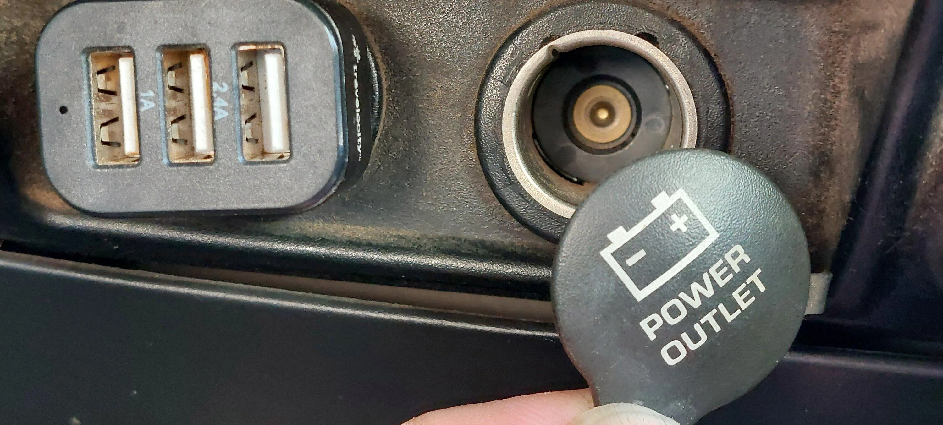

It had what looked like a 5 amp fuse built on bottom, that was in my 05 LJ. (Note the power outlets wasn't made as cigar lighter outlets, no lighter or ashtray in vehicle
Jeep Gladiator Easy routing of wires through passenger side pillar 20221023_155501
) The bottom had burned and melted, at the time it wasn't corroded or anything. I wasn't using the heater part just the fan. If I remember correctly not like I used the heat much there S.E. GA and Florida. :giggle: I started to replace with factory one but was advised (Jeep parts dept) that it was mainly for charging cell phone or radar detector. I didn't like the price for it either so a auto parts store one went in no looking back. That was over 10 years ago, still working great and not limited as much now. Funny to think of the power outlets I've moved on to from that. SAE and Anderson's I did add 2 cigar lighter outlets in my JT though. ? bed and back of console besides 2 that run off house battery. I need to be able to charge a flashlight that uses that still.
I do notice that most are crappy quality or built other than fridge / freezer plugs.

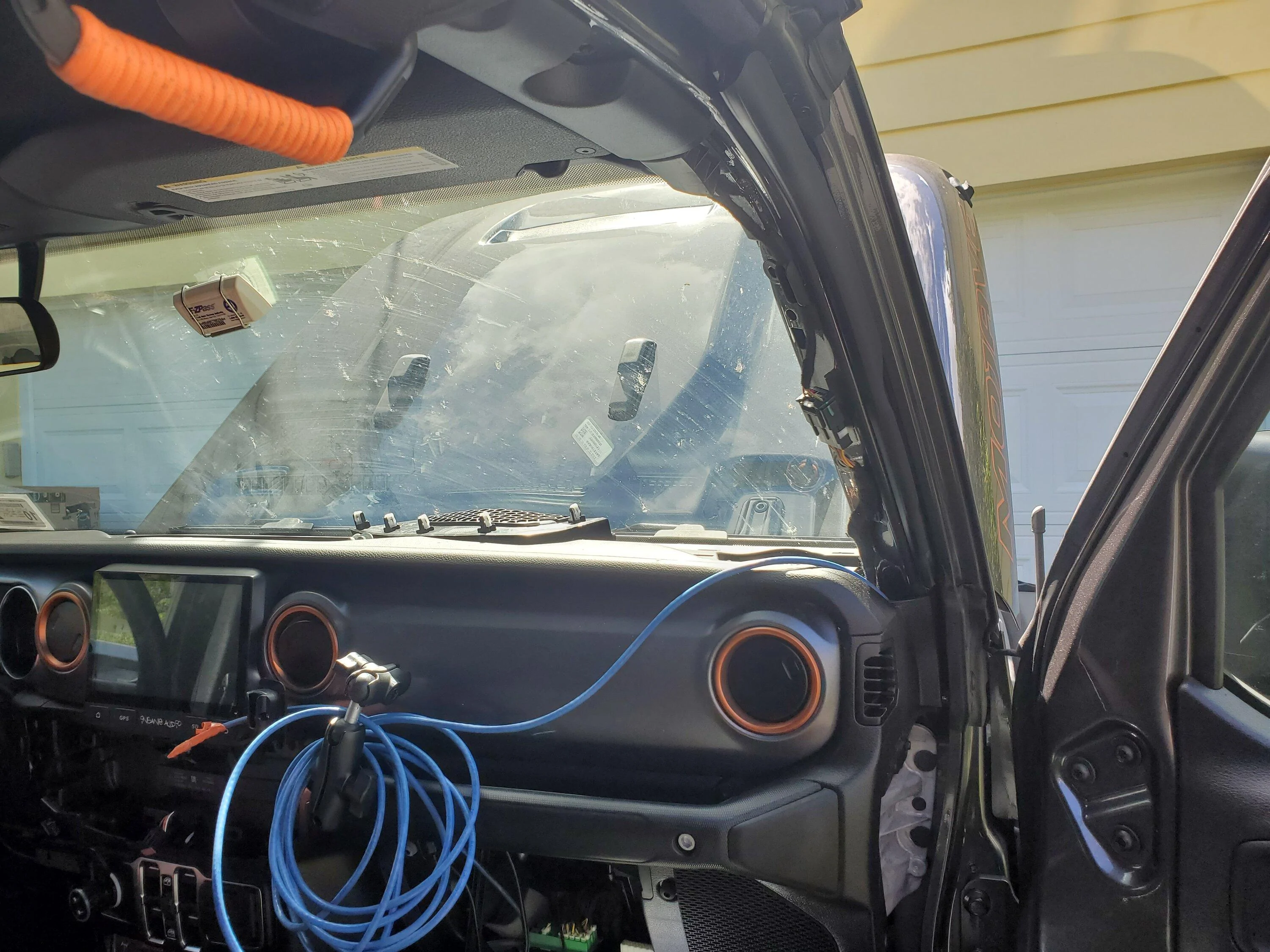

pull the A pillar grab handle two 10mm bolts and the tweeter speaker coverand you should be good to go
This is definitely the easiest way to get down to the kick panel. The grab handle only takes a minute to pull.
I mounted my spod above the mirror and I just snaked the cat5e through the overhead trim above the visors with a tig wire and down behind the the grab handle. Really easy...
Not a great shot, but it's the only one I have with the grab handle pulled.
Modern vehicles, they likely aren't far off! I noticed the ones I have on hand for my classic cars (yeah,, hoard spare parts) are made twice as heavy and well as the one in my JT. The JT one is some of the lightest materials I've ever seen in one - the walls dent and deform easily. Can't do that to the 1970s or 80s ones.

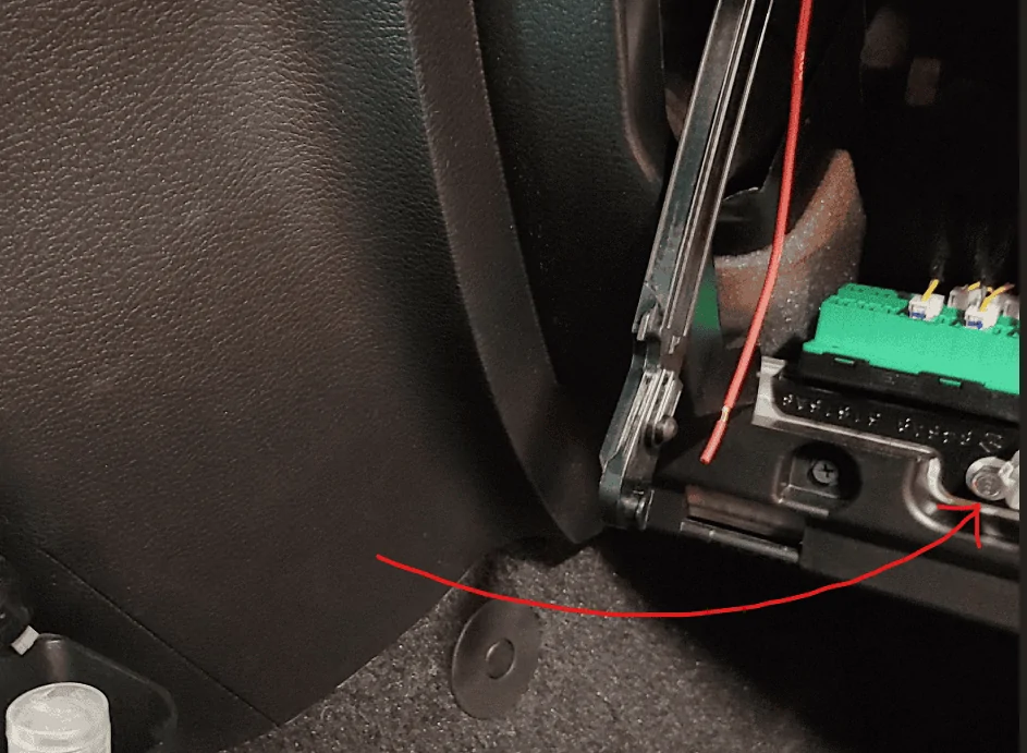

You can almost see the terminal block on mine - it's what I connected my snow plow's ACC trigger to -
