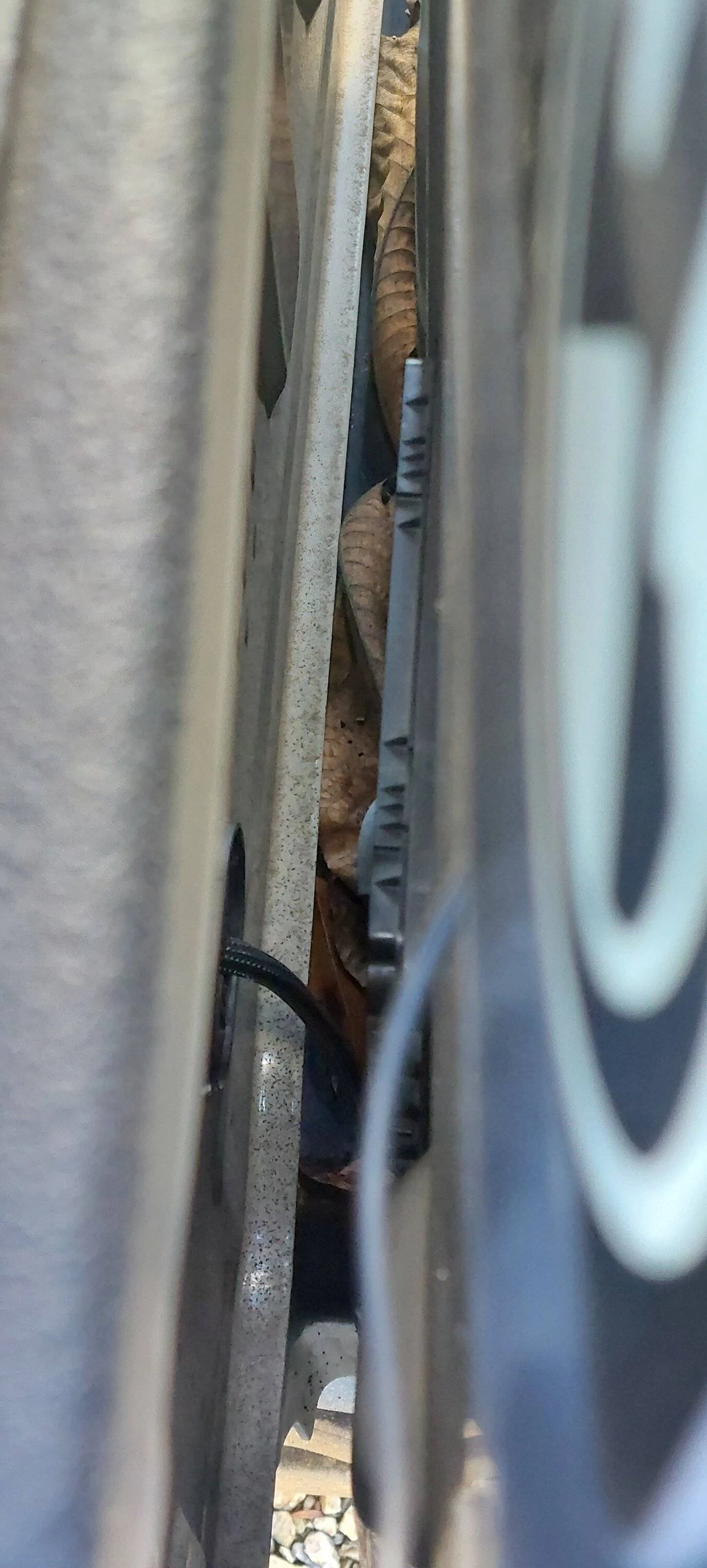

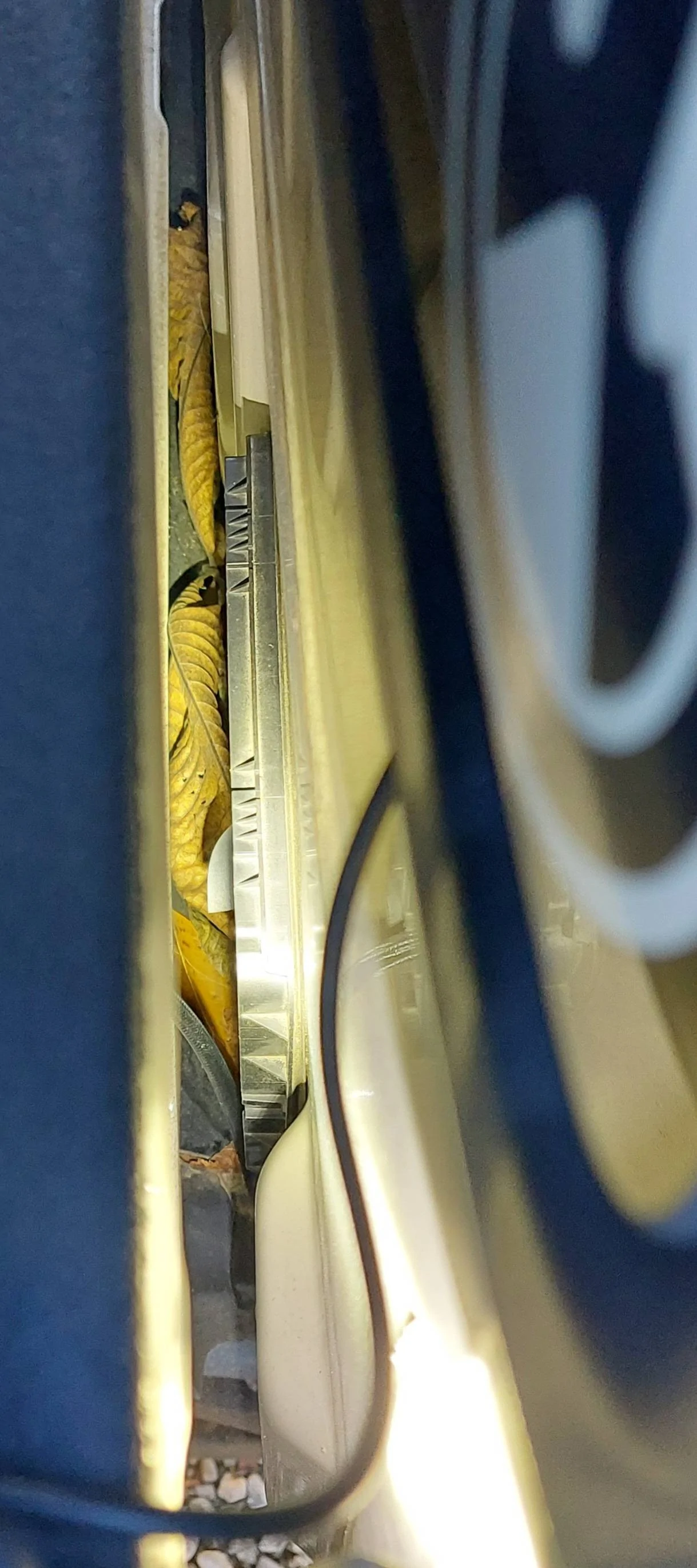

Hmmm, I have trouble figuring out where the pictured location is hahaha, but thanks for pictures.
At the rear right side of truck cab about a foot down and in from back edge of cab. The plastic plug on back wall of bed is in line with right side of vent.
Jeep Gladiator Routing Wires from Cab to Truck Bed 20221215_141955
Jeep Gladiator Routing Wires from Cab to Truck Bed 20221215_142037
If you key off of where the sticker is in side photo to other pictures it should give you a idea of where to look.

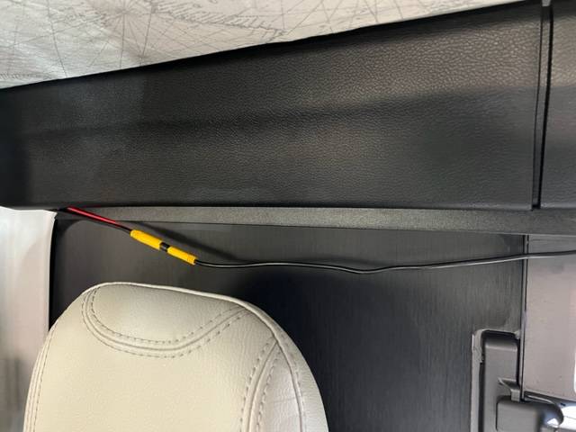

Howdy,
Sorry for the delay.... spent most of the day trying to sign up for a new health insurance plan :angry:.
Here are some pics:
Jeep Gladiator Routing Wires from Cab to Truck Bed IMG_8172
Jeep Gladiator Routing Wires from Cab to Truck Bed IMG_8176
Jeep Gladiator Routing Wires from Cab to Truck Bed IMG_8174
Jeep Gladiator Routing Wires from Cab to Truck Bed IMG_8175
Jeep Gladiator Routing Wires from Cab to Truck Bed IMG_8173

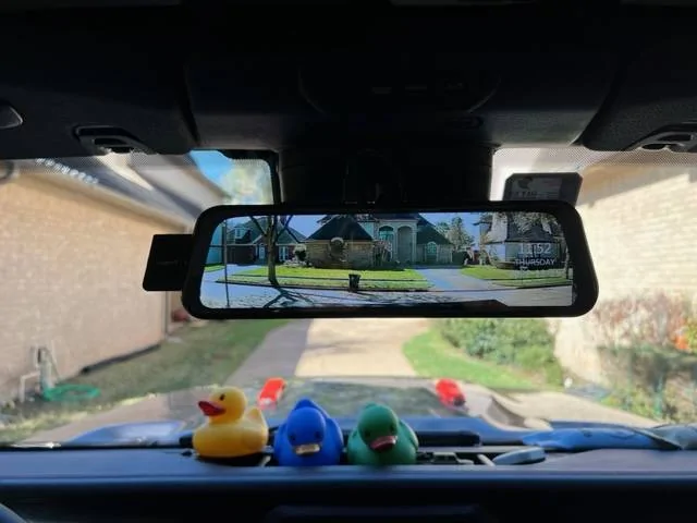

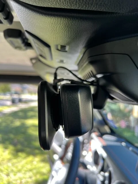

I have the safety options & upgraded rearview mirror, but the front & rear dashcam/ mirror mount helps with vision in rain & provides a much wider view (in addition to black box function). Just make sure you get the HD rear camera, I have a system that I bought 2 years ago in another car & the newere systems are updated & lower in cost. A down side is you will need the 10" version but it will still block your sunvisor because of the front camera. Also it is a bit brighter in low light conditions compared to the mirror. I originally used a small metal angle (about $.87 at HD) but upgarded to wood as I didnt want any sharp objects in the back seat of the Jeep. I pulled the connections out (yellow) they easily slide back into the trim piece, in case you decide to take the top off. If you have any questions or need some more pics, let me know. ;)
That's a nice setup! The visibility looks pretty good as well! I will probably end up doing this as well. Thanks for all your help. I will let you know if I run into anything when I'm actually installing.

Glad I could help. The biggest plus is the wide view (covering the blind spots) n clear vision in rain??

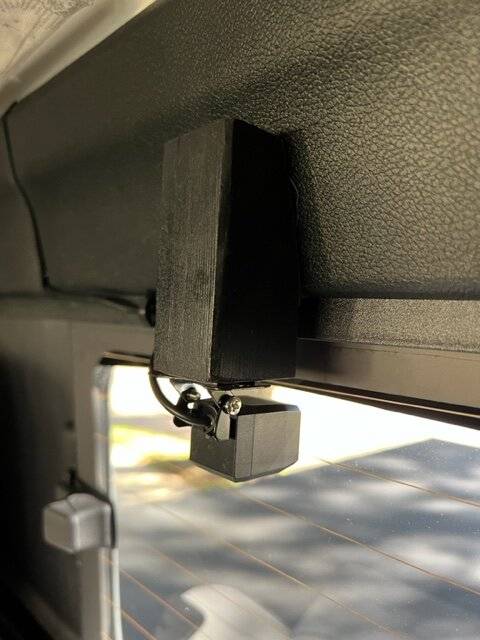

how is the wood block attached?

Can’t remember…. Got it on Amazon for 60.00 at the time! Bought another one “different brand” for 100.00 to compare…. Exact same thing! Just make sure of the following…. 10” & HD rear. 1020. Since my primary use is as a rear view “mirror” I try to get the highest def possible for the rear camera… just go over the details carefully … those sellers are sneaky :mad:

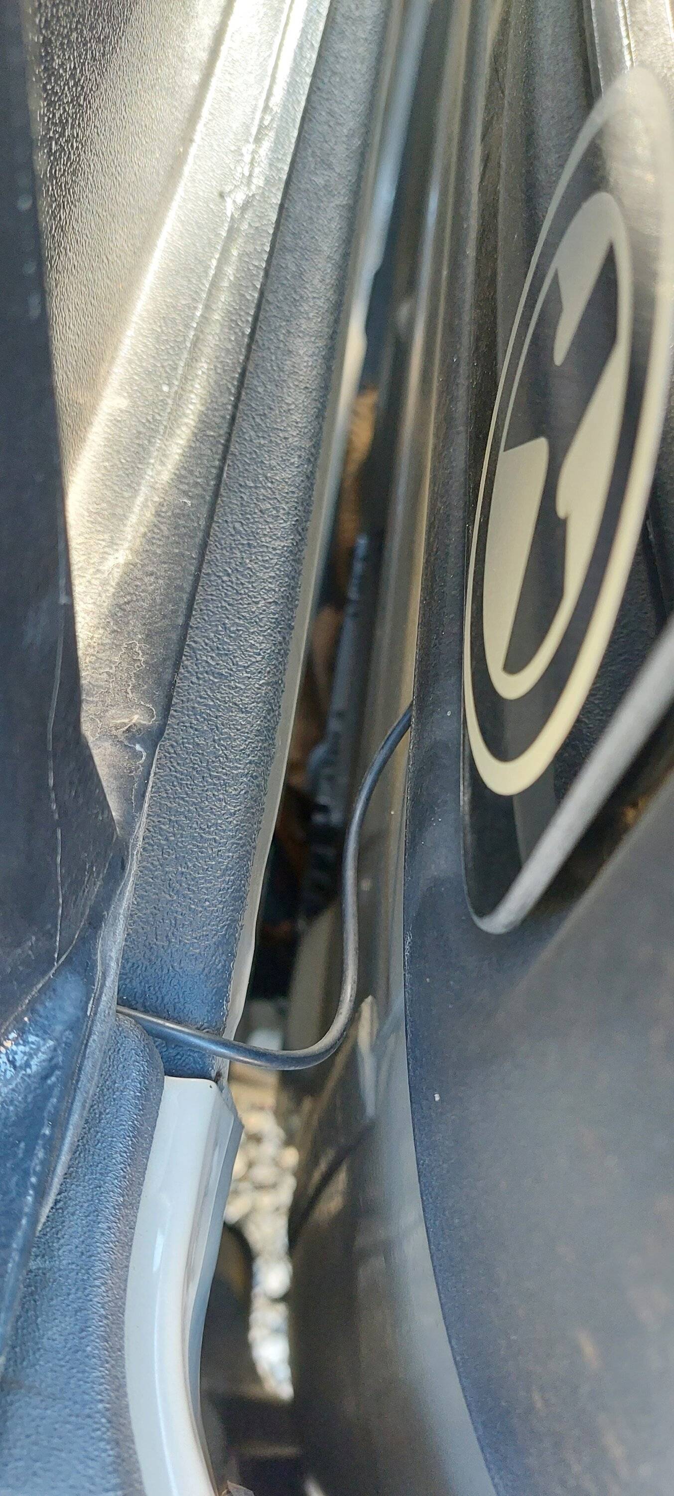

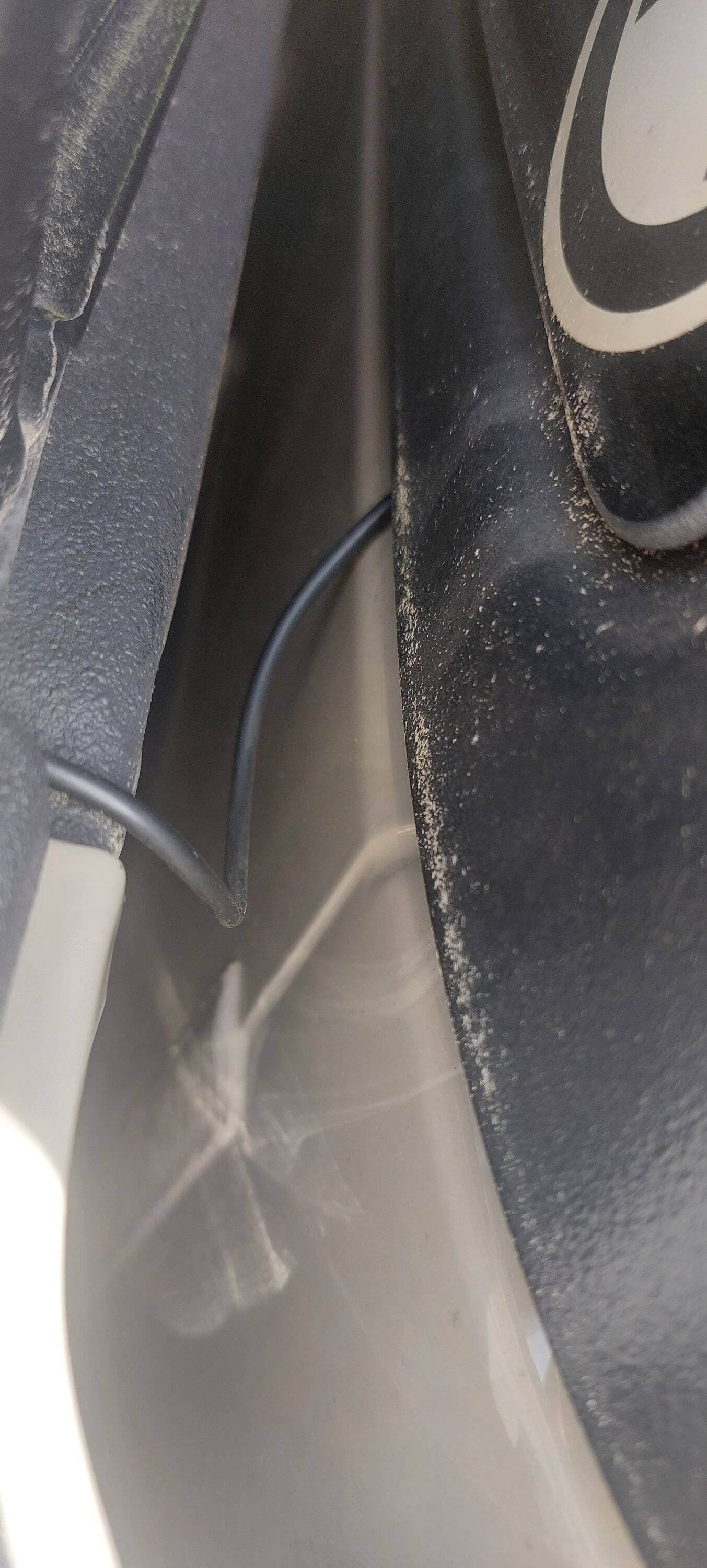

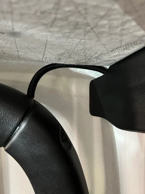

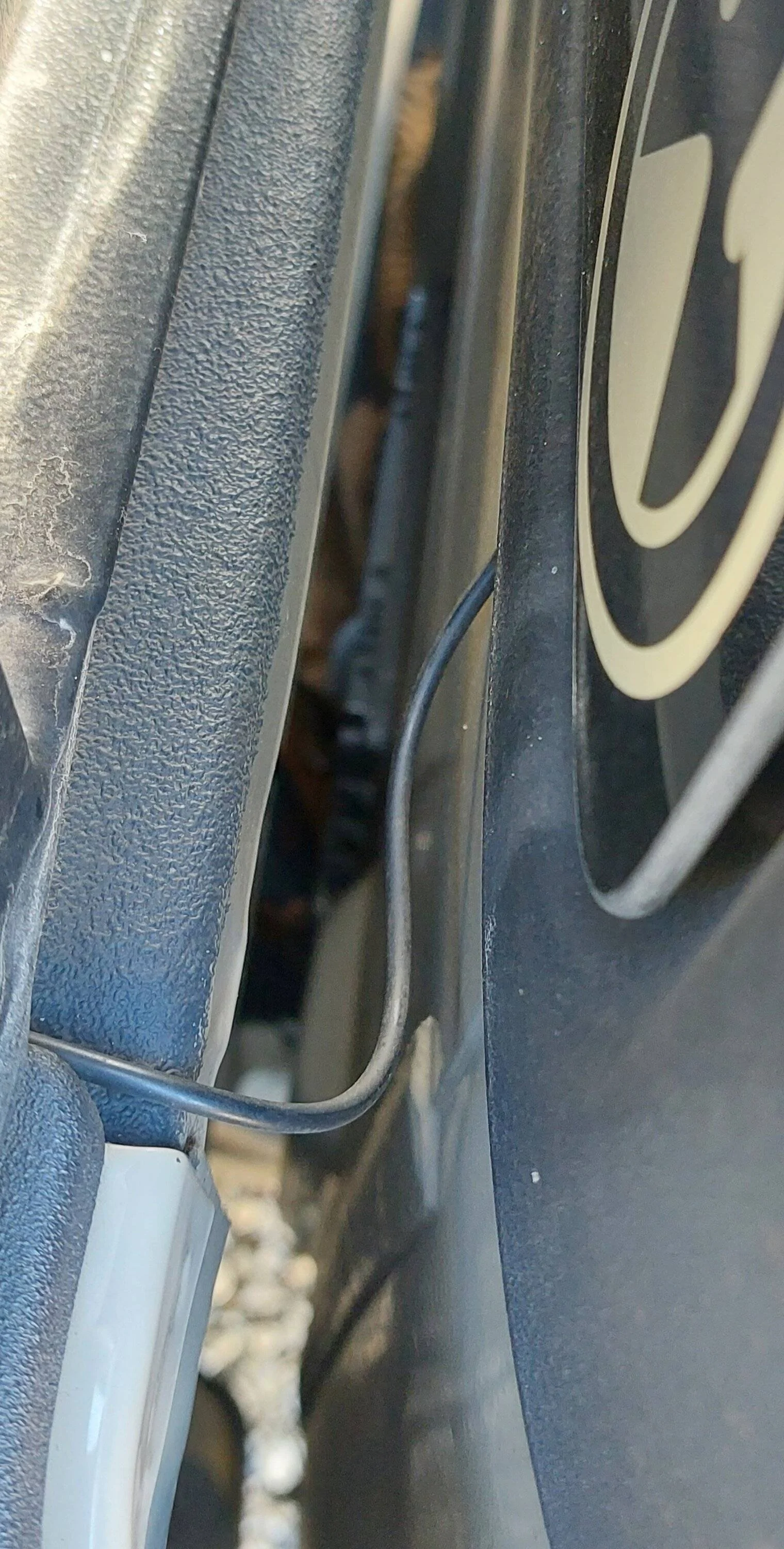

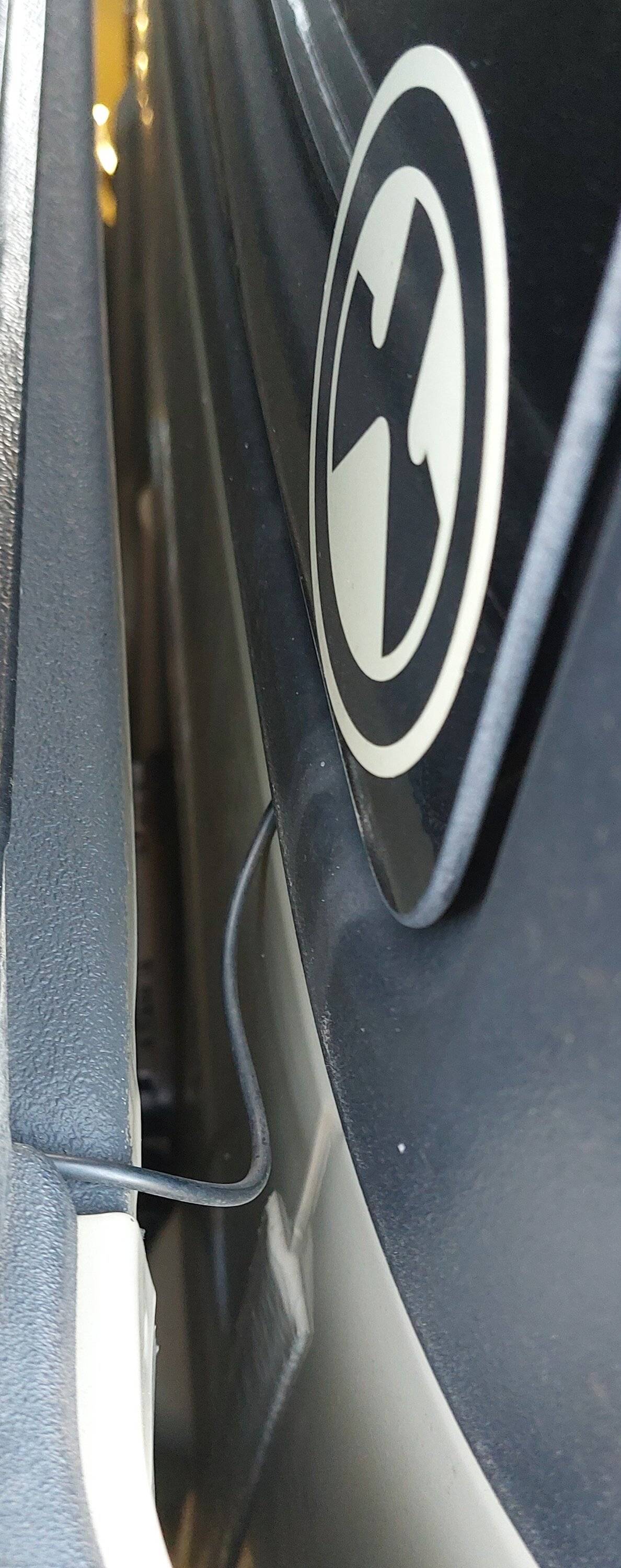

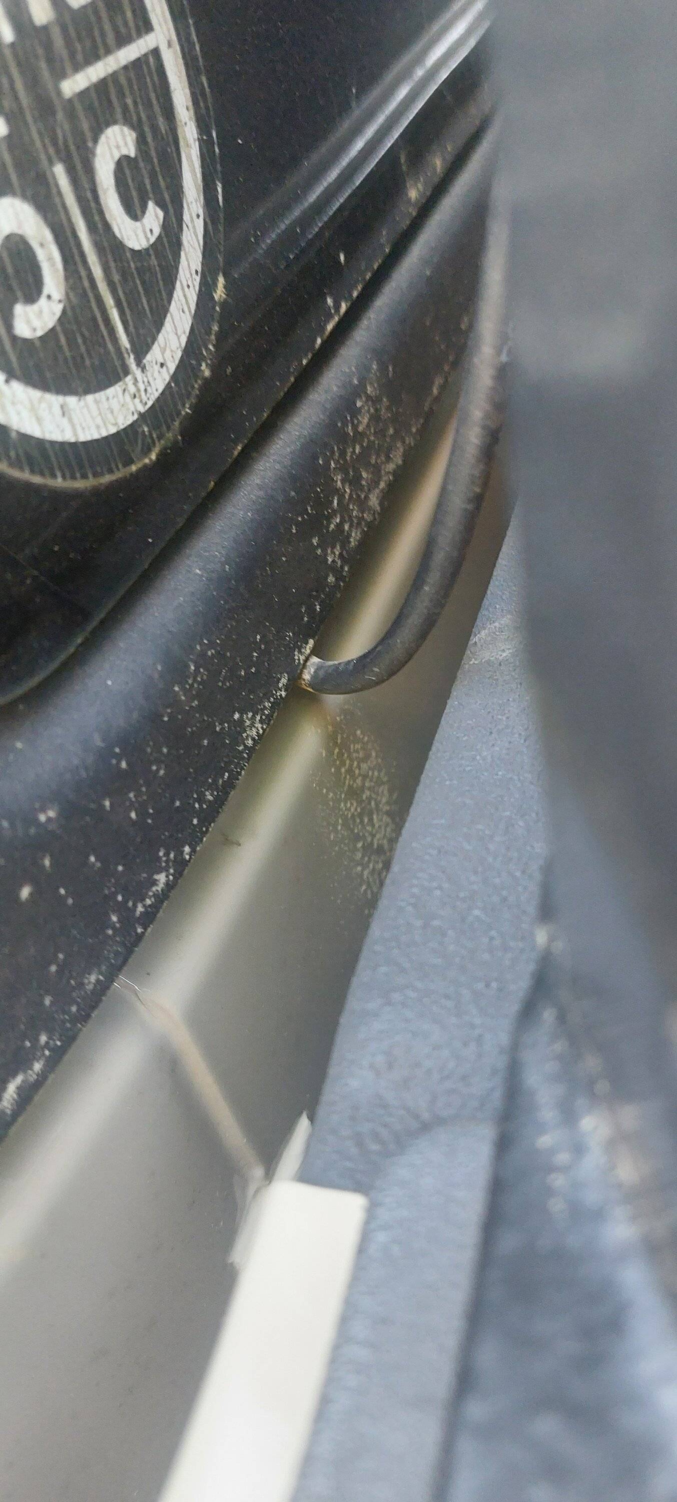

You can just run some wires through it, the wire you will see in my pictures is the rear camera cable on mine that I ran under hardtop. The black plastic further down is the vent on back of right side of cab.
Hey blade, im looking to run a mini coax cable the same way you did. I assume it wasn't too pinched going under the hard top? Did you have concerns with the seal or add any foam? Was there a groove the wire sits In?
I ran wires at seam of where separate metal comes together. I haven't noticed any leaks but I've got wires in a slight loop of loose wire, so any water drips down between bed and cab.
Jeep Gladiator Routing Wires from Cab to Truck Bed 20230504_160409
Jeep Gladiator Routing Wires from Cab to Truck Bed 20230504_160347
One is coax cable for GMRS radio antenna, on left side.
If I remember correctly I may have added some foam sealing tape.

Awesome thanks for the reply.
