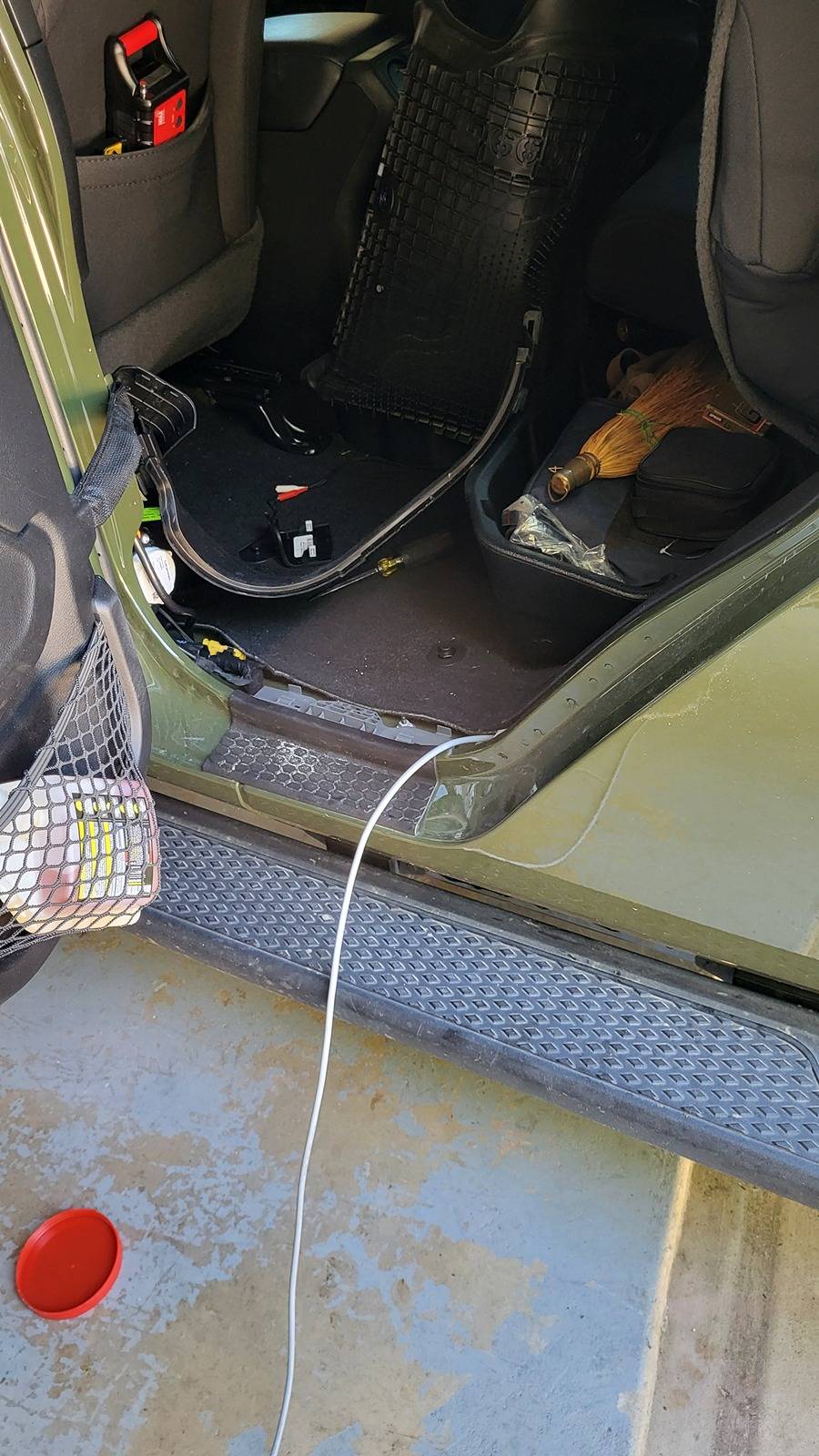

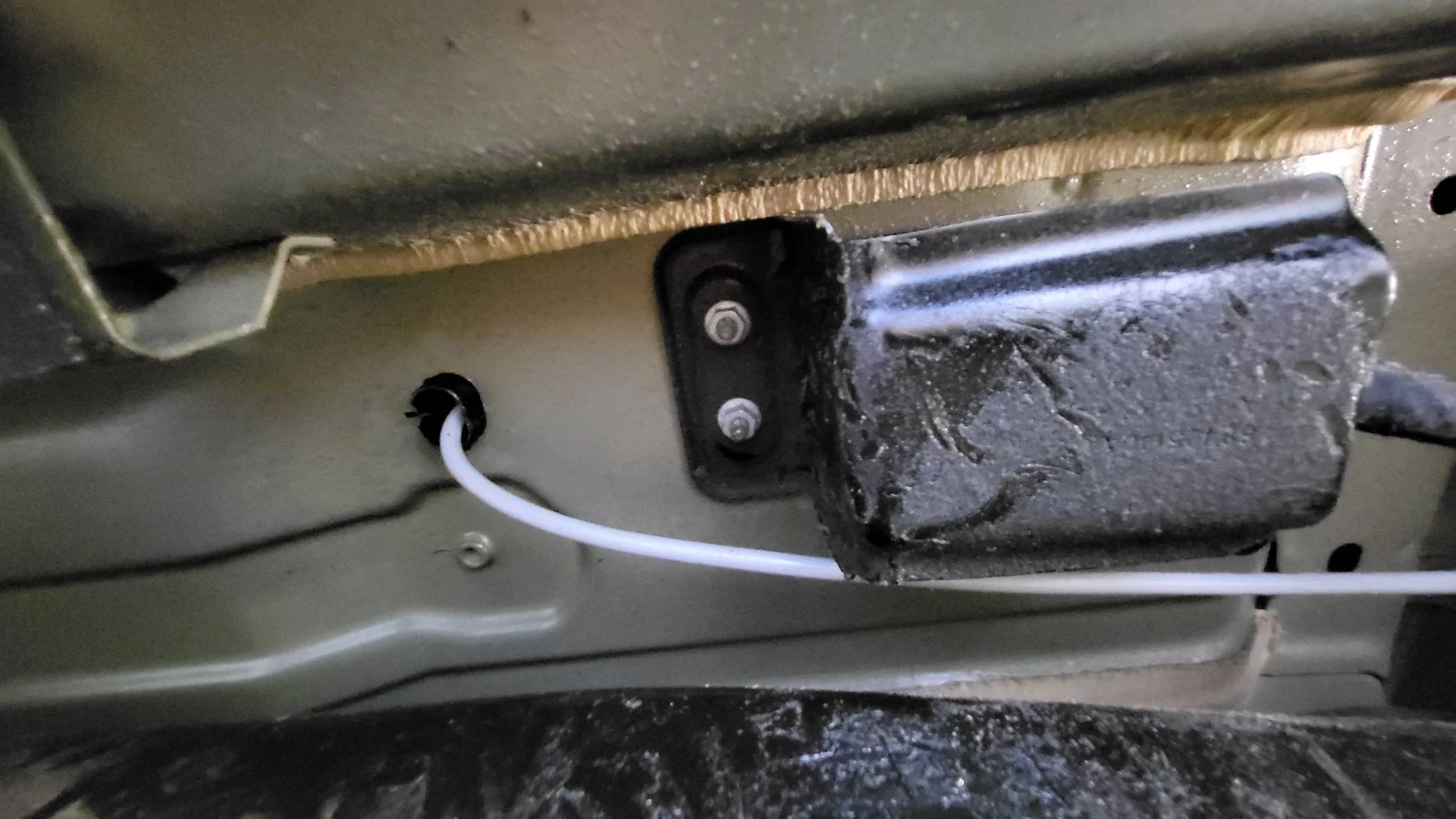

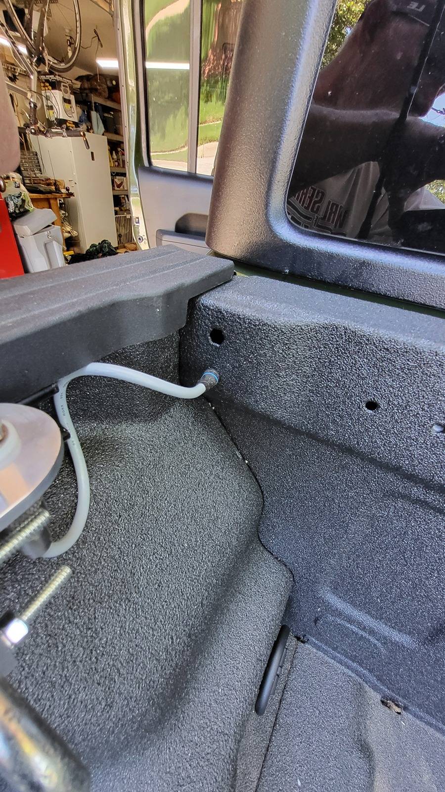

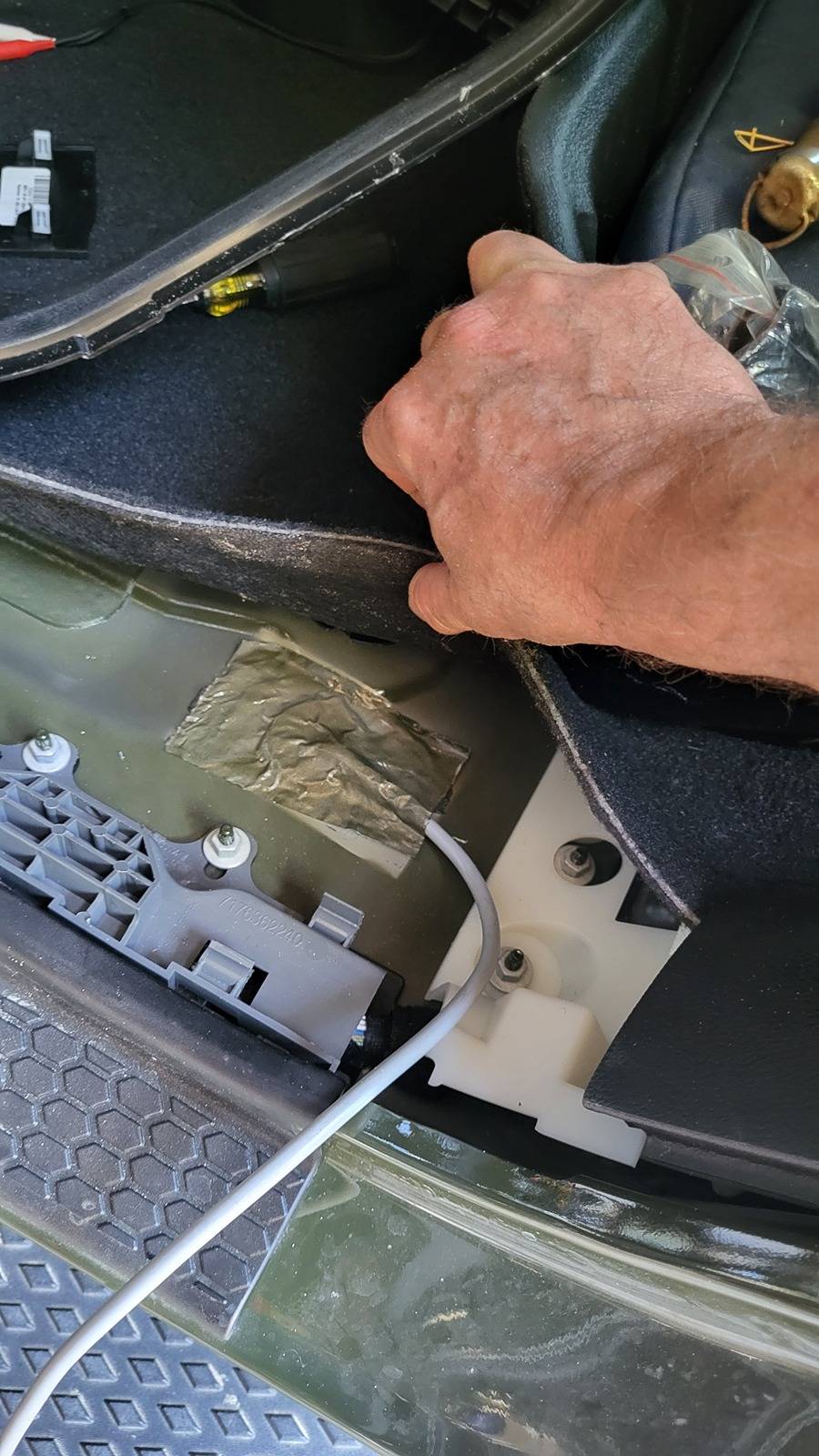

Needed to run coax from under drivers seat to antenna mount in bed but didn't want to run it thru clutch hole (already used for ham rig) all the way to the bed of the truck.
So I was looking under the cab and saw a hole plug even with back door on drivers side. Pulled the back seat carpeting near the door and found it under some thick weather seal tape.
See photos for details. Worked great for my purpose.
I hope this can help others as I haven't seen this hole identified before.

You lost me going from the door sill to wherever you went from there. Where did it exit the cab?
This is great, btw, thank you for sharing it! I will ultimately be putting a CB and/or GMRS antenna(s) back there.
I exited the cab through the hole plug in the floor behind the drivers seat, it is in the photo that shows the coax being covered with the original weather proof tape.
