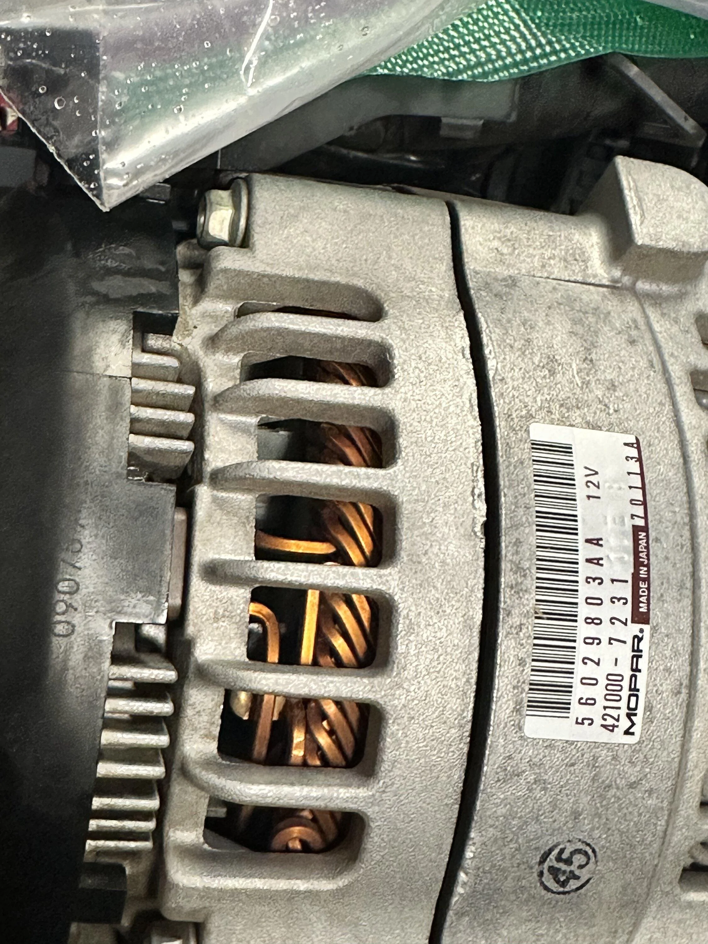

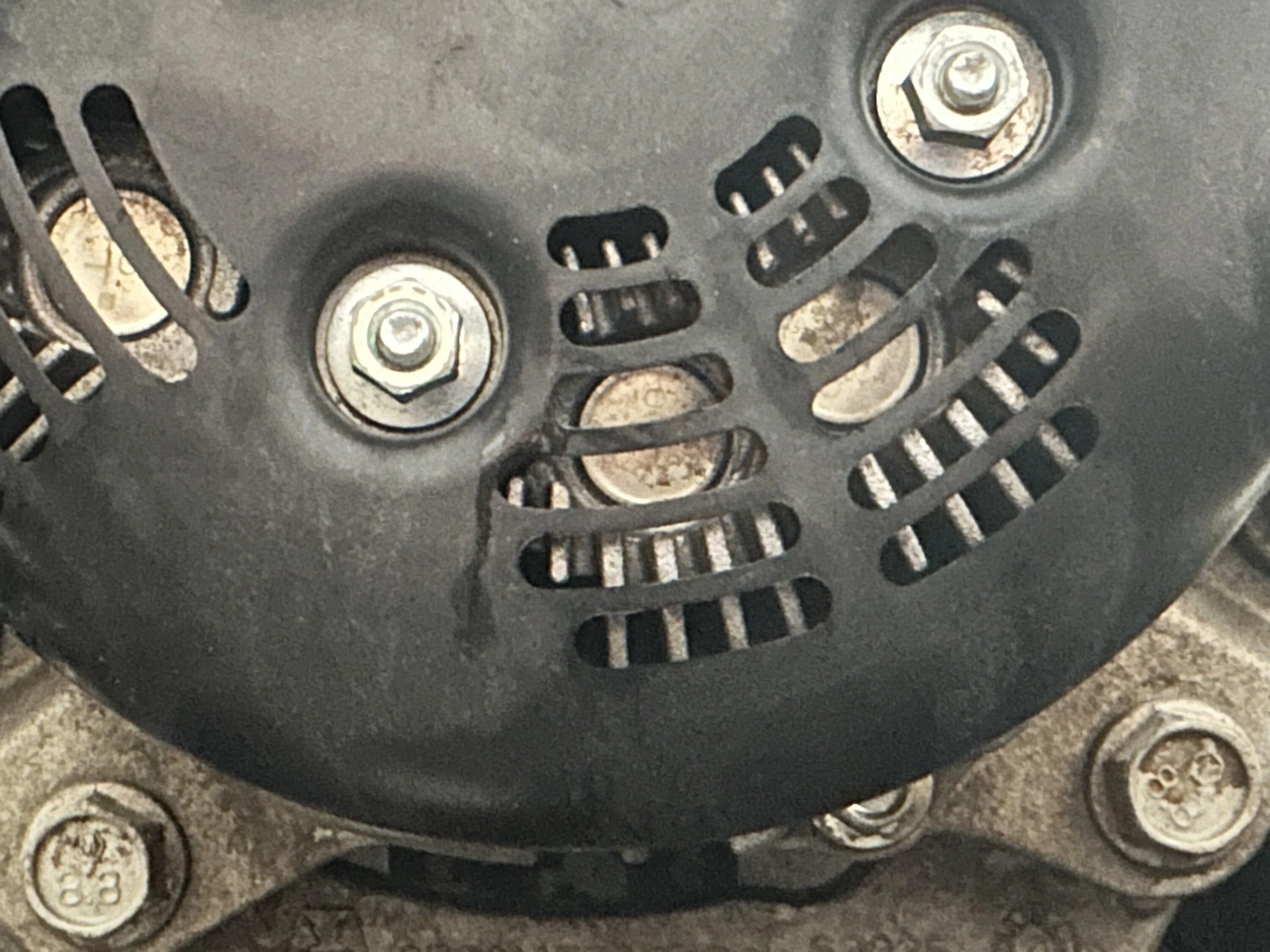

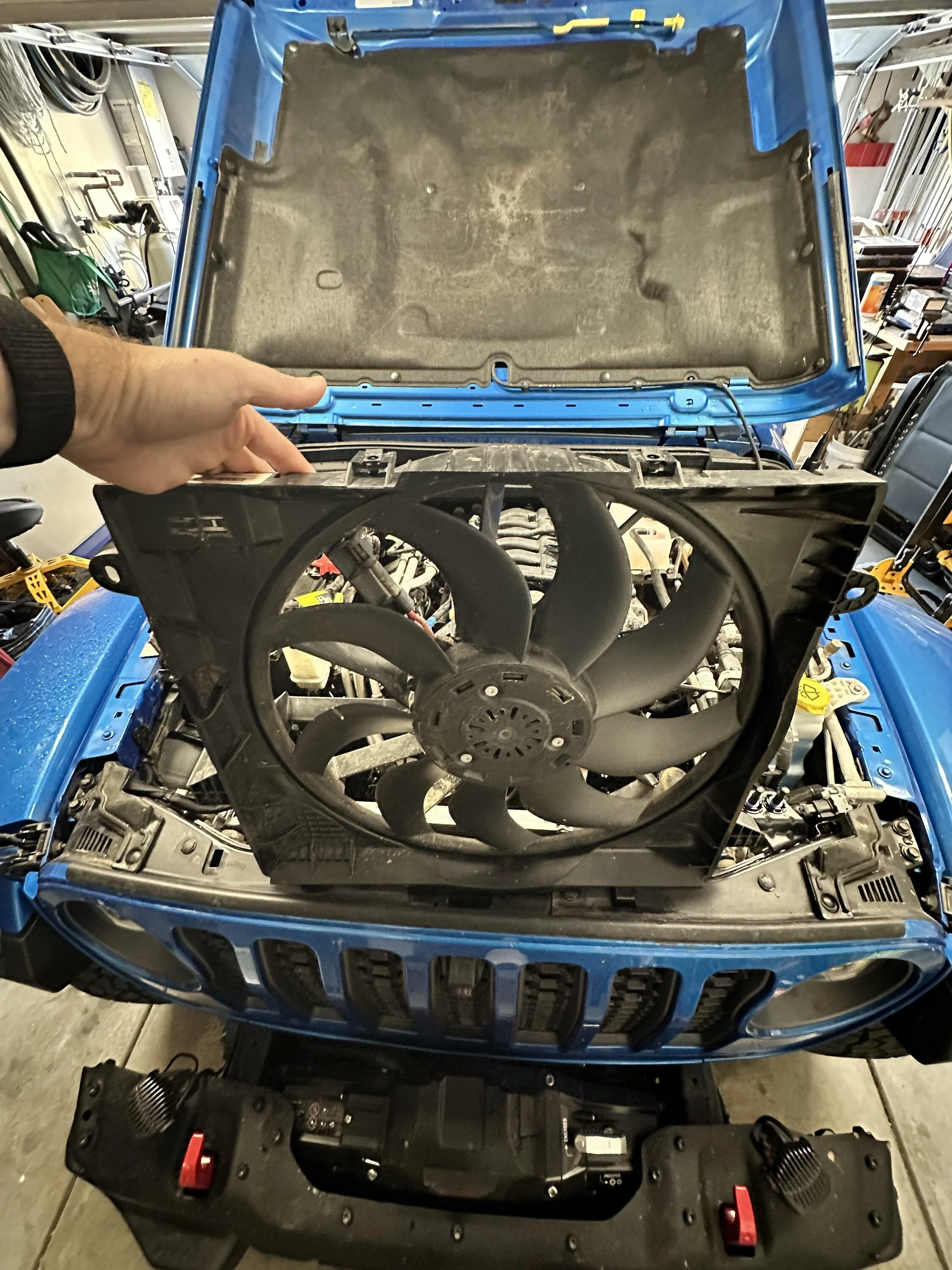

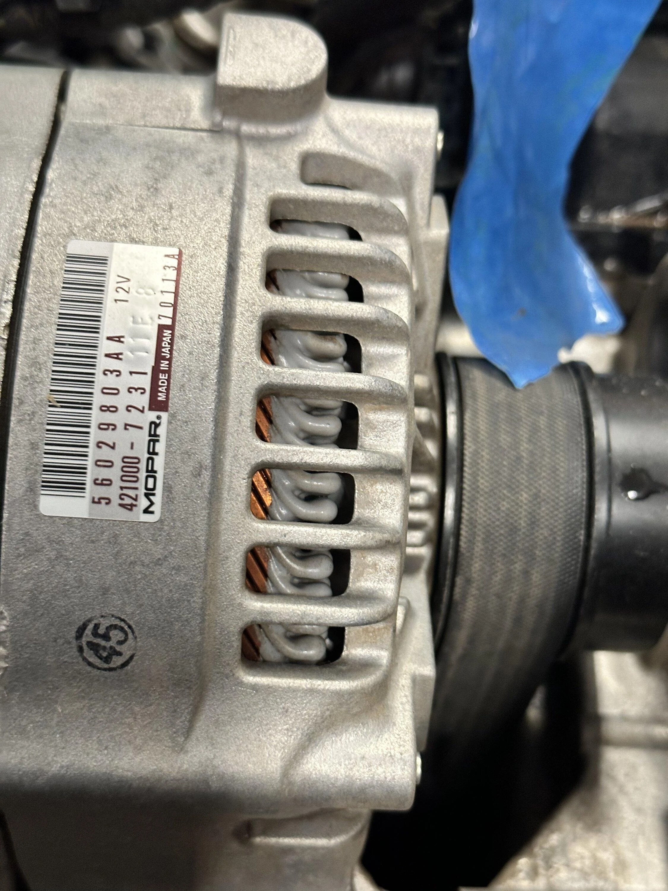

I took the fan/shroud assembly out along with the air box and air intake tube (thing). I had pretty good access to my alternator and it’s in visibly good shape. I hosed off the alternator with a hose (not a pressure washer) to clean it up a little more. No signs of issue. I also cleaned the fan and radiator well. Everything looks good. Still not sure about the slight wine, or if I should worry about it any more.
