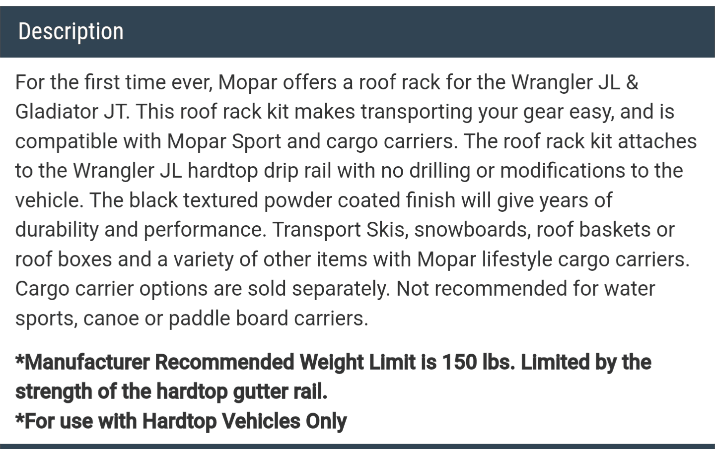

The "others" that don't advise it are MOPAR engineers. The load bars can handle the static weight of the kayaks, but what they can't handle is high winds (highway speeds) hitting the kayaks causing massive forces to be dumped into the gutters. The only way I'd feel comfortable mounting a kayak to them would be if I strapped the front of the kayak to the front bumper and back to the tiedowns in the bed to limit how much the kayaks can move, but even then it's at your own risk.

Thanks for the replies.
So basically what I am getting is - there is a risk, but (as usual) if you take the right precautions you should be fine.
Precautions as in:
Don't exceed (150lbs static weight with Mopar rails)
Attach cross bars to HARD TOP ONLY verses Freedom Panels....
Secure/tie down the bow and stern of the kayak to prevent wind drag/lifting effect from highway speed forces.

I could swear I've seen multiple posts that the dynamic load limit on the rain gutter itself was only 88lbs...

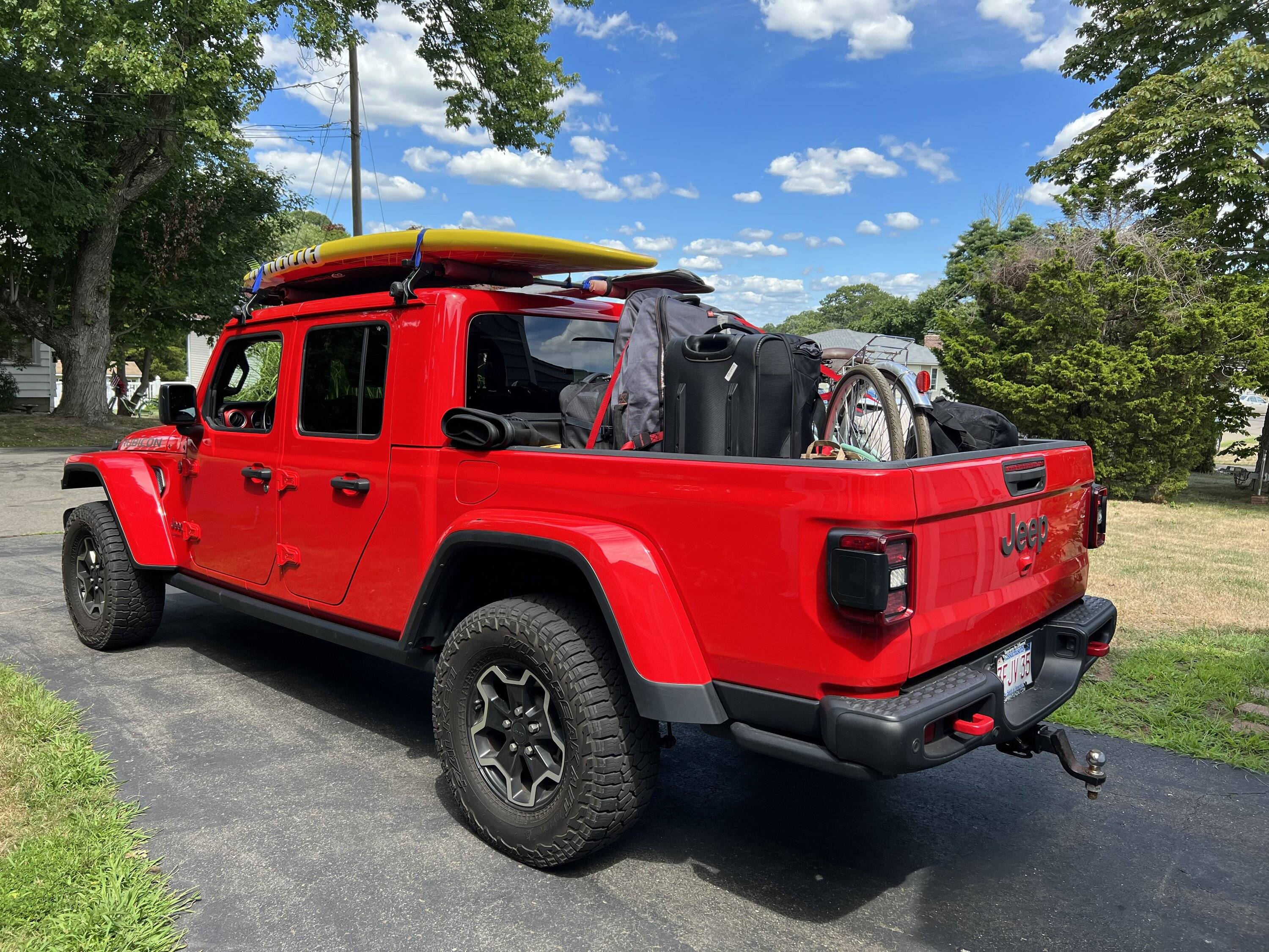

It works, but I thing the key is to minimize front overhand to keep lifting forces low. Keeping static loads reasonable makes sense too. I put a 9’-3” SUP on traditional Thule racks regularly, but set it as far aft as I reasonably can. Feels secure and not overloaded. Photo show was moving my daughter back to campus after the end of last summer.
Jeep Gladiator Rain Gutter Roof Rack  on hard top- Safe or not? 1681945512149
