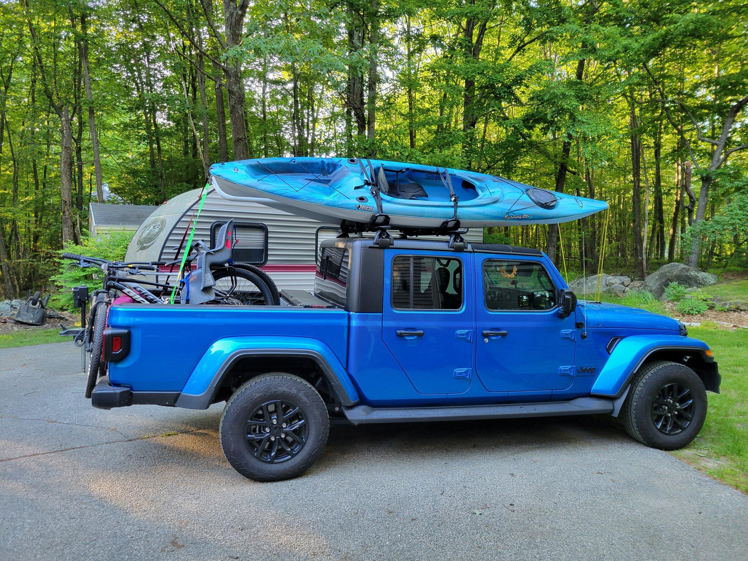

So I searched for someone else who might have done this before me forever, and found nothing. Turns out the kind of person who would run a rain gutter clamp roof rack from China doesn't post about it to online forums.
I figured I'd just take the risk and hope nothing cracks, and if it does fix it. I bought a knock off mopar rack for like 160 of amazon and it just held up for a 3 hour highway trip with no issues and two 55lb kayaks onto.
I'll update if anything changes, but it was solid the whole way so I expect it to last for awhile.

so I drove 65 to 70 and had these tied down tight as a nun in a convent with Rachet straps in back and bowlines in front. they also made in home. I was much more concerned about buffeting than load, so tight tight tight and they will make it at least 6 hours
FYI we all choose our all adventure...
Snailfly Cross Bars Roof Rail Racks Fit for Jeep Wrangler JK JL Gladiator JT 2007-2022 Crossbars https://a.co/d/05z8WnP
