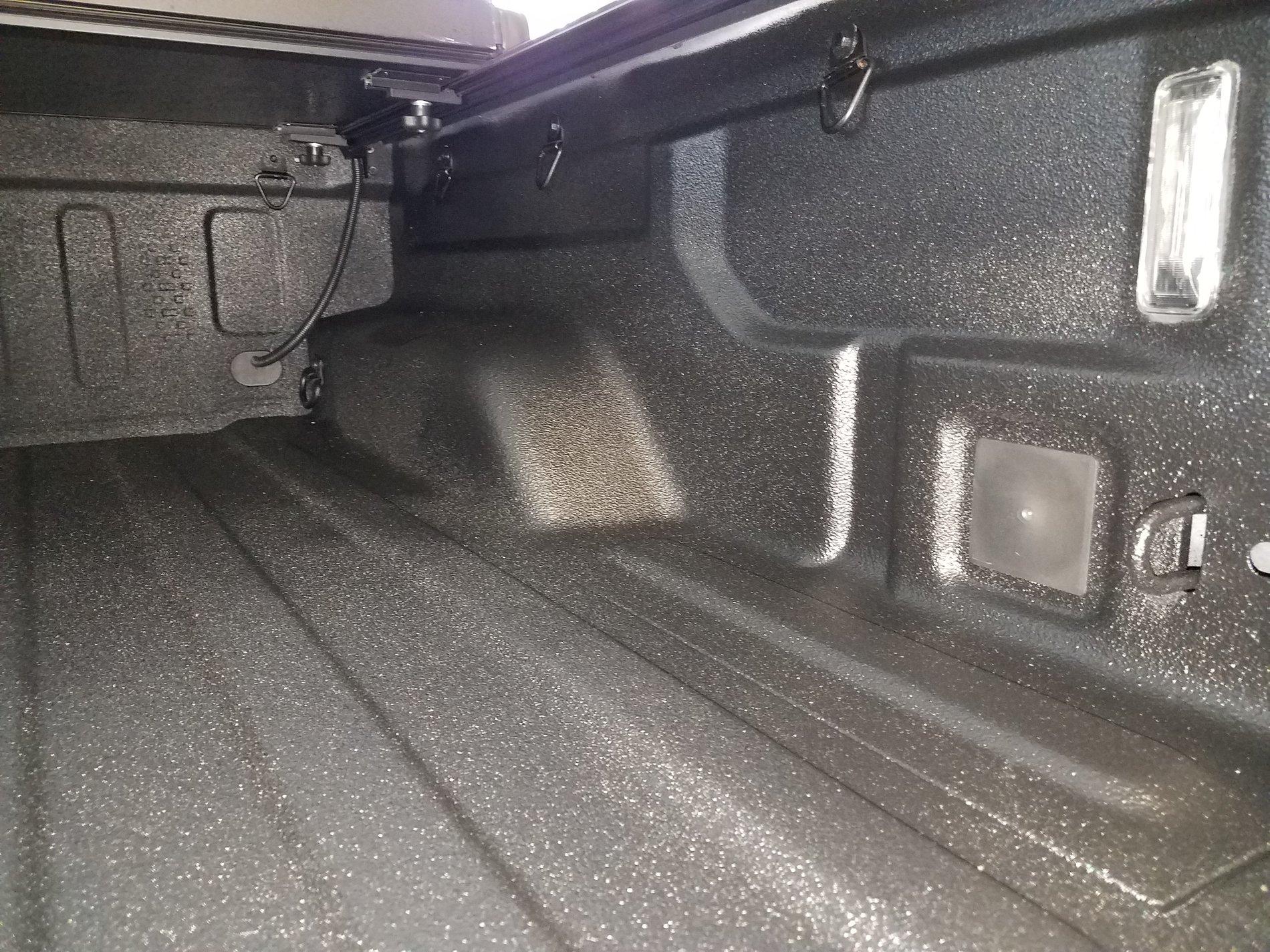

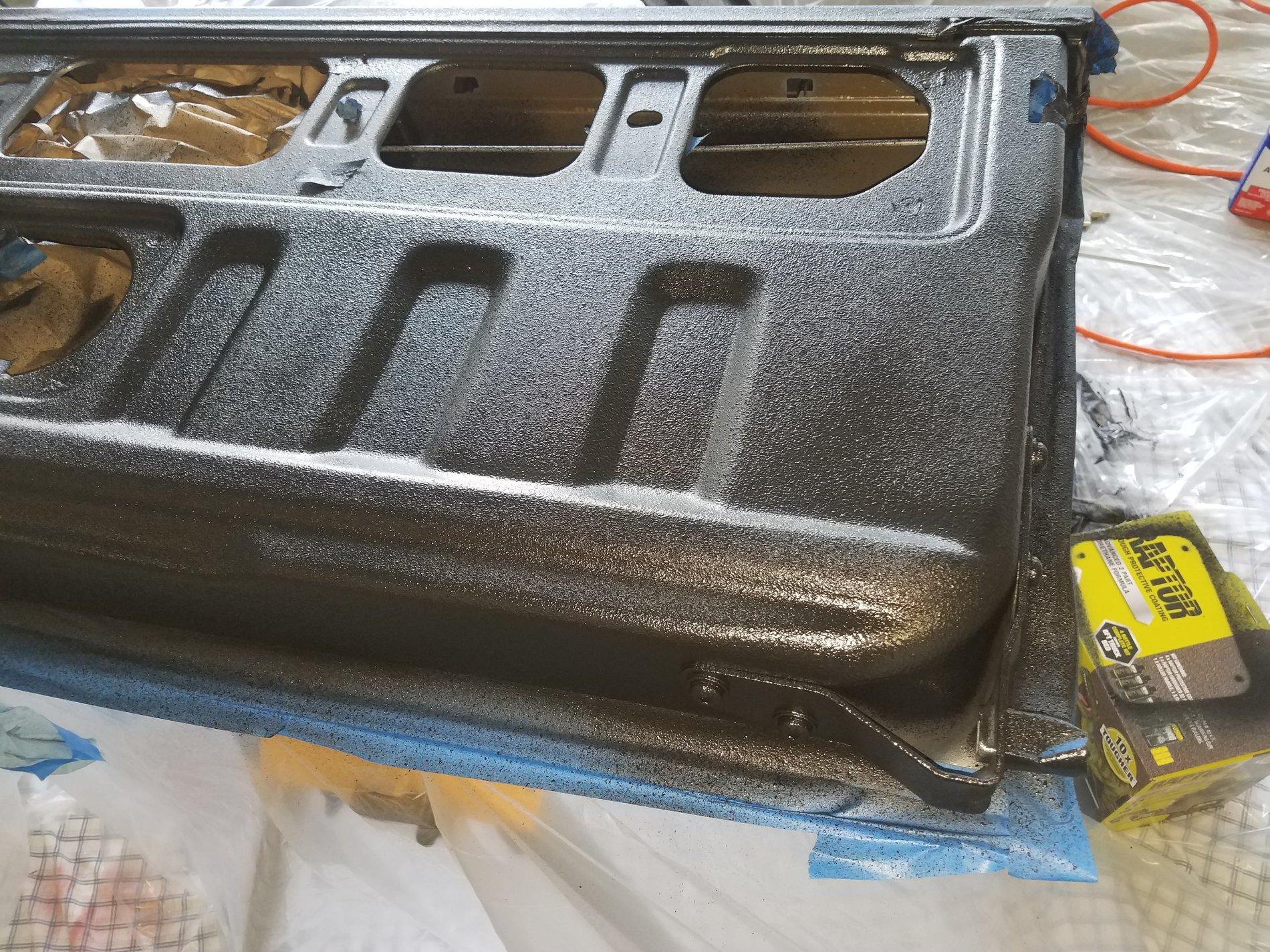

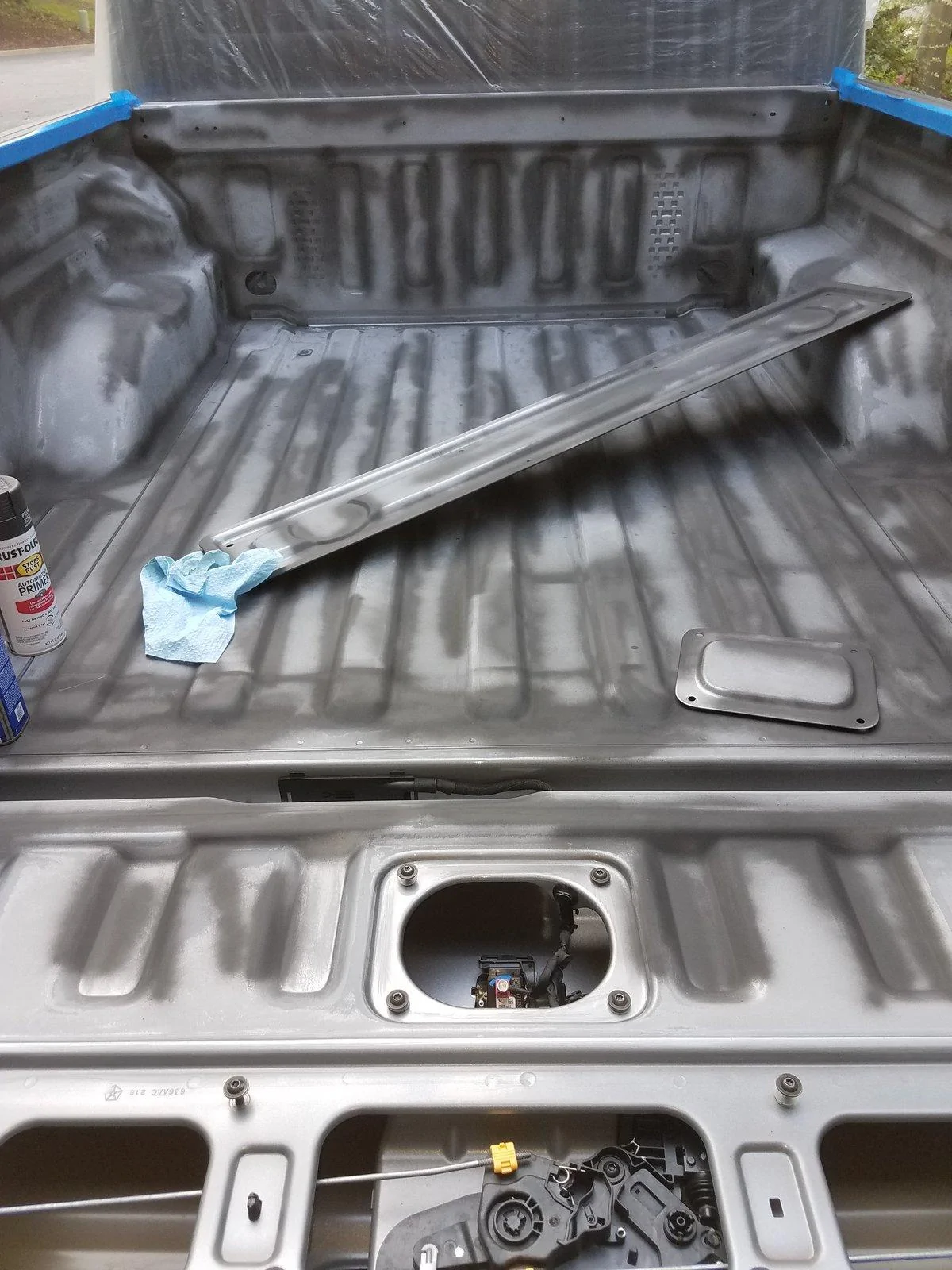

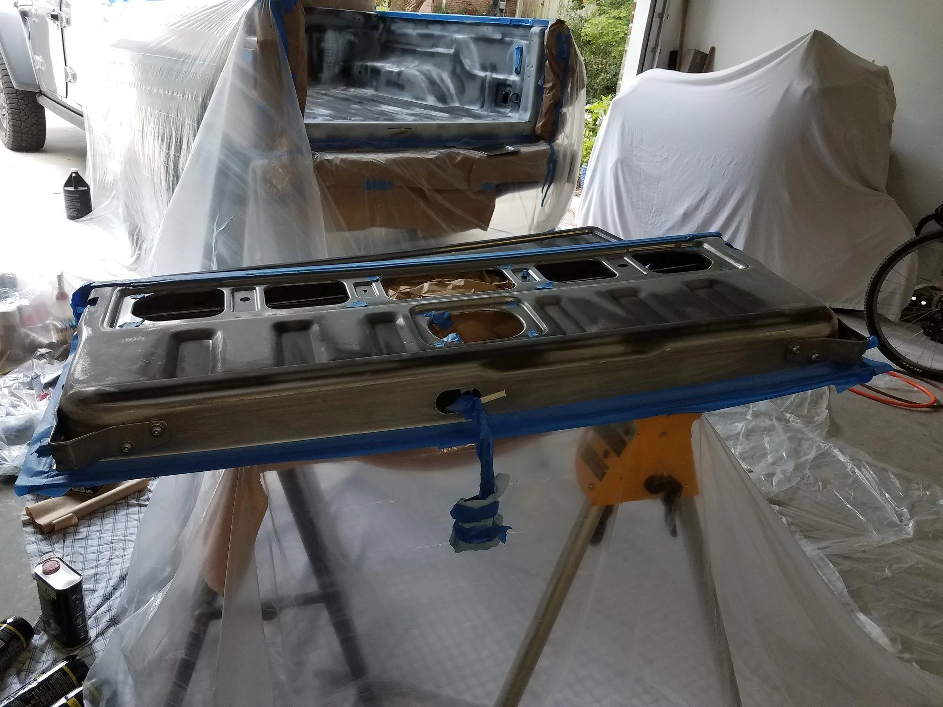

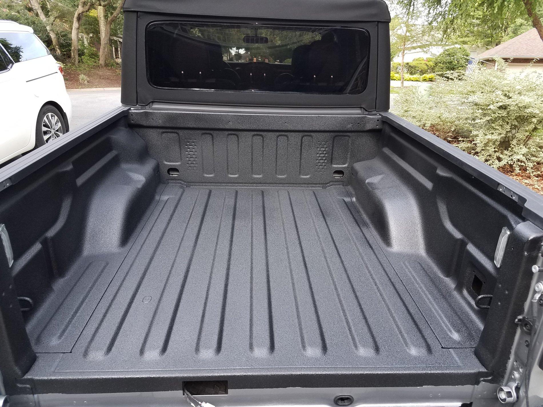

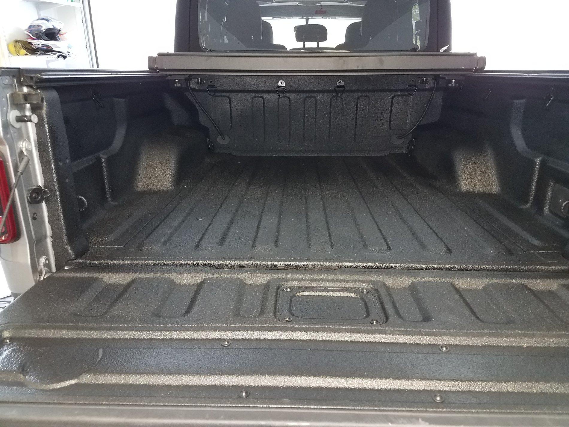

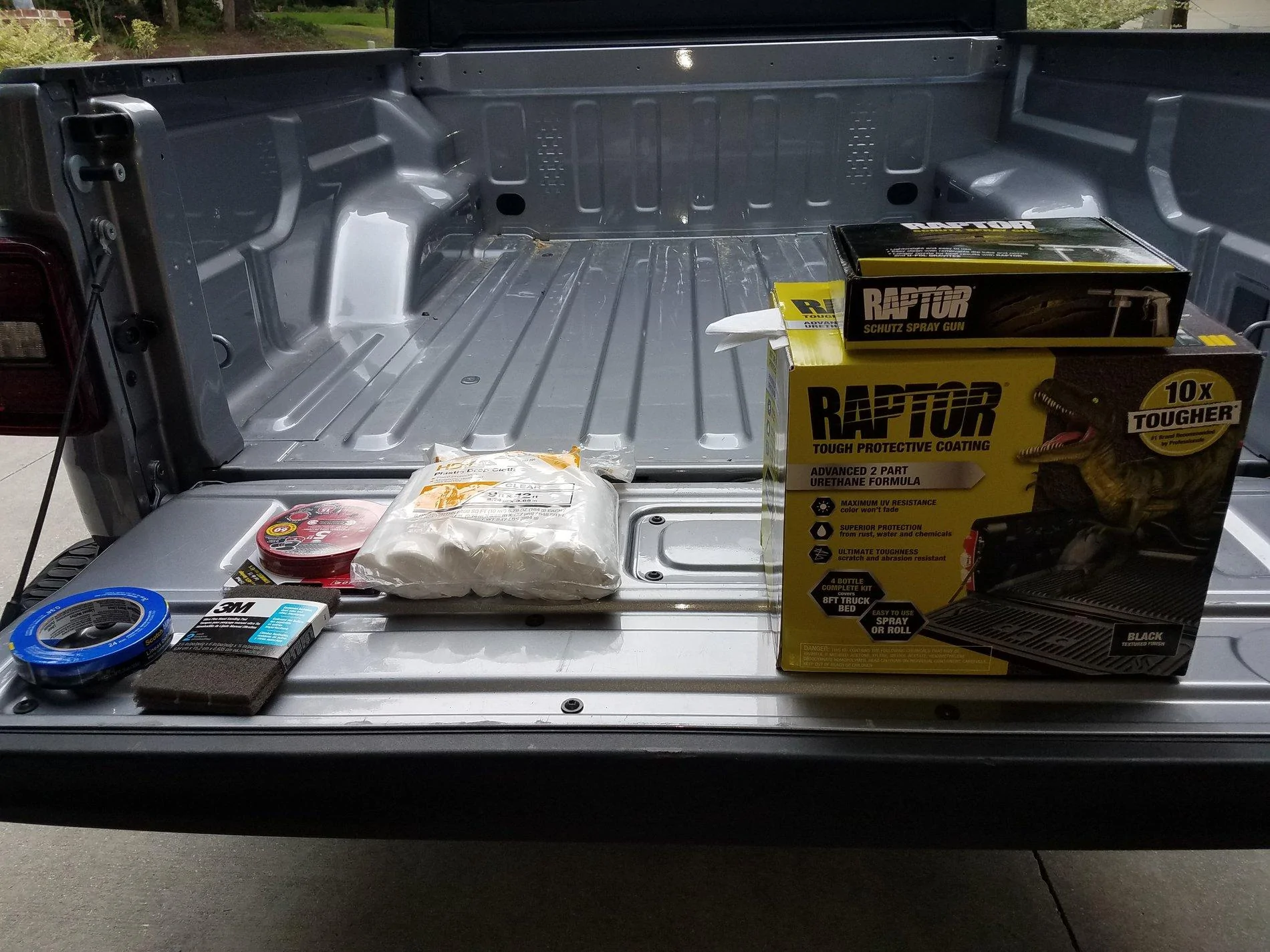

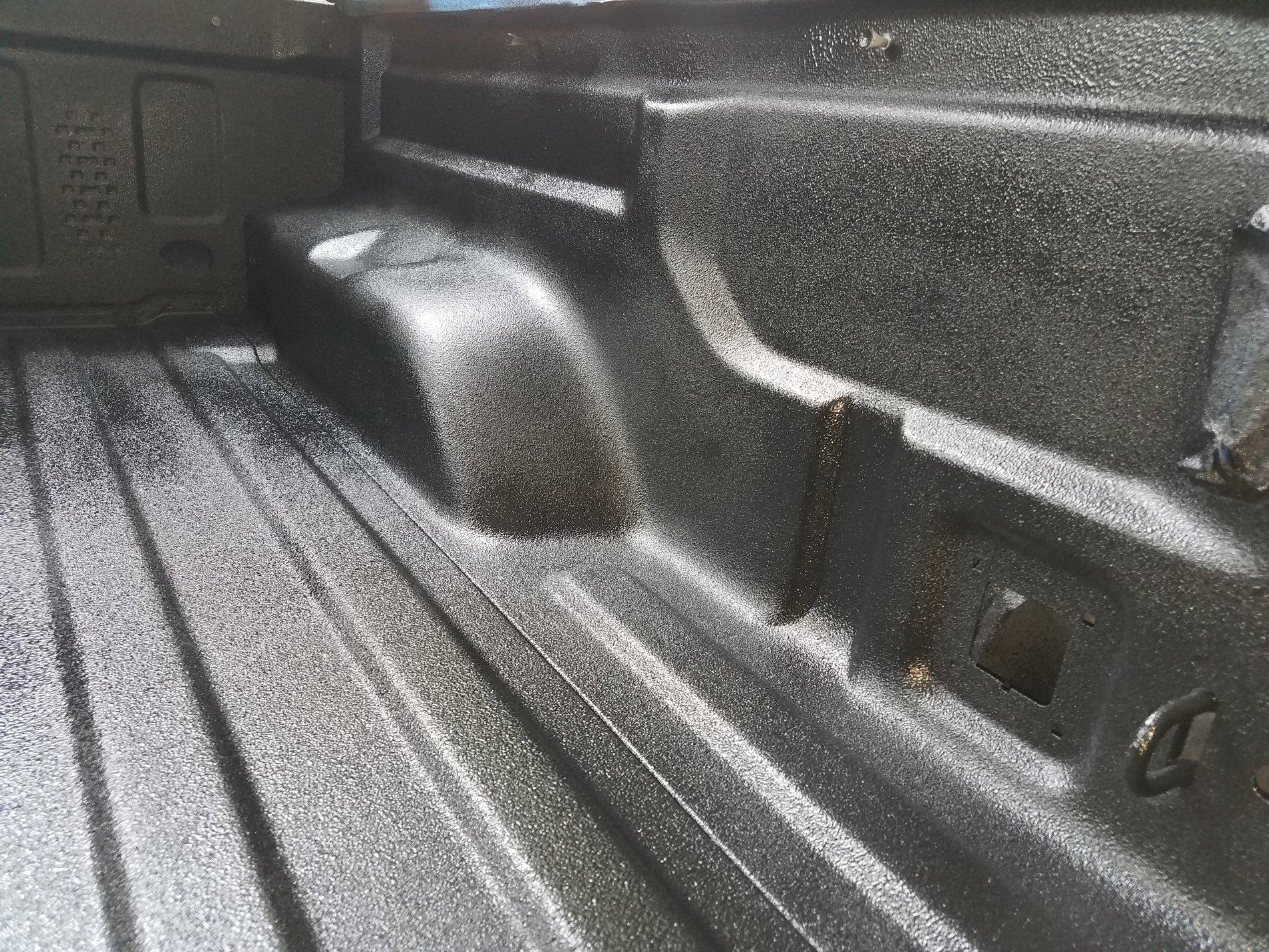

I sprayed in the Raptor Liner product in the bed of my gladiator. You can buy the kit for @ $130 online. It came with 4 liters of product. I'm not sure how one could do a full size truck, but it worked fine for the 5' bed. I stripped everything off and sanded. Then taped and covered. Plenty of YouTube videos on this. Totalled was about 3-4 hours. Spray time and clean up was about the same. I am waiting to re install plug, panels, and tie downs.

Fairly straight forward. Spraying was easy, not much to mess up, not a lot of overspray. No, it is not linex, I'll see how it works.

Actually just used the same kit to do my son's full size square body GMC, four bottles is JUST enough to do a 6.5 foot bed with a "light duty" coating. Thinking I may go ahead and do my Gladiator with the same kit rather than paying LineX $500, should even have enough to do a coat on my Arcus.

Just to follow up, I found it took about 6 days for everything to dry and harden properly. I am still smelling the off gassing. It is hot here in Fl, I thought it would go faster. I do have a tonneau cover on.
