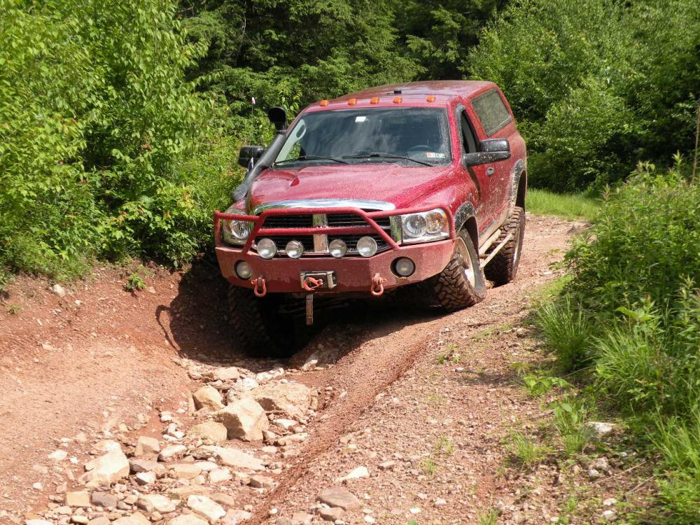

I had my White Knuckle sliders coated by LineX. The shop that did it is no longer in business. Had my LoD front winch bumper done by Rhino Liner. The difference between the 2. The LineX coating is smoother. The Rhino coating is rough like 00 grit sandpaper. If you brush up against it. You will leave some skin. The LineX a bit shine to it. The Rhino is duller.

LineX can do colors. They matched the paint on my Power Wagon front bumper.
Jeep Gladiator Bedliner Product experience/reviews? Rausch Creek
