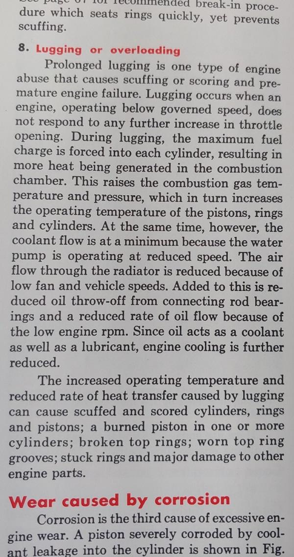

My take, for what it's worth (likely every penny you paid for it) - yes on shifting, bunk on octane just on principal.
Could it help? It COULD - maybe - but you bought a truck that is advertised in all the books, owner manual and other places- 87 octane. It clearly states use 87.
Mine does NOT ping on 87. Everything works as it should meaning that the valve lift, valve timing, spark timing and other things are falling into place to deal with 87 octane fuel. Most of the other 3.6s do as well. My wife has owned multiple Jeeps with 3.6 Granted, a very different tune in a JT vs a WK2, but still a 3.6
To suggest a customer ignore the owner manual and "fix" a problem by using more expensive fuel than what the BOOKS say baffles me. If it can't run on 87 then they are lying (or that engine has an issue)
I should post a snippet from a book or two I have that explains a few things about "lugging" and the side effects (including detonation) it might support the shifting sooner thing.
