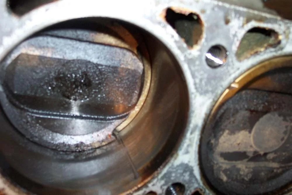

The noise is caused by detonation - which is NOT normal. Not all detonation results in an audible sound like the "ping" or "rattle" but normally it does.
Detonation is not normal and should never be allowed.
The sound is a normal sign of detonation, if that makes sense.
The shock wave of the two flame fronts colliding blows away the cooler boundary layer above the piston exposing the piston head to temperatures that can melt the piston. The shock waves can also result in - - >
Jeep Gladiator Rattle from engine when accelerating (sounds like keys) piston-5a
