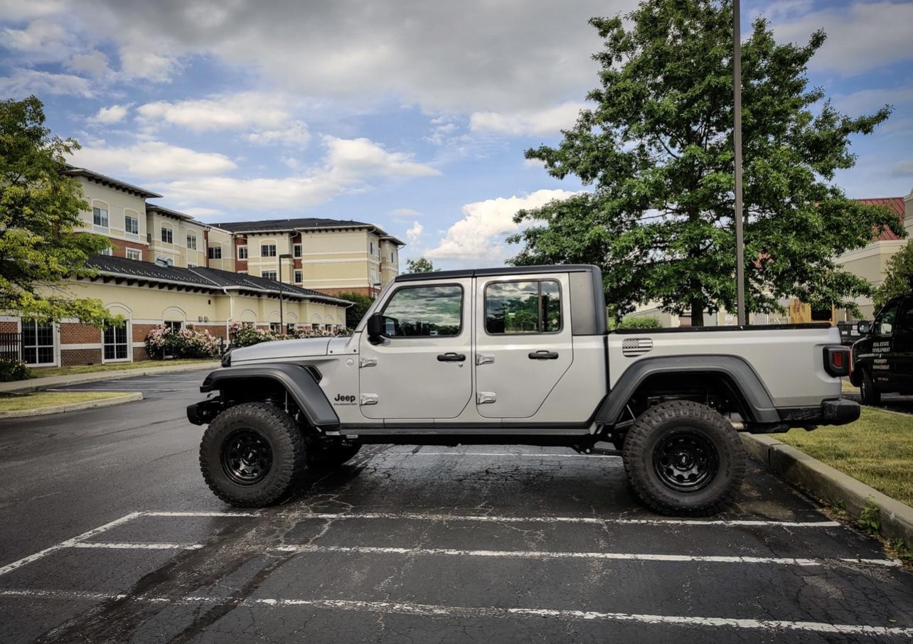

I originally was gonna go with a 2.5” kit but I know I like the 3.5” look more. I already have a 1.5” level kit on and I can tell that the stance is no where near where I want it. I’m chasing this look in the picture (but Snazzberry of course). It’s a forum member’s truck but I can’t remember who’s it is. Those are 35s I believe.

I’ll maybe go up to 37s in the future when I have a second vehicle. Idk how I would feel about daily driving 37s lol. I heard it’s pretty rough.
