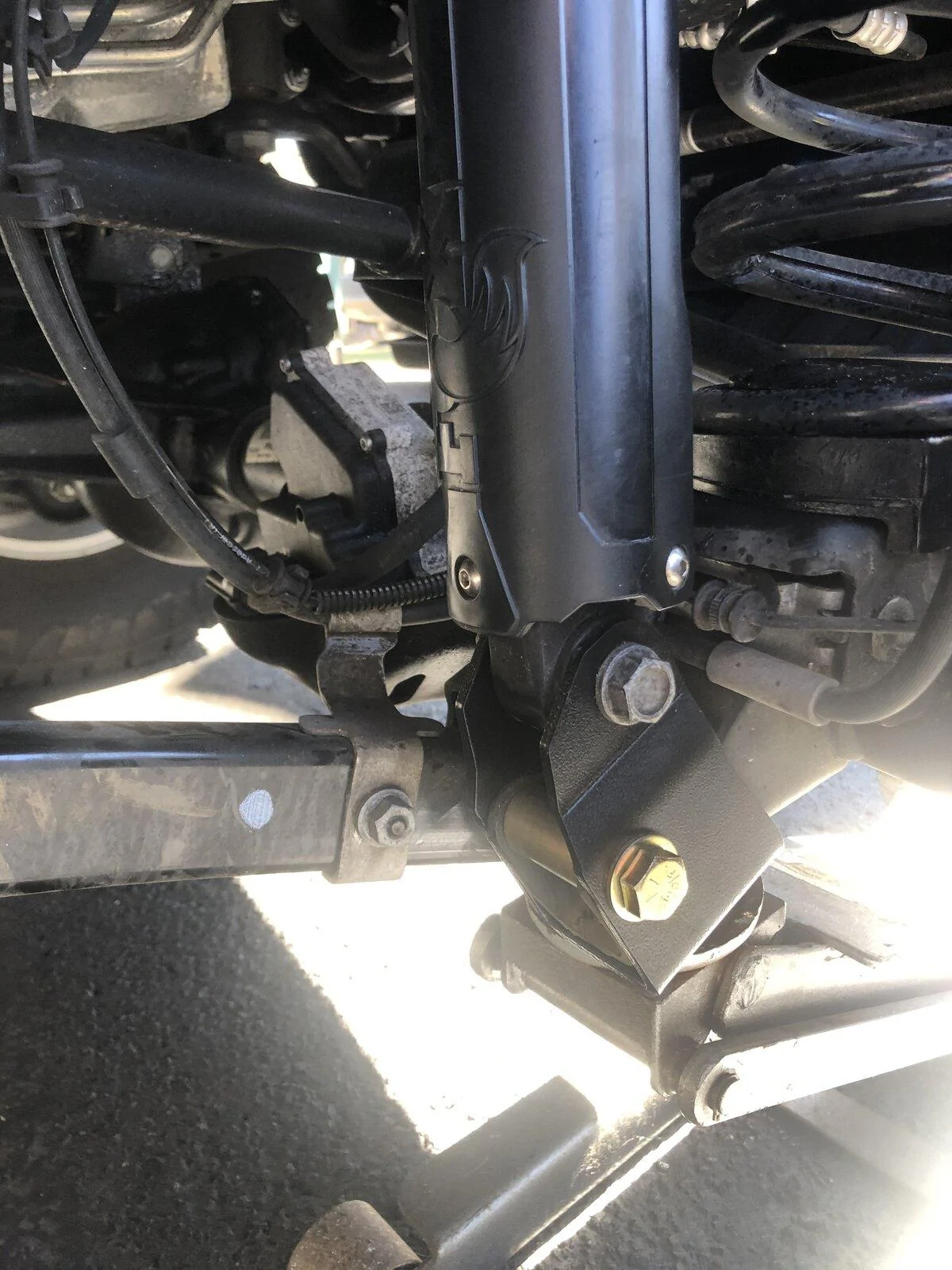

Finally got a around to installing Rubicon Express shock extensions and Daystar front lower spring correction pads. I have 340 and 343 front springs with Daystar 1.5” spacers, Rubicon shocks, sits about 2.5” higher than stock. The RE shock extensions are very nice quality, powder coated and cadmium hardware, bolted in no figment issues. Adds about 2” shock extension, highly recommend them.

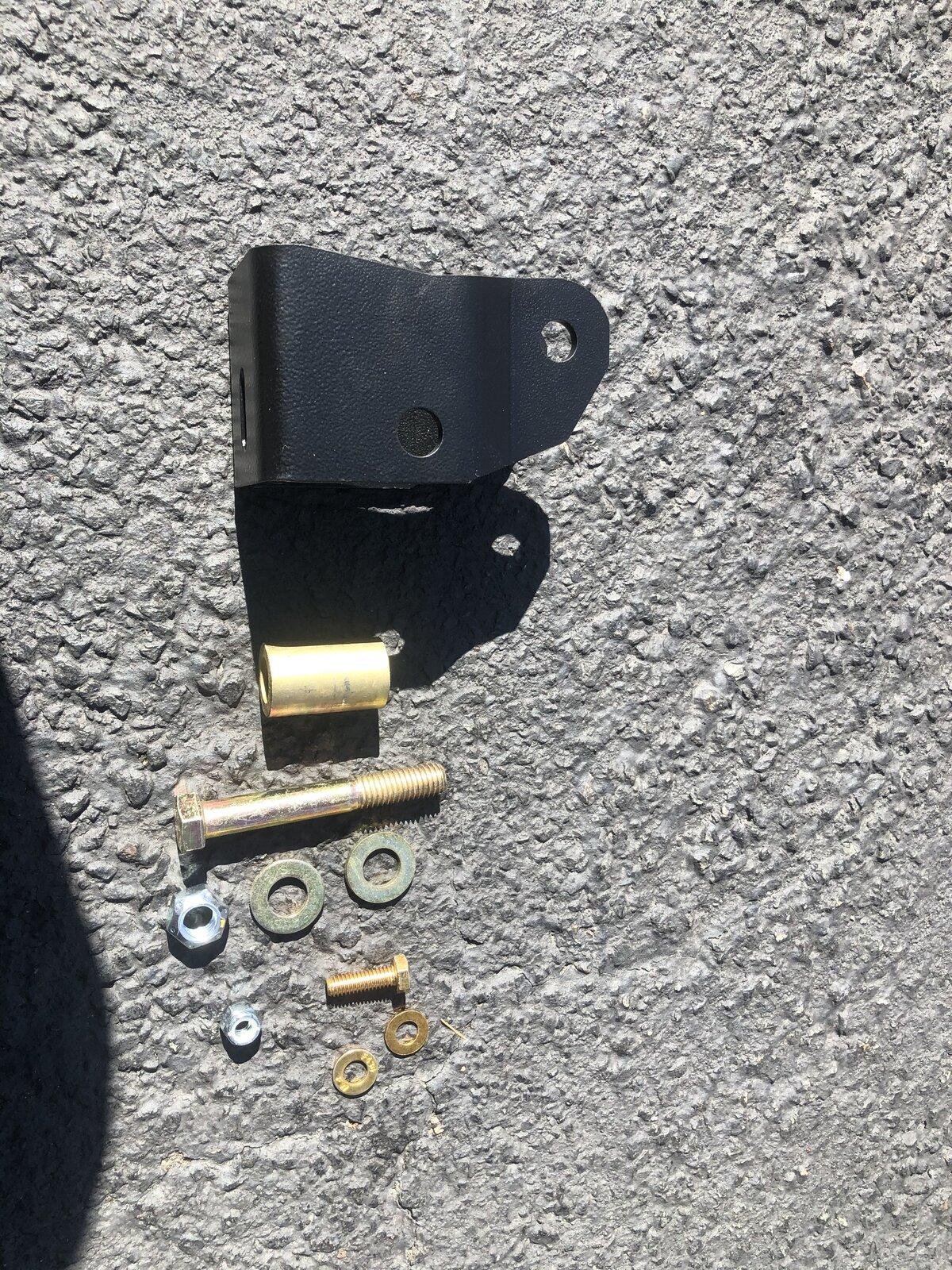

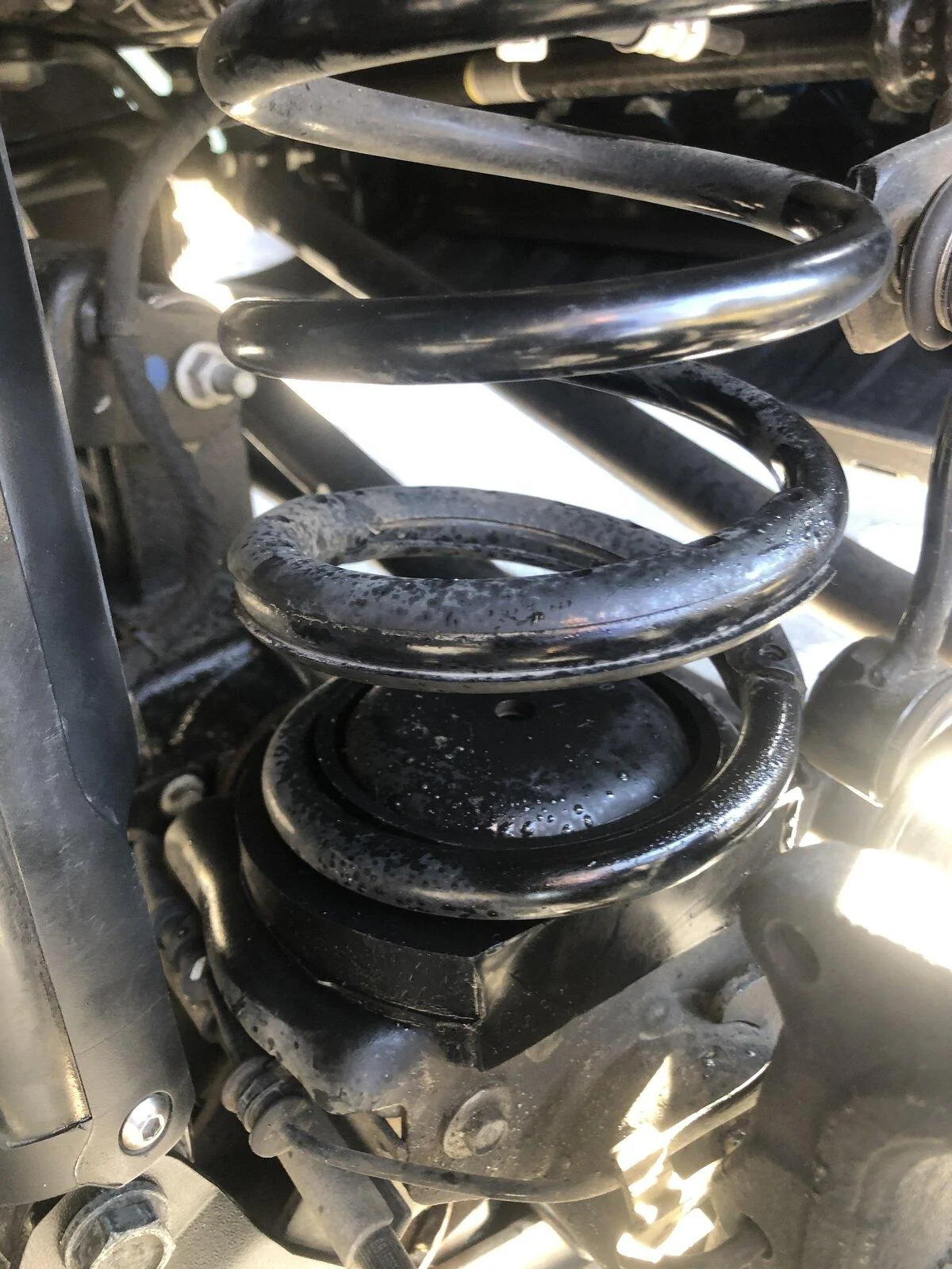

The Daystar correction pads seem pretty decent my oem ones where already a little distorted, my springs were not bowed out but figured they wouldn’t hurt. RE extensions were $50, Daystar pads were $30.
