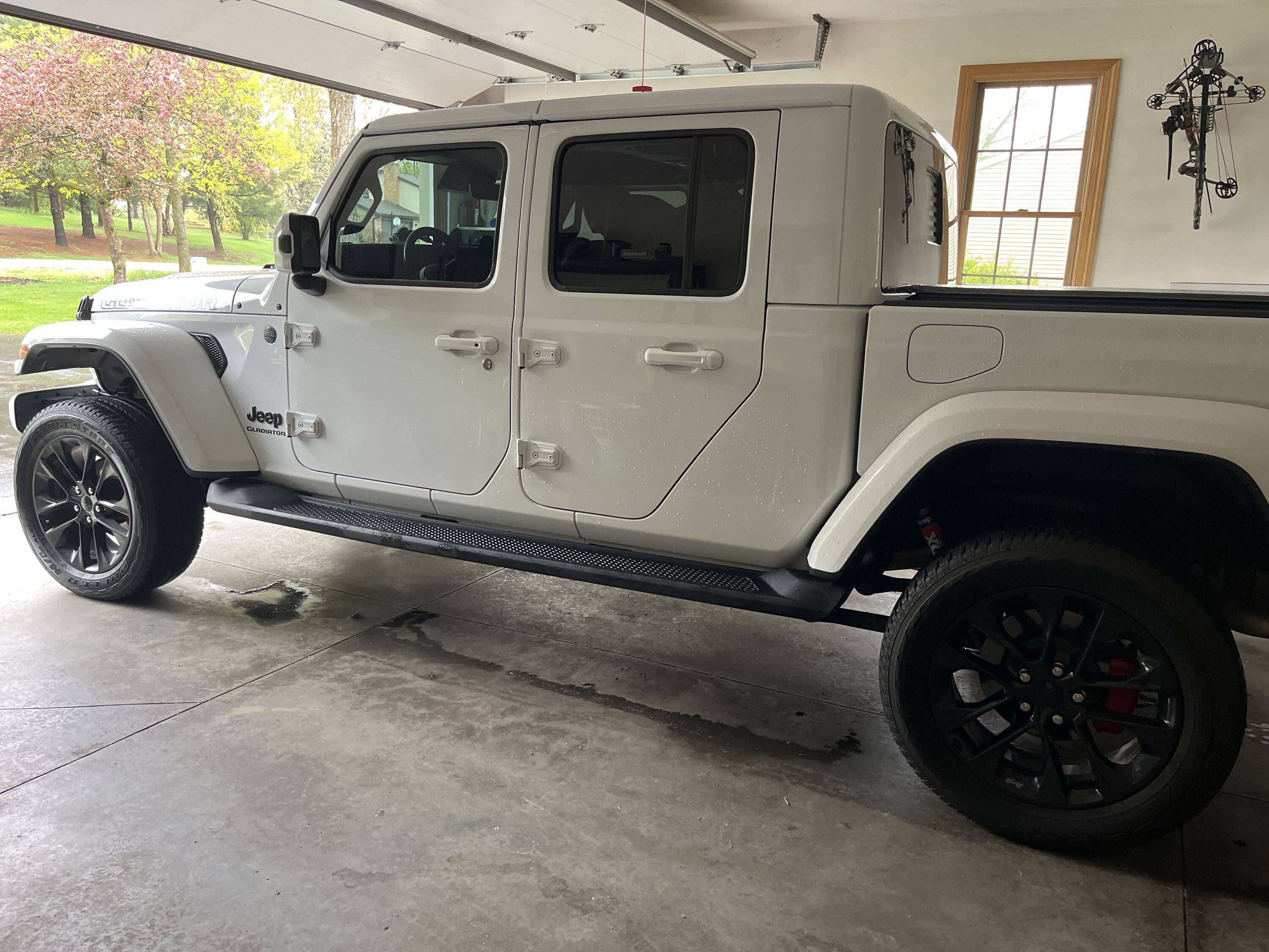

If you’re planning to tow after putting 37s on, first thing you’re going to need to do is re-gear! Think about starting to pedal up hill from a stop on high gear. Exact same thing. You will lose all your torque and power. i bought mine from a guy that had 36s on and wanted to tow his 6k ski boat and just didn’t think it had enough power. I think you’ll be pretty disappointed if you don’t do that first.
That said. I have a 2.5” rough country front and .75 spacer lift in the back. Has worked been great for me and retained the factory ride. Clearly you can see by the pic the 36s are off. Too much hwy driving….
Jeep Gladiator SkyJacker 2.50-Inch Metal Coil Spring Spacer Lift Kit with Shock Extensions image

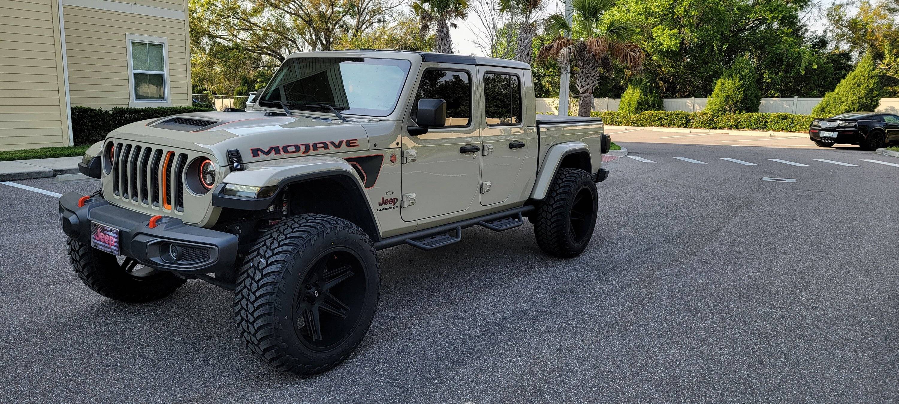

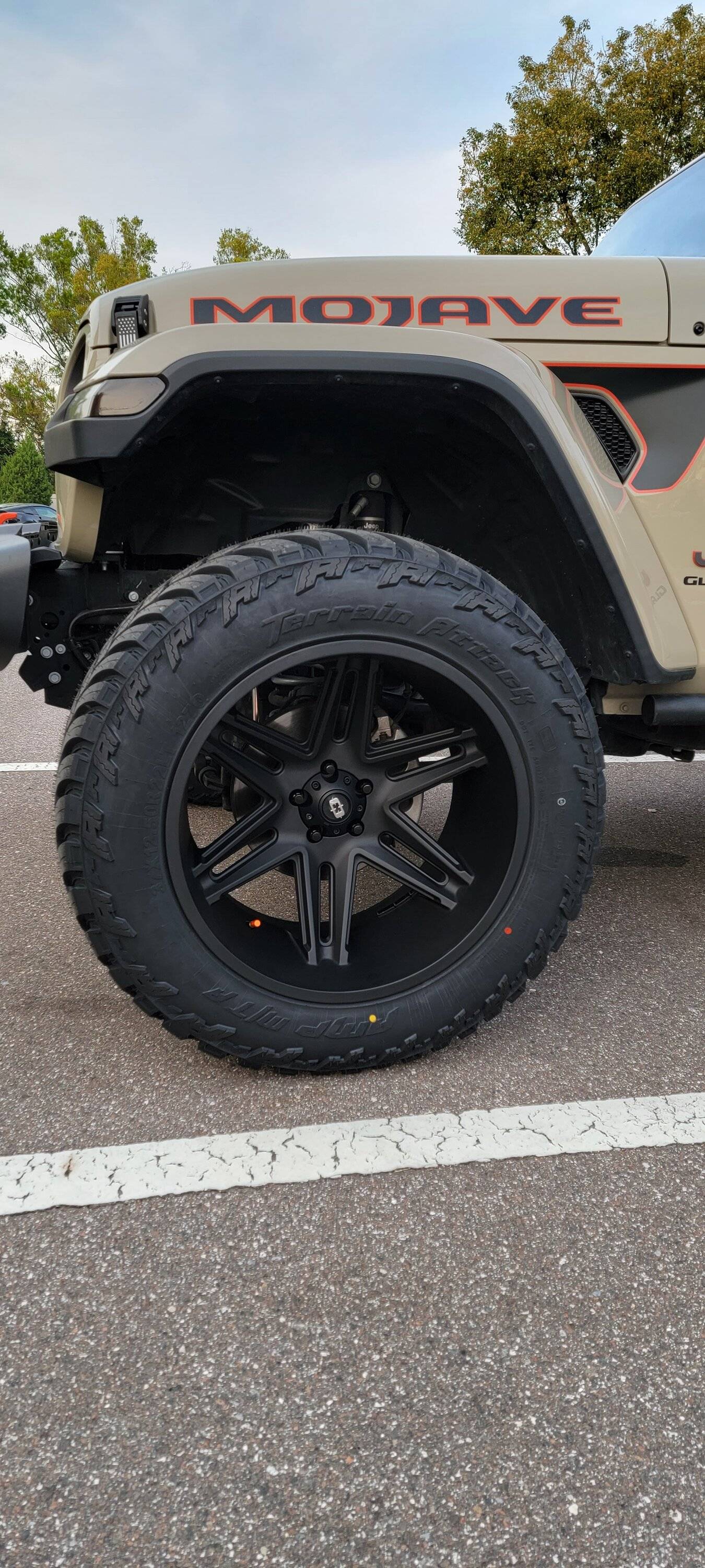

I have the 2.5" Skyjacker on my Mojave. Absolutely no complaints about the kit. Also added adjustable track bar and LCA brackets. Clearing 37's on 22x12s easily
Jeep Gladiator SkyJacker 2.50-Inch Metal Coil Spring Spacer Lift Kit with Shock Extensions 20230224_160736
Jeep Gladiator SkyJacker 2.50-Inch Metal Coil Spring Spacer Lift Kit with Shock Extensions 20230224_180300

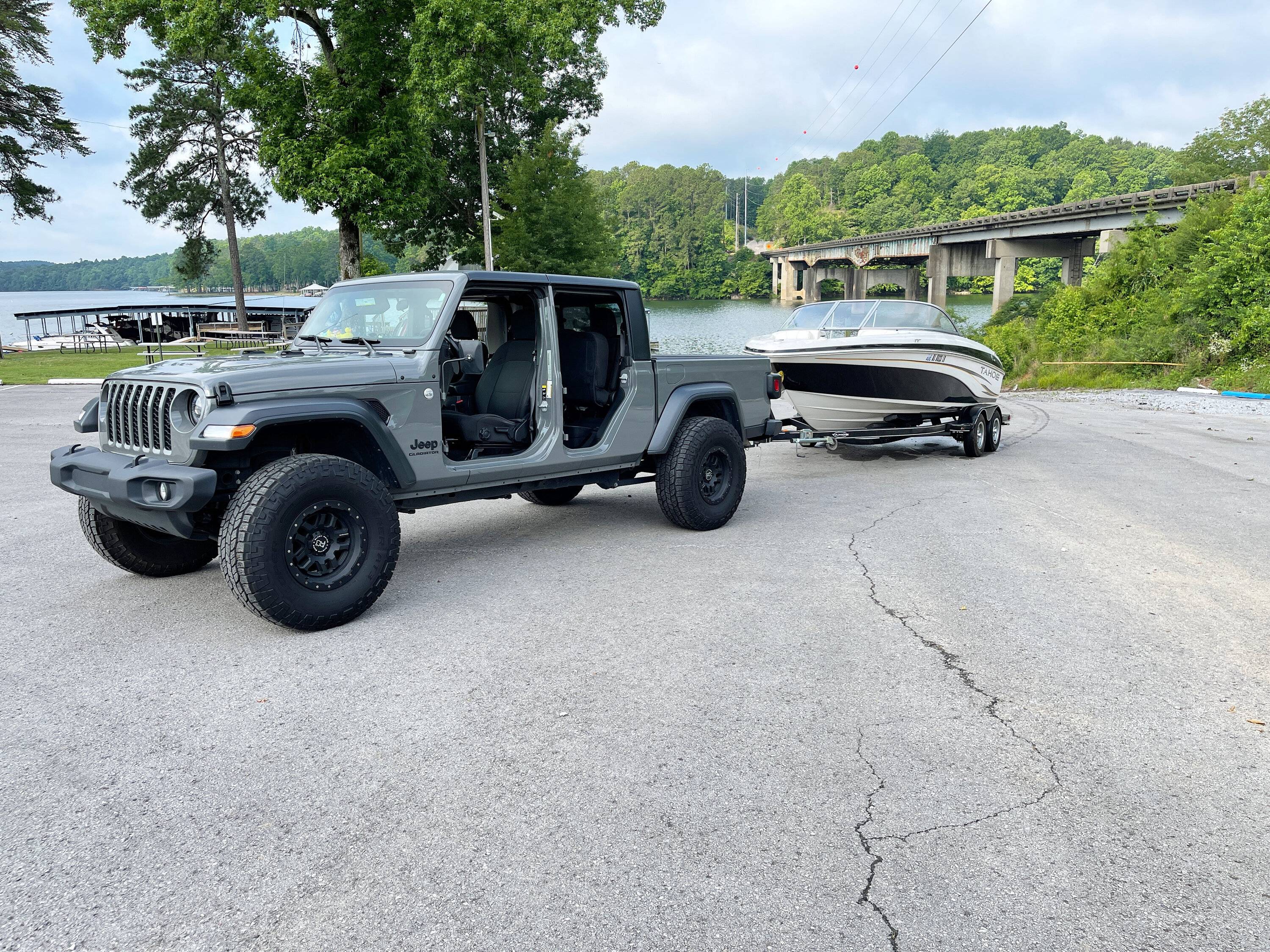

I think it just depends on expectations. I towed our boat with 37s and 3.73s and it did great! I have lightweight 37s though and 17” rims. I didn’t go on the interstate, but it did fine on highway. 60-65mph speeds.
Jeep Gladiator SkyJacker 2.50-Inch Metal Coil Spring Spacer Lift Kit with Shock Extensions 892578C1-6ED2-4FD6-9D37-C3C2E88111F8
I have the 2.5 skyjacker spring lift on mine. Could probably go higher with the 37s but that’s just preference. Not needed.
