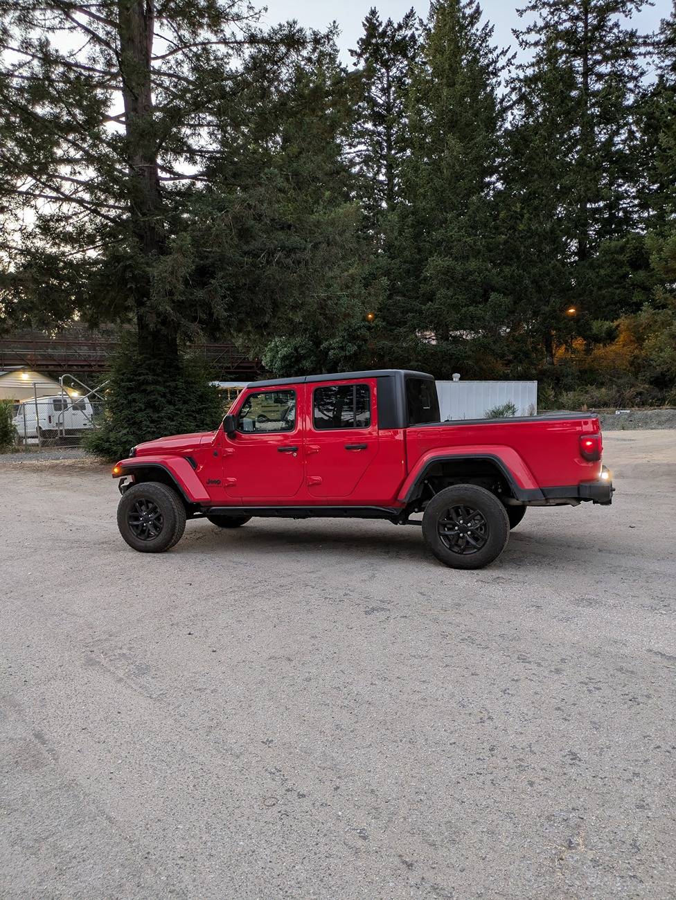

Good! Photo below. Rides great. Rake looks good. Glad to keep the rear max tow springs.
It's settled a little more flat since the photo

What do you mean?
The back settle a little lower and the front a little higher. That photo was on a downhill.
I'm very happy with the setup. The front isn't bottoming out. Even with the bump stop extensions
