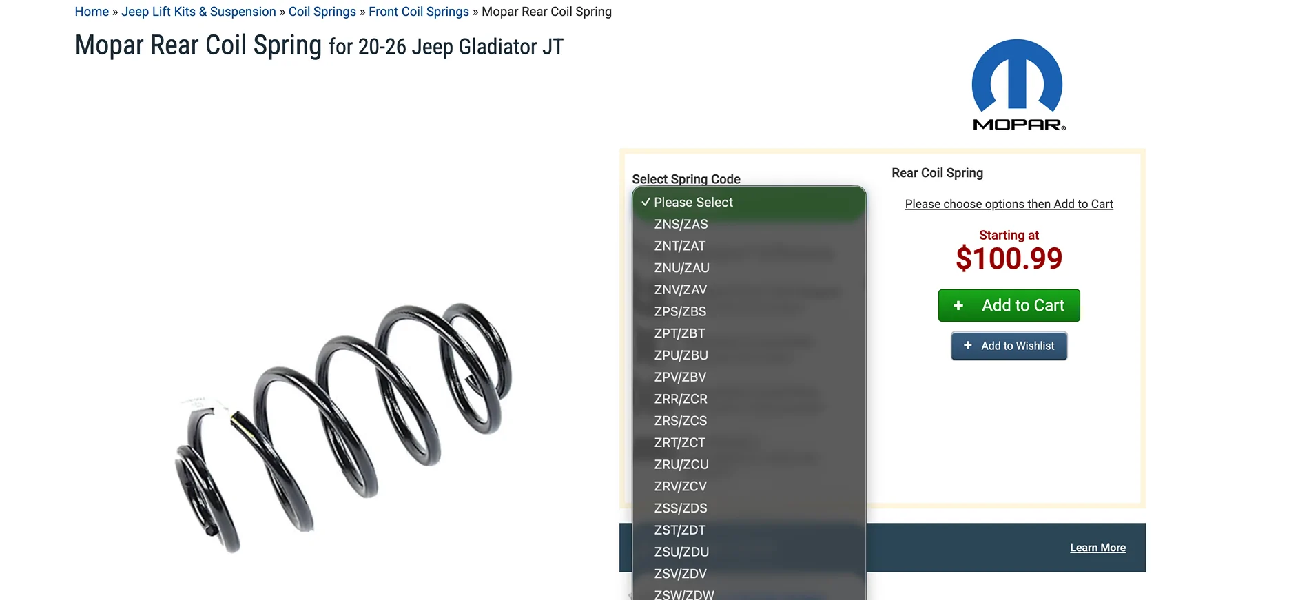

2. I've read some have swapped the Max Tow coils in the rear with good results. I've tried finding part numbers for these but it is vague. Quadratec sells Mopar rear coils but identifies then with a "spring code" which I've had no luck identifying. I've pasted a screenshot below regarding this.

Do you know the part number or spring codes for the max tow coils?

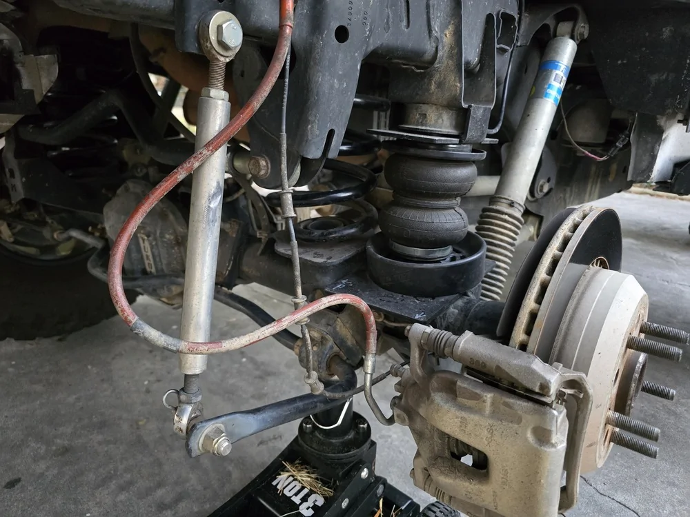

You could always install frame/axle air bags instead of in spring air bags. Just another option. I have no problem with articulation when wheeling. But then again, I didn't have articulation issues when I had the in spring air bags. They do cost more though.
