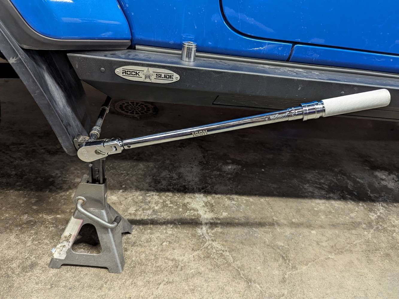

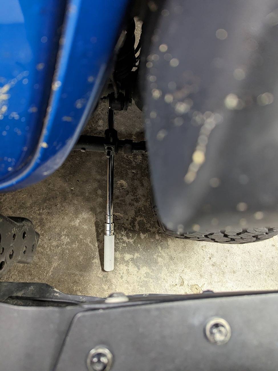

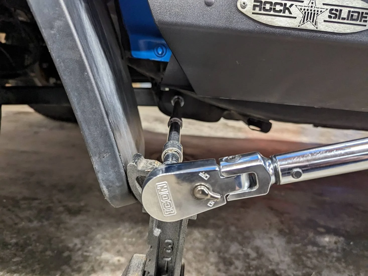

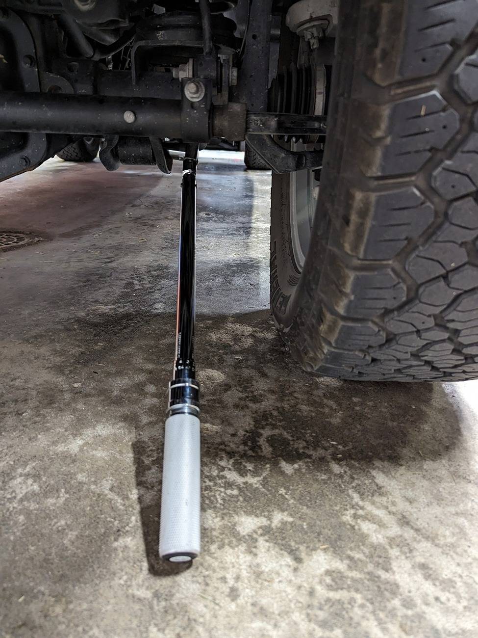

Use a floor jack to raise the torque wrench enough to click.
40,442
53,859
this works for the lower arm rear bolts -
Jeep Gladiator Re-torqueing control arms to specifications PXL_20230825_025230625
Jeep Gladiator Re-torqueing control arms to specifications PXL_20230825_025239429
And for the lower arm front bolts, I've had success with this -
Just reach in and pull up, or, push down, which-ever is necessary ->
Jeep Gladiator Re-torqueing control arms to specifications PXL_20230825_025428863
Jeep Gladiator Re-torqueing control arms to specifications PXL_20230825_025417550
It takes time and patience, but you can do the lowers without really being under the thing.
