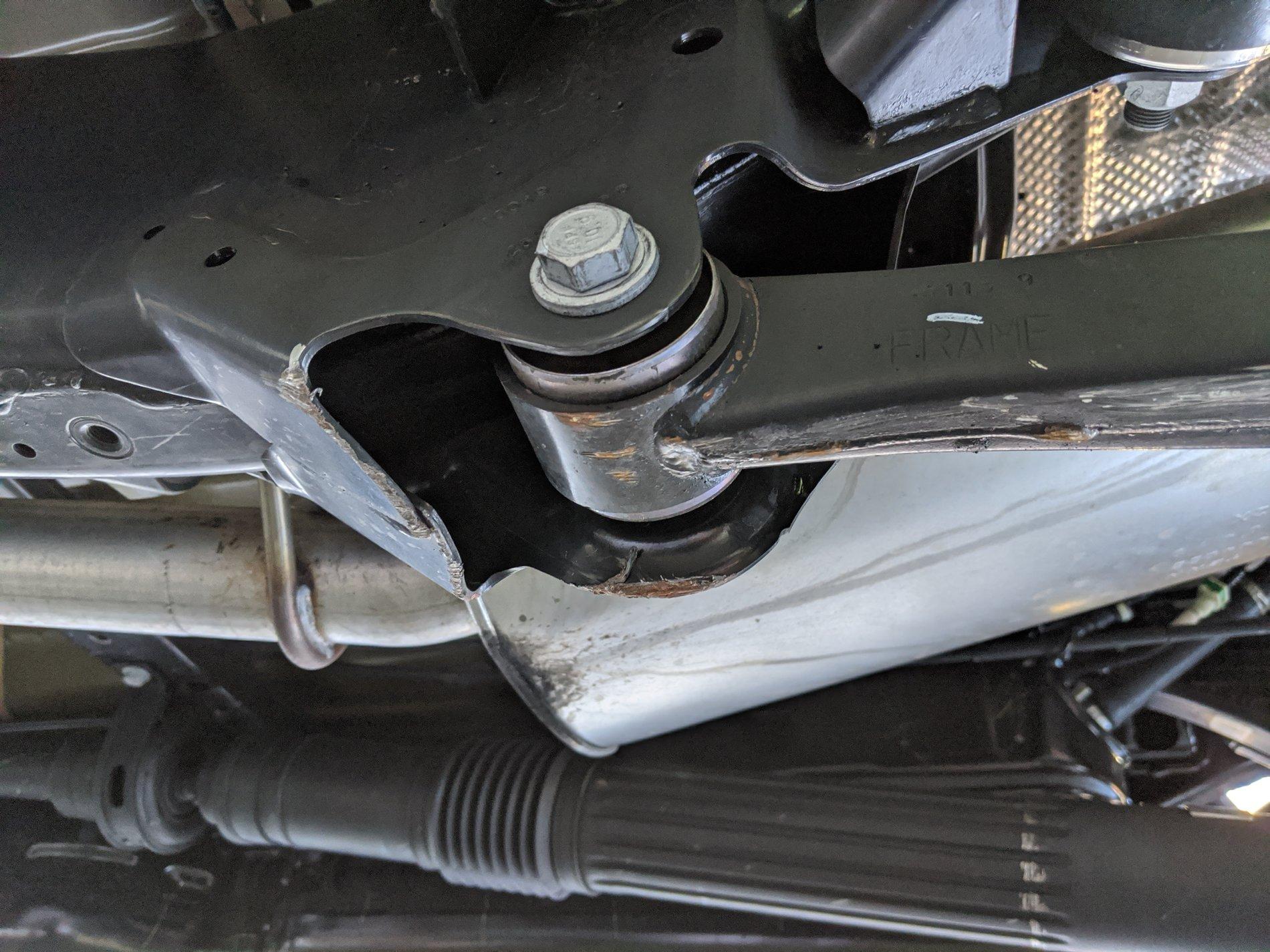

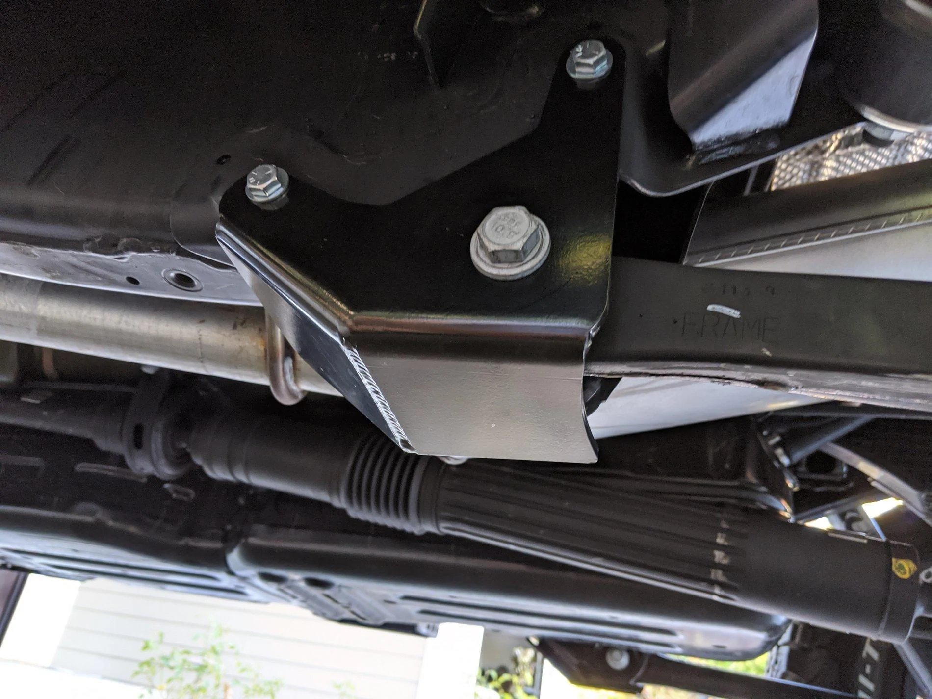

I got them online from Rusty's Off-Road. They don't come with any instructions but they are pretty easy to install, 15 minutes each side. There are already holes for the two smaller bolts, you need to pull the arm out of the way to install the first one. Also you don't need to get a wrench up behind there to tighten them, they way the nut fits on the back side it wedges it in place.

I did mine wheels on the ground. The CA stayed still on the first side, but moved slightly on the other side. Had to use a ratchet strap around the axle and forward to the frame to pull the axle back into alignment for the CA bolt. Still an easy job.

Use your wheel chocks to adjust the arm position. Way too much trouble using a ratchet strap. Arm too far away? Push to the front, chock the rear of the rear wheel. Arm too close? Push to the back, chock the front of the wheel. Takes <30 min.
