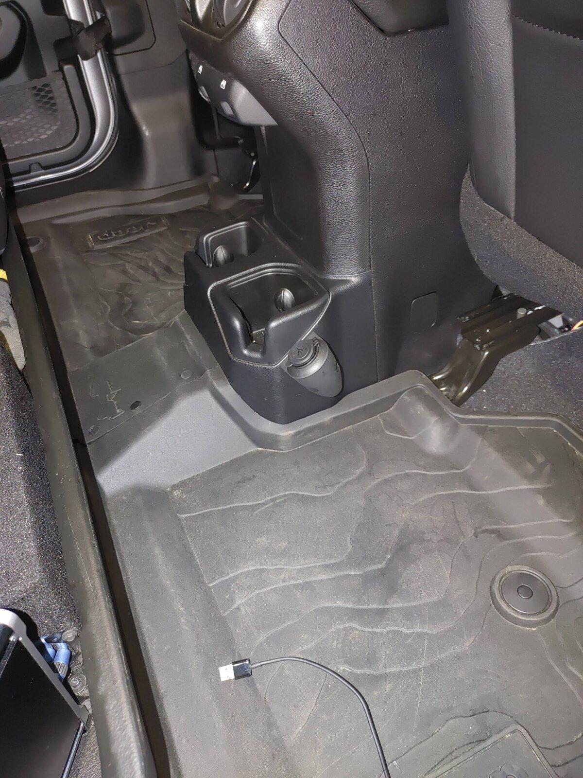

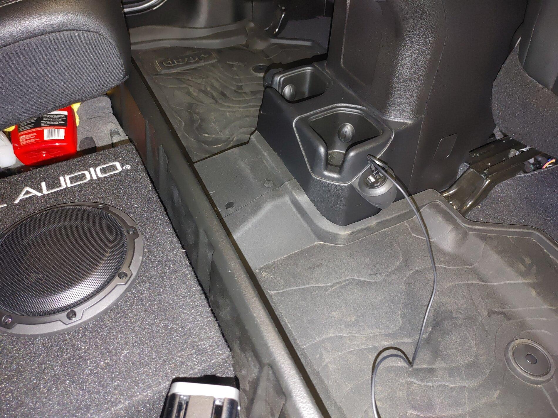

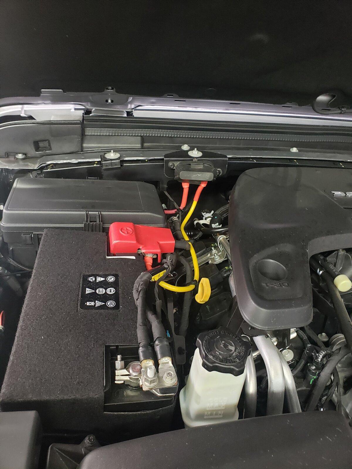

Under the batteries in the firewall, there is a place to pass through a fair size battery cable. It is easiest to access it through the fenderwell by partially or fully removing the passenger side liner. I ran a 4awg to under my back seat to use for many things like audio, charging, lighting, and whatever else comes up. For my charging circuits, for the kids. I added an 80 amp switched relay From stinger (amazon) and a Blue Sea fuse box. The switch signal comes from the aux panel wiring under the passenger side dash. ARB and other companies make the automotive sealed aux power pods, you can load with a number of DC chargers. I found some quick charge variants like the apple and samsung turbo chargers. They are not fancy and lighted but most things charge in 20 minites or less. Kids love them. Issue I have now is I need lighting. They cannot find them at night.
Exactly what I was looking for thanks. Where did you get the usb charger pod? Thanks
