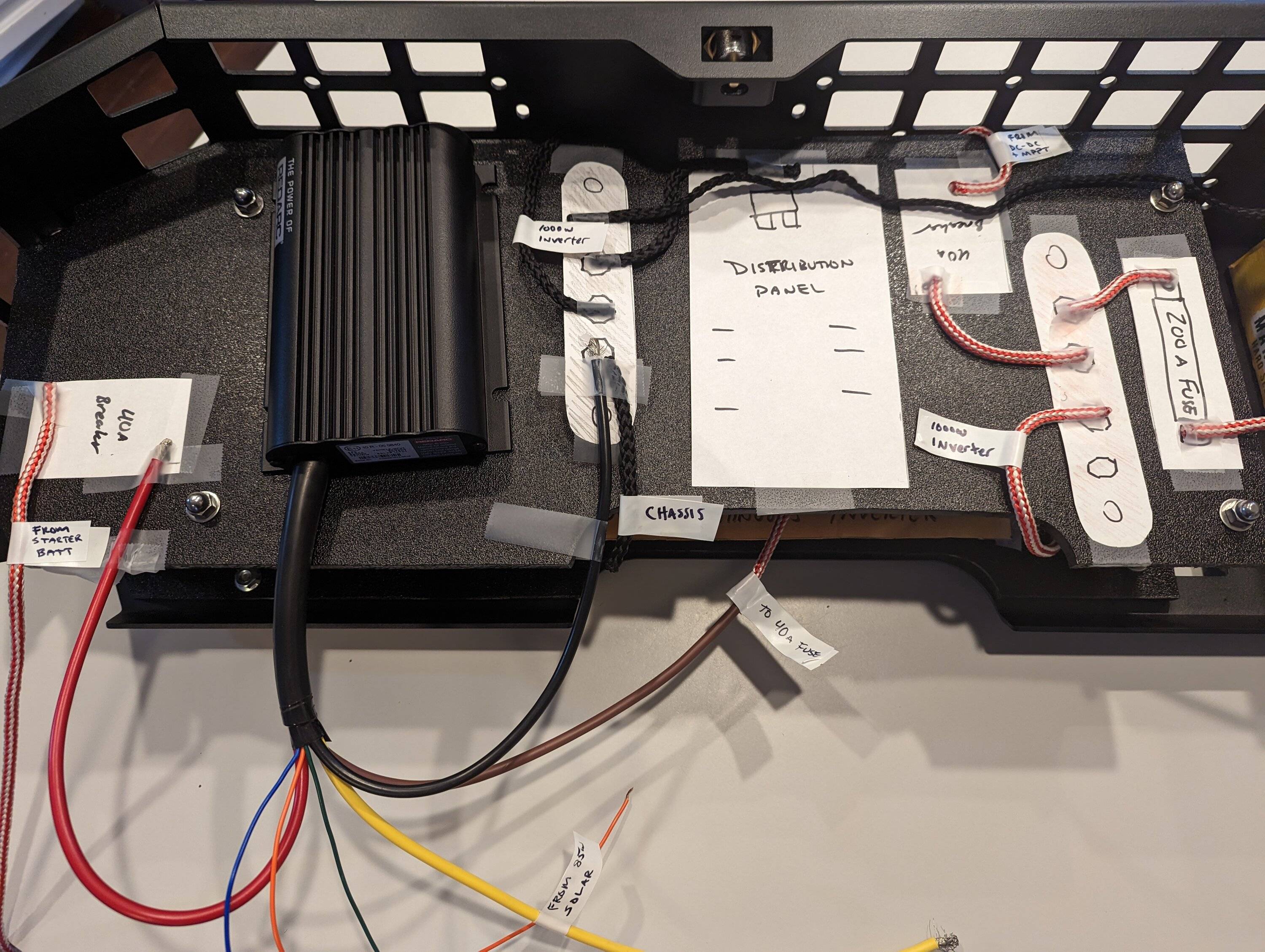

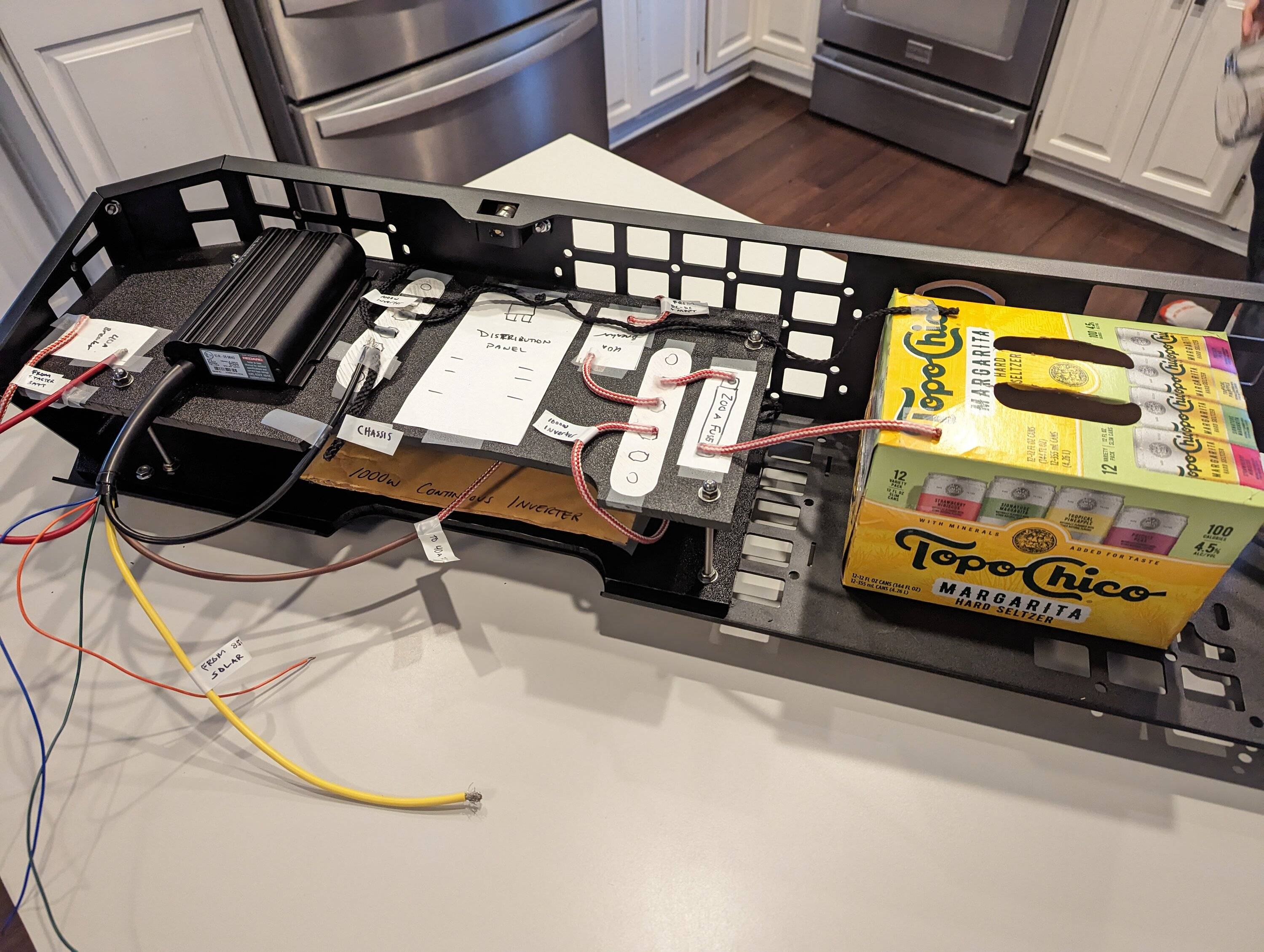

I'm hoping someone with more experience can chime in on my proposed setup. I have everything in the pictures ready to go in an Amazon cart (dimensions were an important factor due to limited space).
Jeep Gladiator Under rear seat electrical setup PXL_20230122_213908876.MP
Jeep Gladiator Under rear seat electrical setup PXL_20230122_213829285
Overview/planned equipment:
-JCR underseat storage (Molle cut outs should provide airflow)
- Redarc BCDC1225D
- 12v 100ah LiFePO4 Battery (the one ordered will fit, the TopoChico box is a placeholder)
- Renogy 1000w continuous / 2000w peak pure sine wave inverter with eco mode
- 6 circuit sub panel for expansion
- pos/neg busbars with 3/8" studs
- 2x 40A 12v breakers
- 1x 200A mega fuse
Not pictured or represented:
- 85w Cascadia4x4 Solar Panel fixed to hood
- Starlink mounted in a flat starmount powered by a POE injector using a 12v-48v step up transformer (none pictured)
- mofi 4500 mobile router
I'm hoping if my setup looks correct then I can dive into wire sizes.
Any and all feedback, comments, corrections, etc is appreciated!
Edit: I realized I forgot a "wire" (rope) connecting the sub panel to the positive bus bar but that is part of the plan as well.

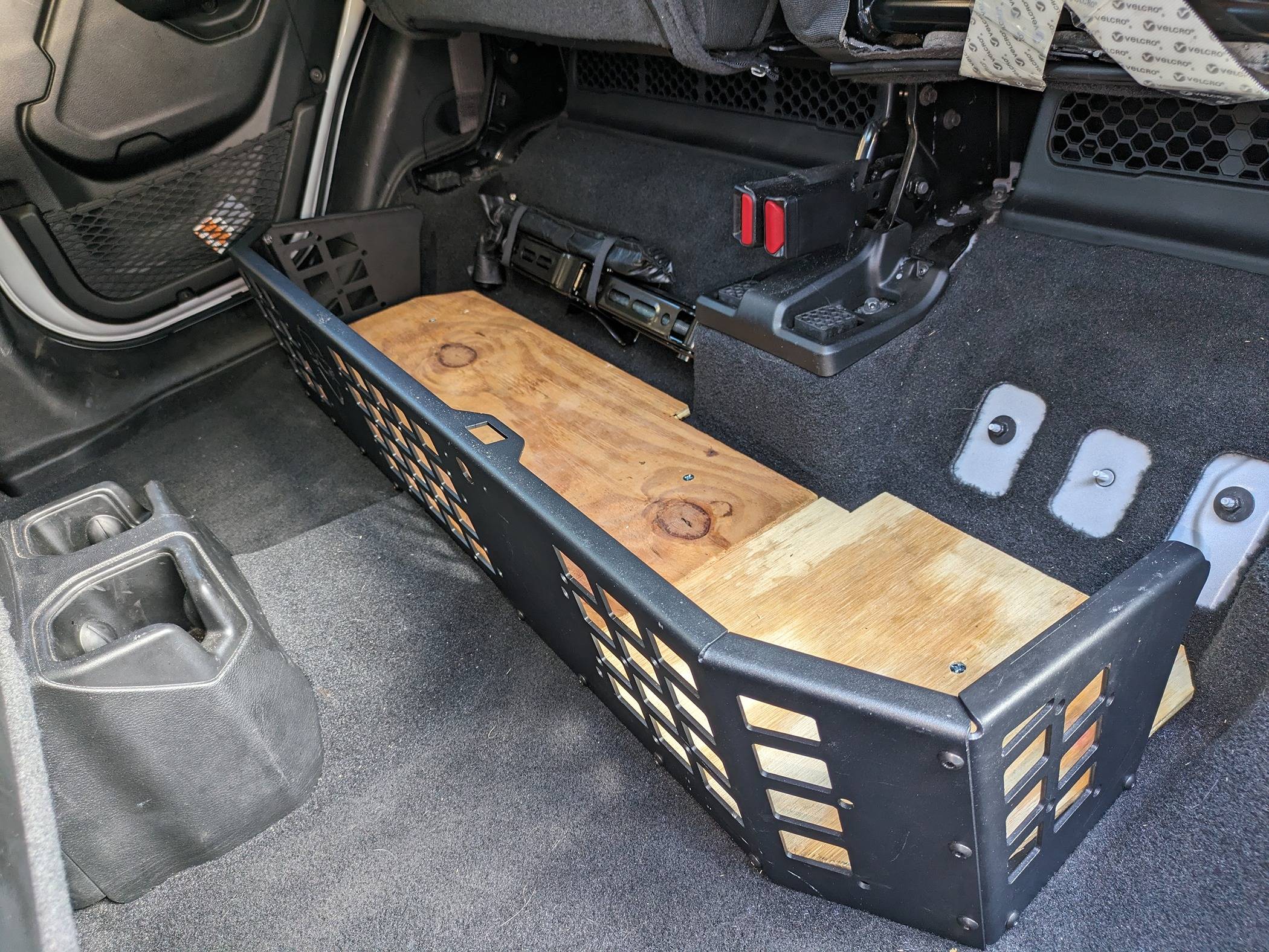

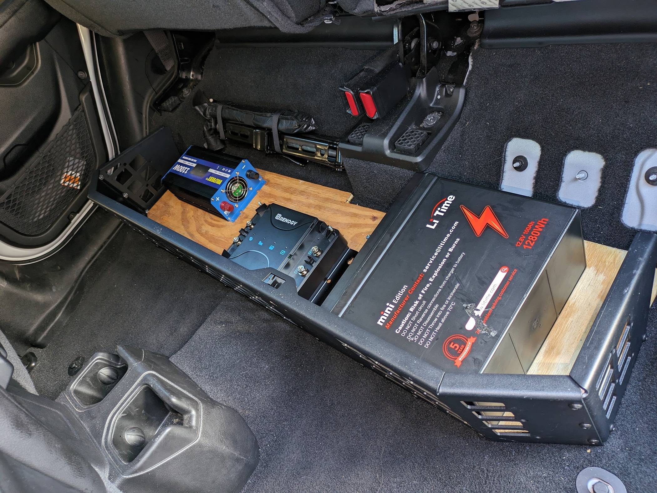

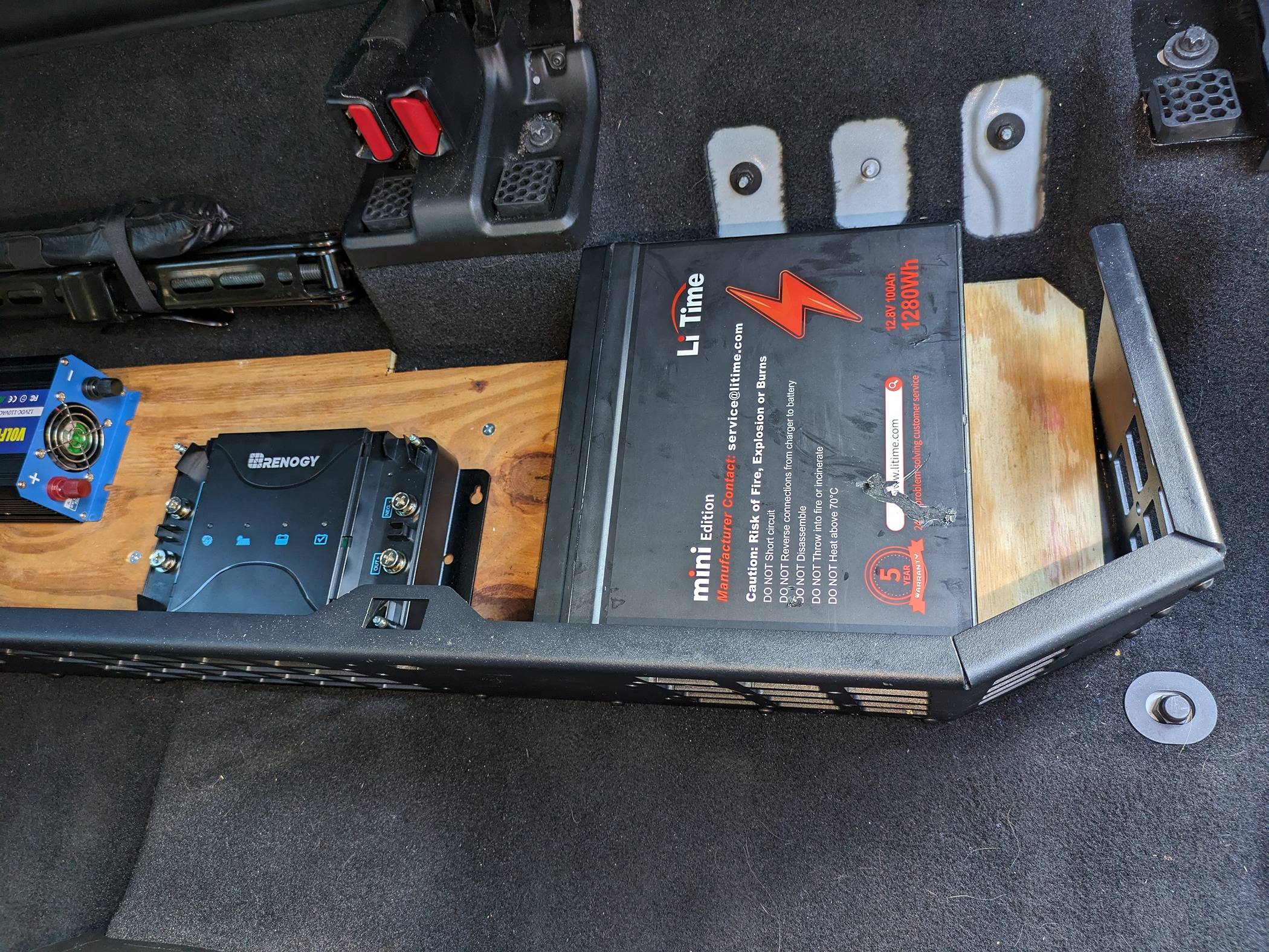

Yes, I think I have all the pieces and this is going to work. Here are a couple of in progress pics with the main components. The LiTime Mini will fit under the seat. I used the JCR Underseat Storage Molle and made a couple minor mods to pull it towards the front of the vehicle creating just a little extra room for the battery and other components.
Once I get it complete I will send out the pics and component list with some results.
I plan to mount 2 - 100 watt solar panels to the roof to feed the charge controller and then run any and all accessories off the 100amp house battery. I may or may not connect the system to the vehicles main battery. I'm not sure and want to do some experimenting. Stay tuned.
