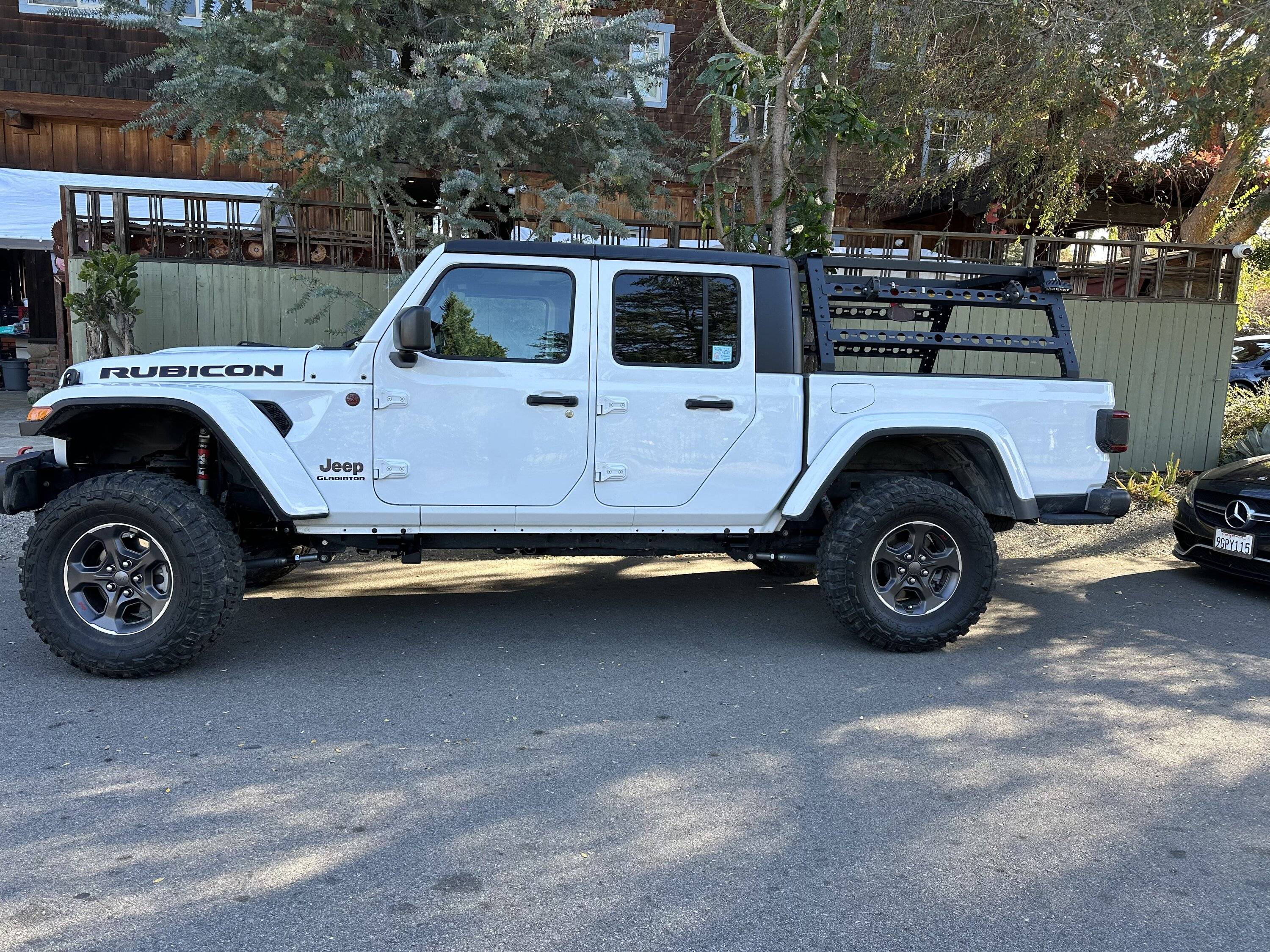

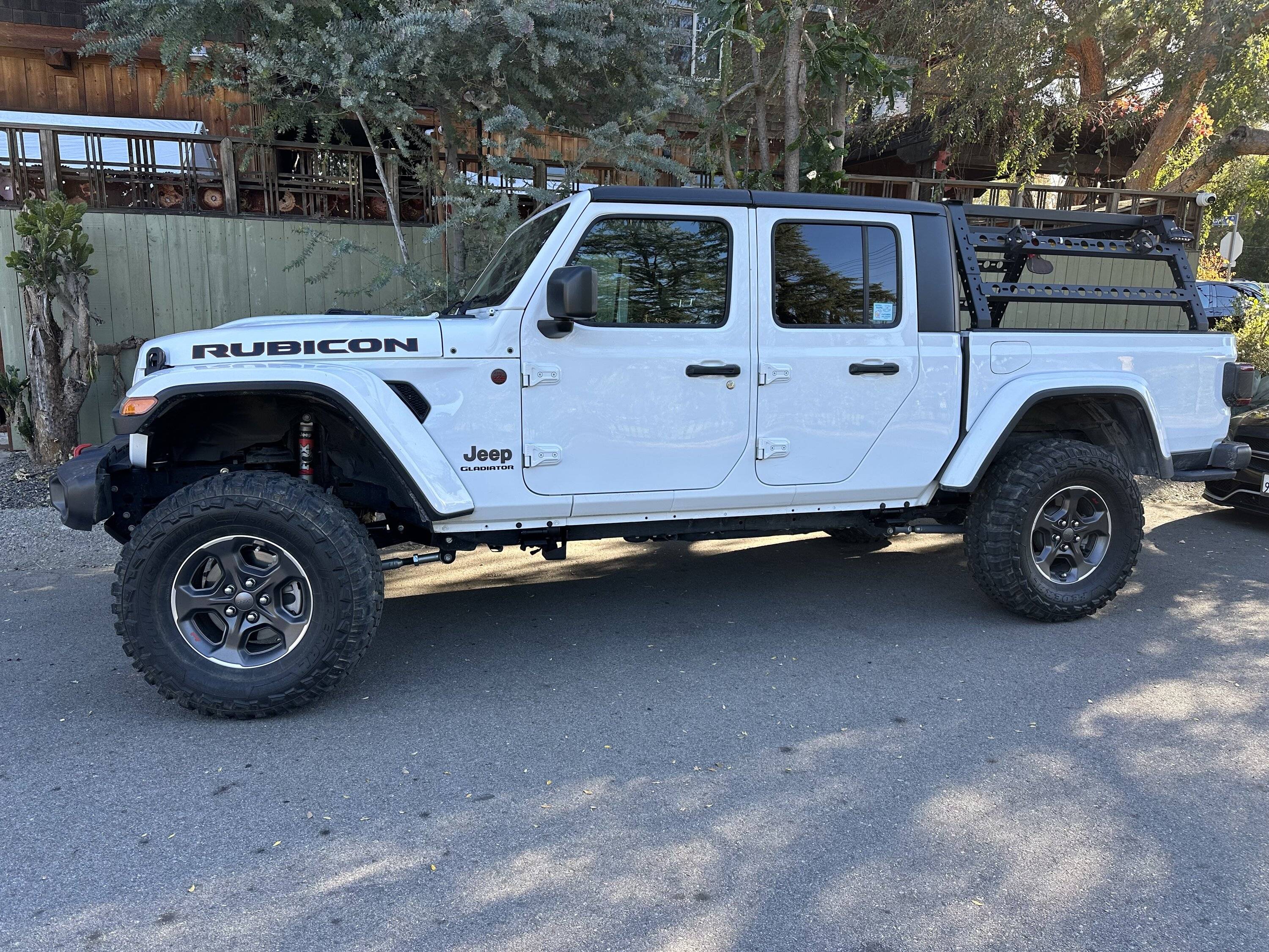

Are you stock height in the front, or on 40” tires? There’s like zero room for flex in the front based on this picture. On 37s I have 8.5” fender to tire in the front on 4.5” lift. In the rear I have the same 8.5” fender to tire on 3” lift. I tow a light small bass boat so I don’t need the rake like you do. Maybe the photo angle?
Plenty of room for flex. The pic is deceiving I suppose.

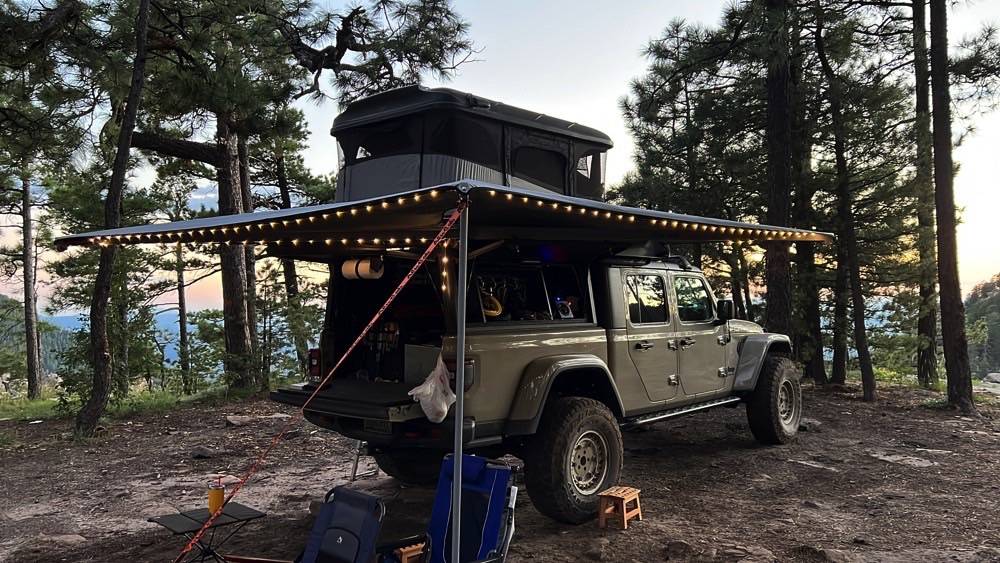

I have the Evo HD 4.5in springs. After reaching out to them they told me the spring rate was the same as the plush but the spring itself was longer. For $300 I just took the gamble and I am happy with them. I have about 400lbs with cap and decked system and it is a very pleasant ride. I had rock crawler 4.5 springs before and the ride is close to the same but I gained some lost height in back.

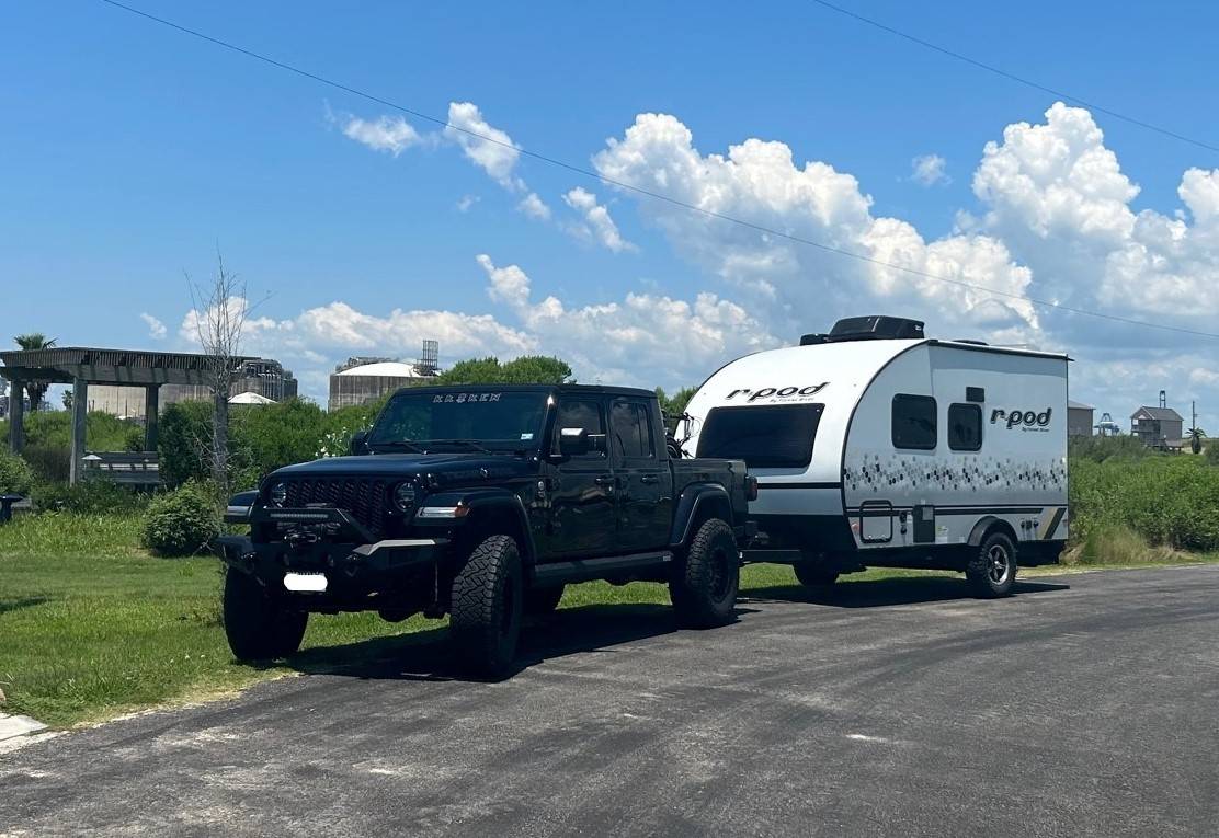

Finally got the rear Clayton 3.5” springs in the rear along with the Fox 2.0’s ride is night and day! I also added the airbags but haven’t run the air lines yet. I also added an aftermarket Mopartype front bumper with Warn VR winch and it gets it “almost level” Not sure how level the bags will keep it once there is a decent load in it…
