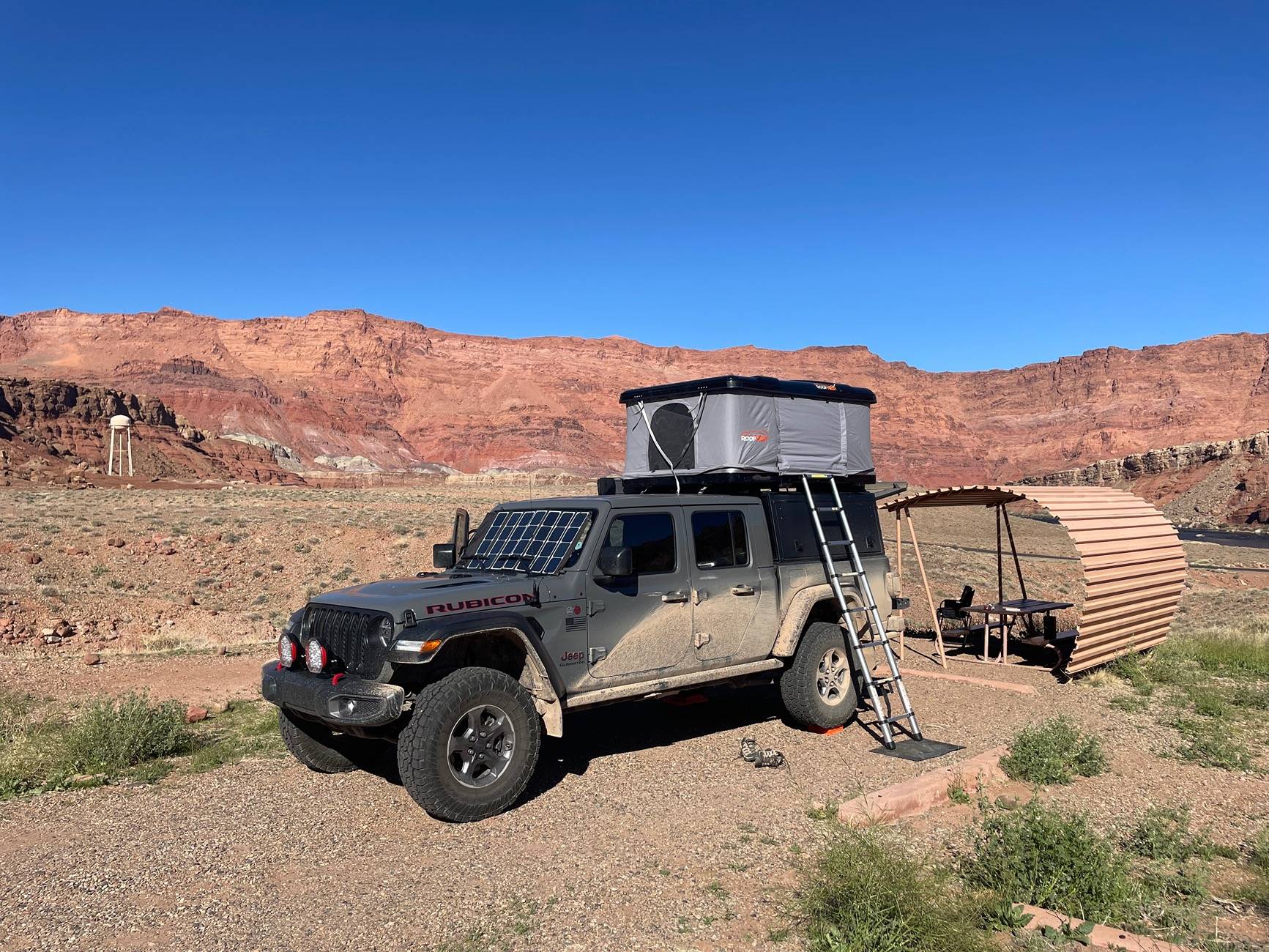

I have the AEV kit and could not be happier. I have the Alu Cab canopy and a full set of drawers every day. Then when overlanding I have a RTT, Fridge, grill, 270 awning, food, water etc and it still rides great. Even my wife commented on how nice the ride is over the stock Rubicon.
Jeep Gladiator New Camper need new rear spring suggestions IMG_6991

Which AEV KIt do you have?

Thanks! Did you consider the higher capacity springs? Curious as to why you selected the standard capacity springs.
I still have my stock suspension with an AluCab and will likely upgrade once I build out my rig a bit more. I'm still reviewing options.
Thanks again.
I did consider the higher capacity springs but I didn’t feel I needed them and I’m glad I chose the one I have.

Do you know how much lift you got out of it was 2.5” like they advertise or more?
It was slightly more when driving around daily but about as said when fully loaded. It is a perfect match with 35 in tires IMHO.
