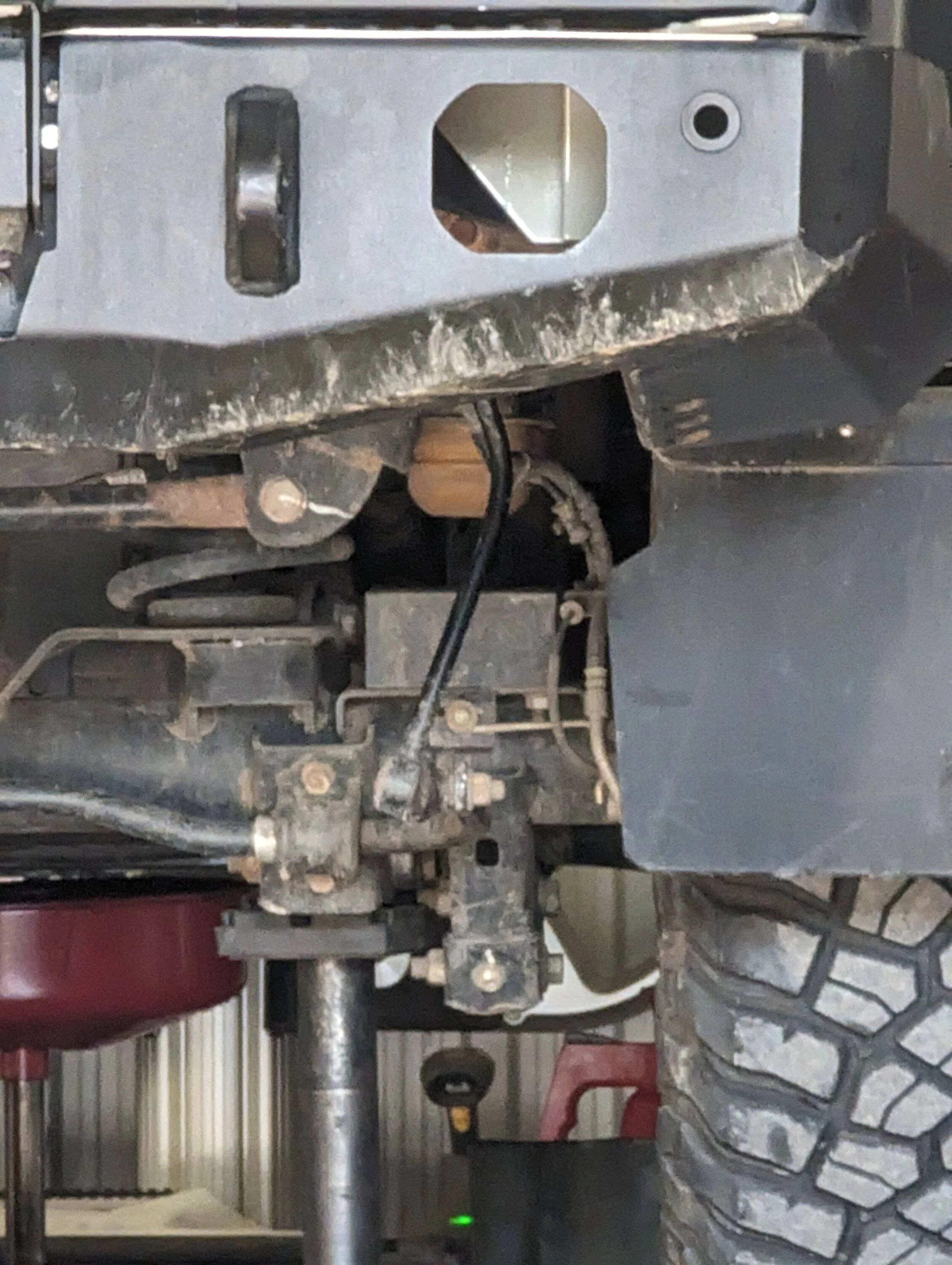

What had to happen, happened. The swaybar link brackets are shearing off the frame. I'm looking for input on either swaybar relocation kits. From what info I was able to find, the standard antirock and the teraflex give a similar ride to the factory swaybar. Does anyone have the heavier 1 1/8 inch antirock? Is it worth twice the price of the teraflex? I've got a canopy and heavy rear bumper with tire carrier plus all the camping gear. Looking at pro's and cons, antirock is Bolt on while teraflex needs holes drilled in the frame. Also will the rokblokz mudflaps still fit with either swaybar?

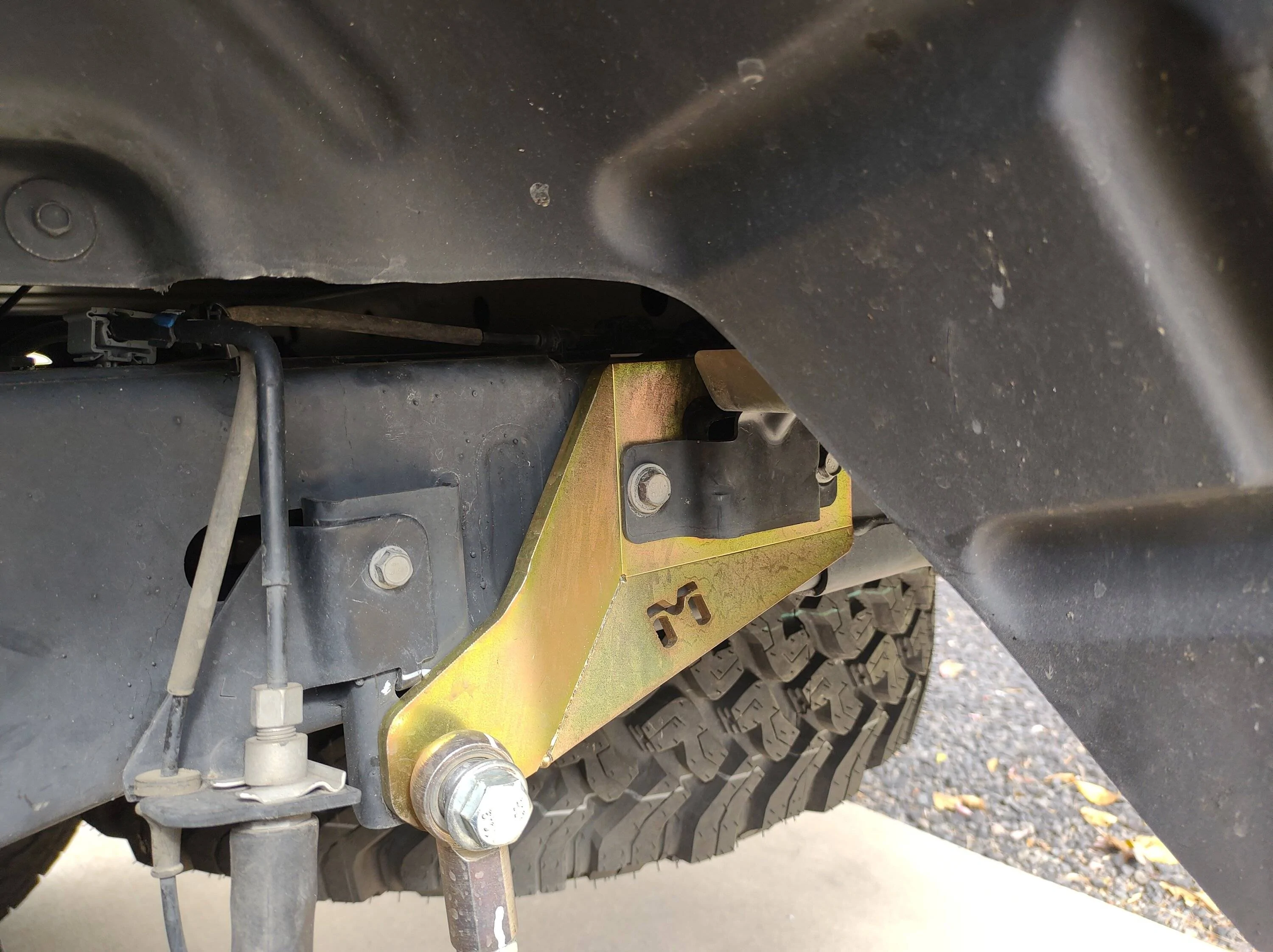

Could always go with the metalcloak brackets to help support the broken ones(breaking) I ended up going Hellwig. No complaints so far.

I thought about it, but it seems more of a bandaid. It won't prevent bent swaybar links
