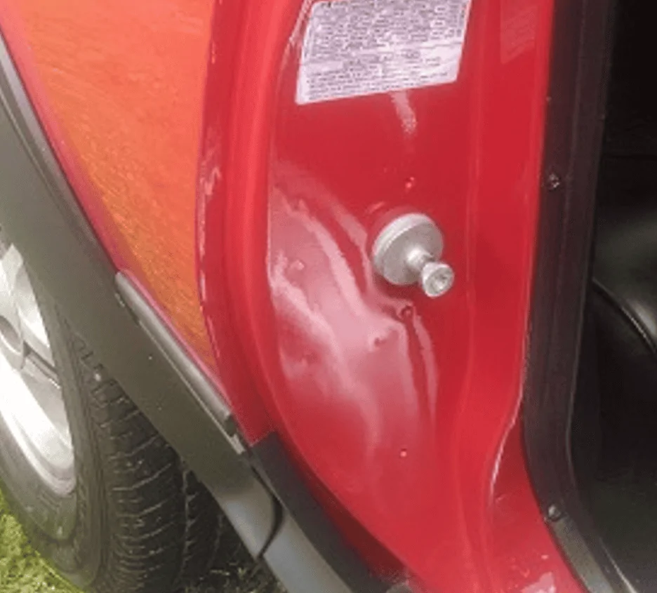

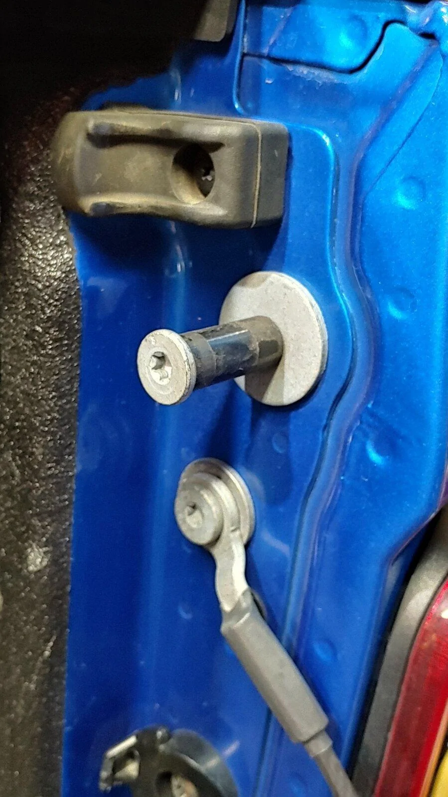

For those who have mis-aligned tailgates when closed, there are ways to adjust unless I'm mistaken.
These used latches almost identical to latches used in my cars, and they use strikers as well, just like cars. The striker can normally be loosened and adjusted in any direction - in, out, up, down, in and down, in and up, diagonally, whatever is needed. The hole these go through is much larger than the threaded base of the striker if my hunch is correct.

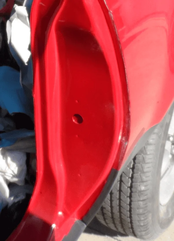

Chances are the hole for this striker is like this: over-sized with a thick threaded plate behind the sheet metal that can move around -
Jeep Gladiator Rear tailgate closure 1649375810782
Same concept - adjust the striker to make the tailgate be farther in or out when latched.
Jeep Gladiator Rear tailgate closure 1649376570440
Loosen the striker - just enough to move it around where you need it, tighten it and try the tailgate again.........

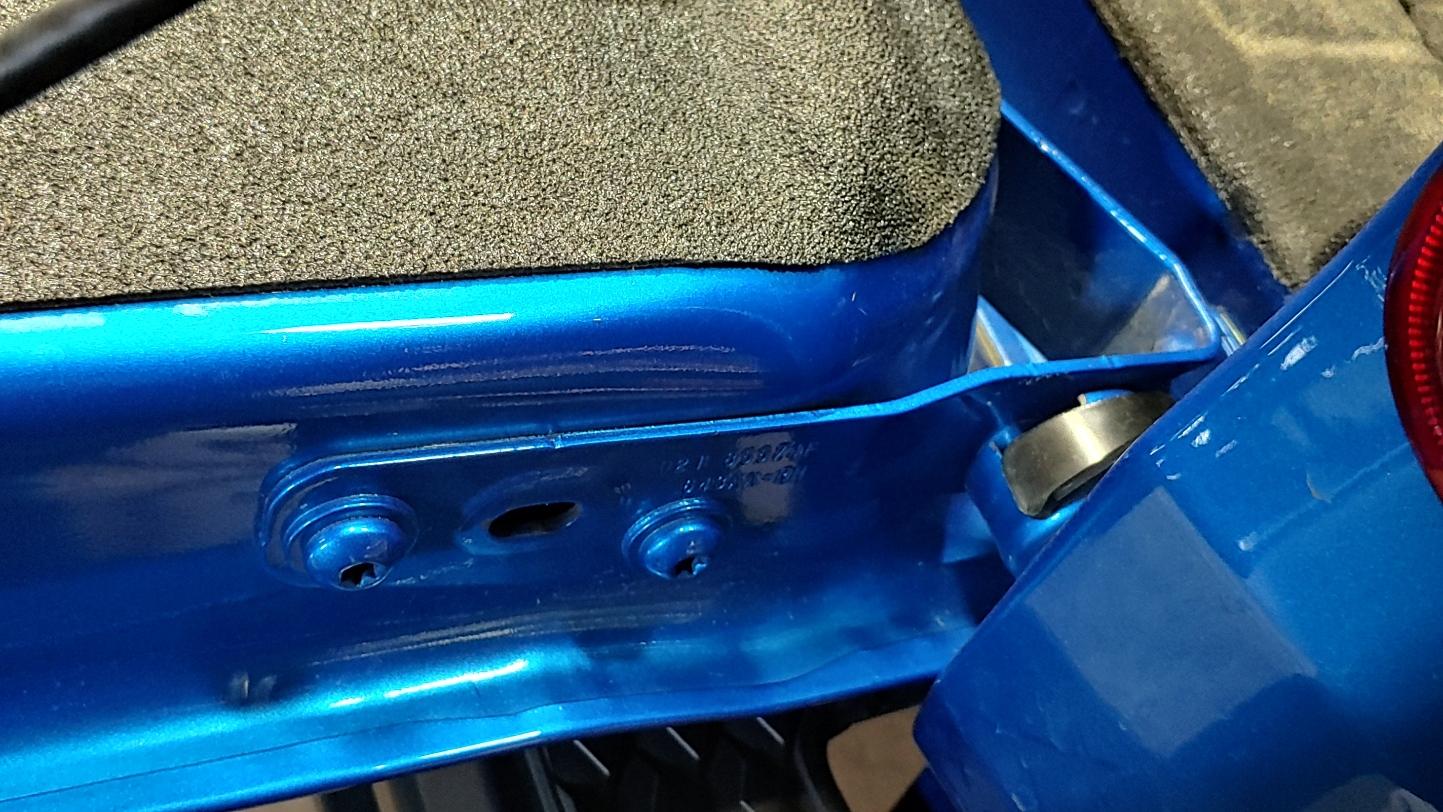

I also believe the lower hinge area is adjustable. There has to be ways to adjust things at the factory to account for tolerances. I have not taken mine loose as it's just a perfect fit I won't mess with it, but I have adjusted many doors, hoods, trunks and hatchbacks over the years and the concept is the same. They can't build these with a small hole and where nothing adjusts, it's just not possible (exception - Fords**)

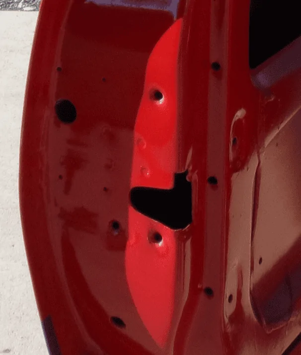

The latch itself can't be moved- in cars or Jeeps. That's why I said the striker would be moved for adjustment. The latches are held in place in many cars with countersunk screws to hold them from shifting. (I put NOS latches in this car after painting it)
The screws sit in the tapered holes preventing the latch from shifting at all. The tailgate latch on Jeeps is very much like these.
