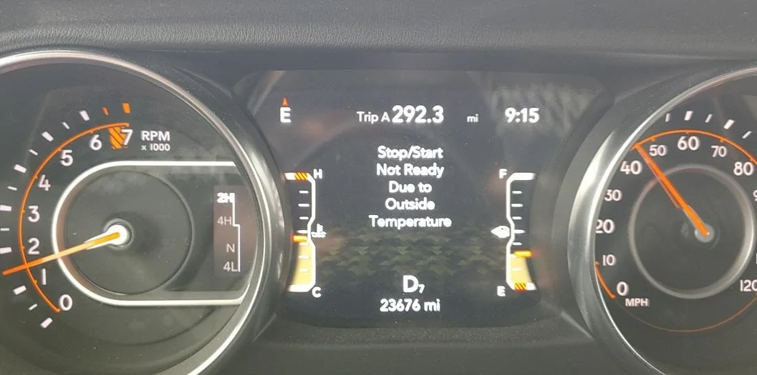

Hmmm… now that it has been mentioned. My Auto start/stop says not ready, cabin heating or cooling. Turn off A/C it say outside temp too high? I do live in AZ at 100+ this month… should either matter???

If climate is set to auto, stop start will show that message.
Pretty much, you’ve set the temp to a certain point and the Jeep can’t get there or maintain it if the engine shuts off, so start stop gets cancelled.

............. only if it hasn't met your cooling or heating setting. I leave mine on auto year around and my ESS works when it reaches my temp setting.
In AZ with the extreme heat is where the problem is.
We've been in an extreme heat thing for the last 2-3 months here - way above normal, temps in the 90s most days and ESS still works once it reaches my temp setting. It doesn't work as often when it's in the mid to upper 90s, but it works.
When it's 96 here and I have the inside temp set to 69 for example, ESS will work after it reaches my 69 setting -
- but if it gets warmer, then I will get this.........

ESS works with AC on.
People keep saying "if your AC is on it won't work" and that's wrong. AC on ESS WILL WORK - if it reaches your temperature setting.
If AC is set to MAX, it won't work. That's in the book about that.
If AC is on in AUTO mode, it will work - if it has reached your desired temperature setting inside.
If AC is struggling to meet your selected temperature either in auto mode or straight AC mode, then ESS won't work until your set temperature is reached.
If the outside temp is over a certain temperature - something like 98 or so, you'll get the message I posted above.

To elaborate - auto or straight AC are exactly the same - if it has reached your desired temperature setting, say you have it set to 69, once it hits 69 in the cabin, EVEN IF IN AUTO MODE, ESS will work.
Auto mode in HVAC has no bearing on ESS working or not.
That’s what I was trying to say with reach or maintain, but as usual, you but it much better!
Your a Guru!!! Thank you!
