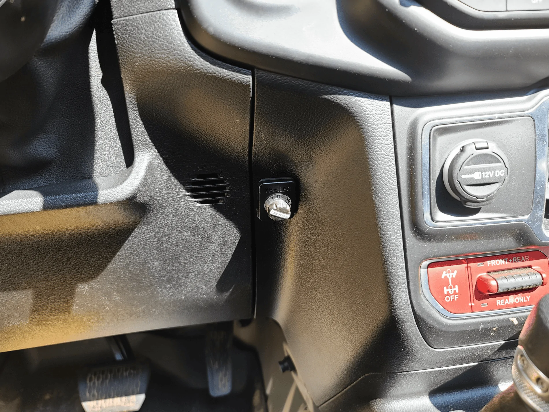

I know this is a little old, anyone relocate the 12v outlet inside the center console?
I have not seen that one. Why relocate and not split or add a new one? Where are you relocating to?
40,501
54,022
Because the MOPAR trailer brake controller takes the 12v outlet spot. You have to remove the outlet to install the control dial/knob for the brake controller. Some would like to keep the 12v outlet - and choose to relocate it instead of removing it like Jeep would if you had them install the brake controller.
He's wondering where to relocate it to after removing it for the trailer brake controller install.
I've been wondering that myself - mine is hanging behind the glove box right now.

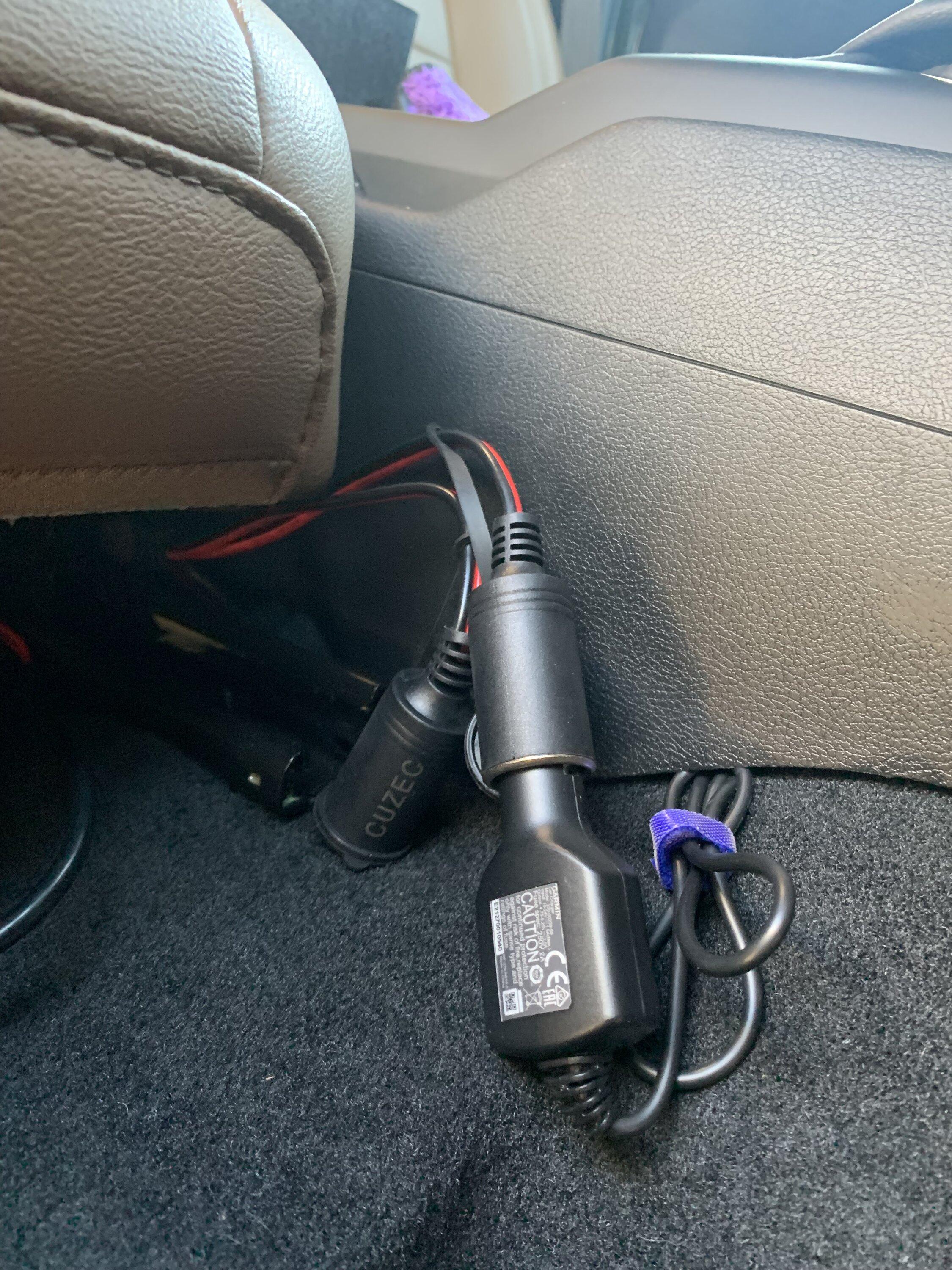

I did the redarc in the same location and used the Quadratech cig plug splitter to run a dual 12 volt outlet under the passenger. It gives you a plug and play live wire from the cig plug. There is an amazon one but everyone said by the higher quality one from Quadratech. Gained an extra plug and used the power from the cig plug outlet.
Pics at the bottom of this page of my build thread for the dash mount.
https://www.jeepgladiatorforum.com/forum/threads/aev-370-jtrd.57162/page-2
Below is a pic of the dual plug that is under the seat. Bought this guy from Amazon and just clipped off the battery clamps
https://www.amazon.com/gp/product/B074WT6LP2/ref=ppx_yo_dt_b_search_asin_title?ie=UTF8&psc=1

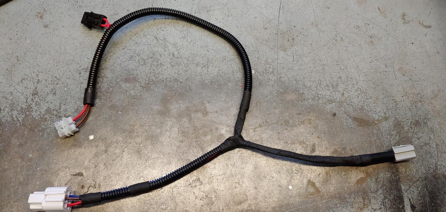

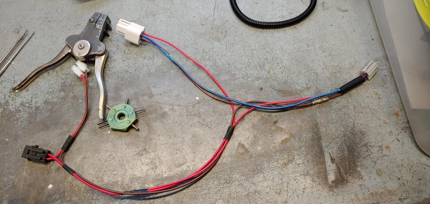

I saw nothing "cheap" or bad or questionable with the Amazon harness - the idea of the thing is to add a 12v tap on the wires to the 12v outlet.
I extended the wires a bit so it would reach from the normal 12v outlet area clear over into the glove box.
My bet is that they come from the same original source, but even if not, these aren't rocket booster parts and are all internal, enclosed in the dash.
I'll likely never need nor use the tap these are intended for, especially don't like fuses in hidden spots, so I am simply using it to extend the 12v wiring a few inches. I left that fuse and tap in it anyway.
