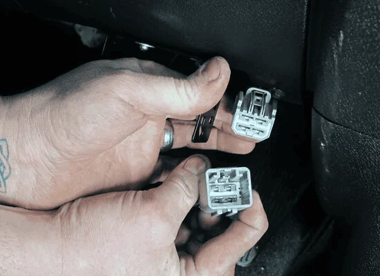

I'm doing a dash cam install (Blackvue 4k) and want to have it always powered for parking mode without splicing wiring. Some of you may be aware that there's an aftermarket trailer brake controller plug in the harness down by the brake pedal. It's a gray 4-pin connector:

There are various connectors you can buy to mate with the one in the OEM harness. The choice isn't critical as you probably won't use the other end (just cut it and splice your own wires onto it).
Something like this would work:
https://www.amazon.com/Tekonsha-3014-P-Control-Wiring-Adapter/dp/B00QRWR1YI

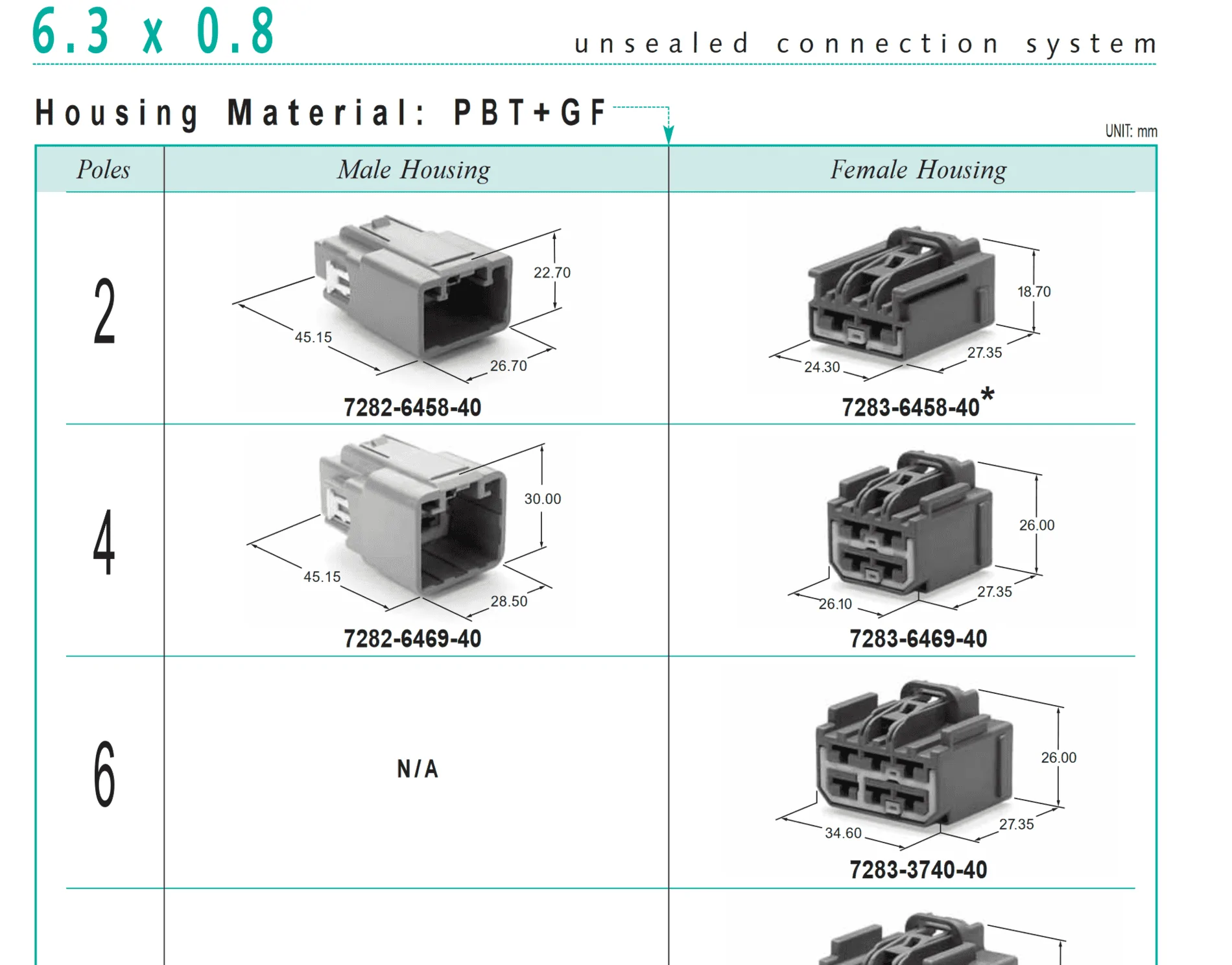

If you're interested in making your own harness, I think I found the connector series. It's called "YESC Kaizen 6.3 Unsealed" from Yazaki:
Jeep Gladiator Trailer Brake Controller Connector 1591368189438
It took me a bit to find this information so I figured I'd post it somewhere on the internet if it ever helps save someone the effort...

That doesn't look to be an exact fit for the OEM connector.
Getting the actual mating connector isn't too much more expensive:
https://www.amazon.com/gp/product/B00QRWR1YI/ref=ppx_yo_dt_b_asin_title_o00_s00?ie=UTF8&psc=1
That's what I ordered.
I also ordered a Quadratec adapter to splice the ignition-switched 12V cigarette lighter... way overpriced at $30 but it only hurts once...
