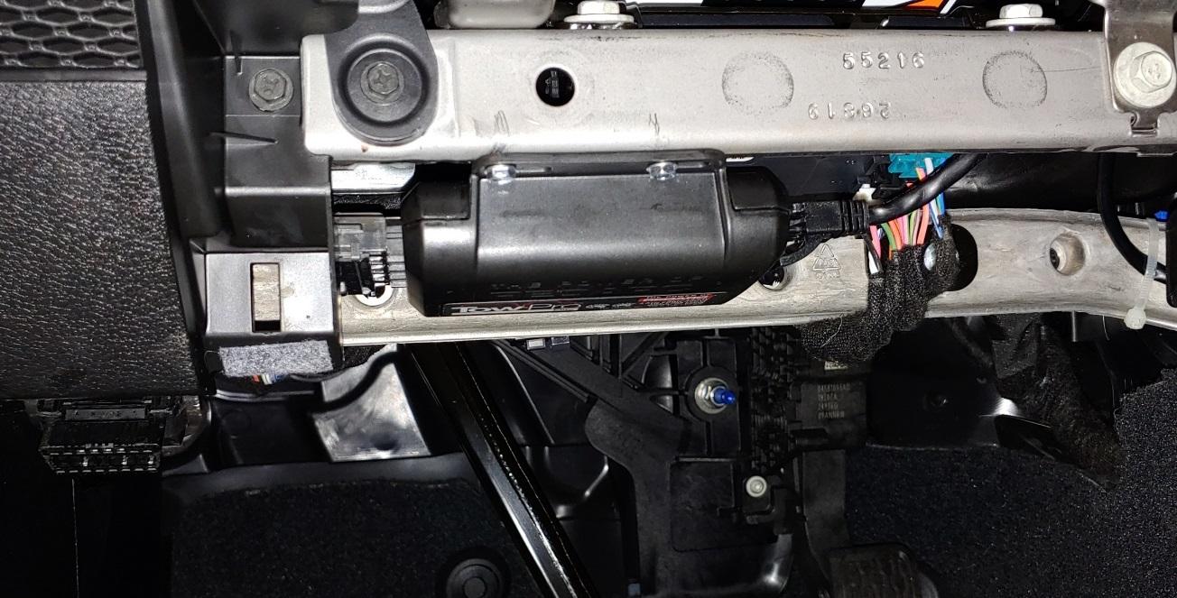

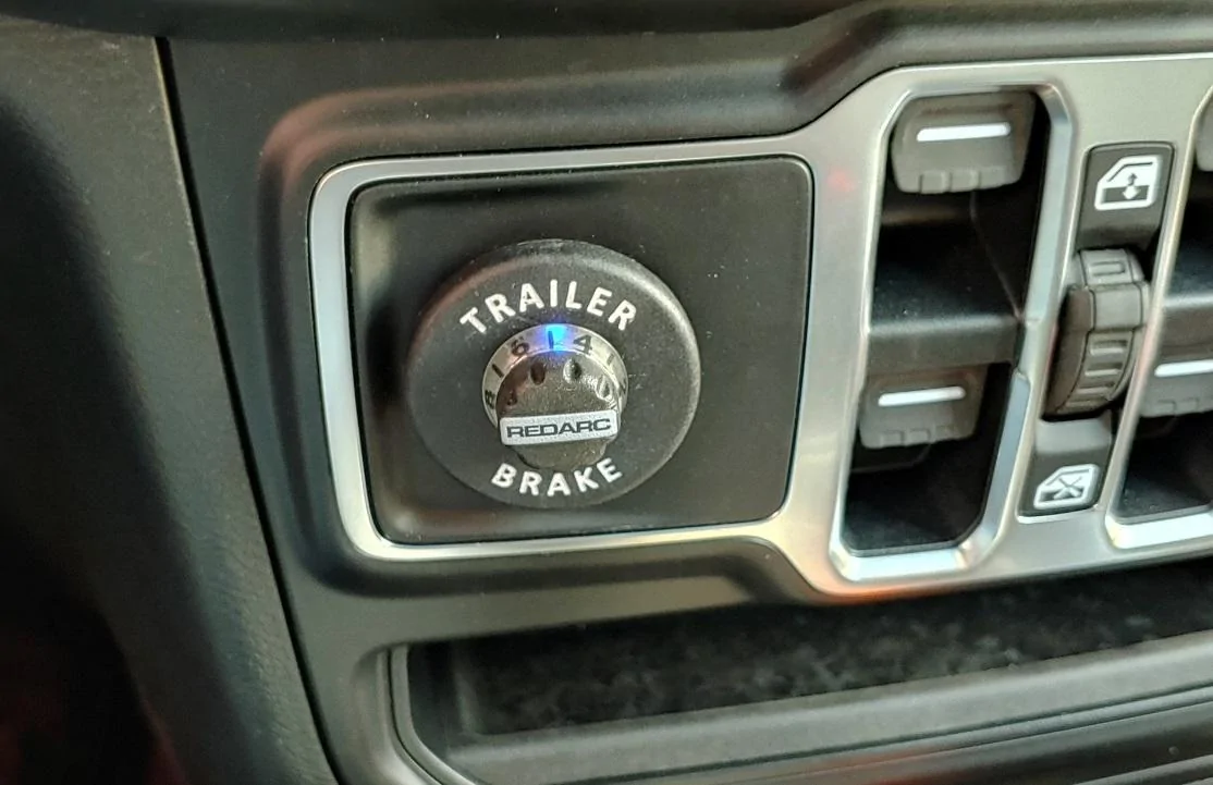

Here are pics of my Redarc/Gladiator installation.

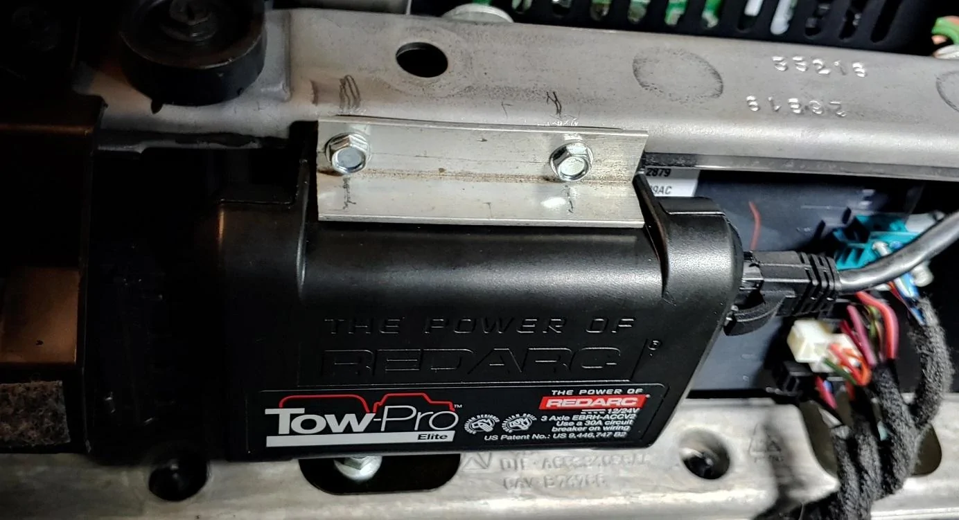

I decided to use an aluminum angle as shown above to reinforce the mounting flange - this is how it looked before I put the aluminum angle in place ->

There are two Redarc controllers. One is about $220 and the other is somewhere around 140 if I recall correctly. The Redarc I have (will install on wife's Jeep) is the better Redarc and is dual-mode. (check their web site for details, no use me duplicating it)
It can be mounted almost anywhere under the dash.
