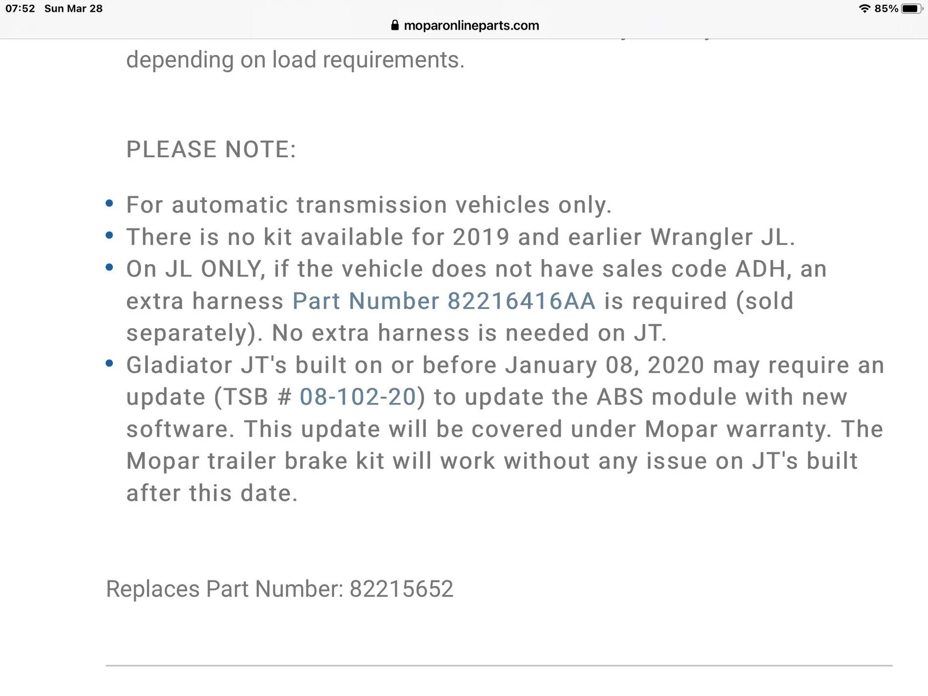

I spent about 6 hours yesterday installing the OEM brake module (I told you it takes me a lot longer to do these projects, I take my time so I don’t screw it up) I also had to remove my Dead Pedal and grind the tip down to reveal that screw hole. That worked out good whereas I wanted to adjust that pedal up anyway. I didn’t remove my front seat and overall it went pretty smoothly, made much easier by all y’all’s Impute and pics... Thank you! I have attached a copy of a disclaimer from Mopar online parts website, where they indicate that JT’s produced prior to January 8, 2020 ‘may’ require a computer update (TSB # 08-102-20).
Jeep Gladiator Mopar Trailer Brake Controller for Jeep Gladiator Officially Released (Part # 82215652AB) 130172E4-B94D-4660-9D7D-877CEF6BEEF0

The way it has been handled is terrible, but the item was tested and there is a resolution. The fix was implemented, at the factory, long before the controller was available to install. The sad thing is the controller offers nothing over aftermarket, other than the factory installed look. The TSB for the ABS module fixes the brake controller issues. In the meantime, the market came up with their own repair method, which is the diode in the controller harness.
You’re saying their IS a fix for the Mopar Trailer Brake not working on my early build gladiator? I’m still searching the forums but if you can point me in the correct direction… I just want this sucker to work after the time and money to install it. I don’t mind installing a diode with a little guidence.
40,496
54,011
Screw the diode. Go to page 28 of this thread, my last post on that page. Take the tsb to the dealer and explain that when u press the brake controller button bad things light up on your dash. Make them flash your abs to the latest version or per the tsb i posted on page 28 here. It's their problem to fix, not yours
