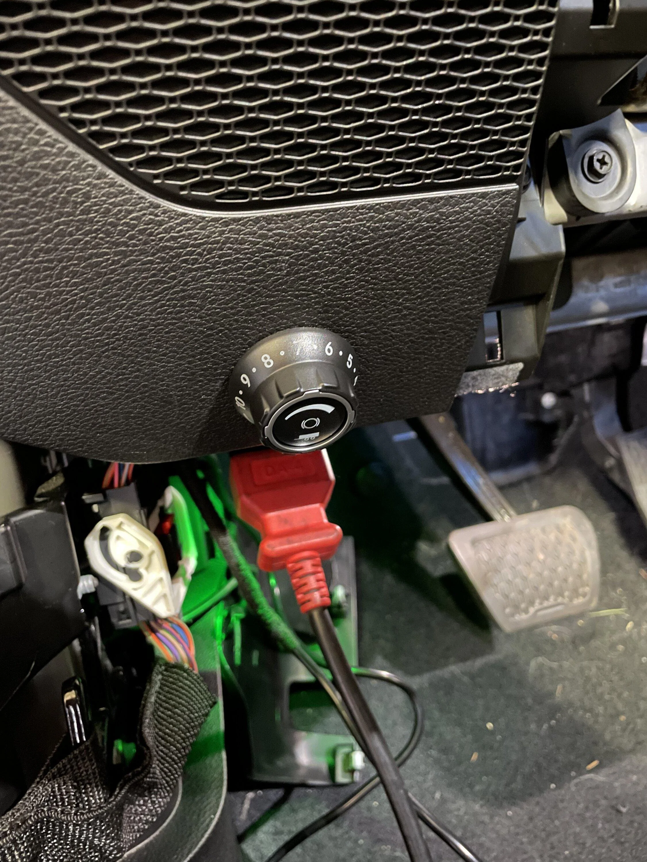

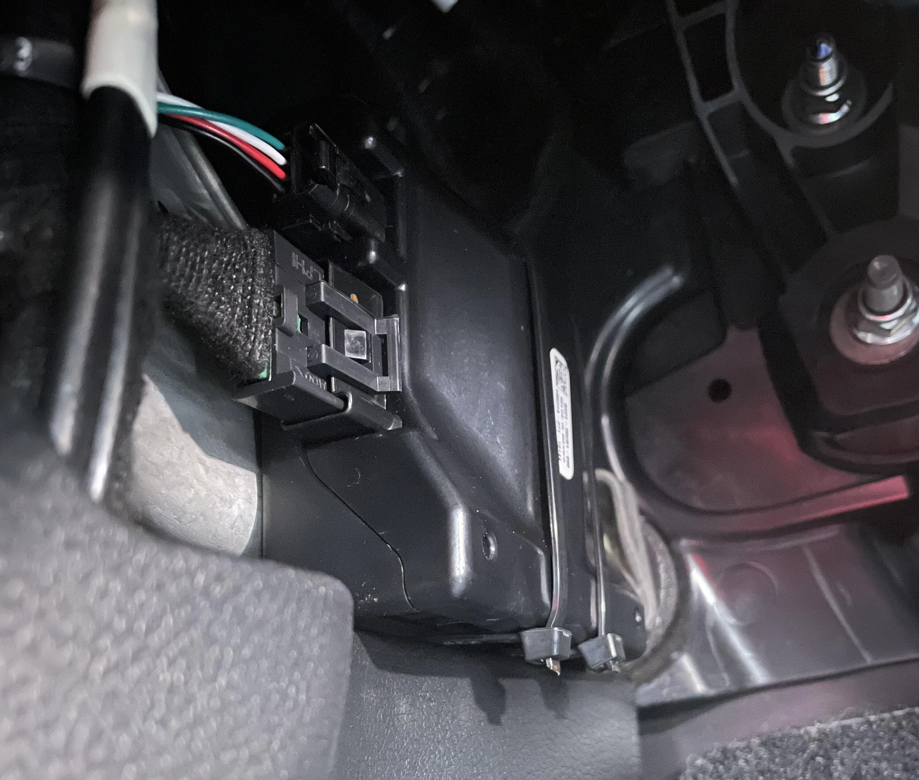

Just adding to the chaos that is the Mopar product. Finally obtained one. I tie-wrapped that bad boy to the frame just above the kick panel.
Did not feel like bolting a 2oz. Piece of plastic.
Where the instructions say to place, well good on ya if you contorted your way in.
After securing ,added the harnesses. Drilled a hole in the plastic of left dash just below speaker grill like others have. This way i retained the auxiliary plug. My only issue was the inconvenience of getting the ABS module flash from dealer to cure the dash lites yelling at me.
Done & done.
