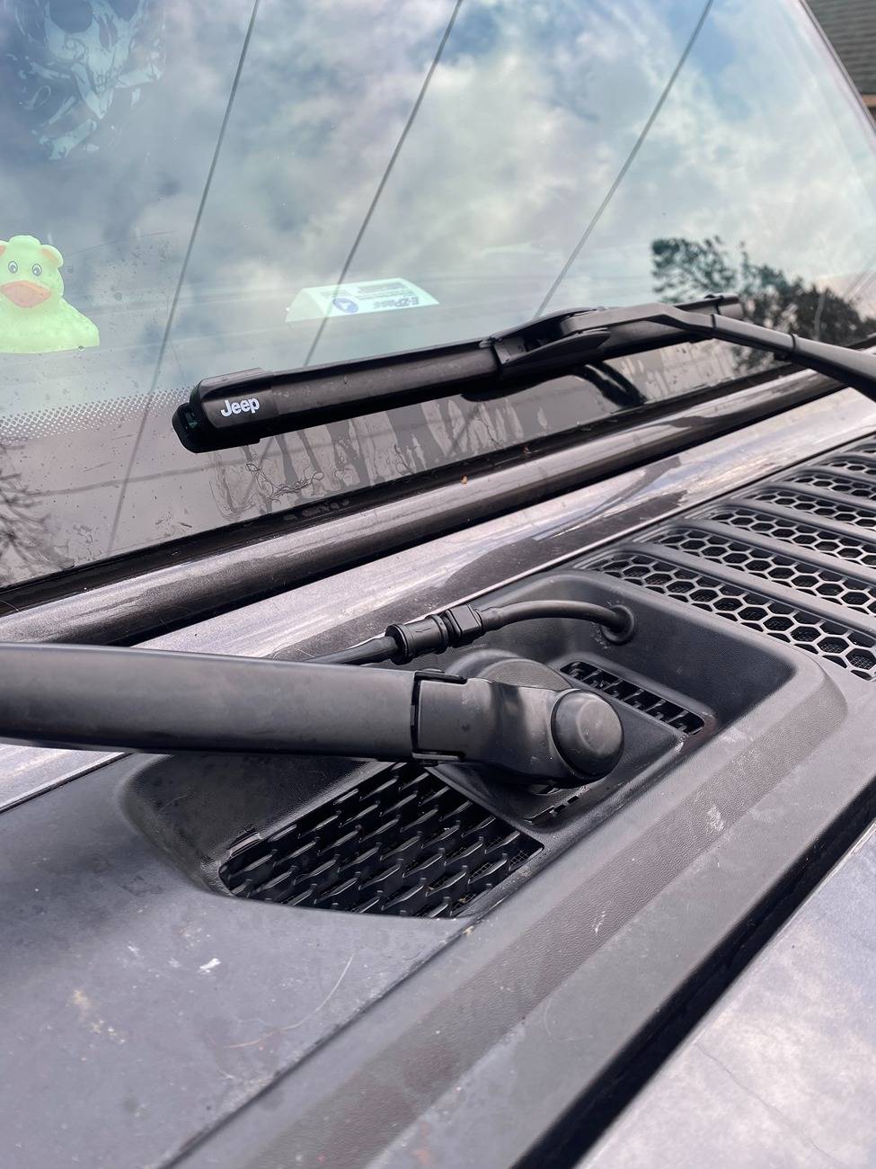

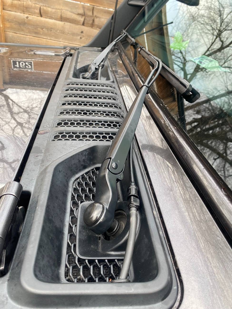

Here is my take on this mod after taking these out of storage for 2 years, finally spent the past two weeks working on them.
Nothing new to add in terms of technique but what I found worked the best (minimal friction and snags when wipers are working) is to NOT route the fluid hose into the spring coil of the wiper arm. By NOT doing so, there is more give to the hose and its not super taunt where it bends sharply resulting in broken hoses. I used black zip ties to tie the hose to the mid wiper arm length for now.
Going on a roadtrip to BOS & PHIL in two weeks so will report back after some solid driving thru winter weather.
Jeep Gladiator Mopar Performance Windshield Wipers w/ Built-In Washer Jets Released For Jeep Gladiator IMG_0205
Jeep Gladiator Mopar Performance Windshield Wipers w/ Built-In Washer Jets Released For Jeep Gladiator IMG_0204
RedRaptorJT
Aug 24, 2020
112
102
St Louis, Missouri
2020 JT Launch Edition
Here's how it looks like. Before when I had the hose routed thru the wiper arm coils, I had breakage right at the end of the quick connector point (wiper side). You can see there is less stress on that point with the hoses routed outside of wiper arms.
PS. and no...you aren't being rick rolled. song came on 80s on 8 SiriusXM. lol
