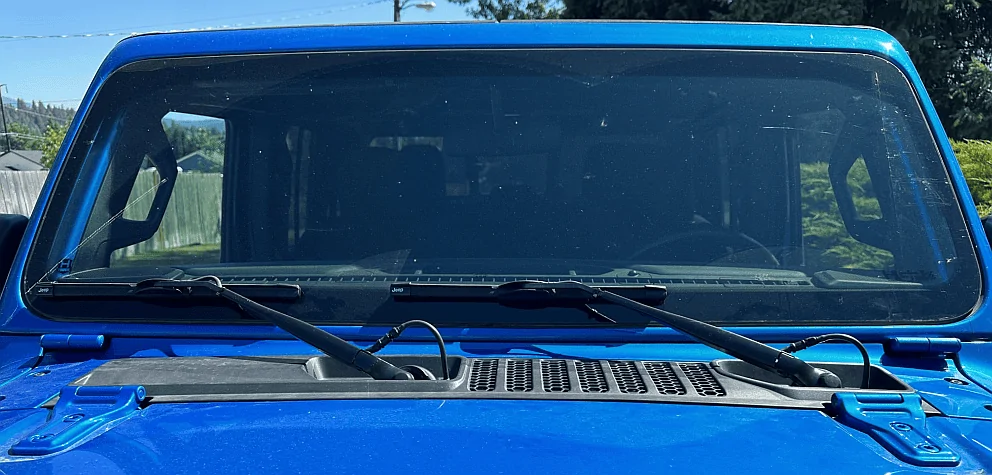

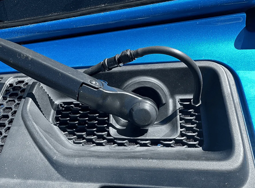

I ended up with both hoses cut…
I finally had some time on a reasonably nice day, so I made some mods to the cowl.
I started opening up the wiper holes a bit:
Then put some rubber edging trim on the cut part:
The trim I used holds itself in place without any adhesive.
Then I put it back together:
So we’ll see how this works.
Well, that didn't work out so well...
One of the fittings broke at the disconnect, and the other popped the fitting out of the hose.
So I tried a variation on the hose-through-the-grommet method...
Jeep Gladiator Mopar Performance Windshield Wipers w/ Built-In Washer Jets Released For Jeep Gladiator 1690063708636
My RV uses a similar configuration: that's where I got the idea. It's a bulkhead fitting through the cowl.
I wanted to run the fitting through the side, but then the fittings would hit the main cowl when the black insert is reinstalled.
It looks rather ungainly...
Jeep Gladiator Mopar Performance Windshield Wipers w/ Built-In Washer Jets Released For Jeep Gladiator 1690063789030
But the hoses gently flex without kinking, and there's no abrasive rubbing.
So we'll see how well this holds up.
I've been very pleased with the wipers otherwise.

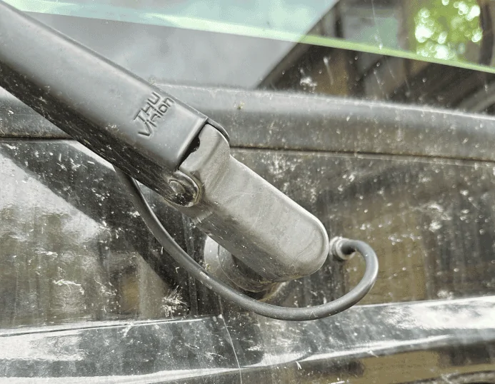

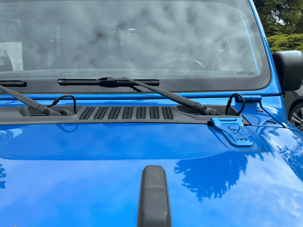

I know, old thread.
Well...
That setup just ended up with the quick-release/check valves both breaking.
So, after looking more closely at my RV setup...
Jeep Gladiator Mopar Performance Windshield Wipers w/ Built-In Washer Jets Released For Jeep Gladiator RV
(Excuse the bugs.)
I redid it with longer, more flexible hoses...
Jeep Gladiator Mopar Performance Windshield Wipers w/ Built-In Washer Jets Released For Jeep Gladiator J
...and it's worked well so far.
I've taken a couple of trips with it, and put about 10 hours on the wipers, and no complaints.
