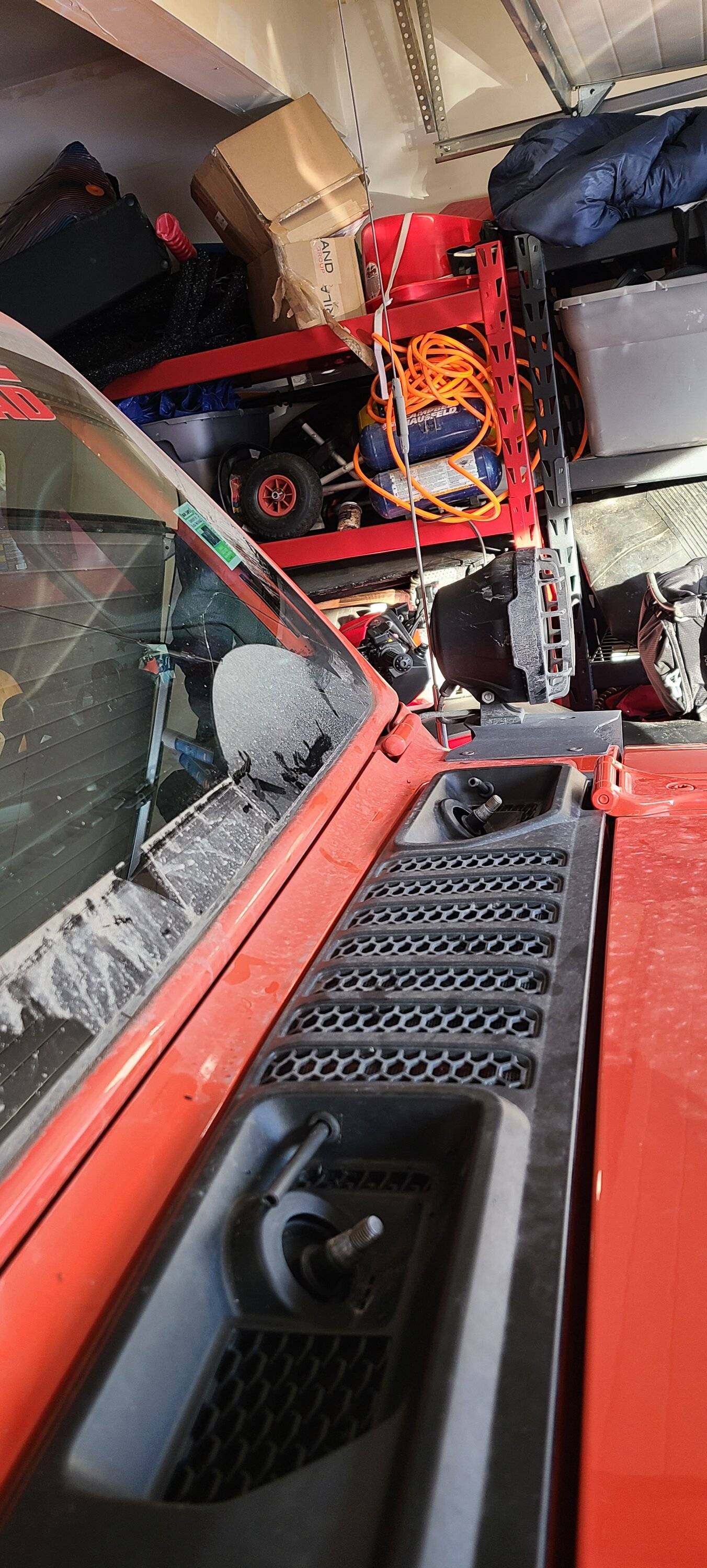

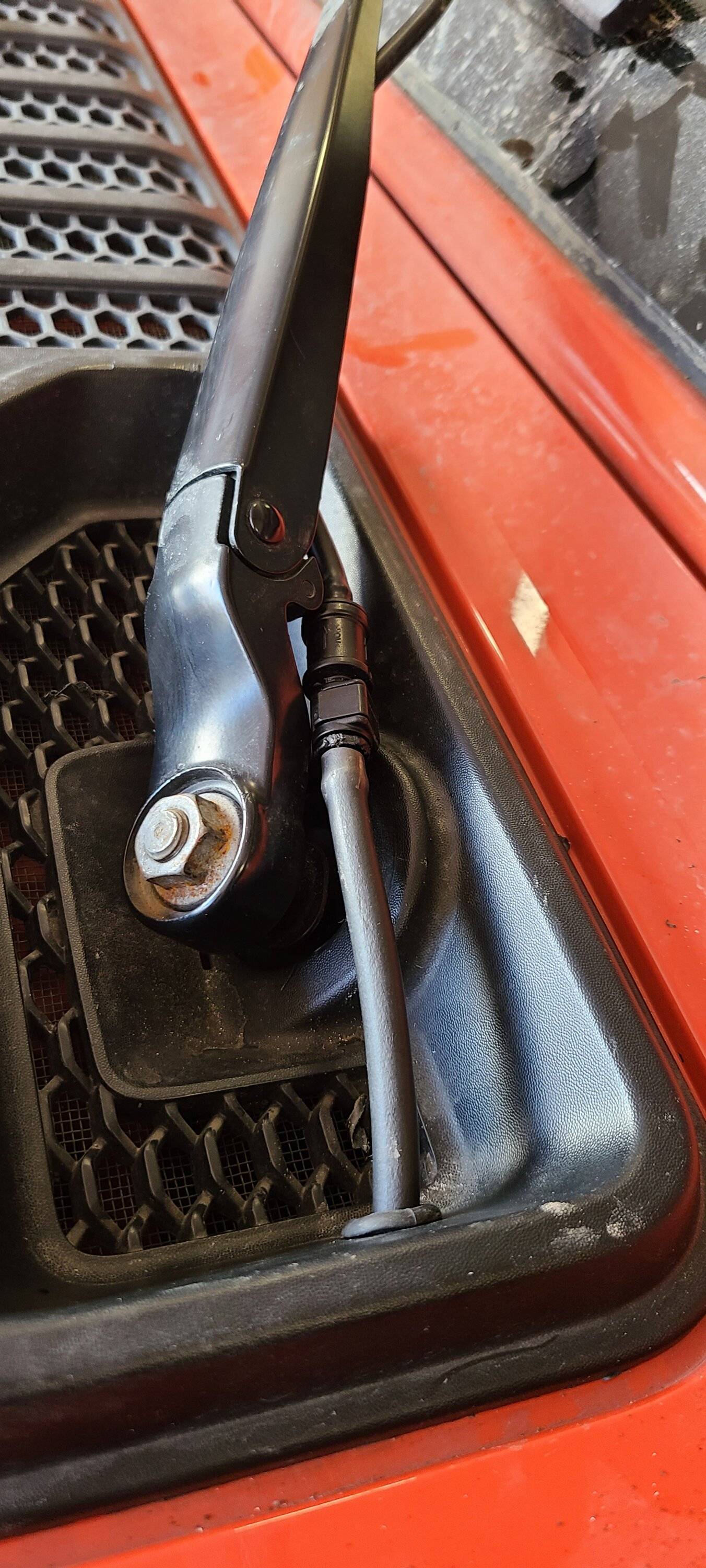

I didn't know this thread was still alive and well. But I've had my hoses get cut so many times I finally did the new hole/grommet thing. Hopefully this fixes it's wagon. I've had to reconnect the hoses probably 5 times since receiving the kit. Don't know it of course until you're blowing washer fluid into the wind. Pretty poor design they really should include the 2 grommets and instruct people to drill a 27/64 hole in the cowl to properly route them.

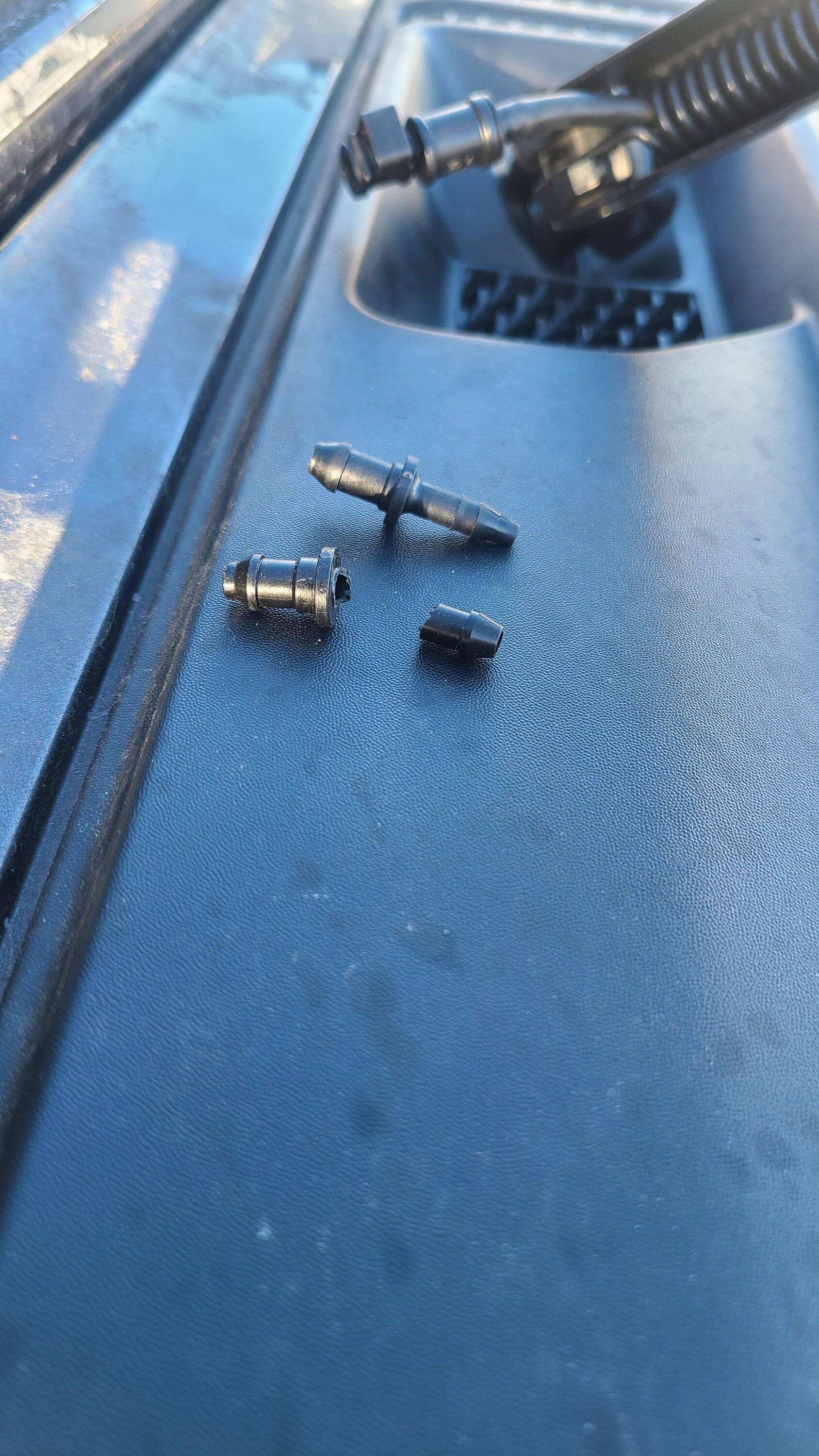

During a -15F day with salt spray on my windshield, the male portion of the quick disconnect on the passenger side broke in half (between the barb in the supply tube and the quick disconnect portion)
While it was a wonderful new "performance" feature to be able to clean the driver's side window and simultaneously spray anything to my right ... I did find a replacement that worked (ignore the fact that the replacement looks smaller ... perspective messing things up again) ... It has been working for over a week now
Benny @AllMoparParts.com is there an official replacement for this?
A VW/Audi part 1J0955875R
I got it here:
https://www.ecstuning.com/b-genuine...d-washer-hose-coupler-priced-each/1j0955875r/
Exact same part did the same thing for me today at -4 degrees. combined with no factory replacement blades or parts I'm writing the whole thing off and going back to Bosch Icons.
Have a link to the grommets you used?

I bought them as a grommet kit on Amazon. And I used a 27/64 drill bit for the holes. Idk what the best plan for where the holes to go is, but inline seemed best.
Brexxty Pack of 180 Rubber Grommet Kit in 8 Sizes – Rubber Wire Grommets with Compact Assortment Box for Wiring, Plumbing, Hardware Repair, and Automotive https://a.co/d/dYpsgvw

Well after a nice long trip up the coast of the Olympic peninsula the torrential rains of the PNW finally caused that wiper arm to saw through my tubing. Looks like I’ll be doing the proper hose routing now. How did you guys warranty yours out, since getting a new one is the only way to get wiper refills now anyways…
