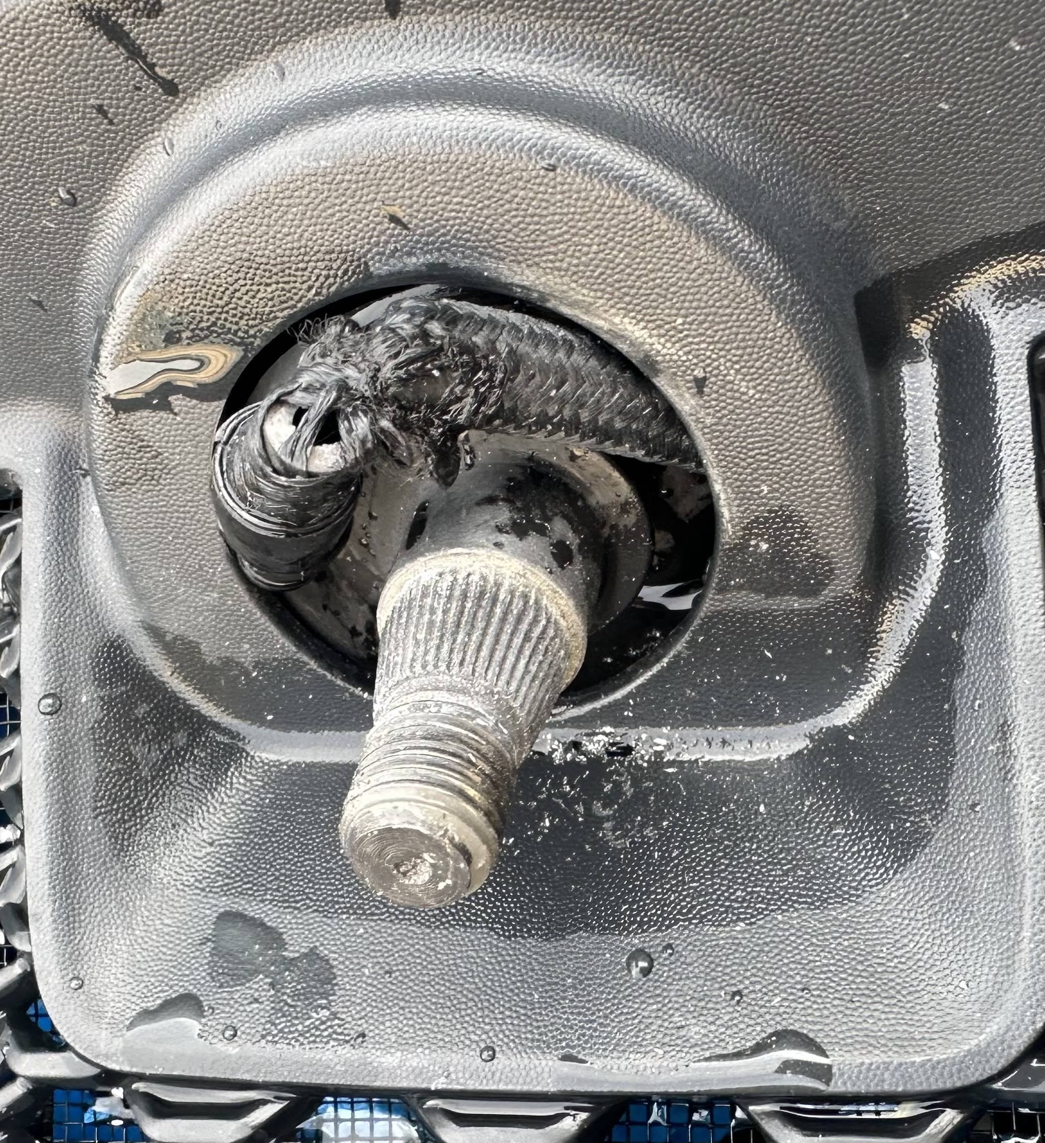

did stevie wonder design the original layout. i mean even a blind fella could see that might be a problem over time. geeeeeesh.
This comment ^^^ made my day lmfao. It's another Jeep thing i guess.

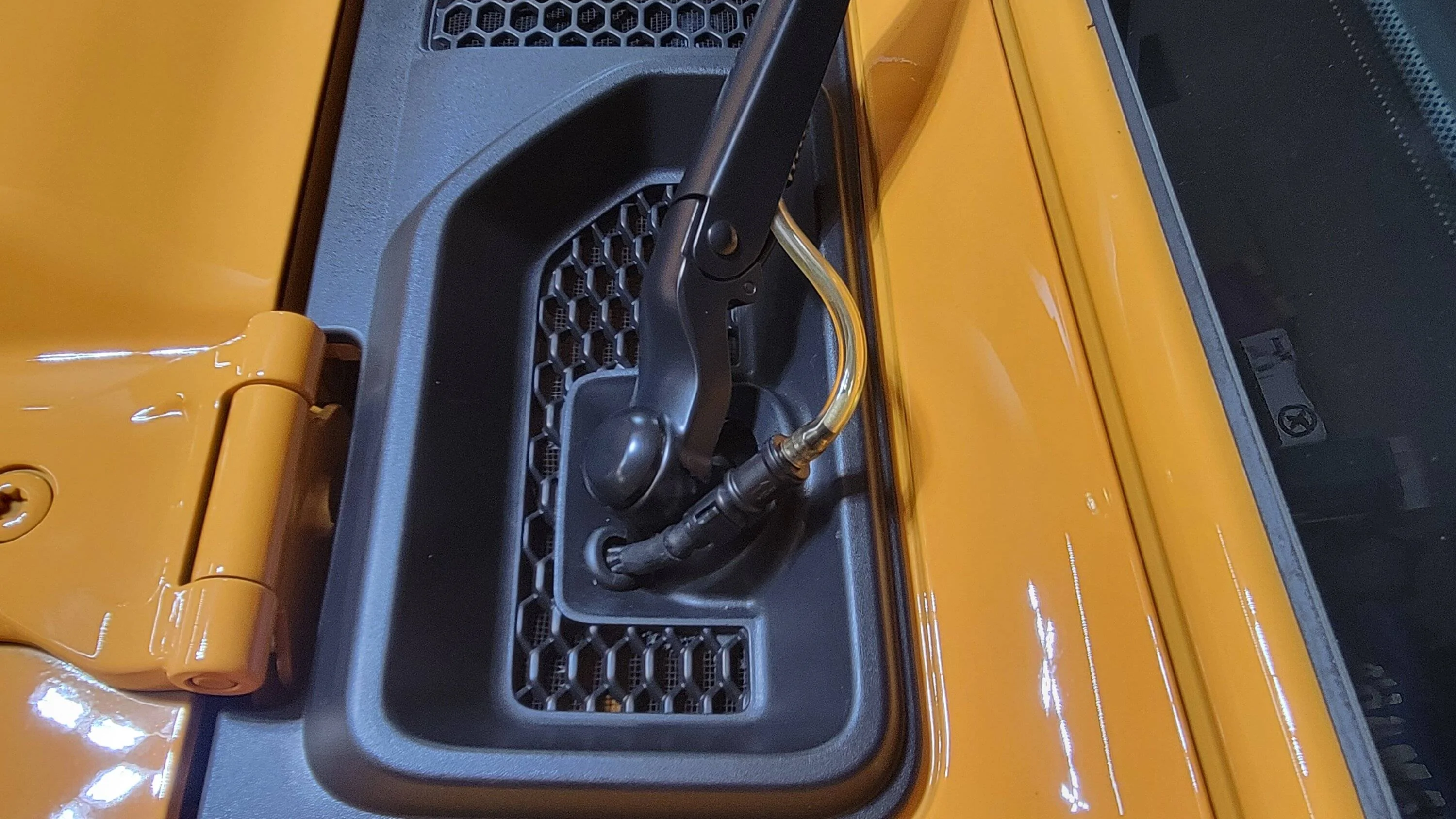

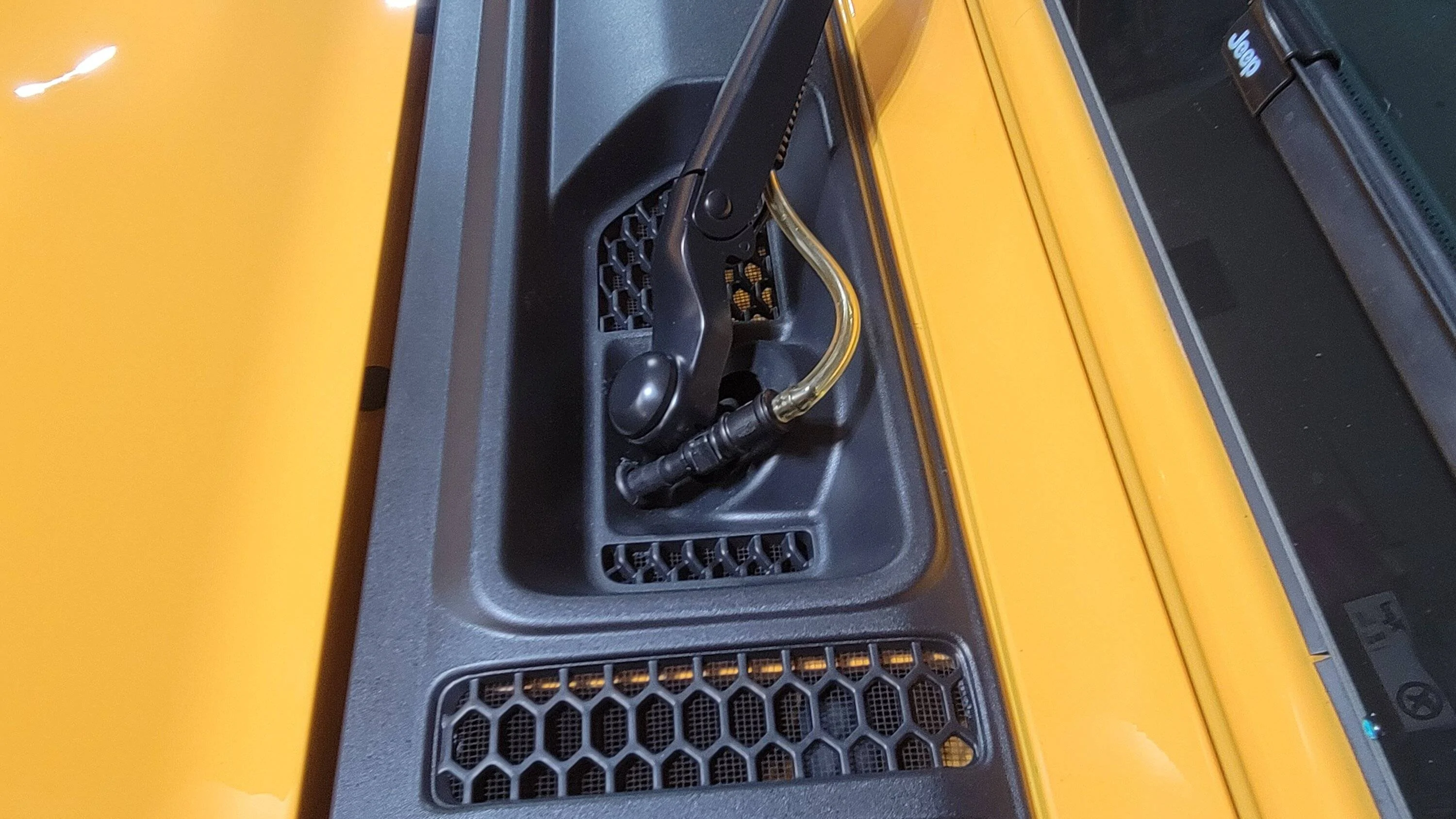

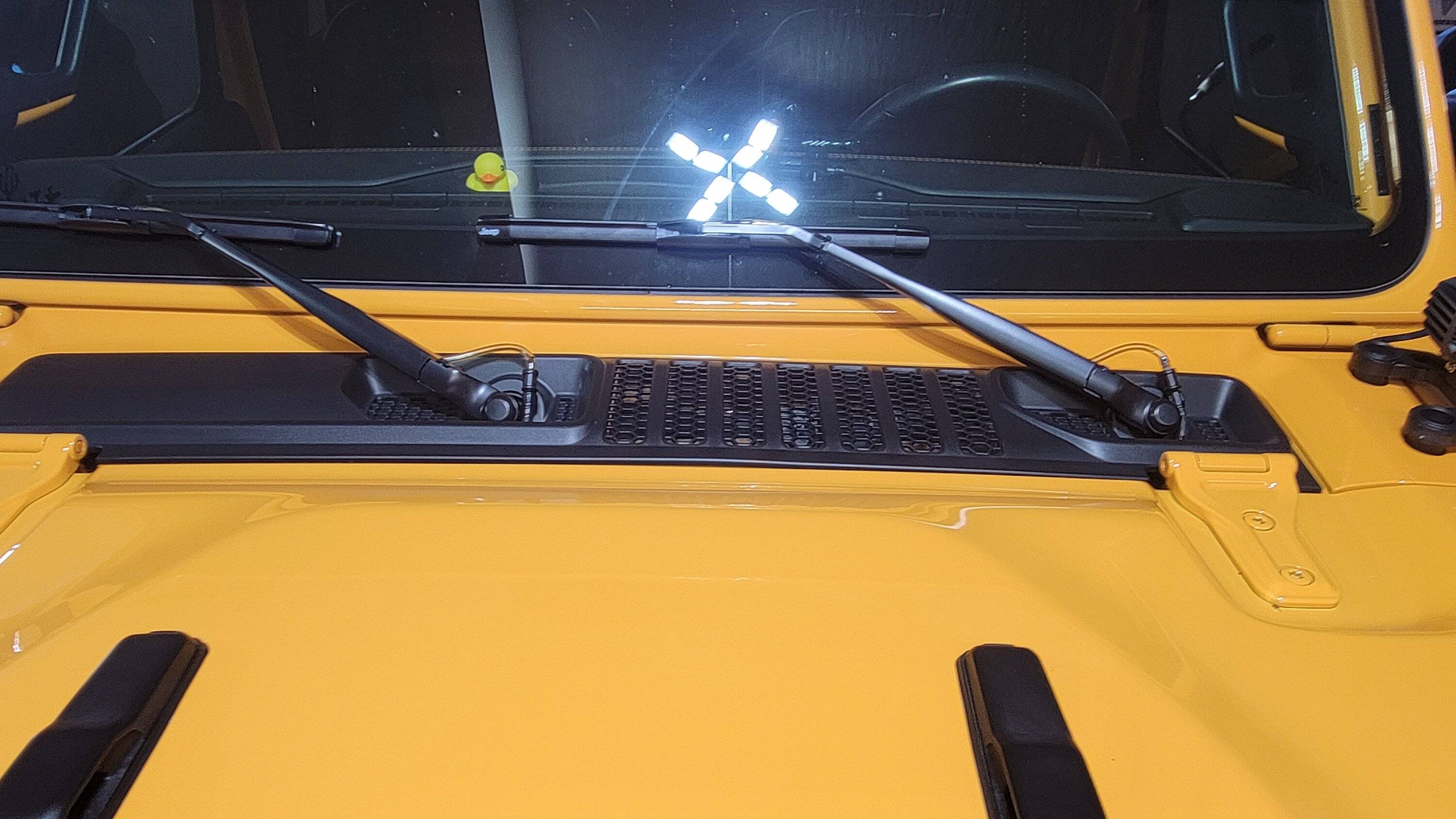

Just now played around with mine,some may not like the out come but for me it works ! Got out the multi step drill bit ,placed a grommet in the hole and installed new hose down the wiper blade to get a bit more length and R&R the hose coupler. I used some yellow fuel line that I had laying around on the wiper blades....
Works great and do not foresee any problems.
This is probably how it should be installed.

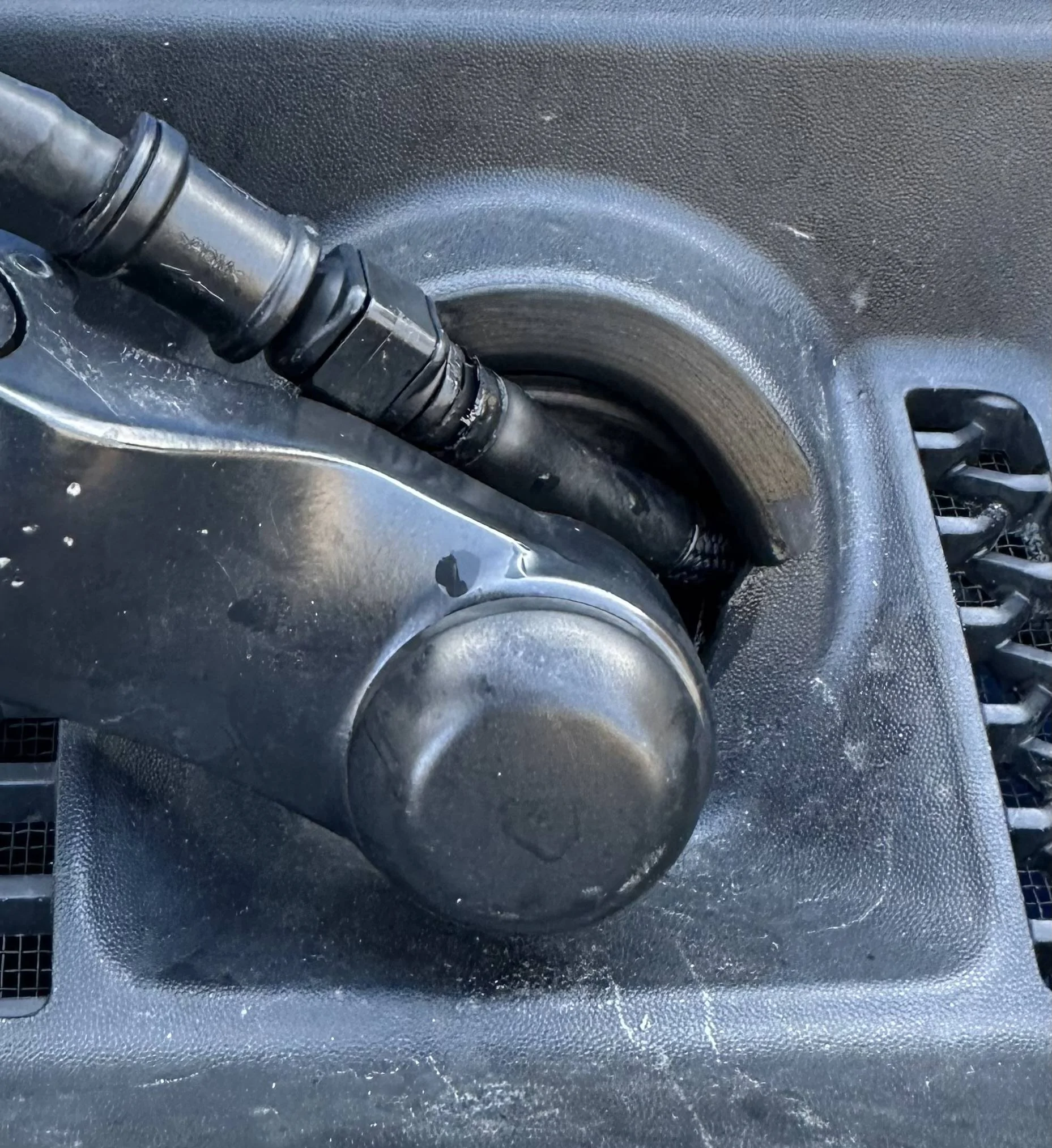

I had my cowl piece off a couple weeks ago to run some cowl light wiring and the nylon braid on mine was frayed badly. I just put a couple inches of heat shrink over both lines thru the wiper holes. Next time I pop the panel off I will be copying your install.

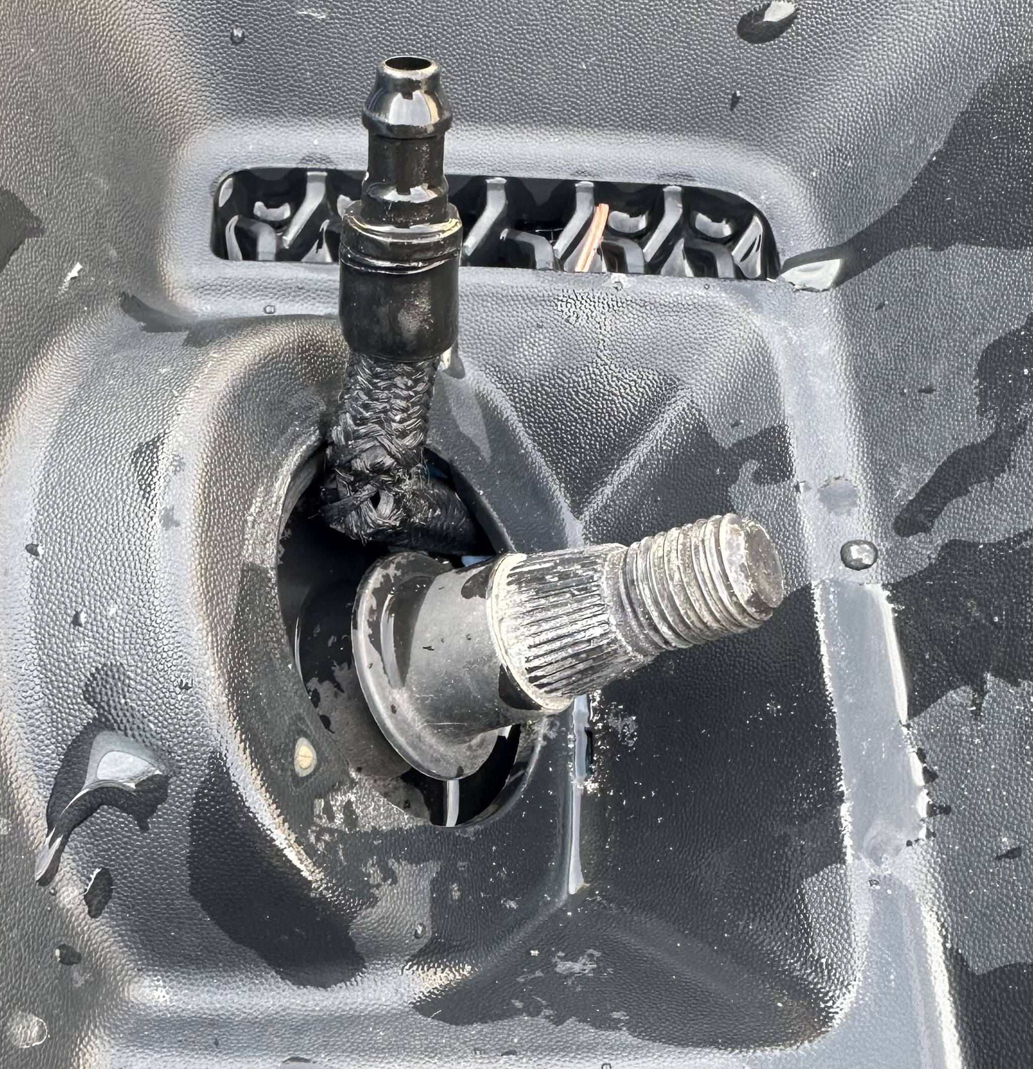

During a -15F day with salt spray on my windshield, the male portion of the quick disconnect on the passenger side broke in half (between the barb in the supply tube and the quick disconnect portion)
While it was a wonderful new "performance" feature to be able to clean the driver's side window and simultaneously spray anything to my right ... I did find a replacement that worked (ignore the fact that the replacement looks smaller ... perspective messing things up again) ... It has been working for over a week now
Benny @AllMoparParts.com is there an official replacement for this?
A VW/Audi part 1J0955875R
I got it here:
https://www.ecstuning.com/b-genuine...d-washer-hose-coupler-priced-each/1j0955875r/
I got it here:

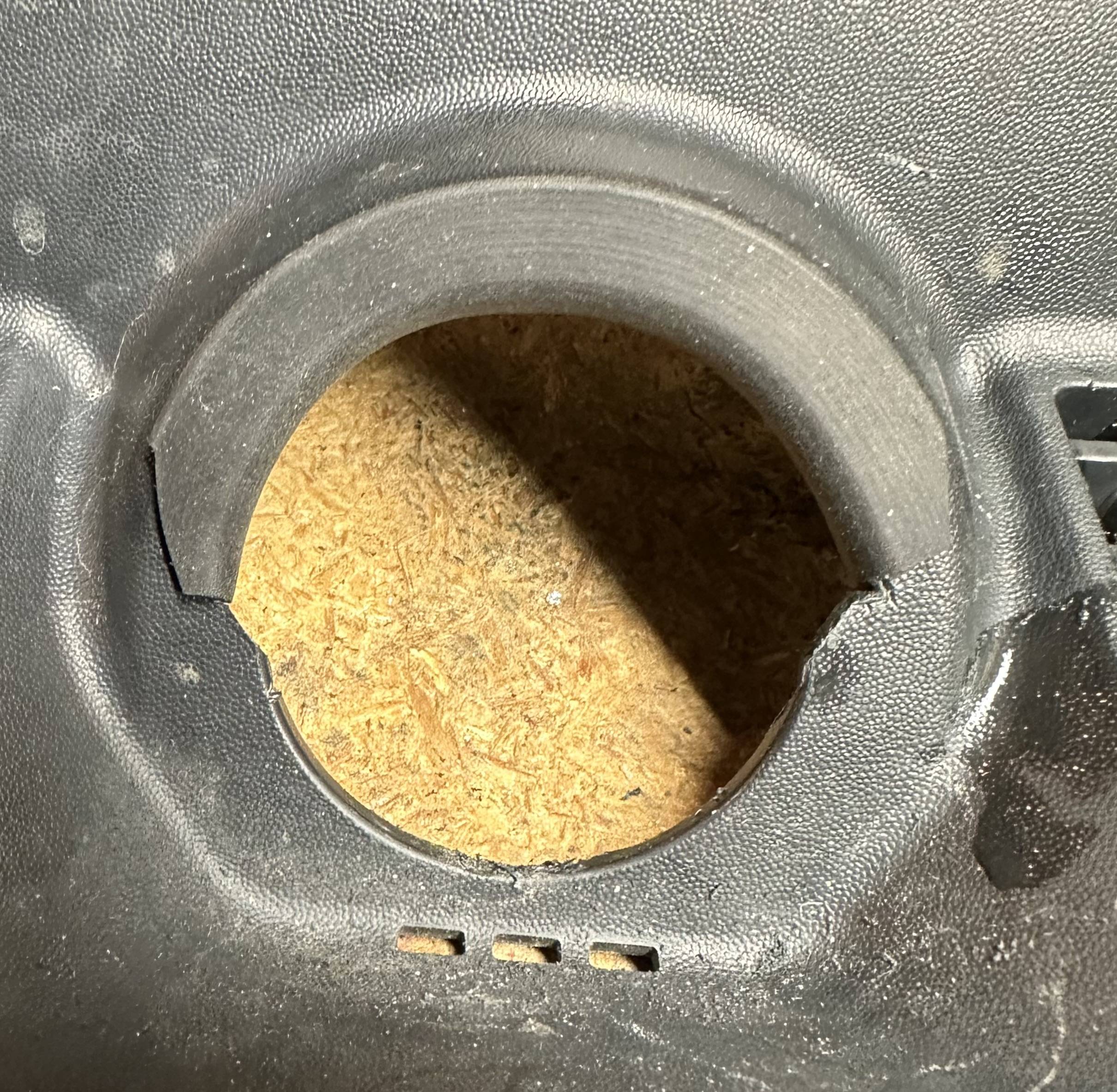

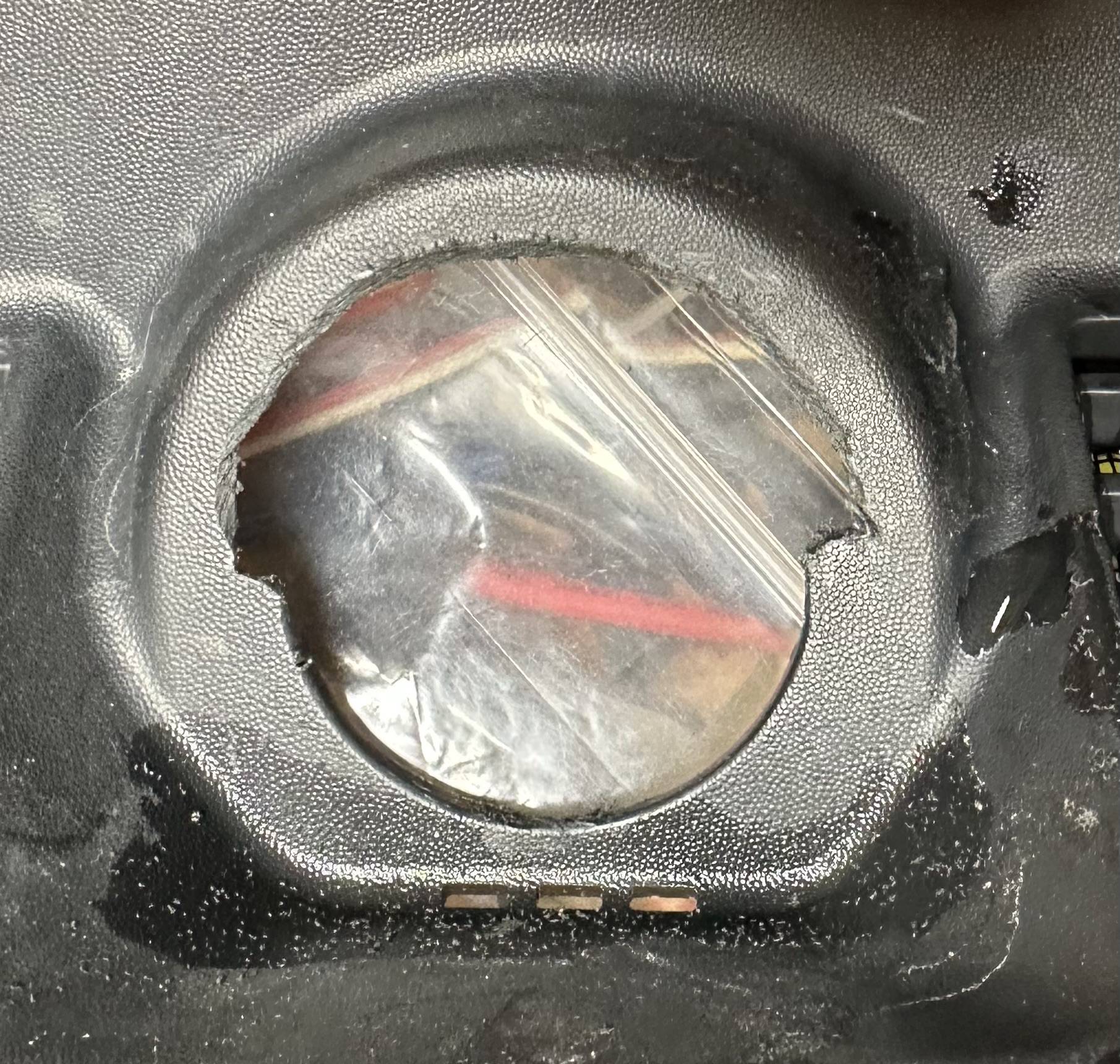

I ended up with both hoses cut…
Jeep Gladiator Mopar Performance Windshield Wipers w/ Built-In Washer Jets Released For Jeep Gladiator 1673735159936
Jeep Gladiator Mopar Performance Windshield Wipers w/ Built-In Washer Jets Released For Jeep Gladiator 1673735213688
I finally had some time on a reasonably nice day, so I made some mods to the cowl.
I started opening up the wiper holes a bit:
Jeep Gladiator Mopar Performance Windshield Wipers w/ Built-In Washer Jets Released For Jeep Gladiator 1673735313983
Then put some rubber edging trim on the cut part:
Jeep Gladiator Mopar Performance Windshield Wipers w/ Built-In Washer Jets Released For Jeep Gladiator 1673735397495
The trim I used holds itself in place without any adhesive.
Then I put it back together:
Jeep Gladiator Mopar Performance Windshield Wipers w/ Built-In Washer Jets Released For Jeep Gladiator 1673735497046
So we’ll see how this works.
