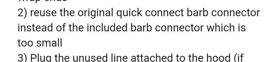

Just installed mine today. Easy enough (with a gear puller for the arms as previously suggested).
Here is a summary of the prior excellent suggestions that I used
1) add shrink tubing to the frayed/frayable nylon wrap ends
2) reuse the original quick connect barb connector instead of the included barb connector which is too small
3) Plug the unused line attached to the hood (if not using both the hood and wipers as discussed above)(fyi - the kit has 2 usable white plugs that are placed in the quick disconnects presumably for shelf life and shipping)
4) paint or otherwise add rust protection to the 2 nuts at the spline joints
I also added antiseize to the spline fittings between the wiper arms and the shafts. The shafts appear to be steel while the arms appear to be aluminum (which led to a bit more of a pull than I was anticipating to get one of the arms off)

Installed a set yesterday on the wife's 21 JLURD and have a set for my 23 JTRD when I get it in about a week....
Gotta ask, HOW did jeep screw up the connector size ????

I didn't have any issues with connector sizes. Everything went together perfectly. What are you referring to?
You plugged the hose the kit provided into the diconnect for the hood sprayers? Mine was much bigger on the Jeep and the hose connector provided wobbled around in it

Sounds good.
What year is yours, maybe jeep changed, mine went on a 21 JLURD, I'll text the theory in a week when my 23 JTRD rolls off the Choo Choo
