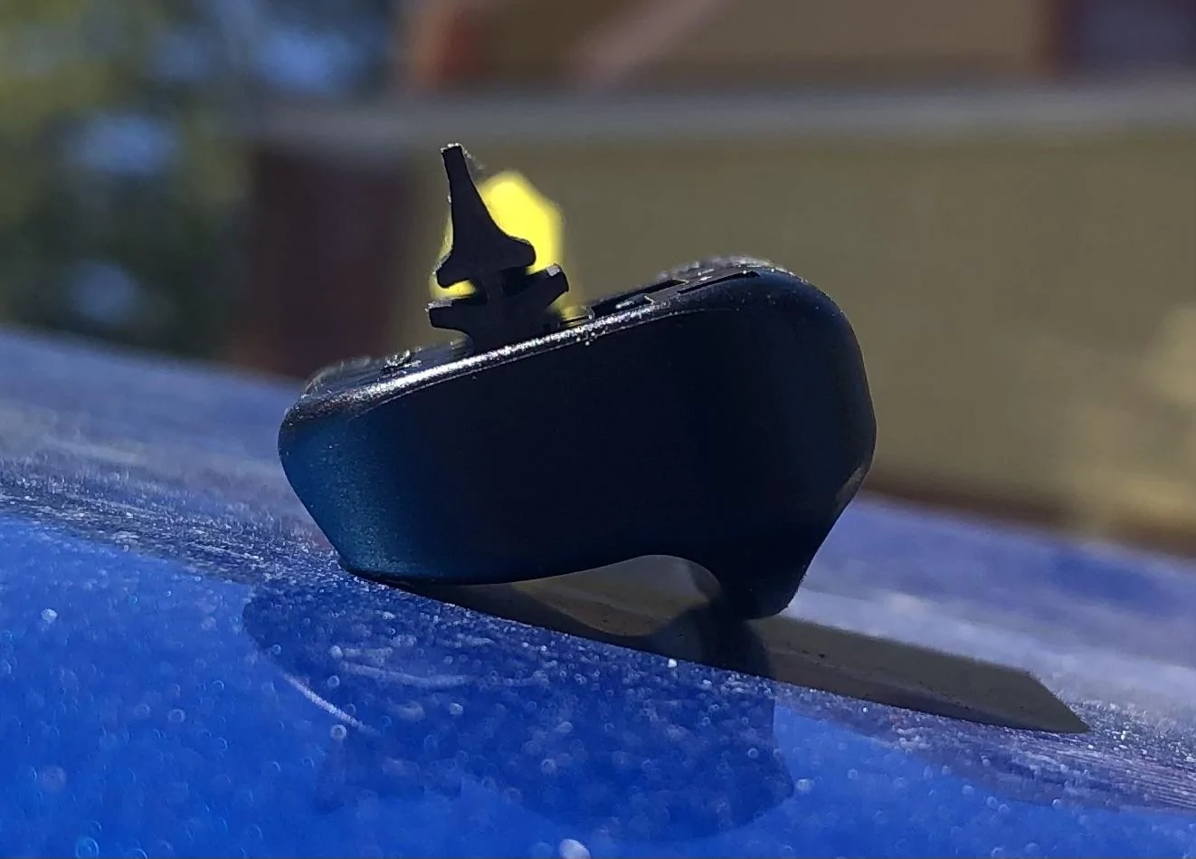

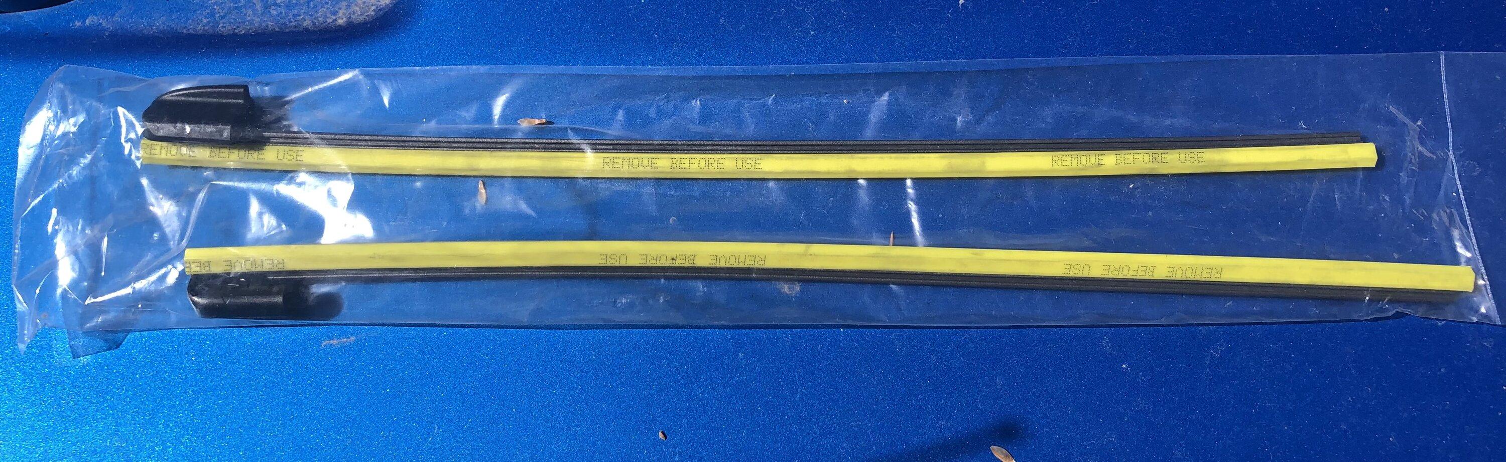

Here are some pictures of the wiper refills...
Jeep Gladiator Mopar Performance Windshield Wipers w/ Built-In Washer Jets Released For Jeep Gladiator IMG_E7516.JPG
Jeep Gladiator Mopar Performance Windshield Wipers w/ Built-In Washer Jets Released For Jeep Gladiator IMG_E7517.JPG

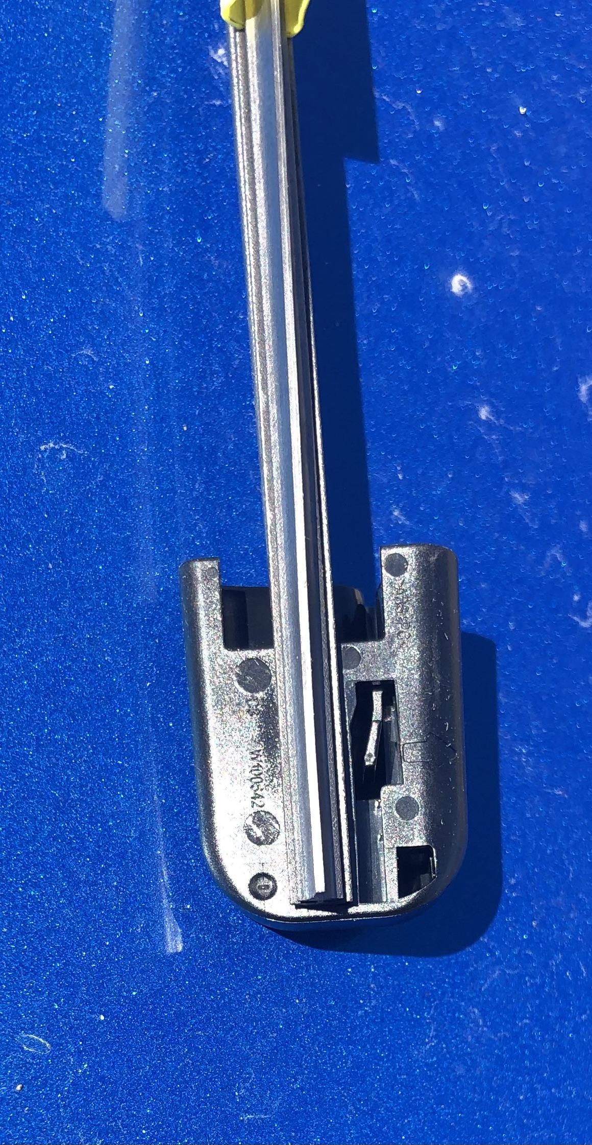

The little lever in the central hole is the blade release. I did not take mine apart.
Jeep Gladiator Mopar Performance Windshield Wipers w/ Built-In Washer Jets Released For Jeep Gladiator IMG_E7518
The large plastic end is affixed to the refill. The refills DO NOT have the Jeep logo on them.
The plastic piece has a plug to seal off the end of the sprayer channel; the channel is probably manufactured in looooong lengths, and cut to size, thus the outer end needs plugged.
Come time to replace them, we'll see what pricing & availability are like.

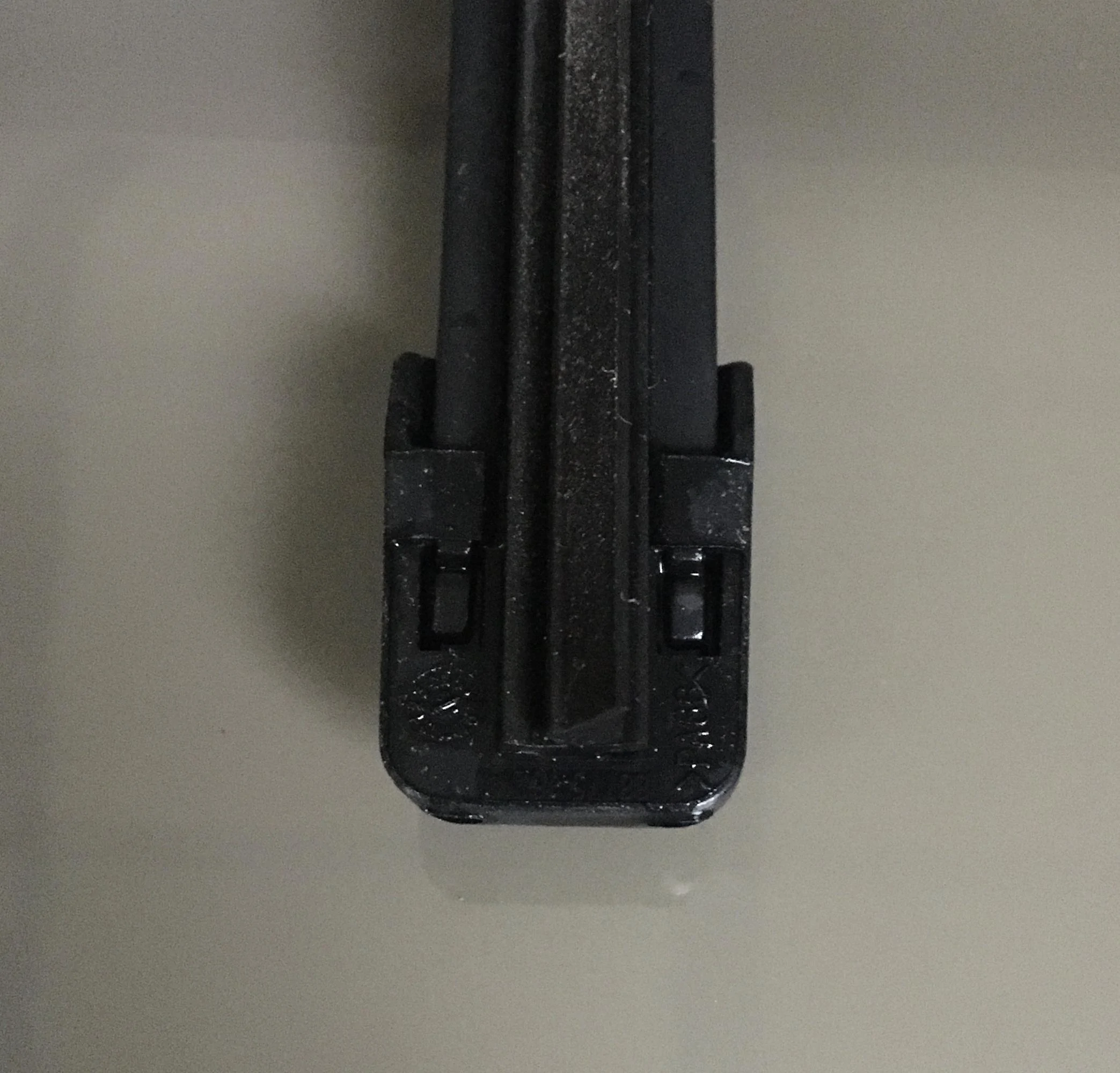

doesn’t look like the oem wiper blades can be refilled with performance wiper blades refills… but usually isn’t difficult to remove the rubber insert from the end piece and slide in a rubber refill And reuse the end piece.
Jeep Gladiator Mopar Performance Windshield Wipers w/ Built-In Washer Jets Released For Jeep Gladiator 9D2B0EC8-E9F1-45C0-933E-89E7C5AF564E
Jeep doesn’t sell rubber refills for the oem 16” Blade, but Honda has a 425mm aero blade that will fit on the Jeep arm and the Honda has rubber refills usually for under $5 each. The 425 is just a skosh longer than the oem but fits without interference.

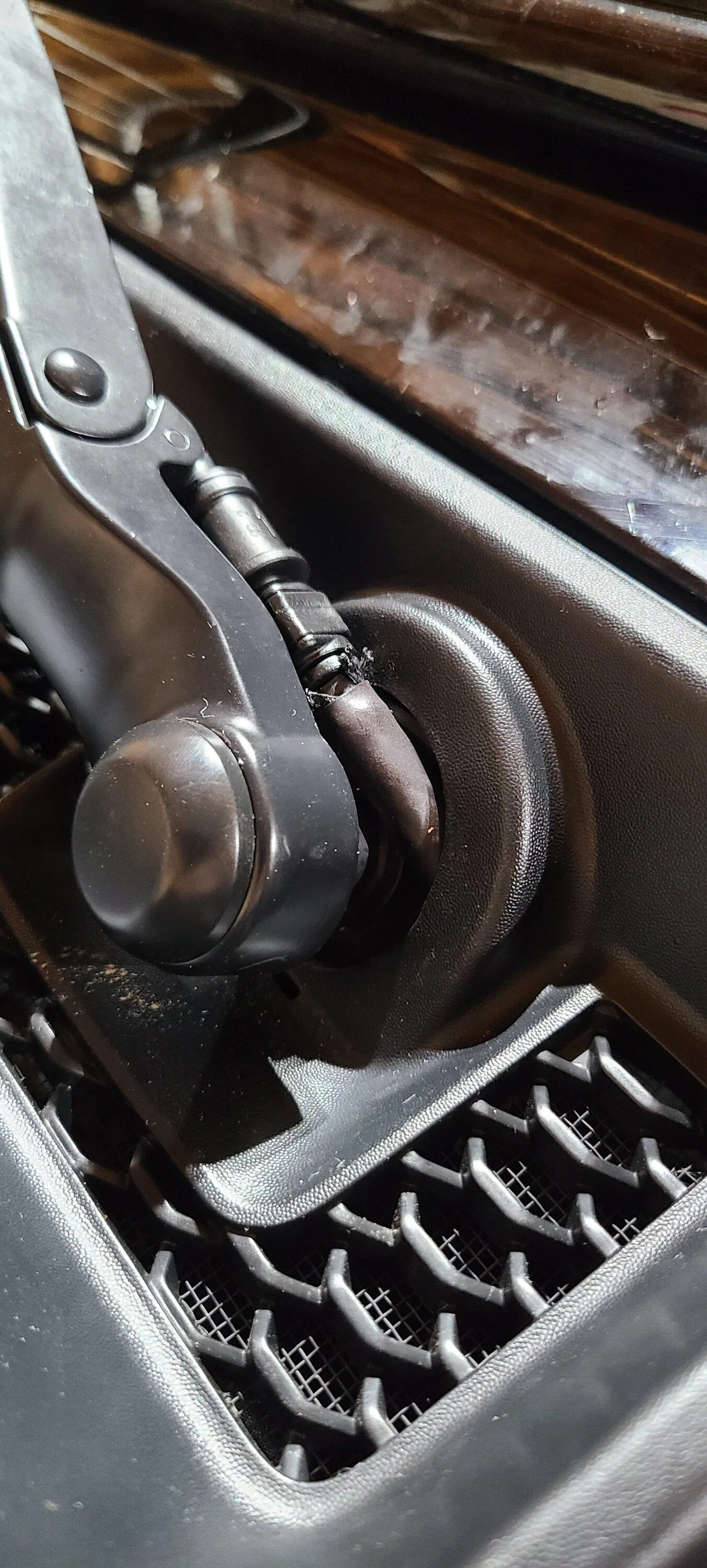

I installed mine today, added the shrink tube to control the fraying and everything sees good. The drivers side tube seems a bit pinched between the plastic cowl trim and wiper arm. The heat shrink already has a mark in it. I worry it could lead to wear and eventually a leak. Any thoughts? Anyone else see this issue?

Same question here... wondering if they have a special fit or if we can put our own blades on them once the originals wear out. I ordered them from BAM, I'll give it a shot and see if the blades are interchangeable with standard ones and report back.

Finally got some cooler weather, so I did my install this morning.
Notes:
  • Painted the nuts because they appeared to have no corrosion protection.
  • The T's that you use to align the wipers are there.
  • The puller was definitely needed
  • I capped the OE line to keep critters and dirt out
  • Use some wire loom to protect the exposed rubber hose
  • Tied the new hose to the old one for added rigidity and support
  • My braided cuts were clean and not frayed but I put some heat shrink on them anyway.
Tested and seem like they'll work fine.
