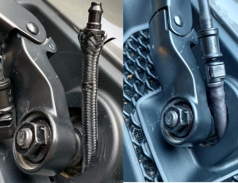

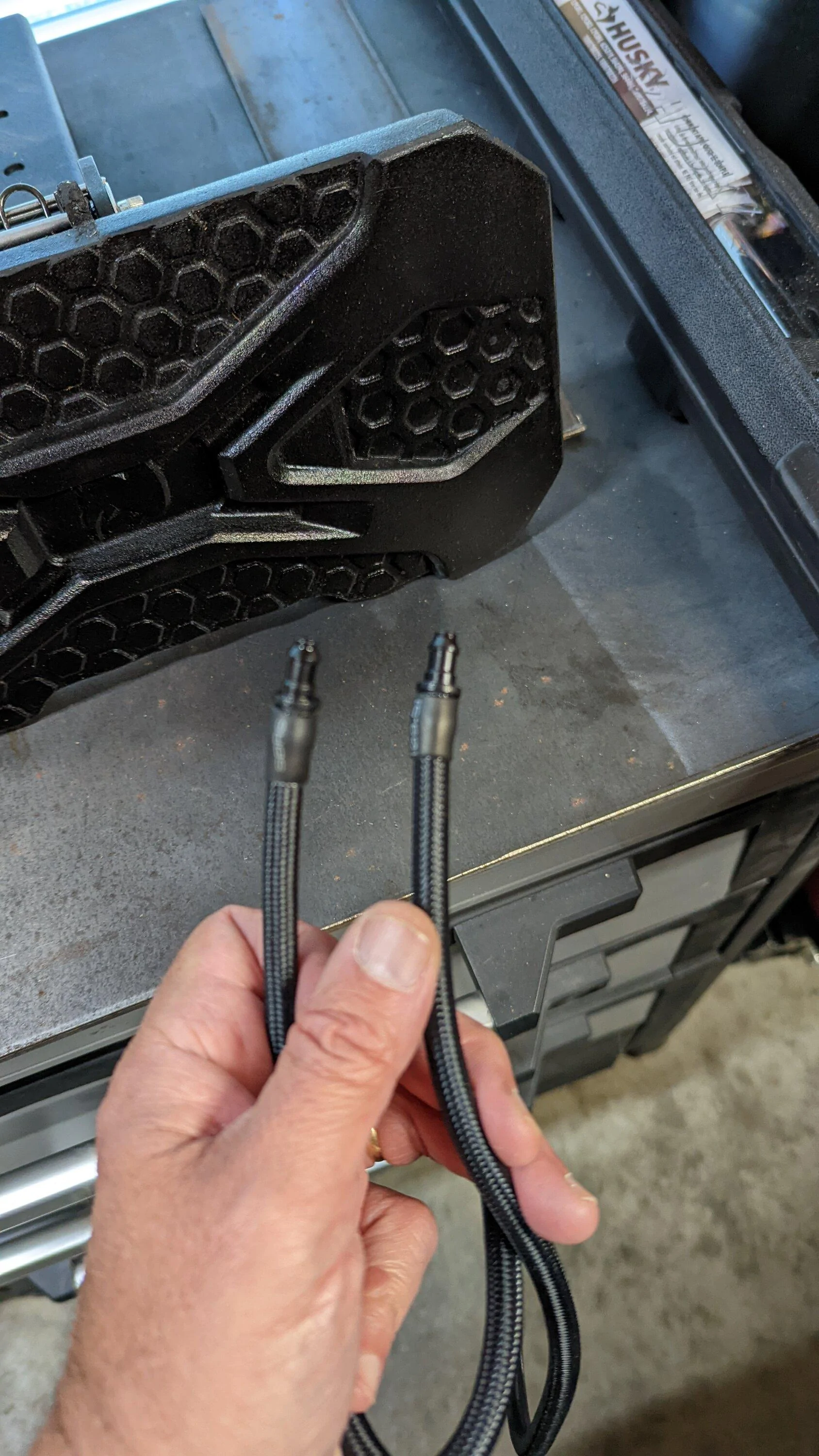

2.) The braided line, though pretty it started to fray a little on the ends.
looks like you need a small black zip tie to stop the braided cover from fraying.
Yeah so the kit came with 2 medium sized zipties. I don't know if it was there for a fix to the issue of the fraying, but there's nothing in the instructions. I may end up putting a little tie or even a drop of superglue to hold it down if it gets bad, for now its hidden and only time will tell.

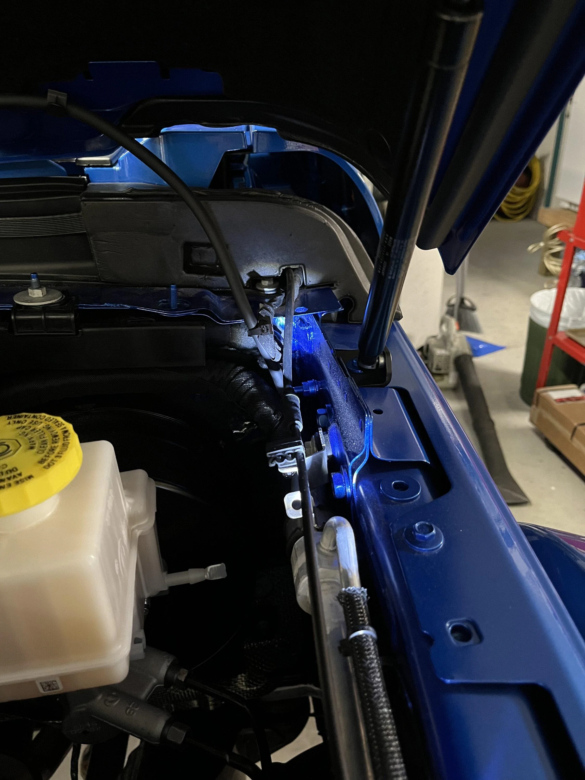

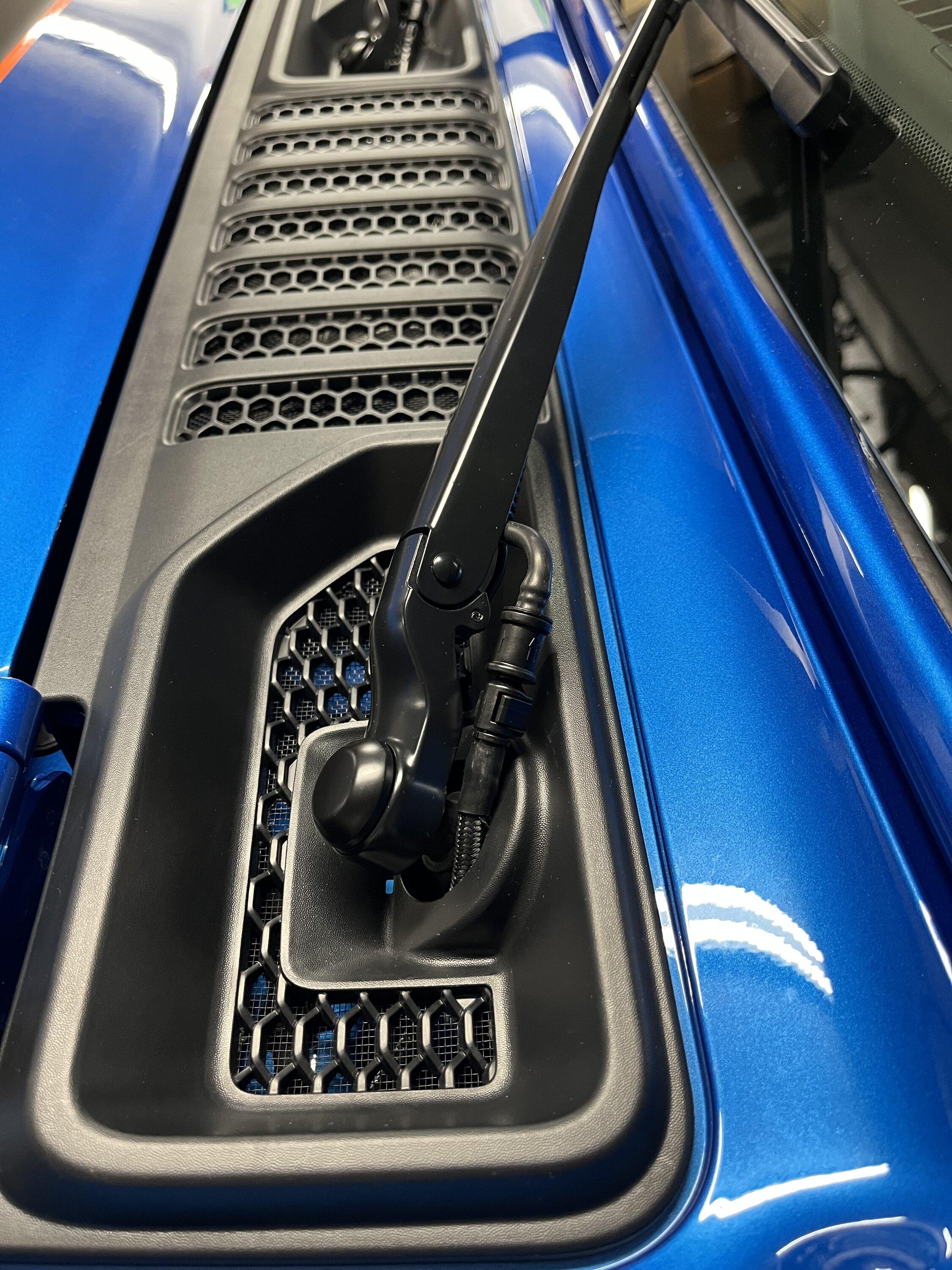

Did the wiper washer mod yesterday. Pretty easy thanks to previous input by others on the forum. MoPar’s directions left a lot to be desired. I took care of the braided line fraying by using heat shrink at all four places. The braided line is just a protective cover for the tubing under it. Heat gun on low heat used. Had just enough hose to get to both wipers. This was after running the line through an existing hole in the foam block at the cowl, (see pic). Different than the posted YouTube video. Wipers came off only with battery terminal puller. Pleased with the end result. Haven’t tested yet. Will do when I wash the truck sometime this week.

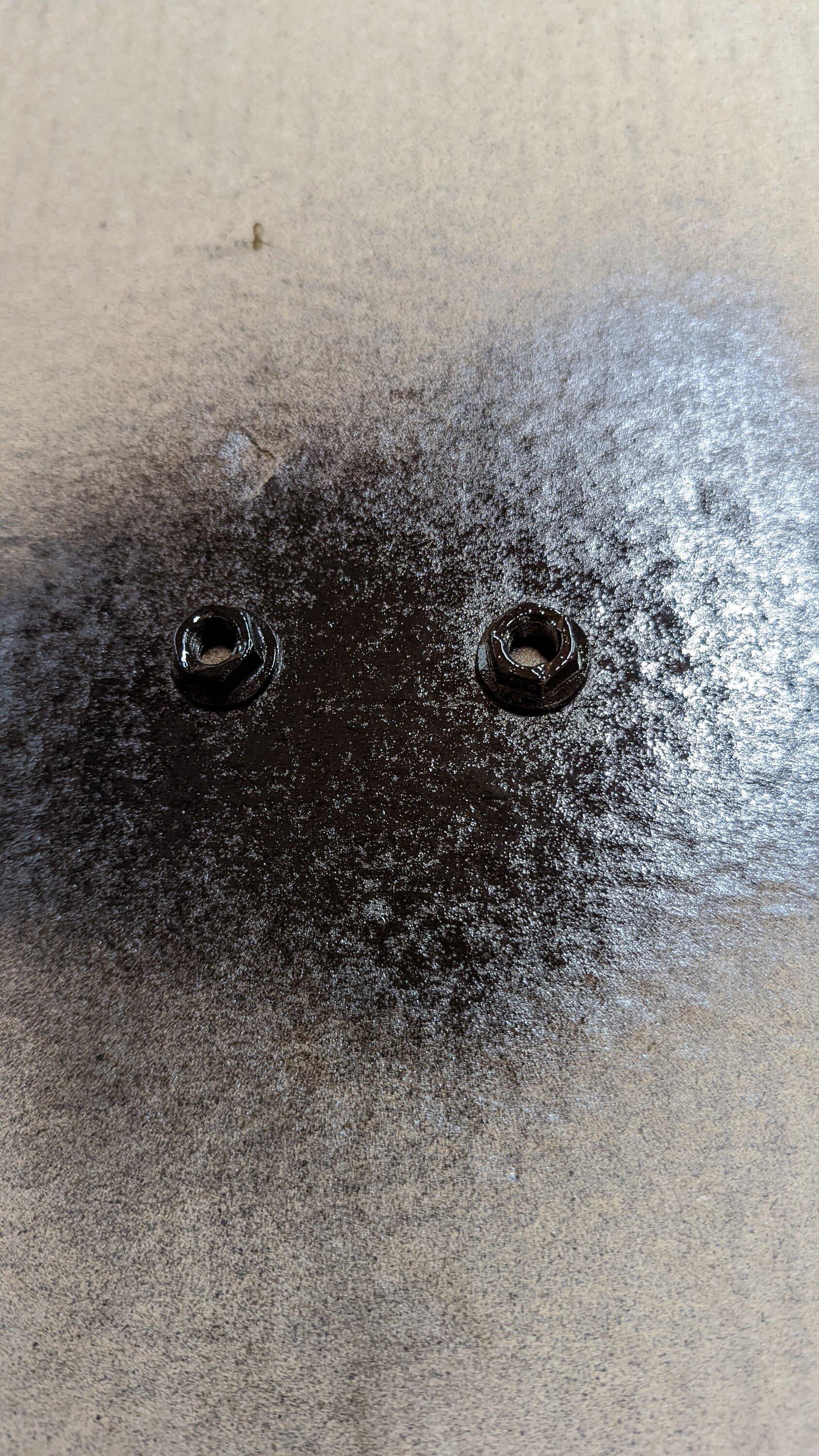

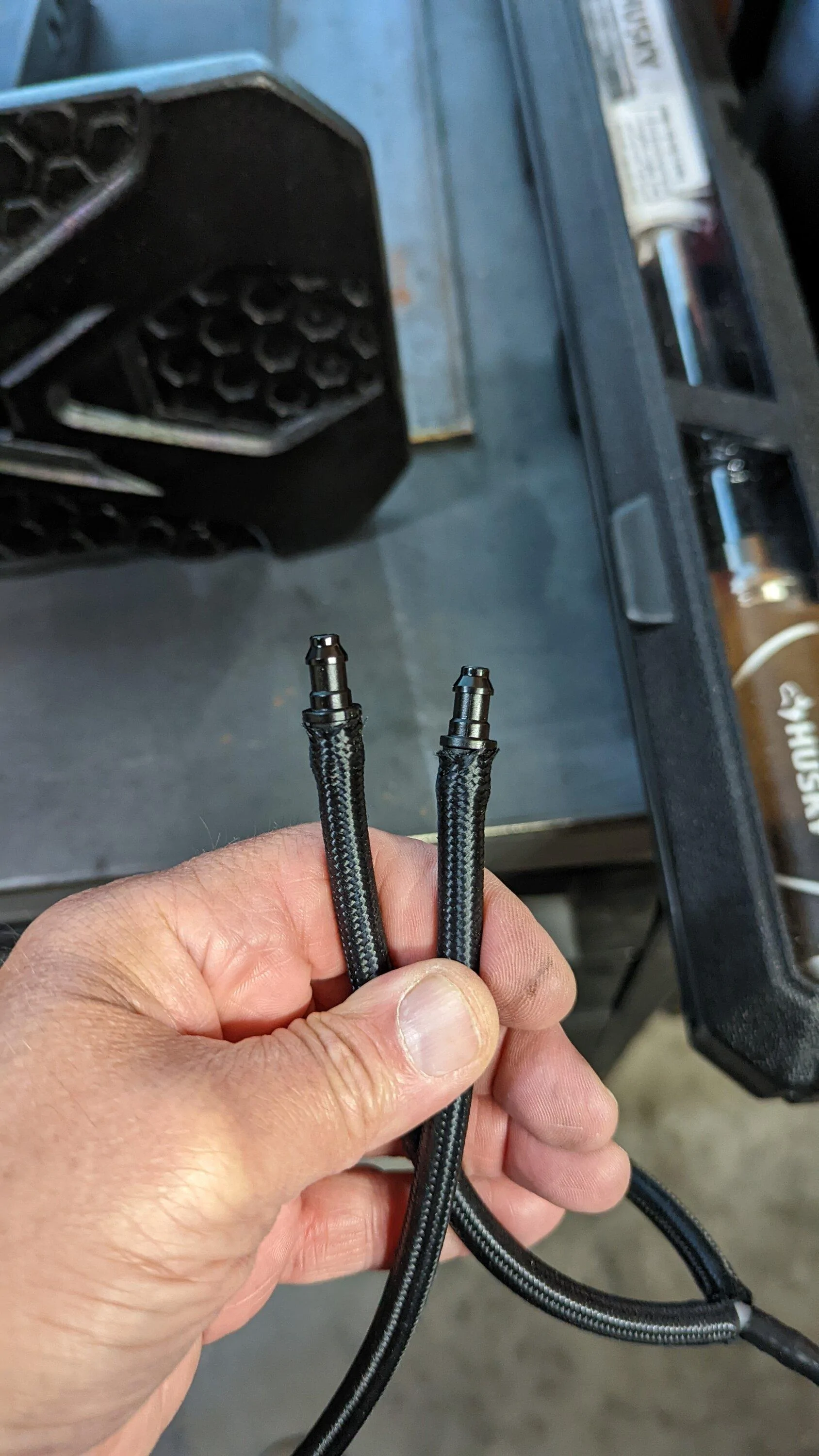

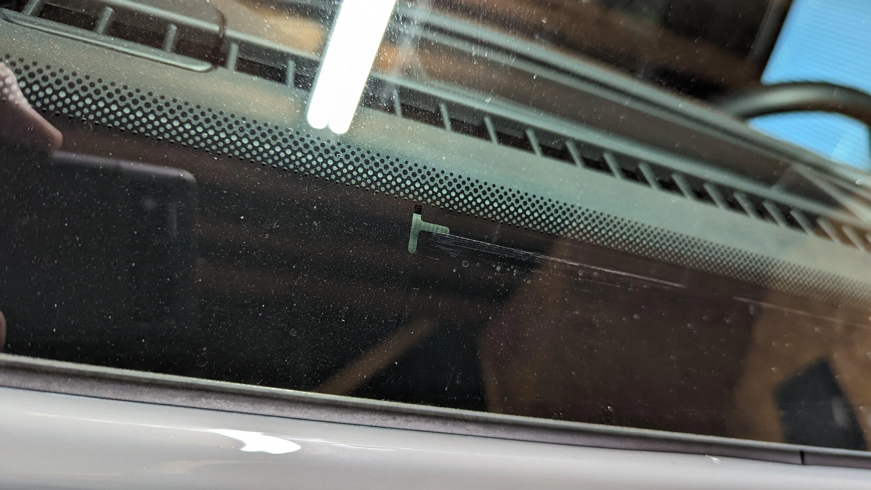

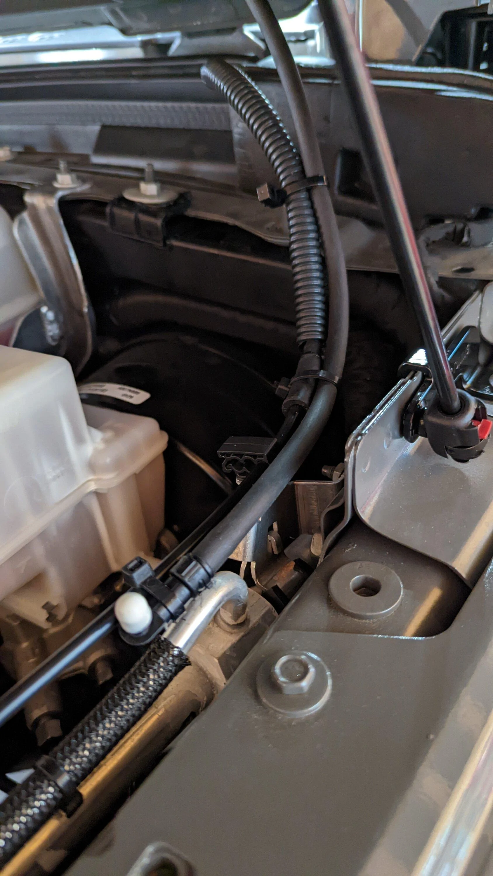

Finally got some cooler weather, so I did my install this morning.
Notes:
  • Painted the nuts because they appeared to have no corrosion protection.
  • The T's that you use to align the wipers are there.
  • The puller was definitely needed
  • I capped the OE line to keep critters and dirt out
  • Use some wire loom to protect the exposed rubber hose
  • Tied the new hose to the old one for added rigidity and support
  • My braided cuts were clean and not frayed but I put some heat shrink on them anyway.
Tested and seem like they'll work fine.

Its funny, being the first to do something has its down falls. I wish I thought about the heat shrink to help the fraying, I wish I thought about capping off the old line etc.
Gatorized
Sep 13, 2019
1,875
1,761
ME/NH
For the price the heat shrink should have been included,
