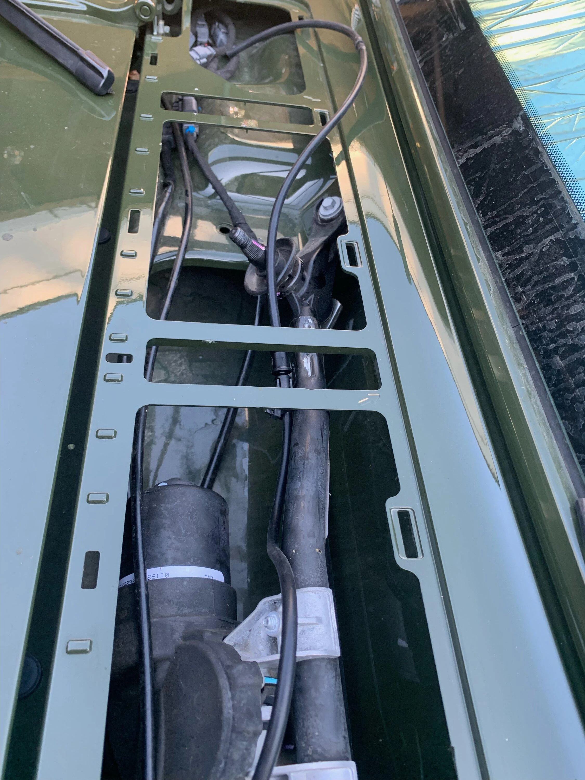

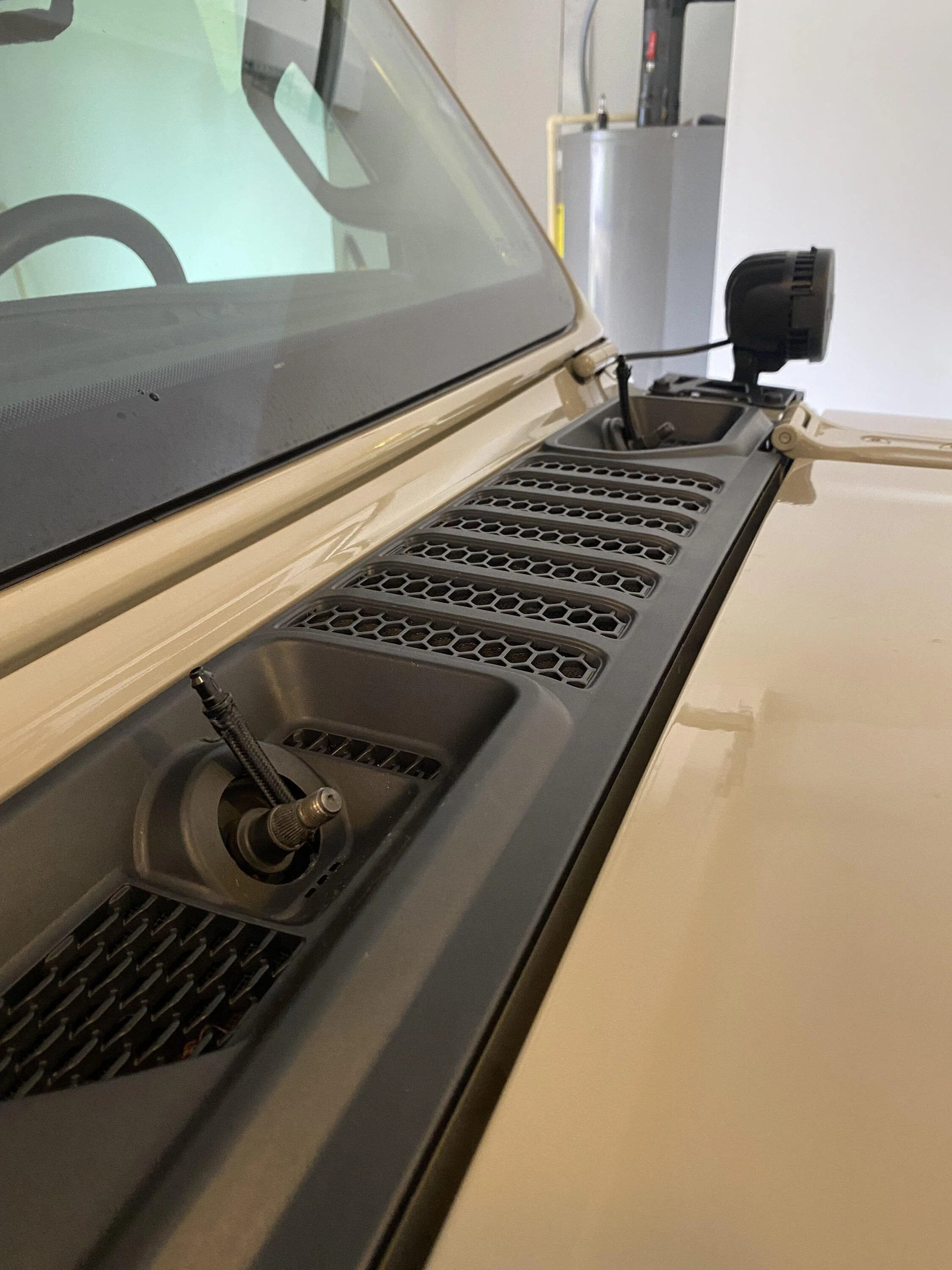

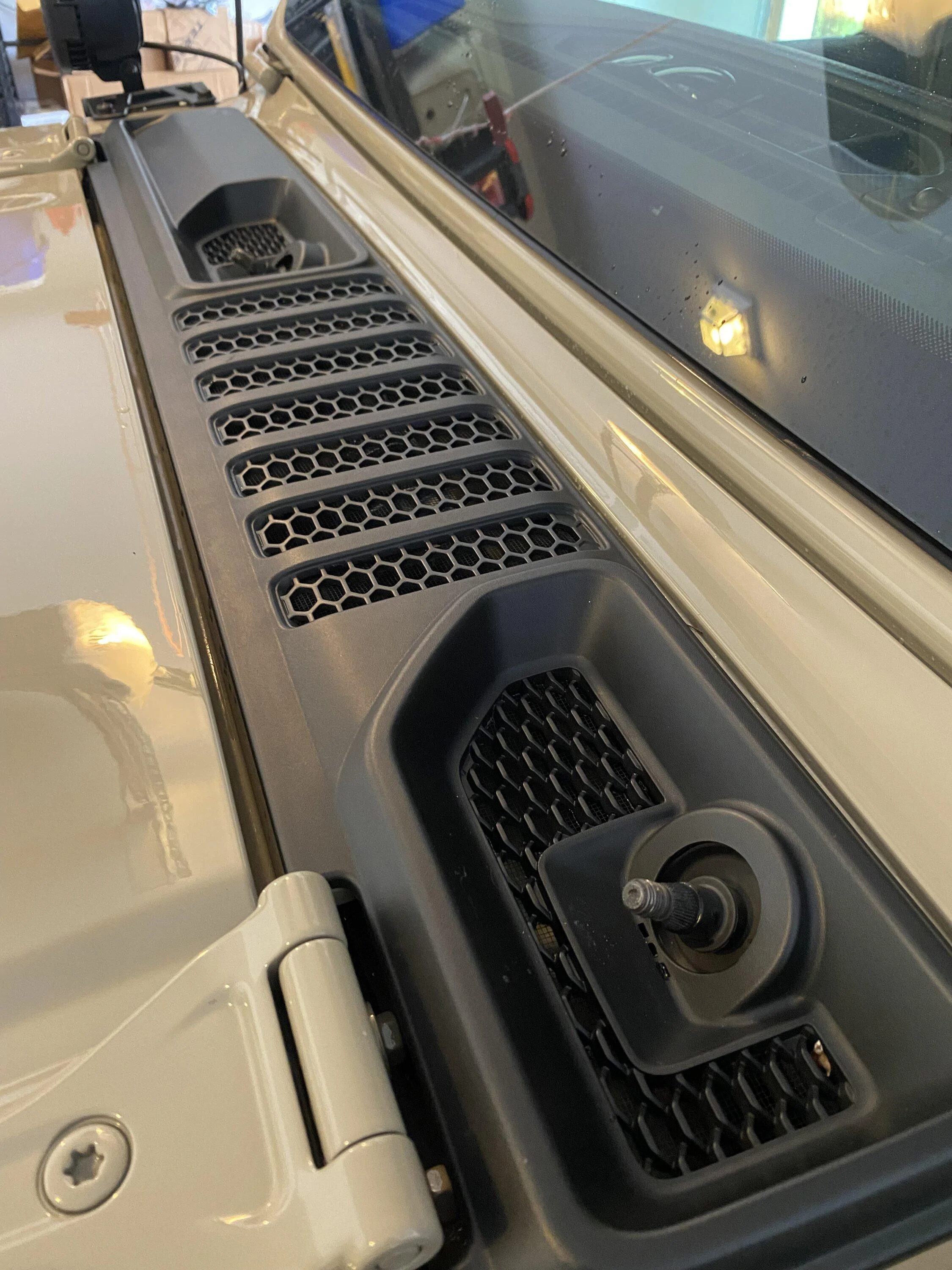

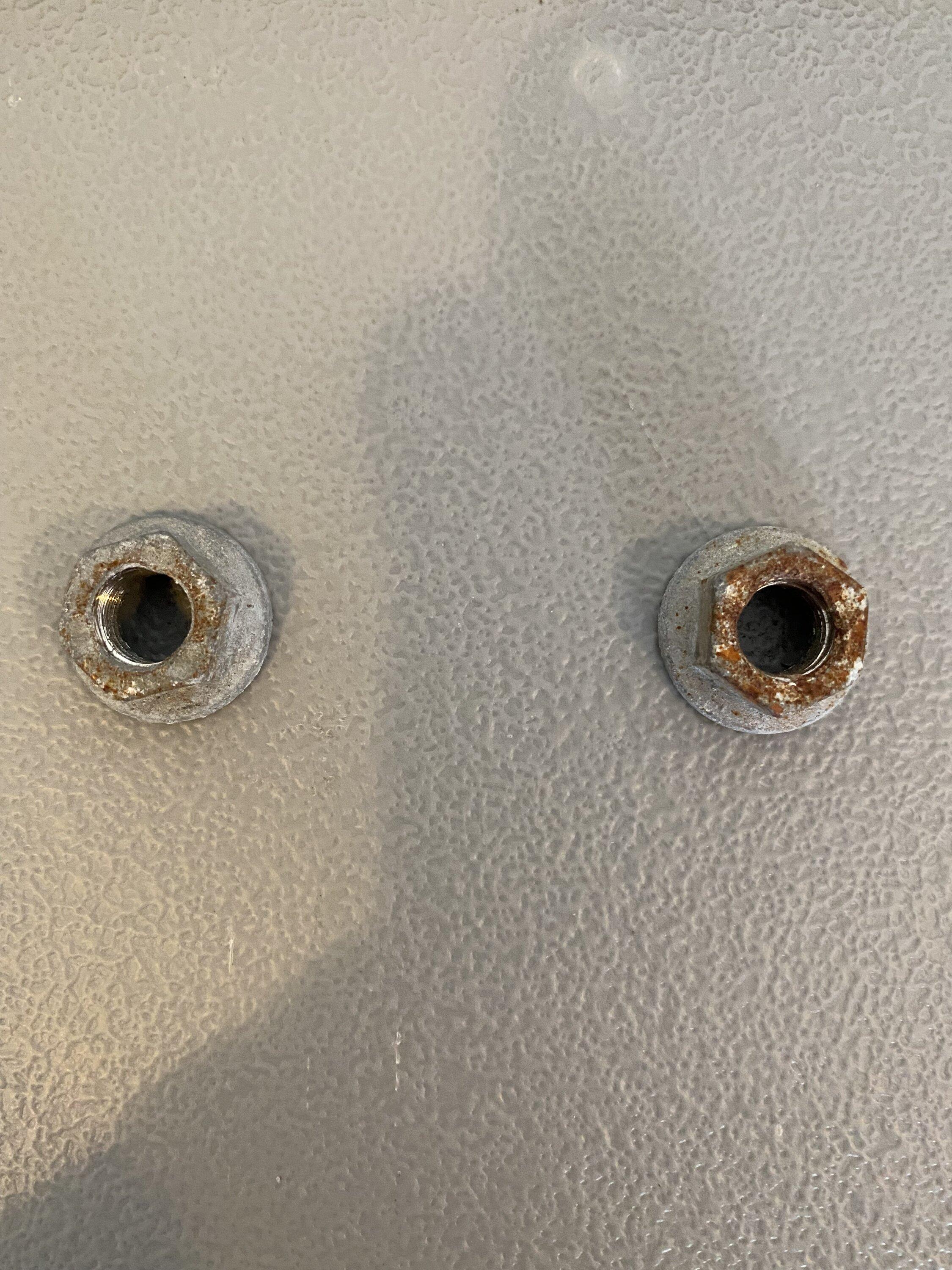

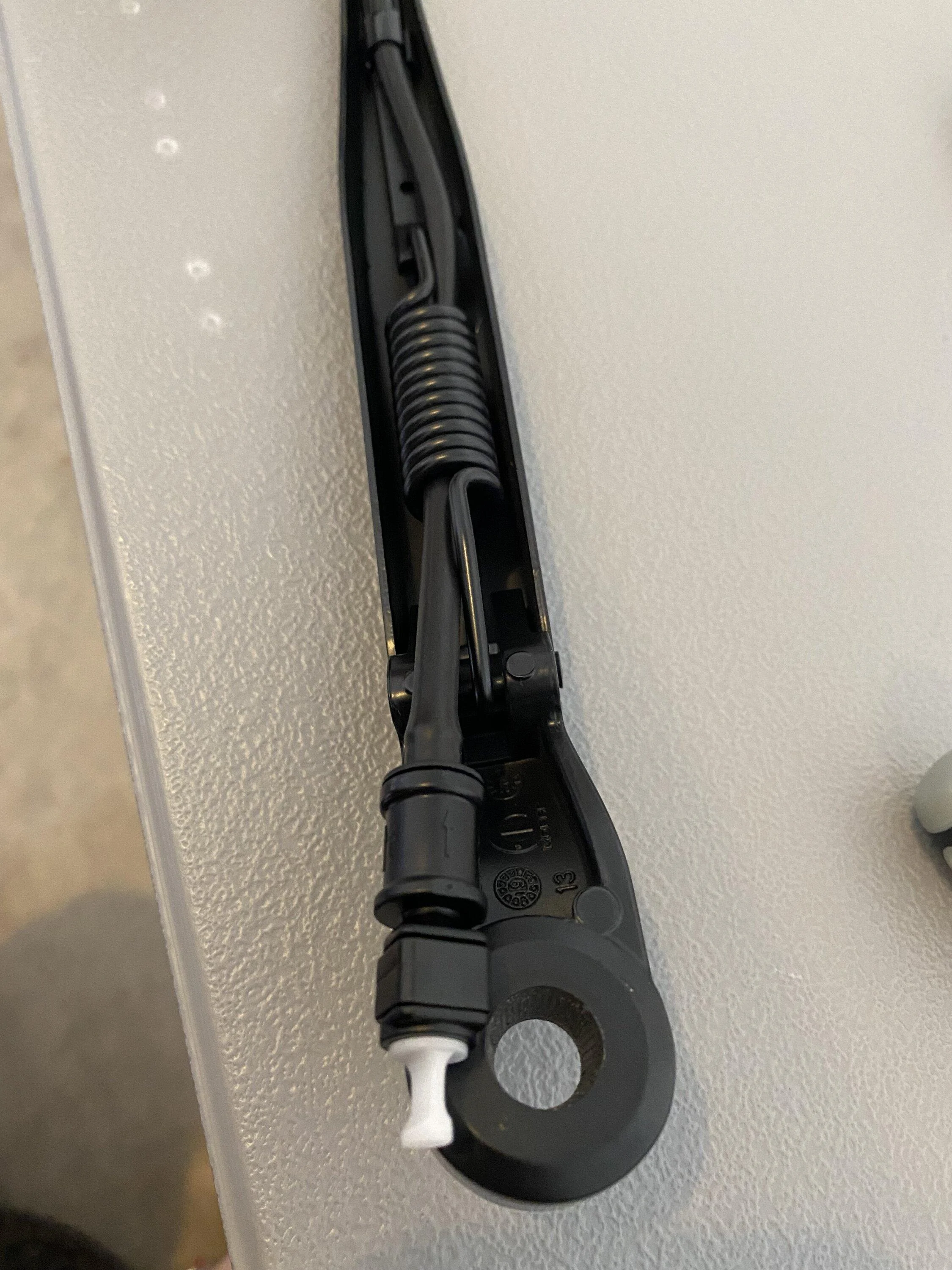

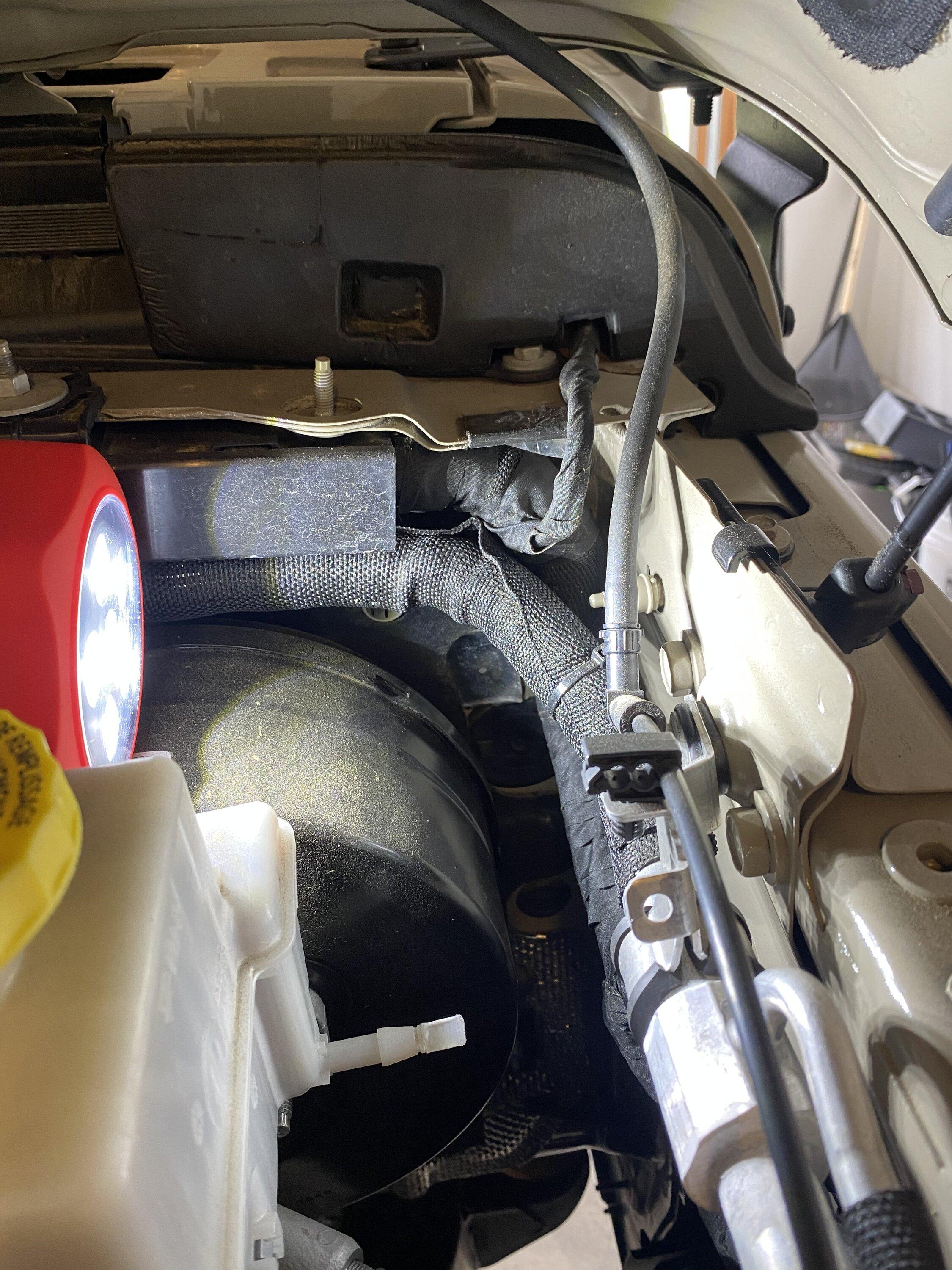

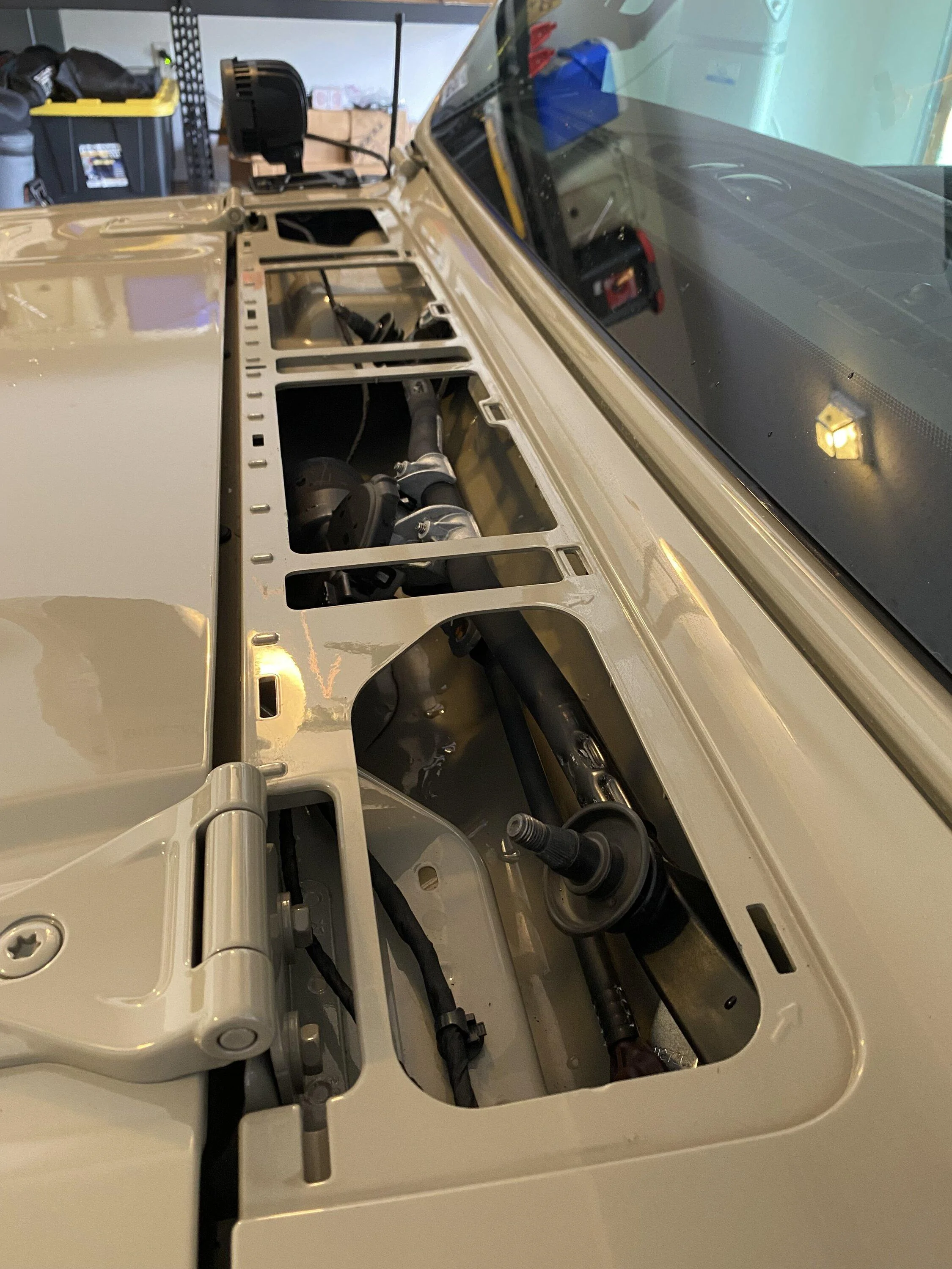

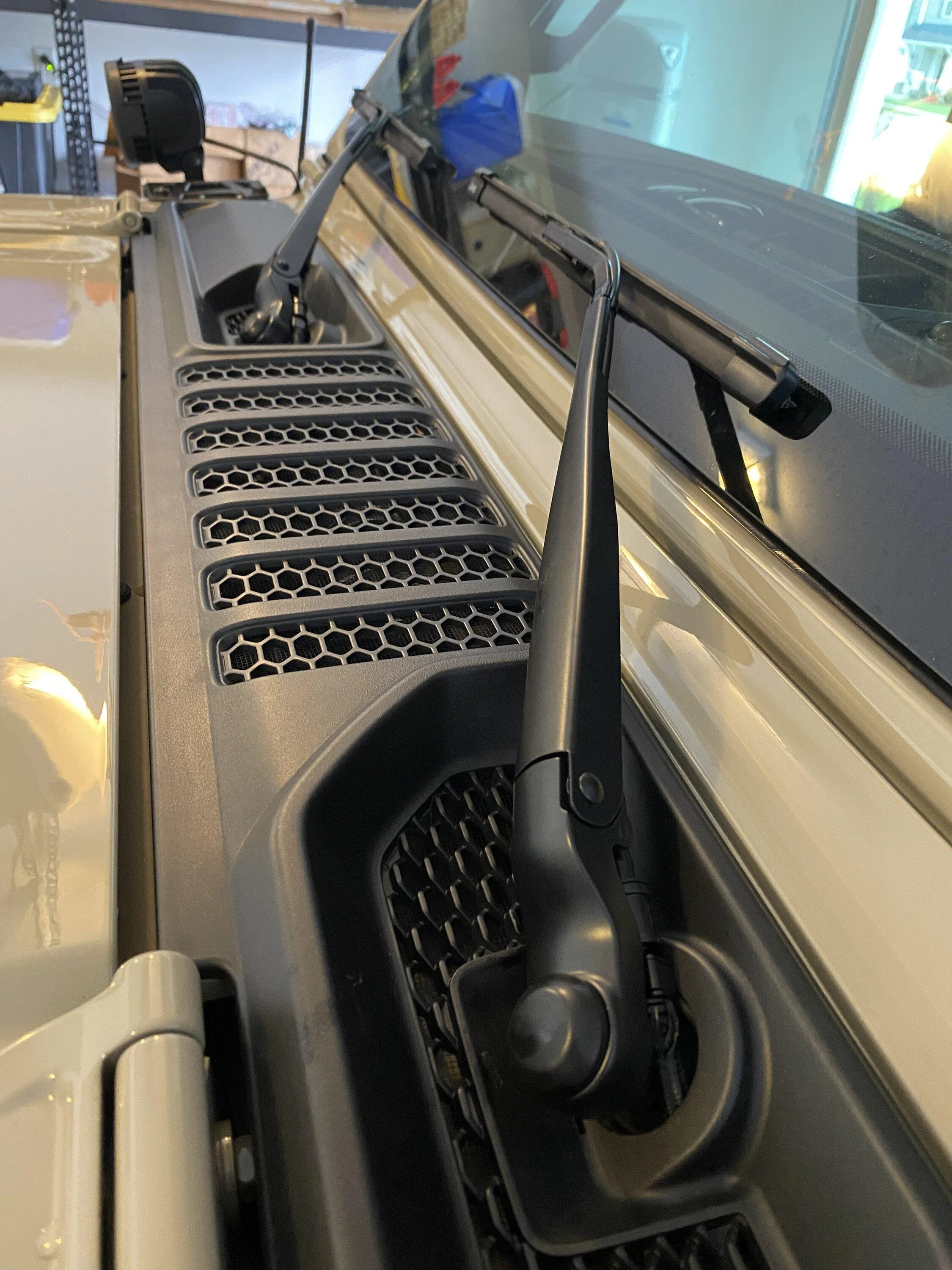

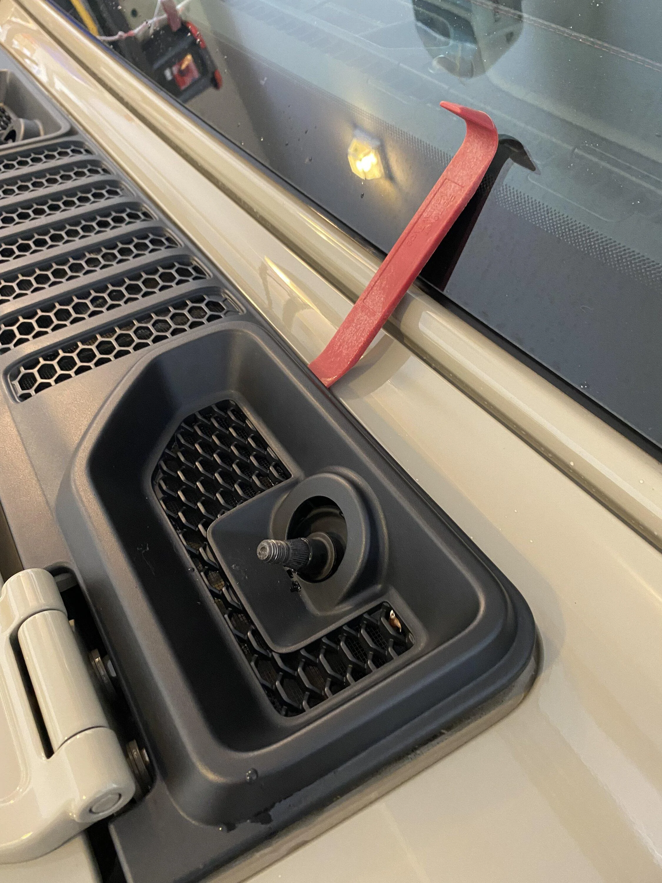

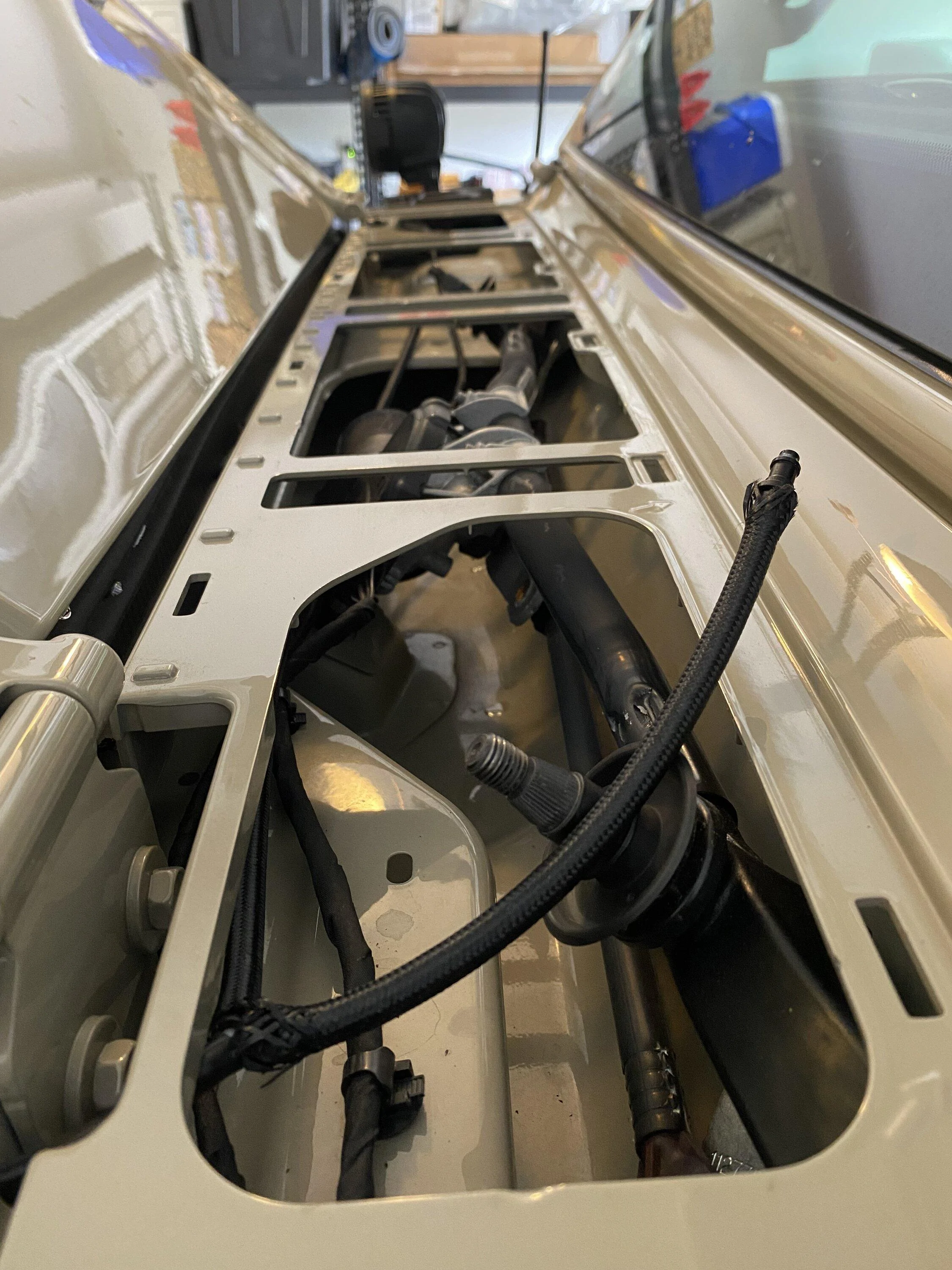

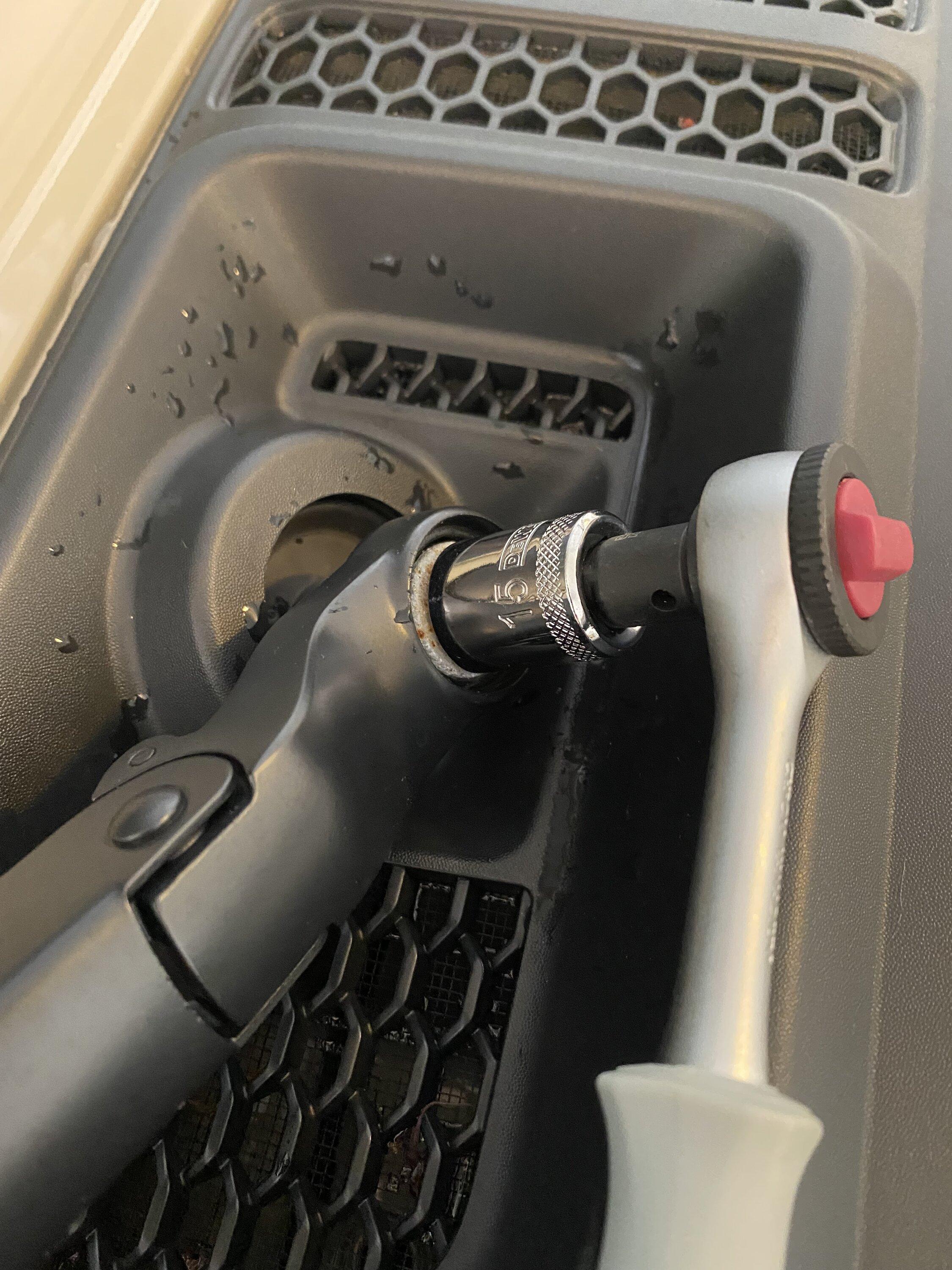

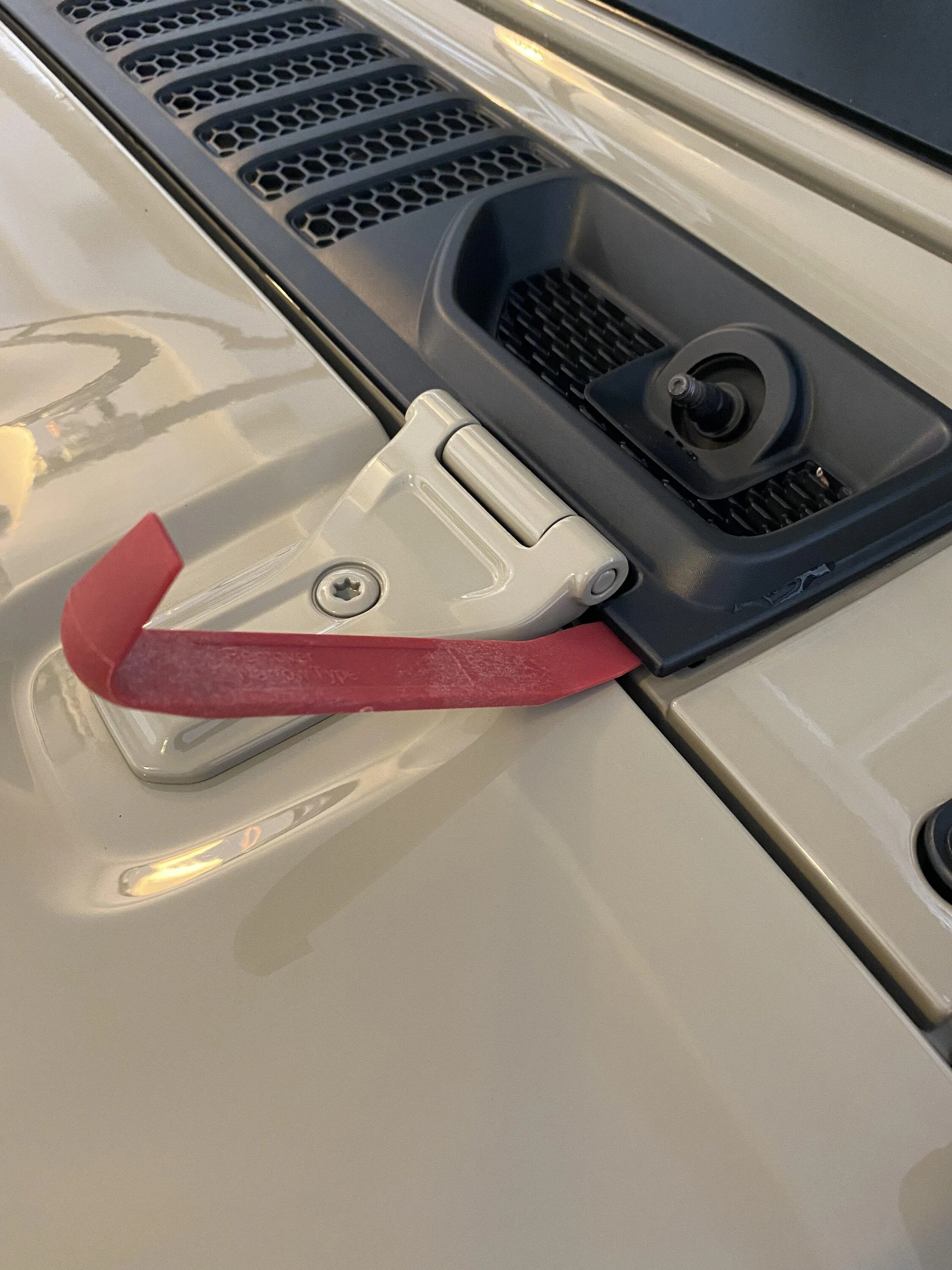

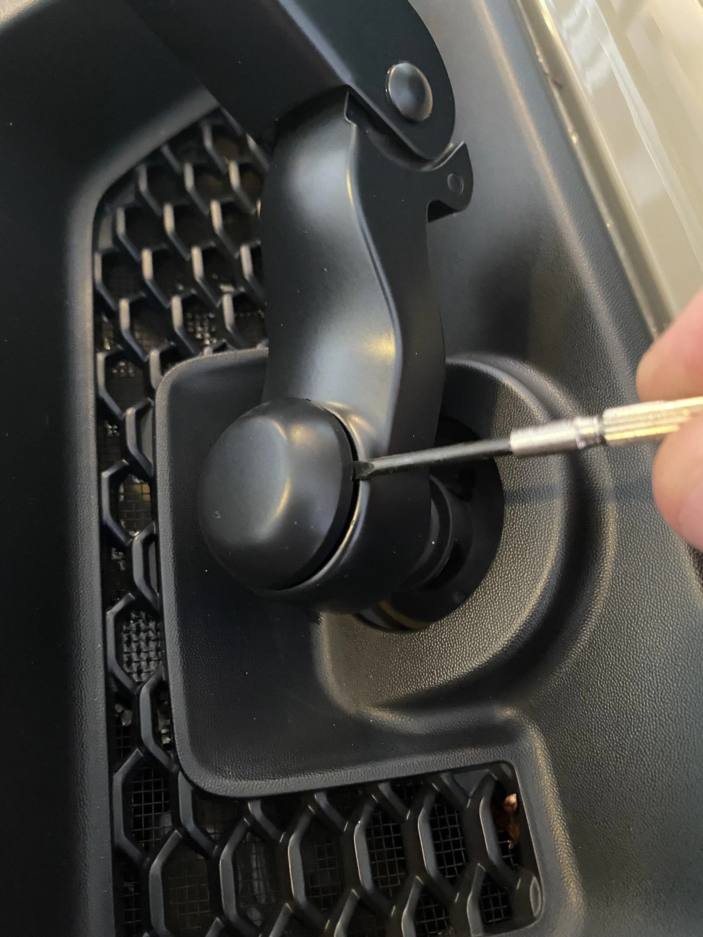

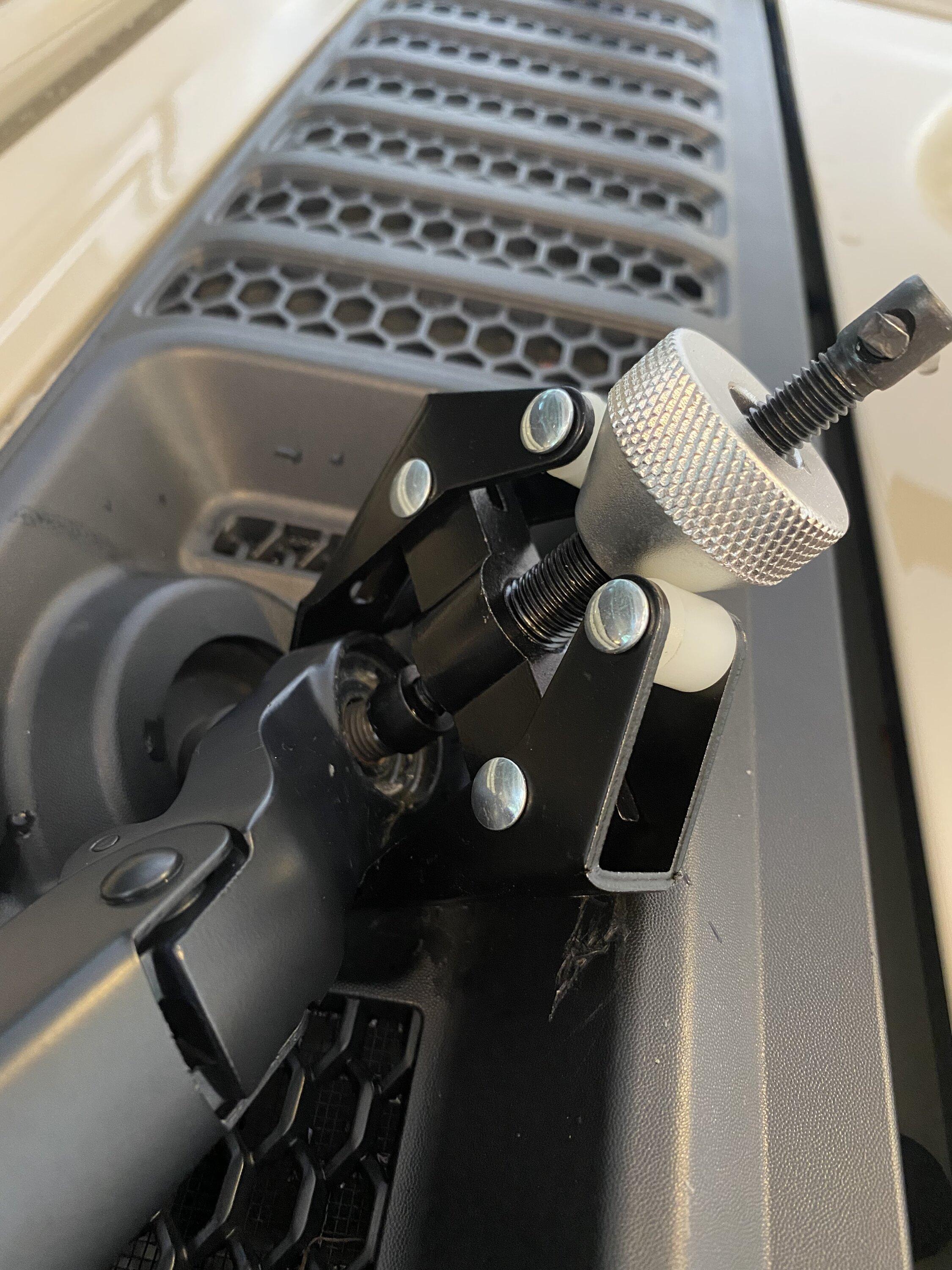

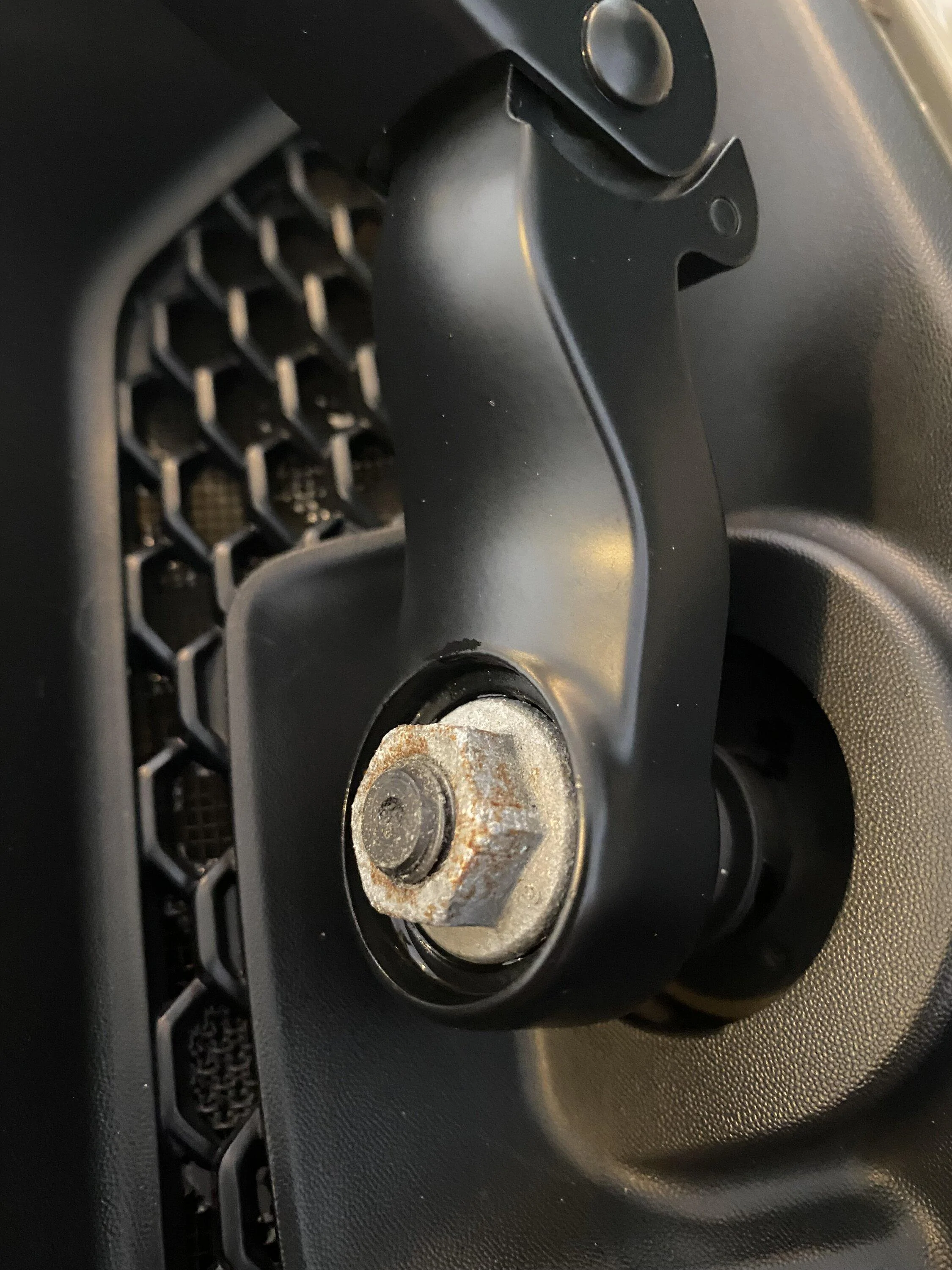

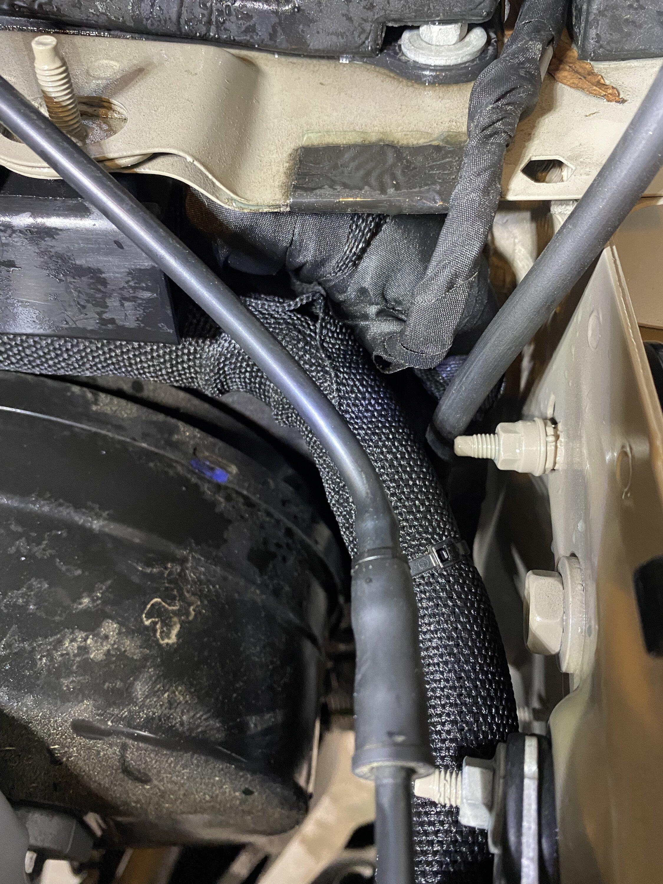

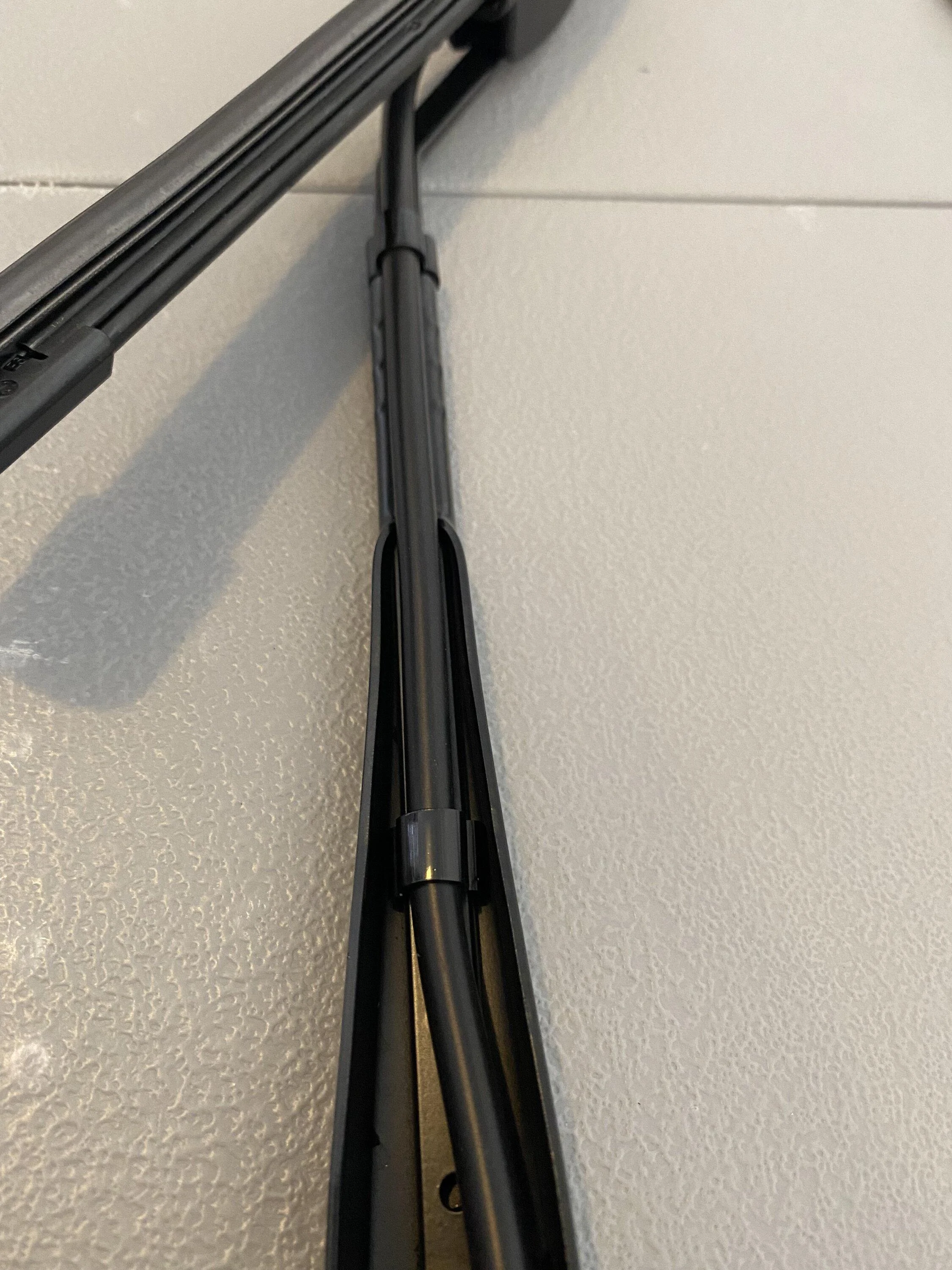

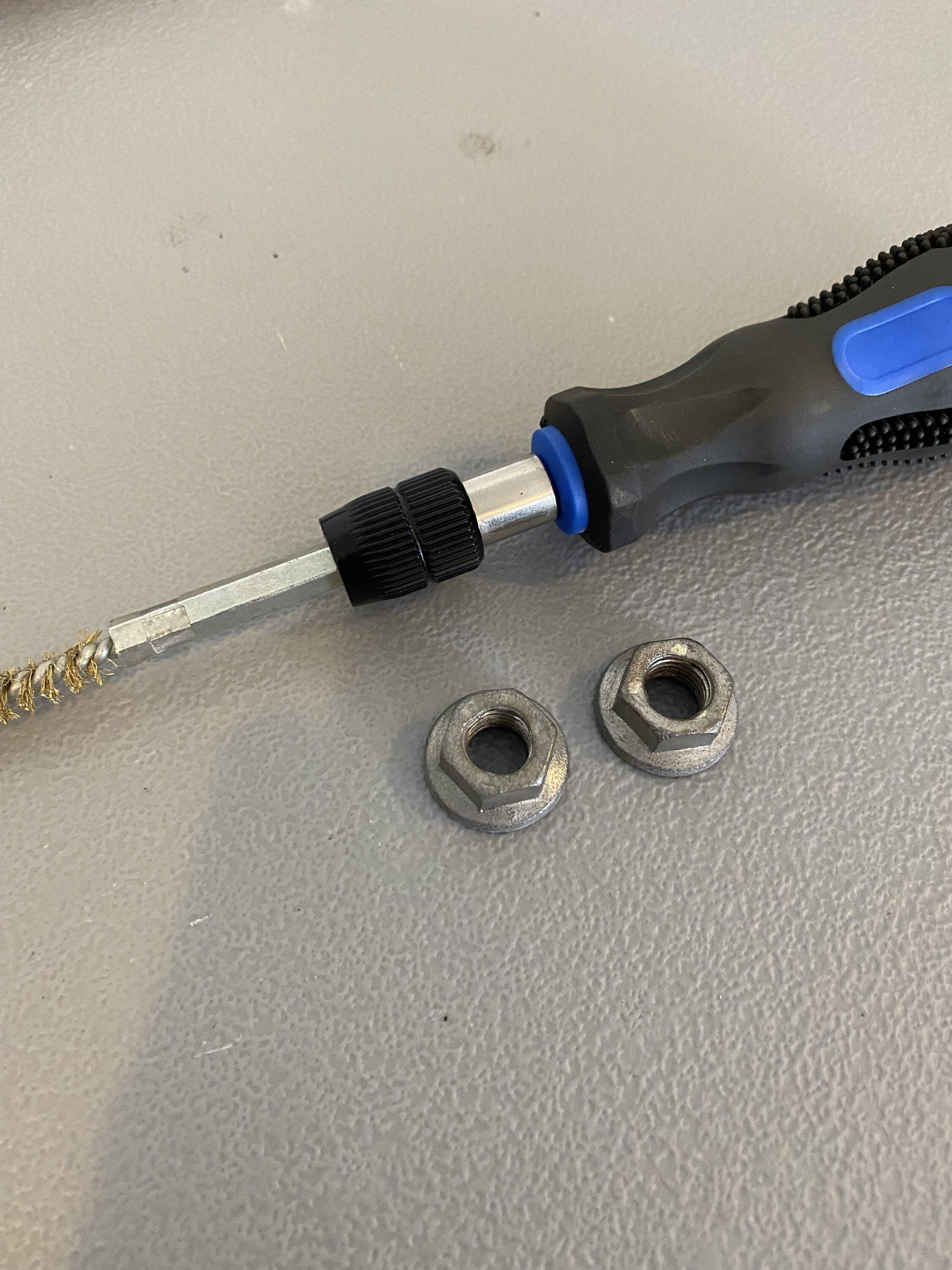

So I thought it would be good to post a more in-depth post about these. First off there are a couple things I don't like. 1.) How very little detail or thought went into these instructions. 2.) The braided line, though pretty it started to fray a little on the ends. With that being said it was a straight forward install. I have a 2020 JTR and defiantly haven't taken the wipers arms off before. Under that little cap you will notice mine were corroded and had some surface rust. It was taken care of by using a brass brush and it came right off, I used a little DW-40 Silicone spray to further prevent the rust from coming back. The wiper arm puller was handy as well. I don't know how I would have got those things off without that tool or really struggling. I did manage to scratch the plastic cowling around the passenger side wiper arm with the puller only because its a weird angle to put it on. There was plenty of hose with the kit and I never felt like I needed more. As you can see where you disconnect the old sprayer hose from the main line notice you do not re-use the elbow anymore. Just pull the elbow out and slide in the new end. Fun fact also you will see indications on your windshield that look like sideways T's those are for wiper alignment so when you are putting the arms back on with the new blades installed, just line them up and slide the arm on the bolt post. Easy squeezy. Need to know anything more feel free to reach out.
This is great. All the photos I wish I took during mine, but with the exact same clean result. Nicely done!

Tested mine just now and I'll definitely have to wait for the puller to arrive next week.
If you're worried about nicking the plastic caps with a screwdriver, a little fishing line worked under them like dental floss works great.
Dental floss might work too ?
