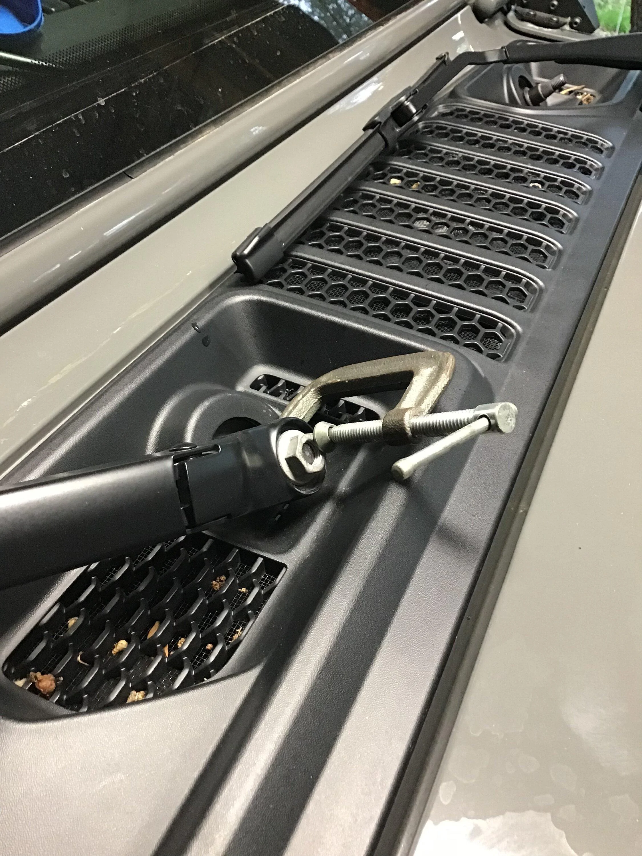

Received & installed mine today. It took about ½-hr.
The braided line cover was in pretty good shape, but I went ahead and put ~5mm of weatherized heatshrink on the ends anyway (weatherized heatshrink tubing has some sealant inside the tubing.)
I didn't need a puller for the wiper arms, but I've had the arms off before.
I need to reposition the nasty little tubing clips, and there's a mod. I'm gonna make once the parts arrive, then I'll put up some pictures.
All in all, I'm happy with the product.

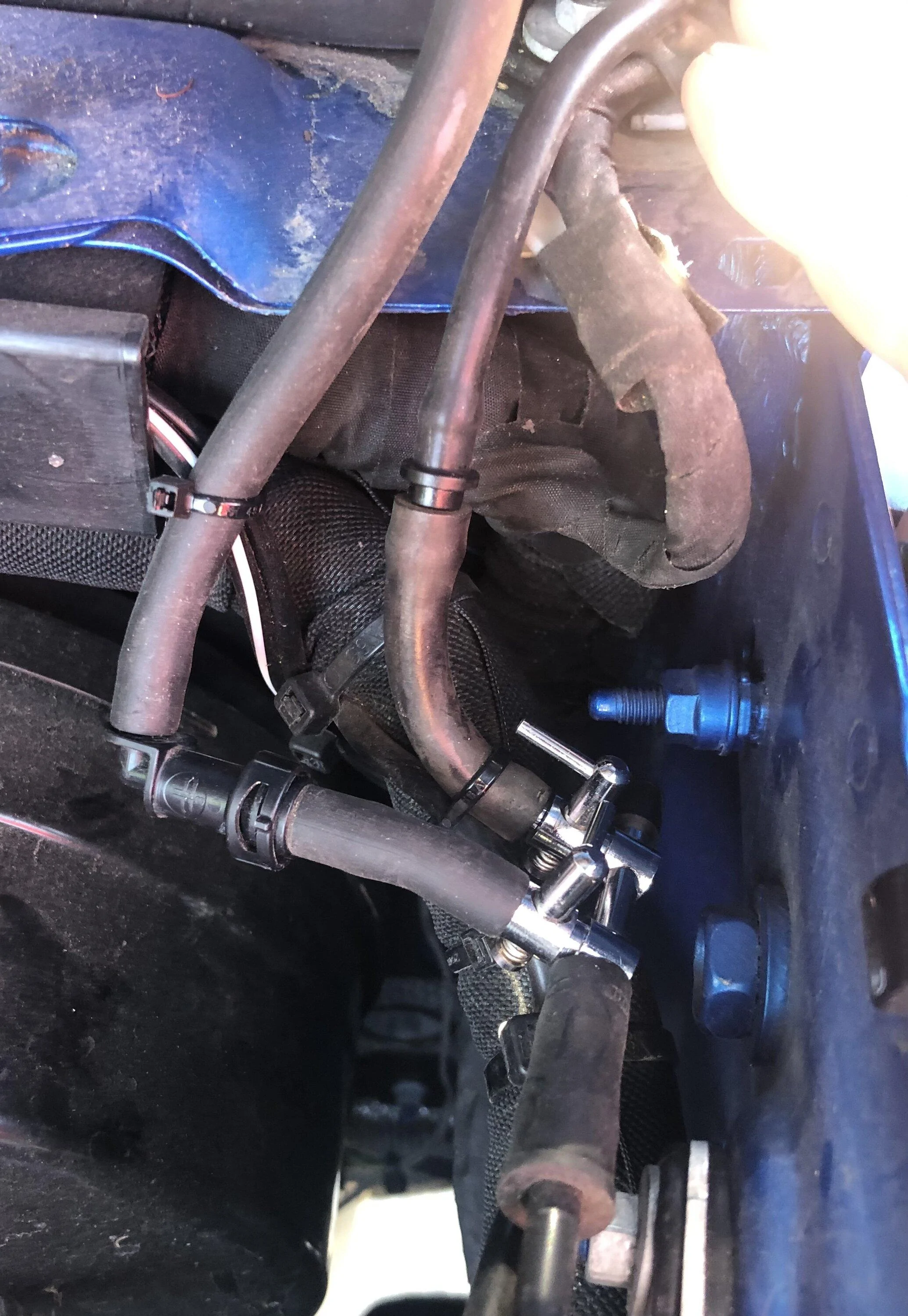

I put in a valve assembly so I can choose either set of sprayers.
Partially because it gives me options, partially because my OCD won’t let me abandon stuff in place.
One note:
The elbow in the stock line is also a quick-disconnect, making hood removal one step easier.
