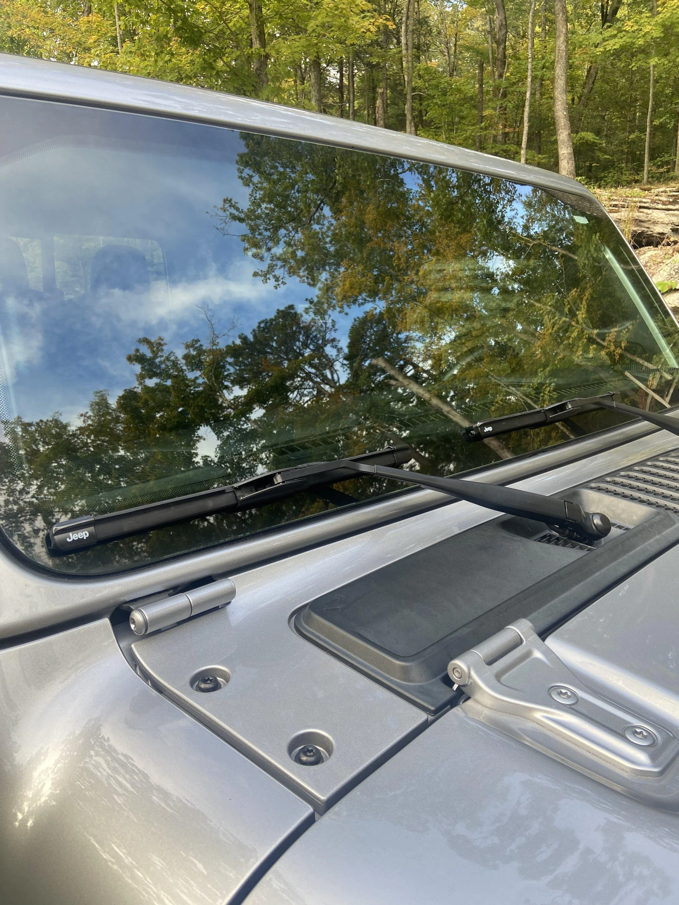

I went on a test run to also check the new paddle shifters. The wipers seem to work really well. Of course the windshield was already completely clean. They come with a second set of wipers which is cool. No idea what replacements cost. I assume less than the whole kit.

Be cool if someone can quote a price on replacements. The blades are also good (typo: food) quality?

Refills are generic and really cheap for my other car that has these same type of blades. I buy the 6 mm silicon refills from Amazon, 4 for $10. Just changed mine out and they work great. You'll have to trim them to fit, but that and install is easy.
