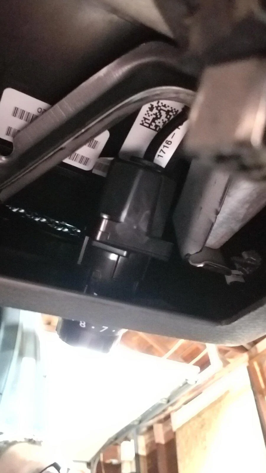

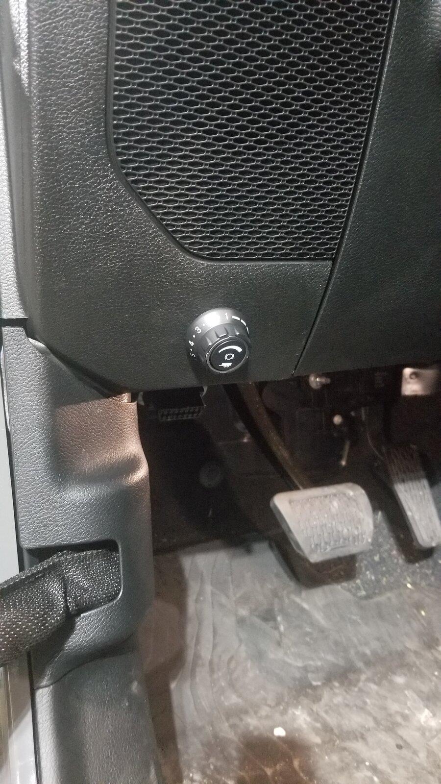

Did you remove the panel or drill in place? Any tips on drilling, this is by far my favorite location
I removed the panel but with a steady hand you wouldn't have to. I used a dremel with a small bit and made a template from the spot where the 12v is. The second pic I added because there is a brace behind that panel and you want to make sure the controller is centered with it.
