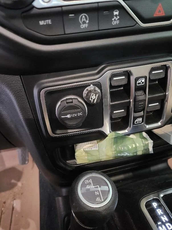

So, I went in this direction, following some of the advice I got here. It's not for the faint of heart; you have to be spot on while drilling the hole and there's a fair amount of support plastic on the back side you need to trim away.
Best of both worlds. It's close to hand for emergencies and I still use a GPS that requires a 12v outlet.

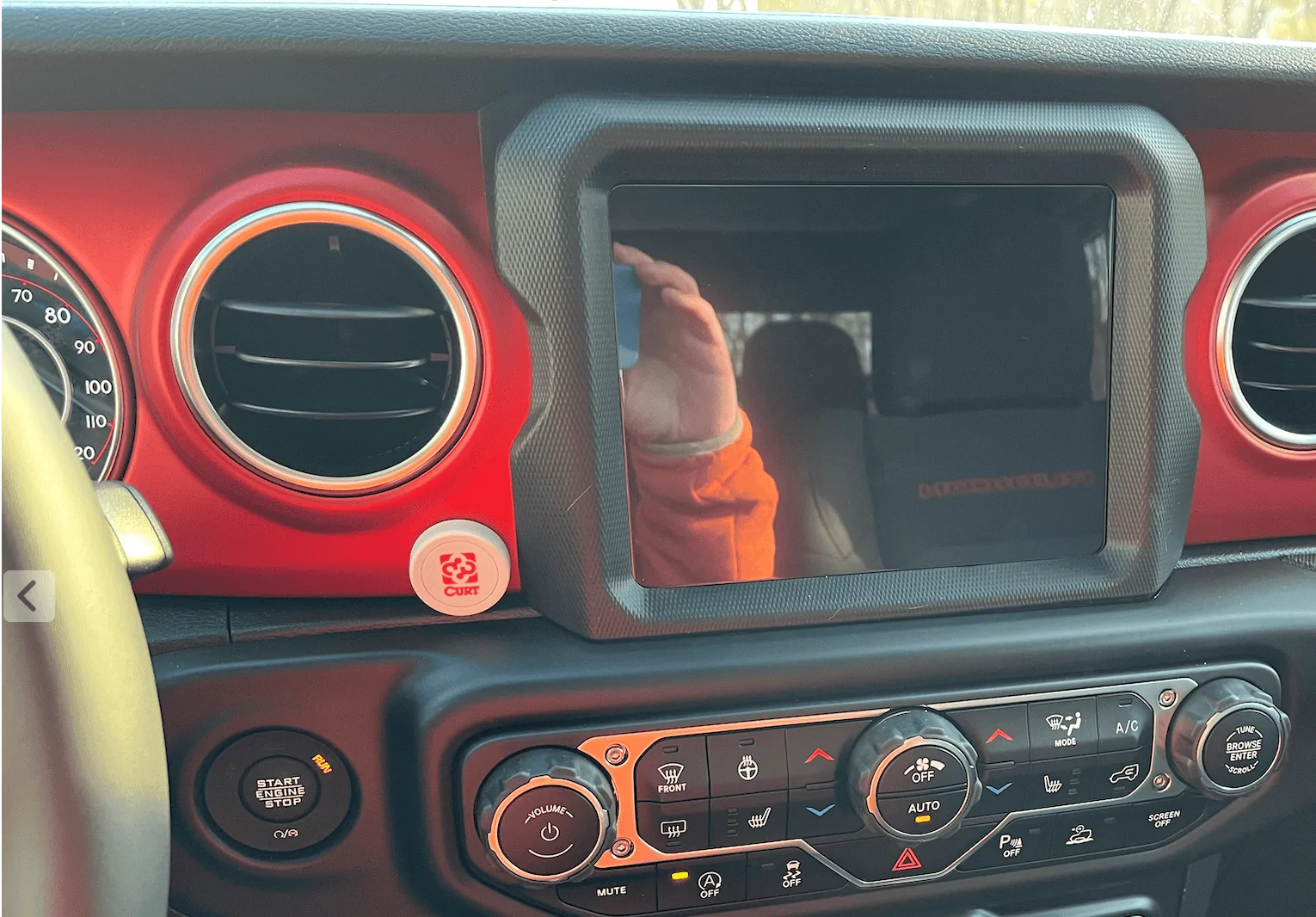

I put my Curt controller on the left side of the steering wheel.

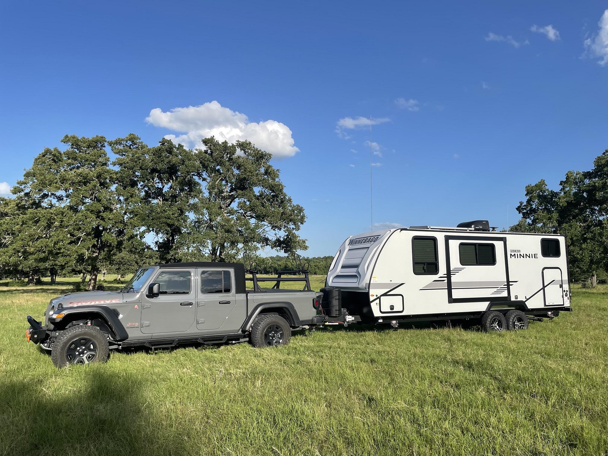

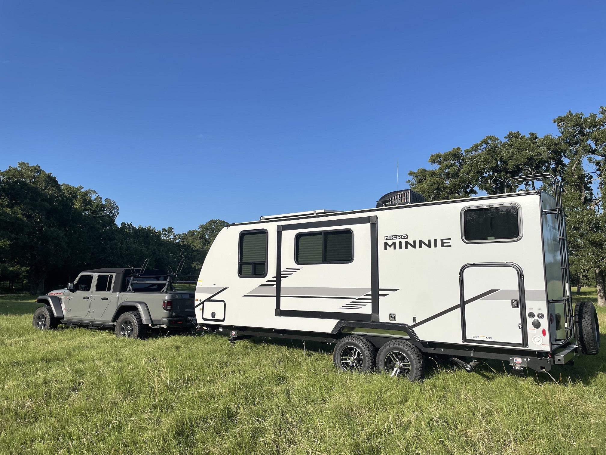

I forgot to post a pic, just for fun. The Curt Echo handles the RV like a champ.
This pic was before I added the airlift bags and adjusted the WDH to help the squat. Also before I adjusted the hitch to level the trailer. Also before the drought gremlins killed all green stuff in a 200 miles radius. Also I am annoyed that the forum does not allow .heic pics so I had to convert this to jpeg first.
