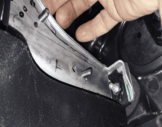

I'm not sure that I would agree that they both can't be made to fit.....here's why. I installed my controller... the controller mounted to the bracket using upper hole in the bracket bend and one way up high on that same bracket, while being mounted on the outside of the bracket, per the MOPAR instruction, IMAGE 1.

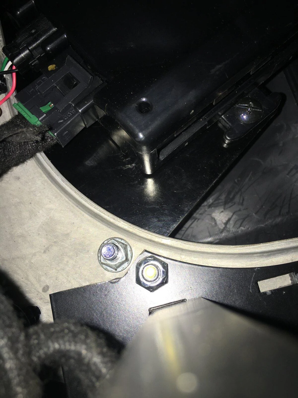

In reading through the MORE installation instructions, it mounts in the lower, unused hole in the bend of the same bracket and the other unused hole closer to the firewall in the same bracket, but on the inside of the bracket, IMAGE 2, such that it doesn't appear to have any interference with the module mounted on the other side of the bracket.

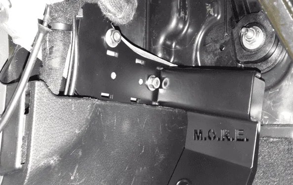

Where it will interfere is where the MORE bracket corner extends over the hole previously used to mount the controller, IMAGE 3. However, there seems to be little reason why that corner of the MORE bracket couldn't be trimmed off, or a hole drilled in to large enough for the controller nut to to avoid conflict with the controller mounting screw and nut.
I think a key issue here maybe...did the dealer install the controller on the inside or outside of that bracket? MOPAR instruction installation indicate to put it on the outside as in my picture, IMAGE 1.

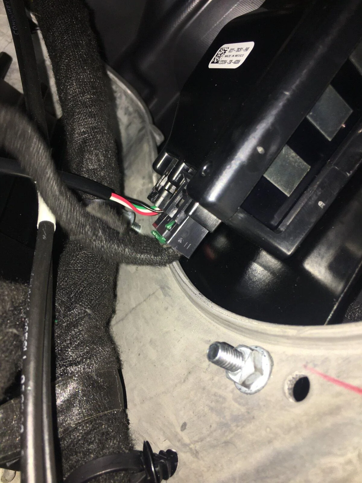

I will be installing this tonight. Thank god for the pictures here, the instructions sucked and I had no idea where the module mounted. My JTR has a build date of 1/2020, I am hoping I don't need a flash.

Installed mine today. What a pain in the rear. Really mopar could you have made that any more painful?
Hardest part of the knob install was getting the 12v socket out. Now that i know what to do it would be easier 2nd time.
Now the controller box. The mounting.. my back will never be the same. A contortionist would be helpful. There was a plug harness taped to the body inner wall right where the controller goes so that needed to be undone. Getting the upper nut on was a test of patience. Connect the harnesses before putting nuts on. Ask me how i know. The hole for the upper nut needs the Christmas tree plug removed. No good way to get at it some cursing was involved.
Cord from the knob just makes it. The cord to the vehicle harness is ridiculously long.
It's done but my kids may have increased their vocabulary.

Confimed....M.O.R.E Dead Peddle DOES fit with factory MOPAR Brake Controller. As promised, I order ed the pedal and installed it yesterday. As expected, the pedal bracket which follows the contours of the dash brace to which the controller is mounted does interfere with the controller mounting screws (image 1). However, a simple trim of the MORE bracket to avoid conflict with the controller mounting screw/nut and it's in....Image 2. While I could have been slicker by measuring the screw centers of the controller mount screw and the dead pedal screw and drilled a 1/2" hole in the bracket for the existing controller mounting nut, working up there is so tight , and the amount of material left on the MORE bracket would have been so minimal that I choose to simply cut it as illustrated.
Jeep Gladiator Mopar Trailer Brake Controller for Jeep Gladiator Officially Released (Part # 82215652AB) mounted more dead peddl
Jeep Gladiator Mopar Trailer Brake Controller for Jeep Gladiator Officially Released (Part # 82215652AB) more pedal cut
