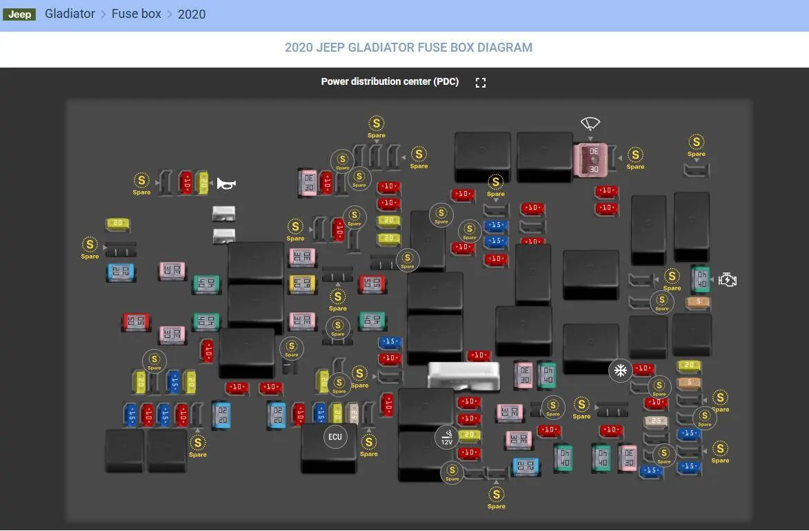

After researching problems with the integrated center stack module I saw on one of the Wrangler forums where someone had a bent pin on the underside of the power distribution center. I checked mine and sure enough there was a bent pin for fuse 105. Like that post said, I carefully straightened it and very carefully assembled the PDC and the came right up when I connected everything and started the Jeep. I can now see why most people opt to go through the fender when replacing the auxiliary battery. I'm very glad I was able to repair everything without going to the dealer with the help of information through the various forums.
