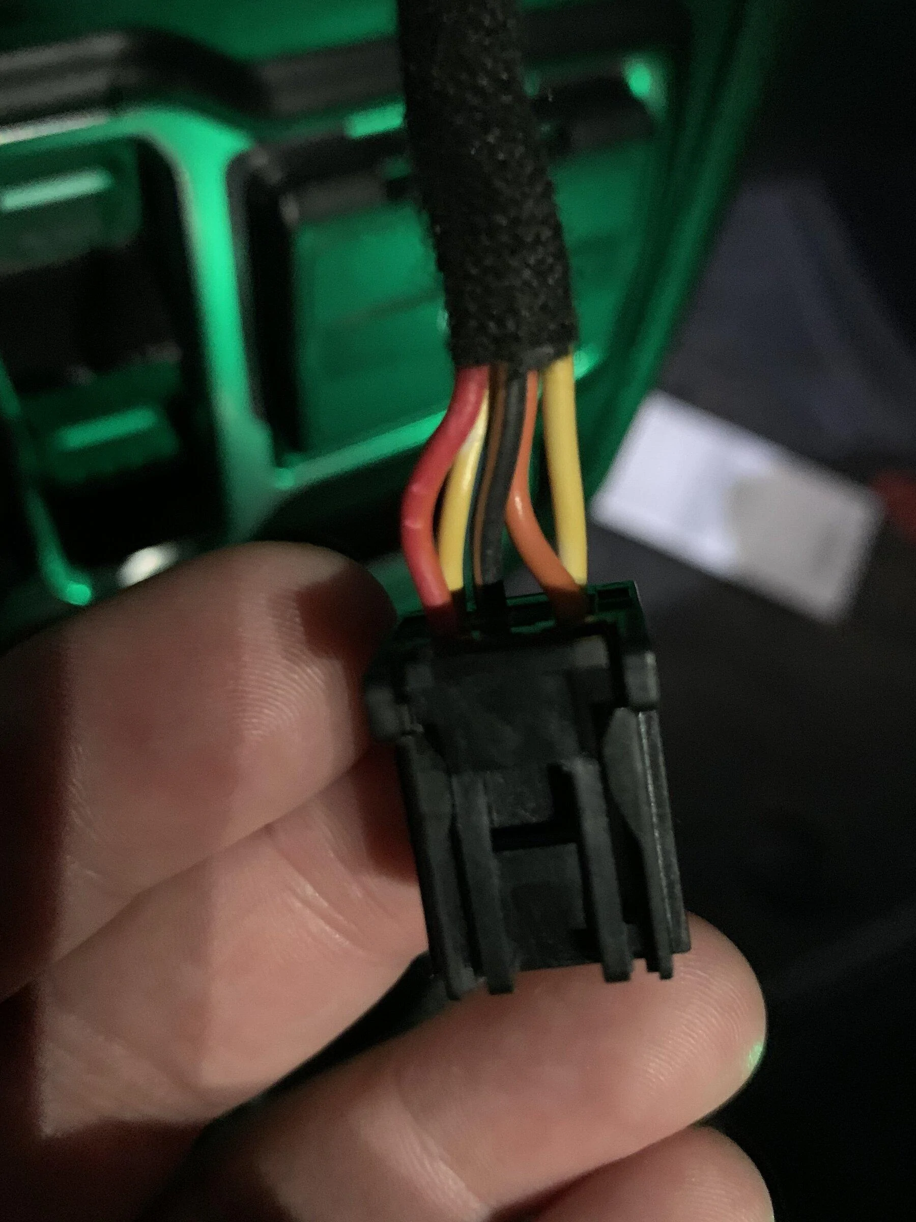

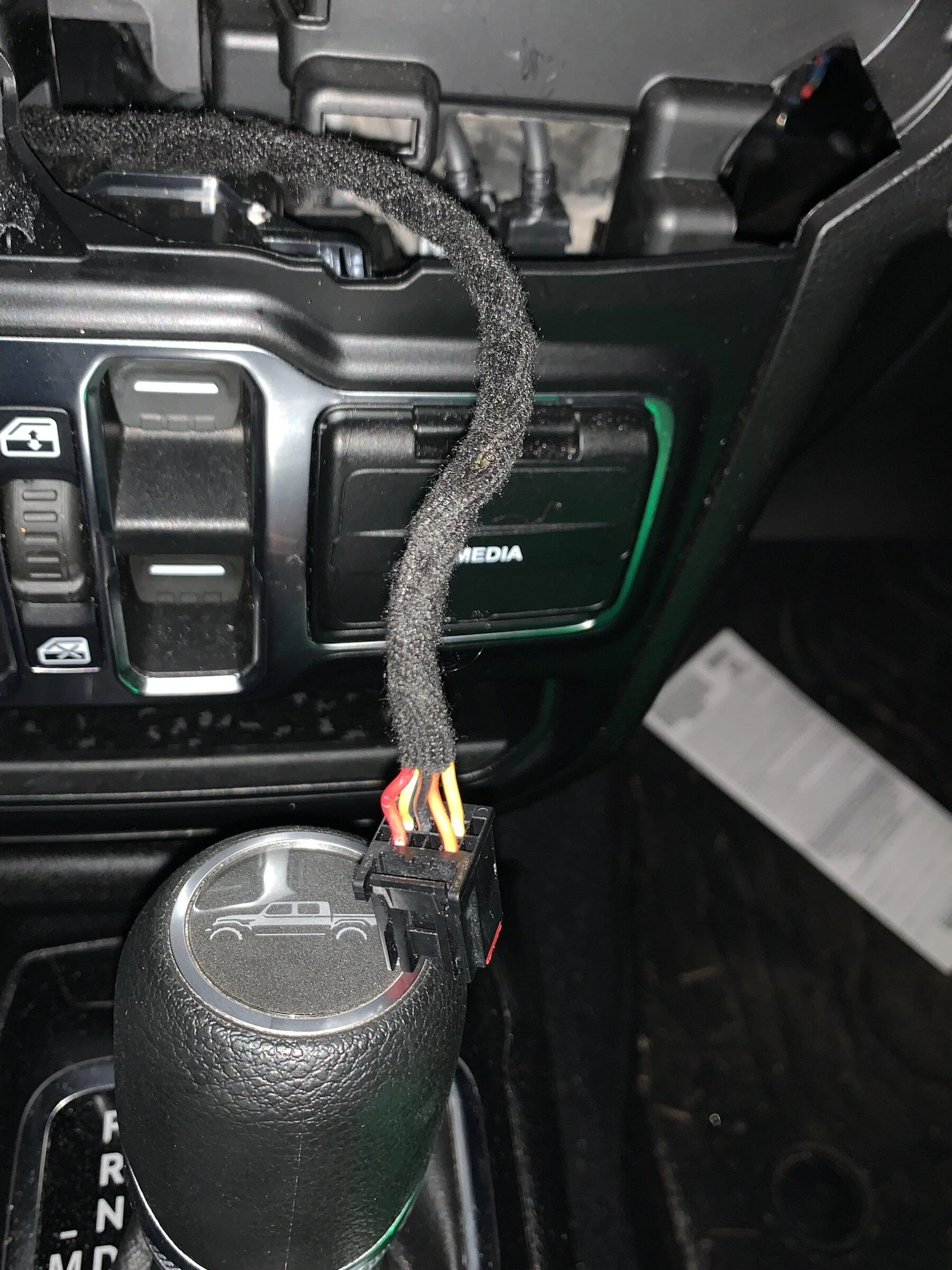

trying to tap into the harness that connects to the ac controls on the dash and cannot figure out which one is the hot lead. Anyone tapped into this before? I tried using my voltage meter but couldn’t get a good read on anything

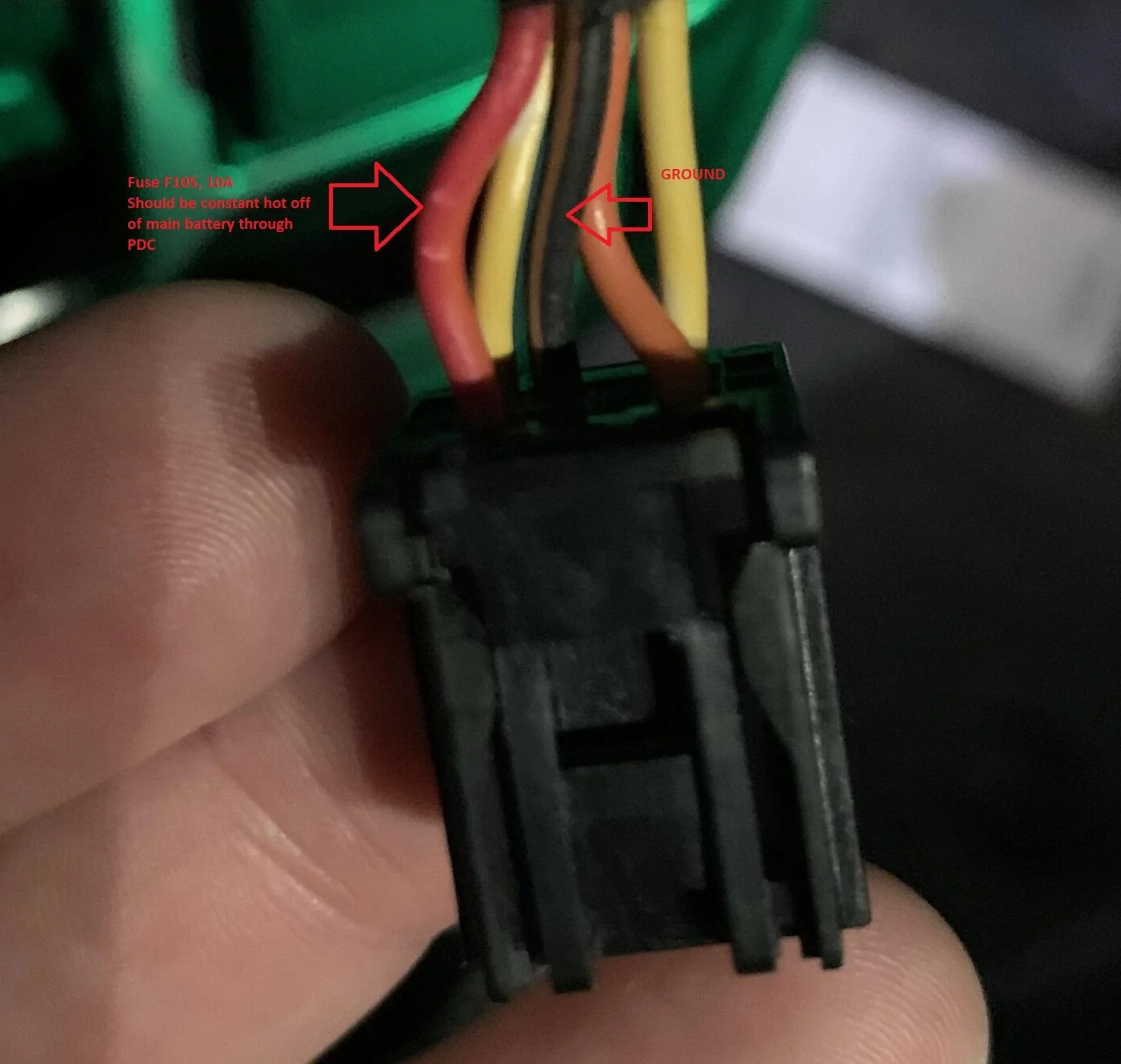

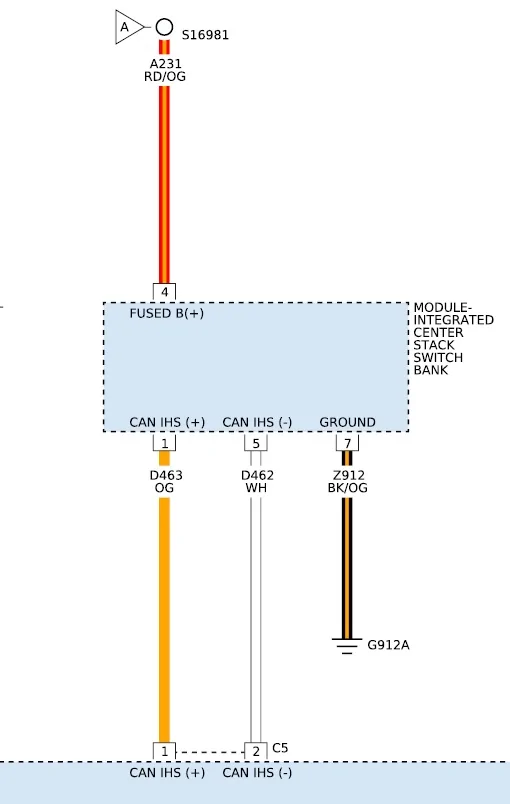

I assume you have the base sport HVAC controls?
Below is what I figured looking through my 2020 Gladiator schematics but that is for the dual zone automatic air conditioning system and it shows one less wire for that connector.
Edit: The extra wire is for the switch back lighting circuit on another schematic.

I have the dual zone ac as well. There was two hot leads coming out of that harness, I was trying to get some aux switches to illuminate when the other interior lights turn on. I tapped the one pointed out but was able to borrow a voltage meter from a neighbor and found what leads were hot
