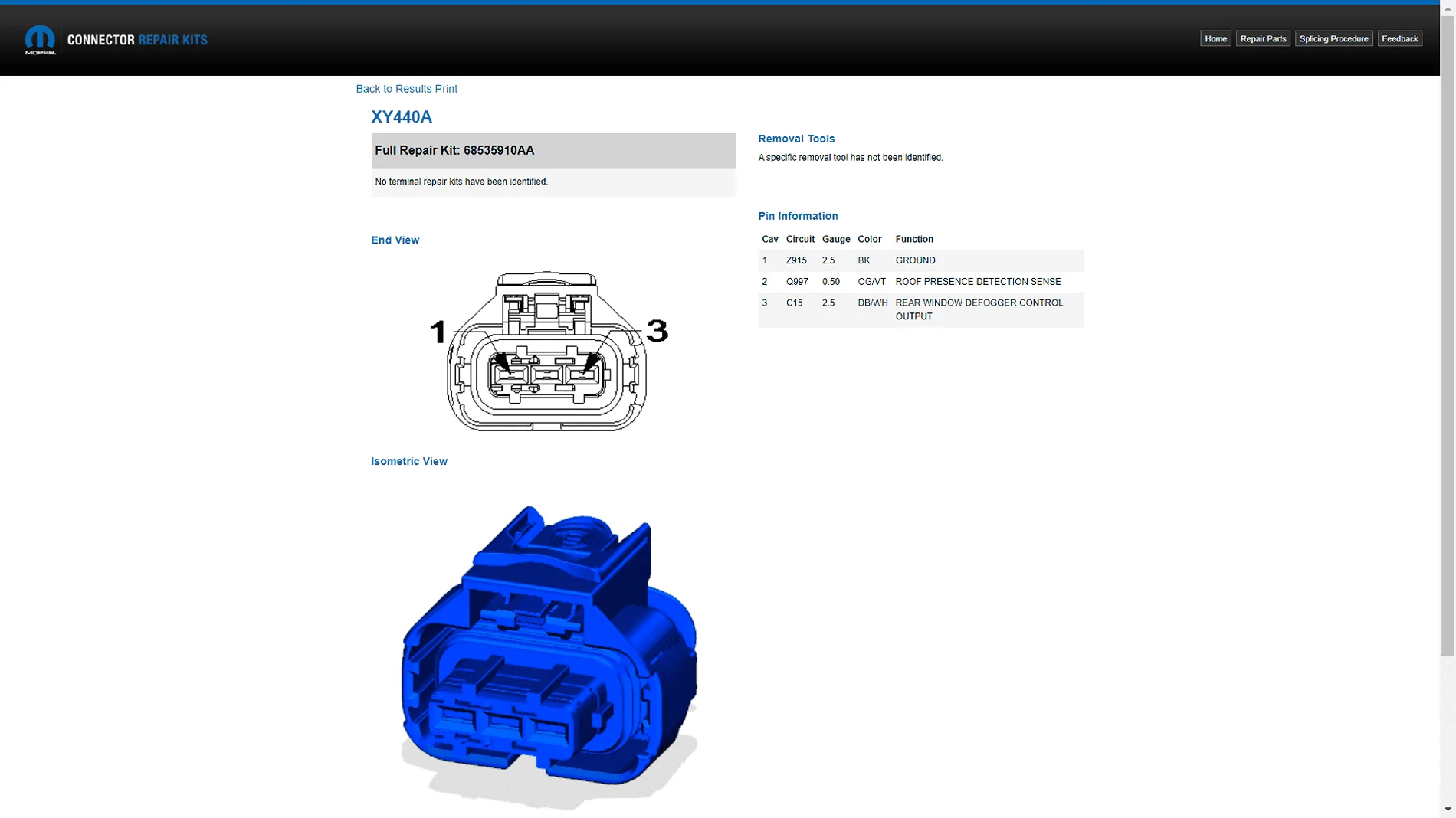

Been searching but can't seem to find any info, or maybe I'm searching the wrong keywords. Does anyone know of a wiring harness for the rear window defroster, the window side (male end I believe)
I'm considering building a box for installing a 12v fan in the rear window to blow cool cab air into the bed topper. For the dogs on road trips. Was thinking if I can get power from the rear defrost power it would be easy to connect and disconnect, and as a bonus it's switched on/off by the button on the dash. Obviously don't need rear defrost in the summer so it's just sitting there waiting for a harness/mod! Anyone know if there's a plug and play harness available?

The jumper wiring on the rear glass is only serviced with the glass. According to my schematics the body side of the harness is male, This end has a serviceable pigtail part # 68535910AA
The female side does not have any pigtails available unfortunately.
Here is an image of the male side for reference
Jeep Gladiator Rear window wiring harness 1723237098930-cs

Got it. I suppose someone with a broken rear window could save the wire.
Surprised there's nothing aftermarket, there seems to be aftermarket everything else
