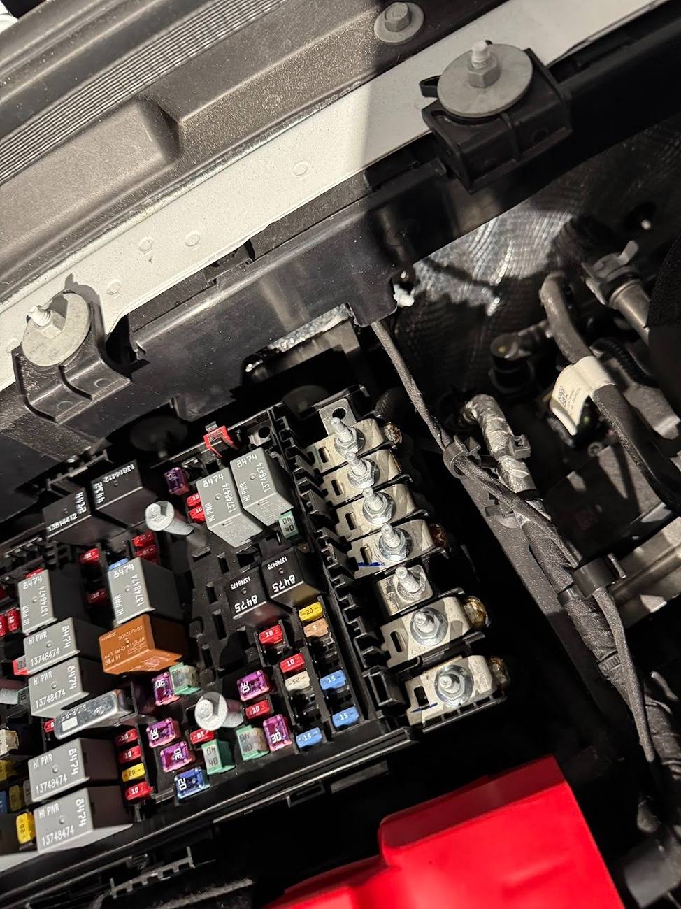

Update: Solved. Sharing this info just in case this helps anyone else. After reading about this on the JL forum - ESS Battery Cable Caution and ESS (N3) Fuse Warning | Jeep Wrangler Forums (JL / JLU) -- Rubicon, 4xe, 392, Sahara, Sport - JLwranglerforums.com, I got this solved.
I think what happened was that I wasn't careful when installing my solenoid, and I must have blown fuse N3. First time working on a vehicle with a dual battery system...
I swapped the cable going into N3 to N4, and all is well now. Now to figure out what fuse array to order so that I can get this back to how it was originally.

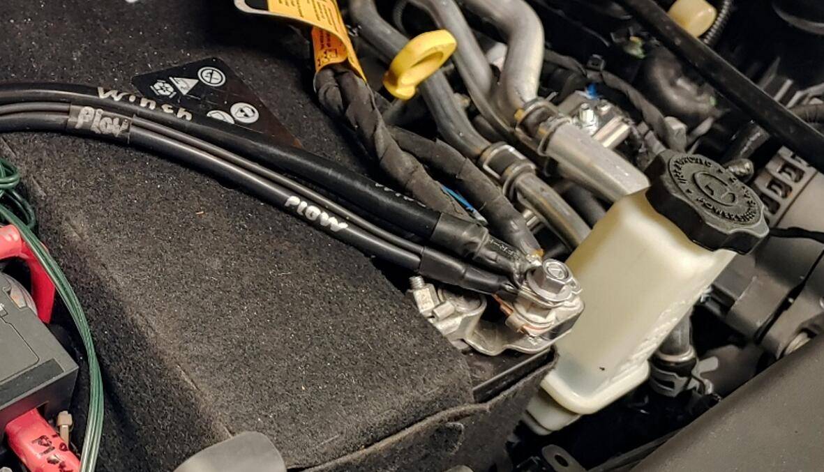

Where did you connect the winch ground? Just curious, as I don't see it in the picture..........
Thank you for sharing the forum sponsor info. I swung by the dealer today and bought the replacement 68368854AA part and swapped it in and all is well now.
In that picture, I had the winch ground disconnected. I have it hooked up to the negative terminal of the battery.
Makes sense you had it fully disconnected to check things out.
Top connection/threaded post on top of the IBS (the device on the negative terminal) is best.

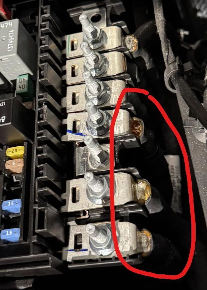

I just took a look at my fuses again to make sure that everything look OK after my re-install of the fuse array, and I noticed that my cables have like what looks like yellow/orangish glue around the bend where the cable connects to the fuse array.
Image included and red areas of potential concern are noted.
Is this potentially damage from when I blew fuse N3 out of my carelessness? Can I drive safely like this? I'm going to take it to a local Jeep shop this Wednesday to have it checked but I am curious if anyone else has already experienced this. I'll document what is communicated to me.
I also noticed that I have code p0562 - which has to do with battery/system voltage being low. I tried clearing it with my code reader, but it does not go away. I also noticed that my Electronic Start/Stop system menu page on the dash says "Start Stop Not Ready" and nothing else - no message about battery charging, etc. It does not appear to work either.

Never mind - found pics online from others that have that same orange colored goop on the cables. Looks totally normal.
249
40,519
54,123
May be from the sealer in the insulating tubes over the terminals?
I use marine or water proof heat shrink tubing that has a clear "glue" inside that looks similar but not orange.
