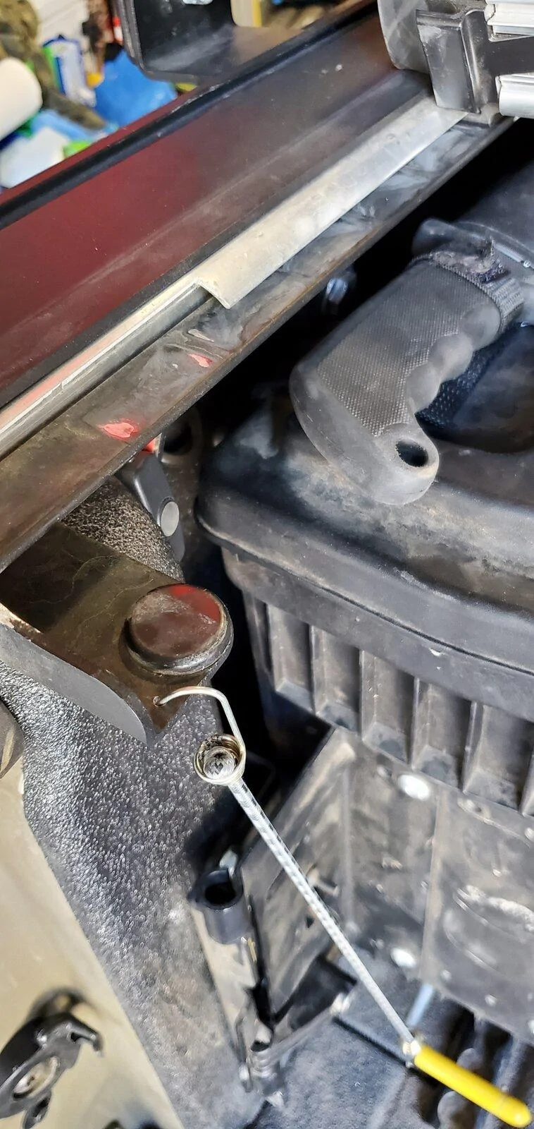

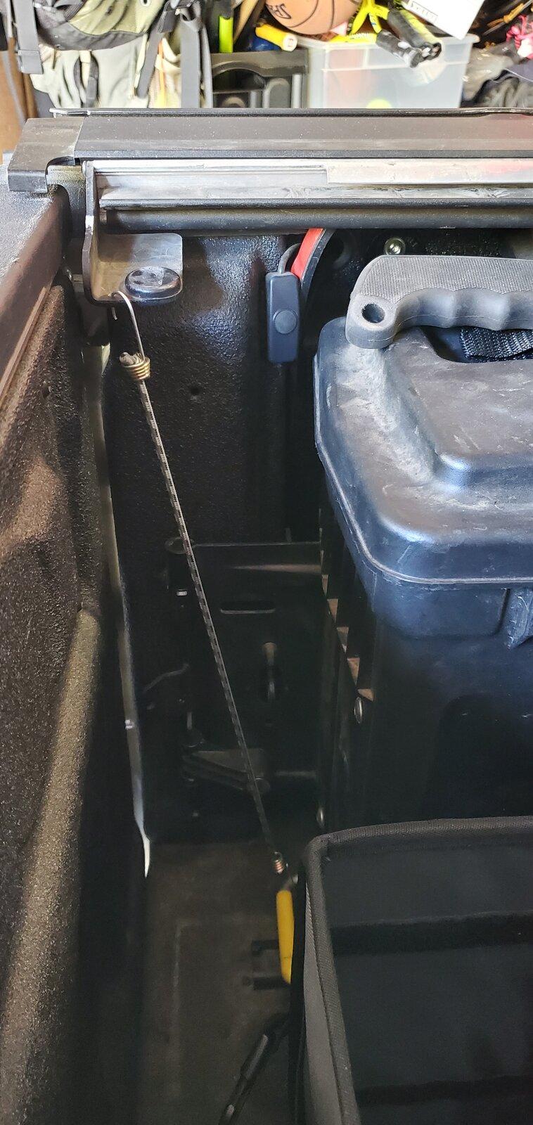

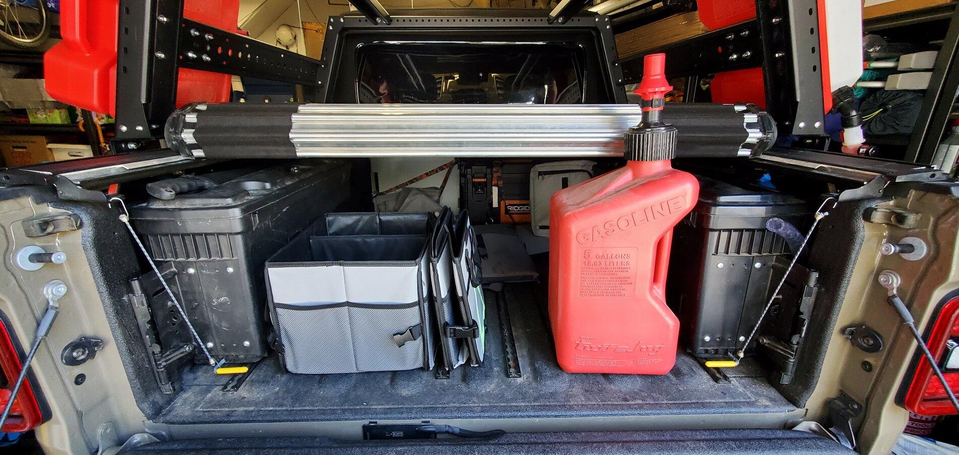

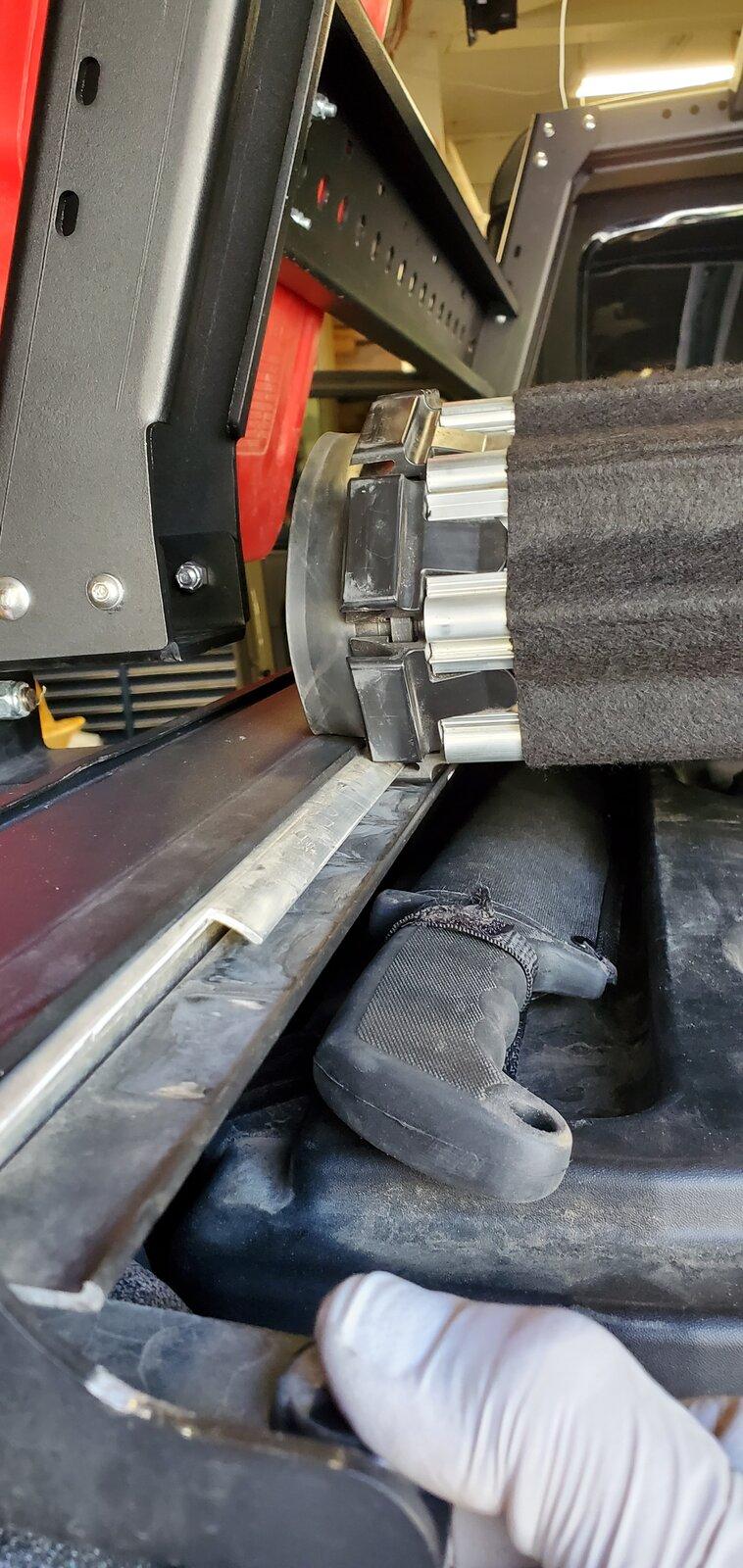

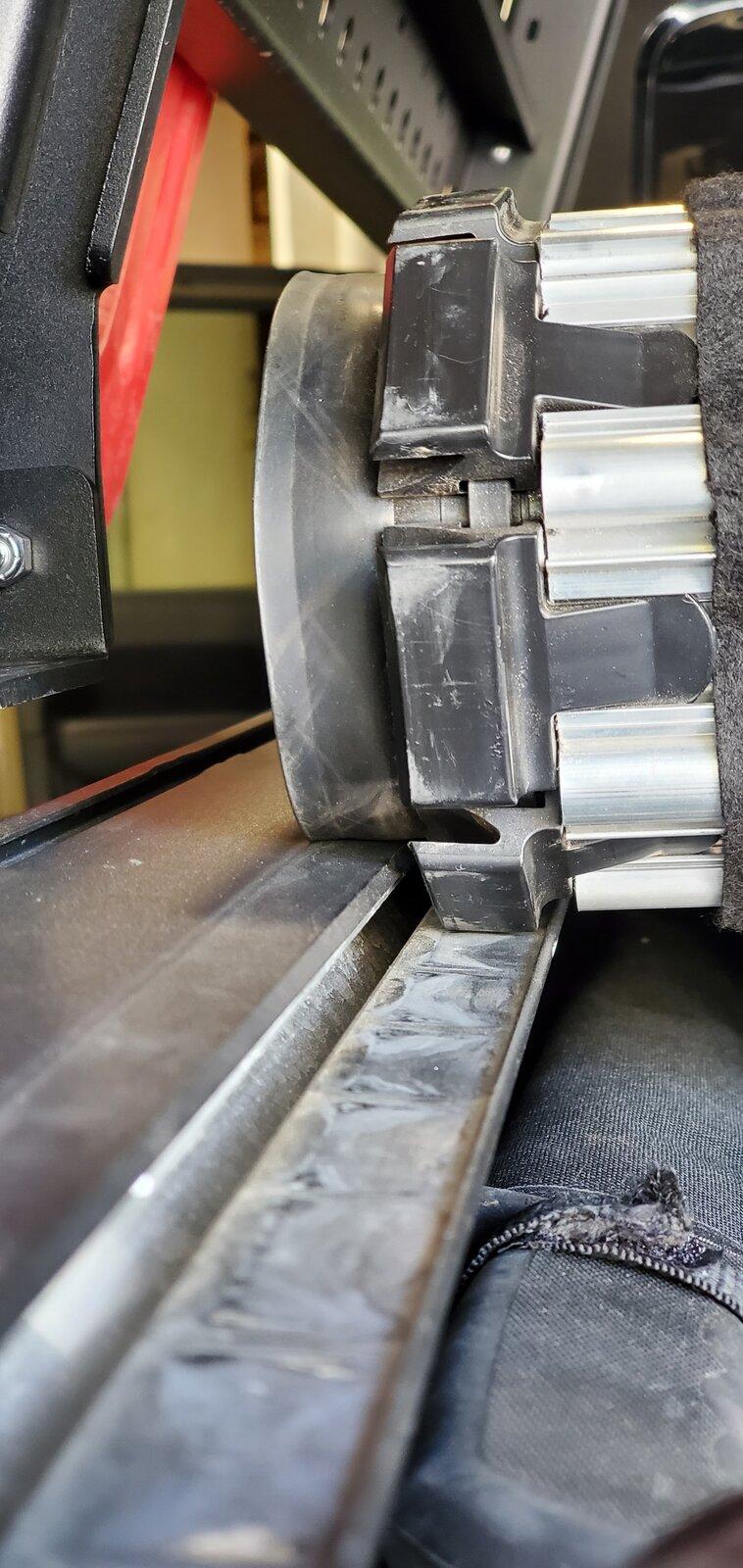

So if you look at pic 1 it shows the track that the cover rolls out on. Second picture is the aluminum rail that comes out to lock the entire tonneau cover. So I figured out that if you hold down the aluminum rail it will lock the cover in place. Cannot roll forward towards the cab. It can however roll back but where's it going to go?
So what I did was drill a small hole in the arm where the cover pushes down to lock itself in place, added a small bungee cord to keep the arm locked down when I need to transport something but still want to keep most of the bed covered.
What's nice is locking the cover down this way you have almost unlimited adjustment.

Great idea, never thought of that. :) I have the same wheel well toolbox too (though I only have one) biggest issue with them and the bedcover is that you need to open the bedcover and swing them out for full access to the lid.

Wow that is nice. Is the cover relatively waterproof when closed up?
My wife wants an ARE cap like as soon as we get the truck, but I'm trying to convince her we can hold off and maximize lockable storage with something like this. I'd be more inclined to go ahead and get the cap if I could lay down in the bed but since I can't I don't really see the rush.

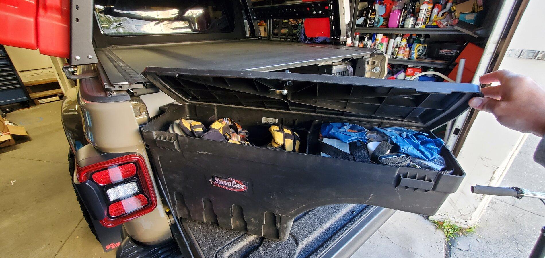

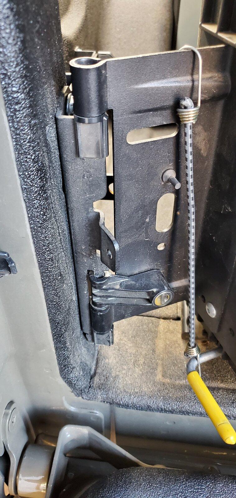

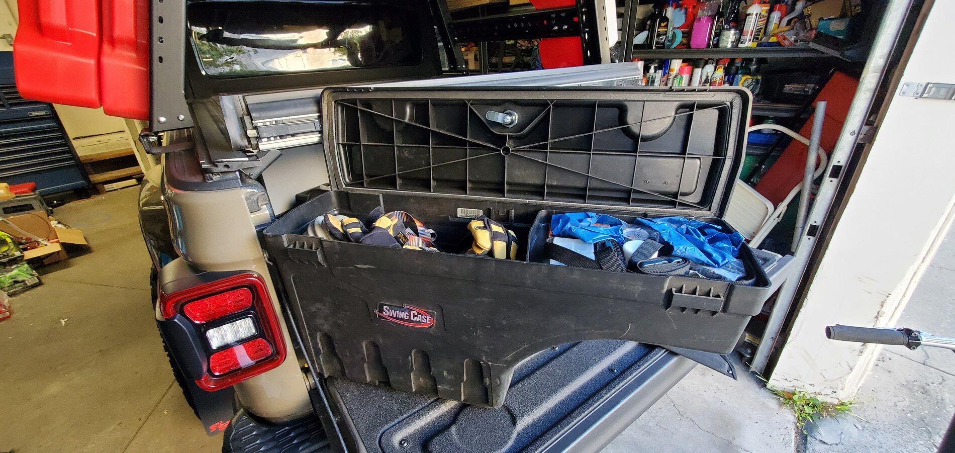

I modified the swing case stop so that I only need to unlock the Tonneau cover and can access the box. It does not hit the truck.

Man, you're just full of good ideas. Got any hot stock tips :LOL:

What bed rack is this? The Bak Revolver works okay with it as far as rolling up? any water leaks under the cover because of the rack mounts? Great setup

It's the Voodoo Max Modular rack. The Revolver works great, rolls all the way up.
No leaks for me. But I did add extra weather stripping to my setup.
