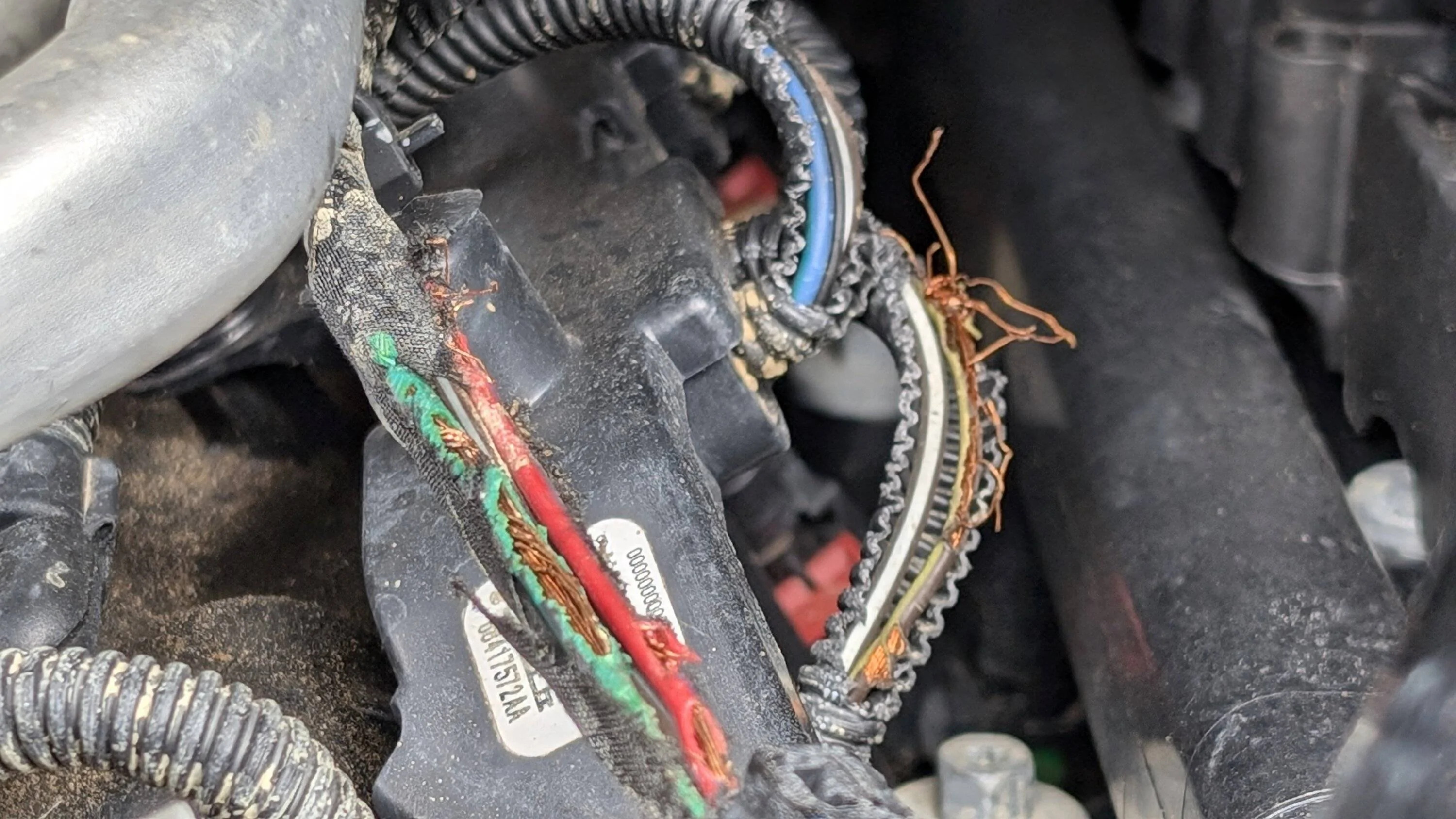

I posted the pictures originally in the 'Engine Bay Fires' thread. I was quickly told that what I have is rodent damage. Friend and I went out to the Jeep, and took pictures and yup, it sure is. They even made a bed out of the rubber/foam sound deadener. Nice of them. I bought a Shop manual to identify what it was. It indeed looks like the fuel injector wiring harness. The only code I have a 'CHECK 4WD' which I don't think is related.

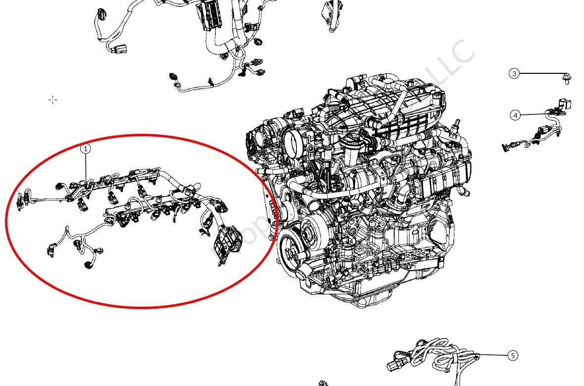

I have included two pics of the damage, and the items that I 'think' matches it from the shop manual. It is described as: 1 WIRING, Injector 68417572AA. I am interested in learning if the displayed damage is repairable without replacing the entire harness. I Jeep runs fine. This apparently happened while I was overseas for a couple months (Feb-Apr) and has been unnoticed until I changed the oil a couple weeks ago.

My $0.02. If it's working right now in the condition it is in, then splicing in wire to repair can't be any worse. However, I'd bite the bullet and spend the $$ to replace the complete harness. Looks to be less than $150.

I agree with whysoserious, replacing the harness will be quicker and save headaches.

I would fix that in a heartbeat. That's no big deal. I have done 10 repairs in the last 24 months on 4 total vehicles. Harnesses are wound through the rest of the wiring/hoses/intake and are taped and zip tied. They are usually a pain in the ass to get out. I use heat shrink that has glue in it. Solder in a section of stranded of the same gauge and heat shrink the repair. Then use loom to cover it all and protect it a bit. The most luck I have had is using ultrasonic repellants. Some say they don't work, but I have not done a repair since they were installed under all the hoods. They will be in all my vehicles from now on. Like $25 for 2 on Amazon.
