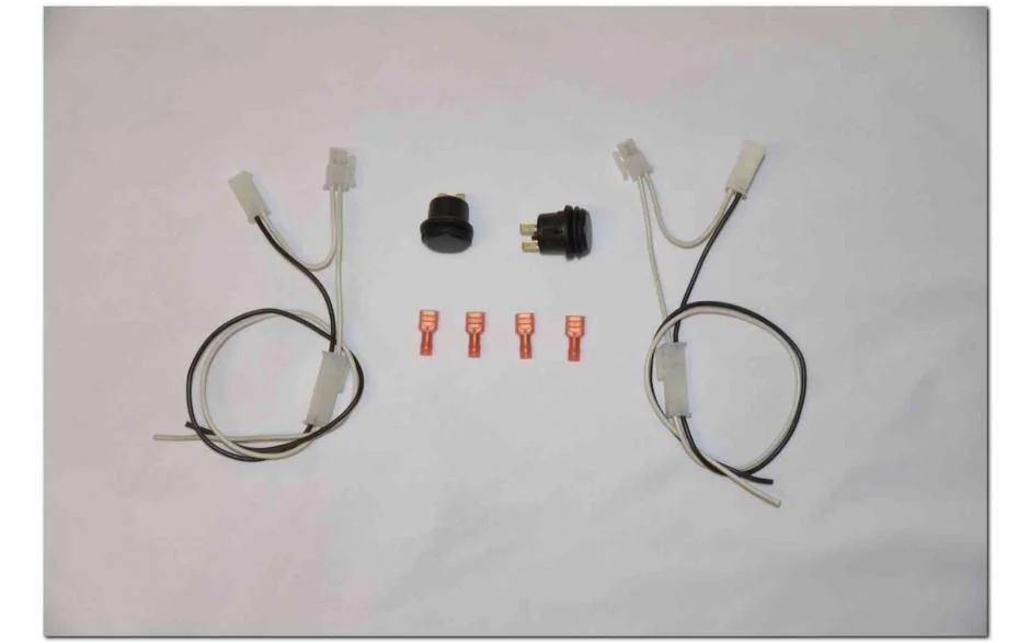

I've seen the kit and I can't justify $80 for a bunch wires, spade connectors, plugs, and switches.
Jeep Gladiator RSE Step Sliders Door Delete Kit, DIY sl-dd-100_-_4

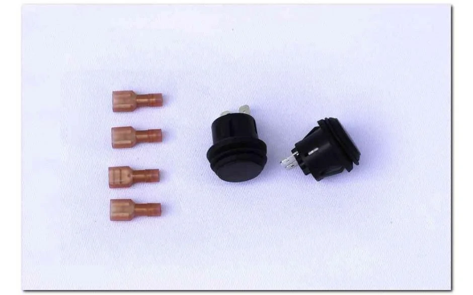

So I've decided to make my own wire harness. I have the wires, spade connectors and plugs sorted but I can't figure out whether these switches are rockers or momentary push button. Any in site would be helpful.

They are not momentary switches. They will only also operate one set of doors.
I have them on my front door sills in the pop out panels by the lower set belt mount.
The rear I have designed up some magnet holders that fit snugly through the latch loop and hold the magnet over the sensor.
