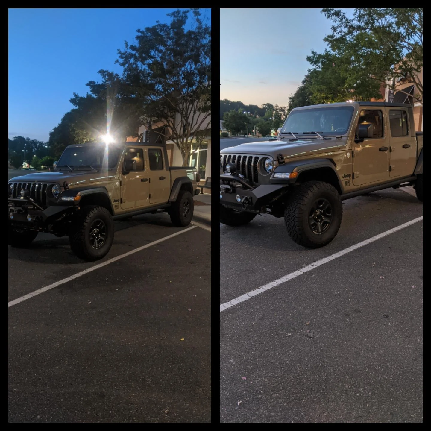

I only added the fronts, still got my Max Tow rears and no you wouldn't mess anything up. Everything else I have other than the 2.5" ReadyLift SST lift kit is stock. Still have the stock Trackbar and control arms. At this point there are only two things I may add, adjustable front track bar and a Fox Steering Stabilizer. Based on how it's riding and driving I don't need either but I just personally want to match the Stabilizer to the shocks and recenter the axle. But it drives and rides awesome as it sits. You should do it.

A little better picture to show the stance and height now compared to before. Left side is with the Rubicon springs up front and 2.5" ReadyLift installed with and Max Tow Springs in the Rear and Rubicon Fox shocks front and rear. Right side is how it sat before with the Max tow springs front and rear and 2.5" ReadyLift installed. Sitting in the same space you can see the front end is slightly higher and it's more leveled out.
First ride on the I-85 this morning about 25 minute trip one way to inspect one of my buildings and I'm smiling guys, this things riding like a dream.
